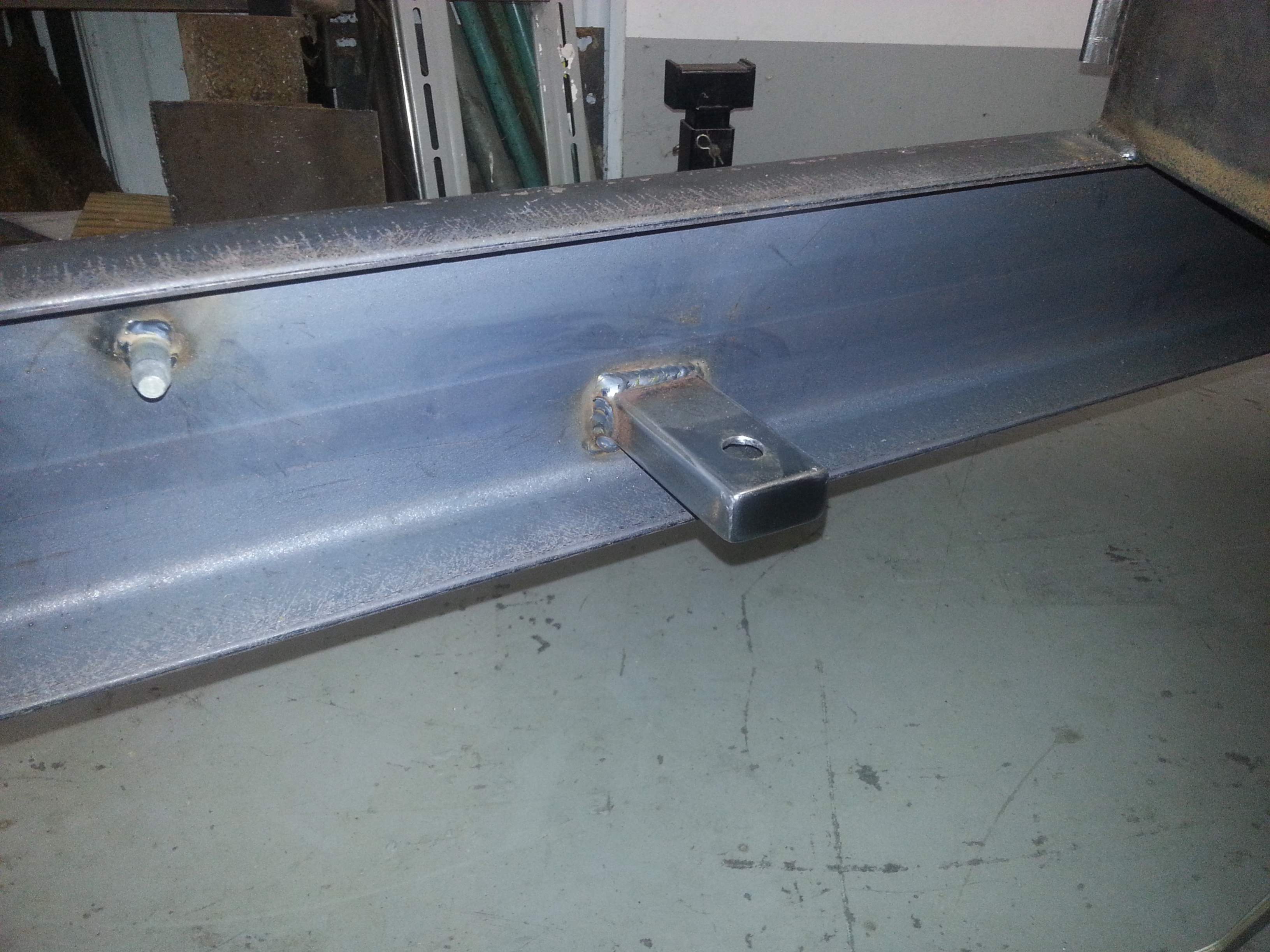

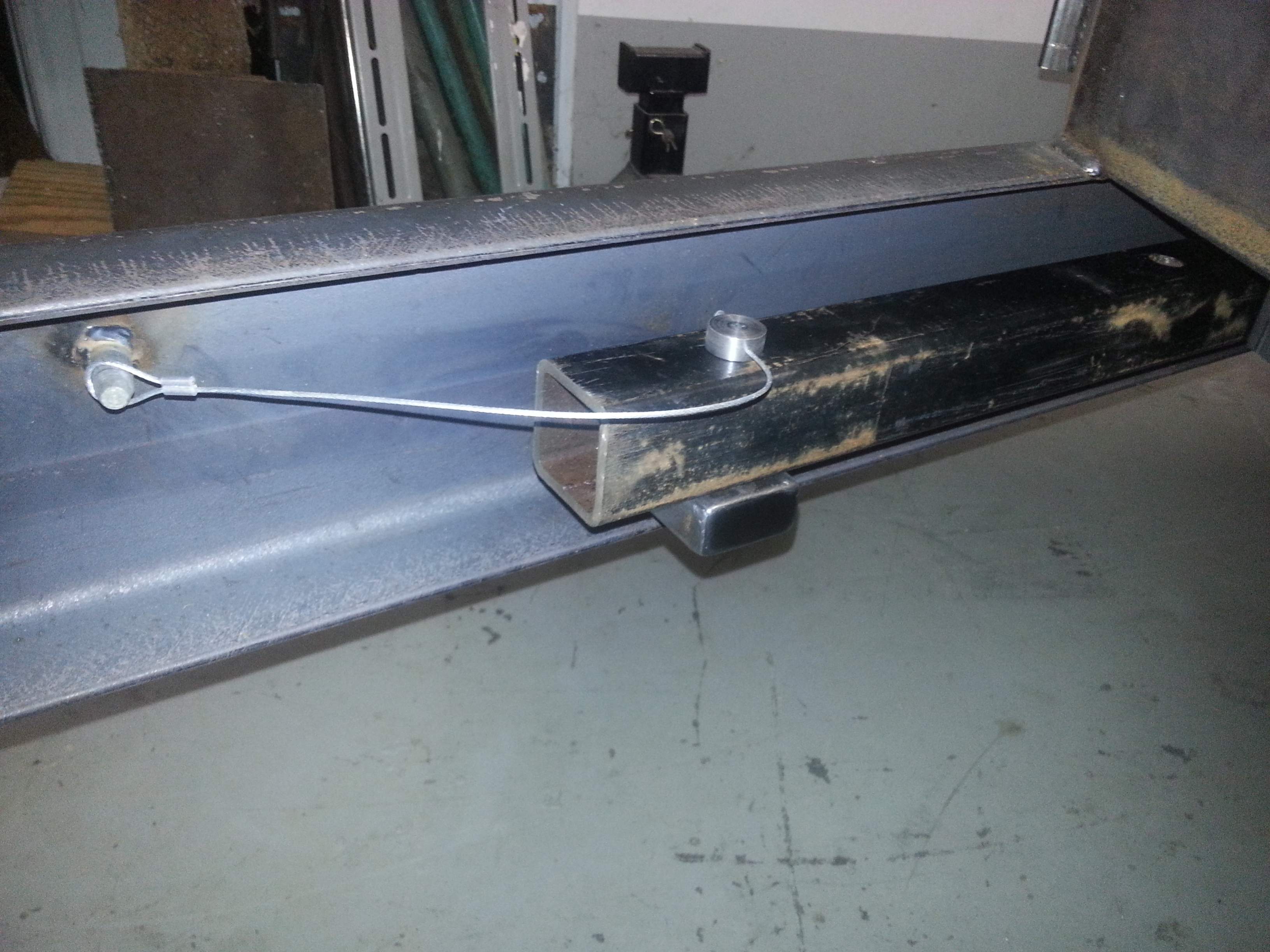

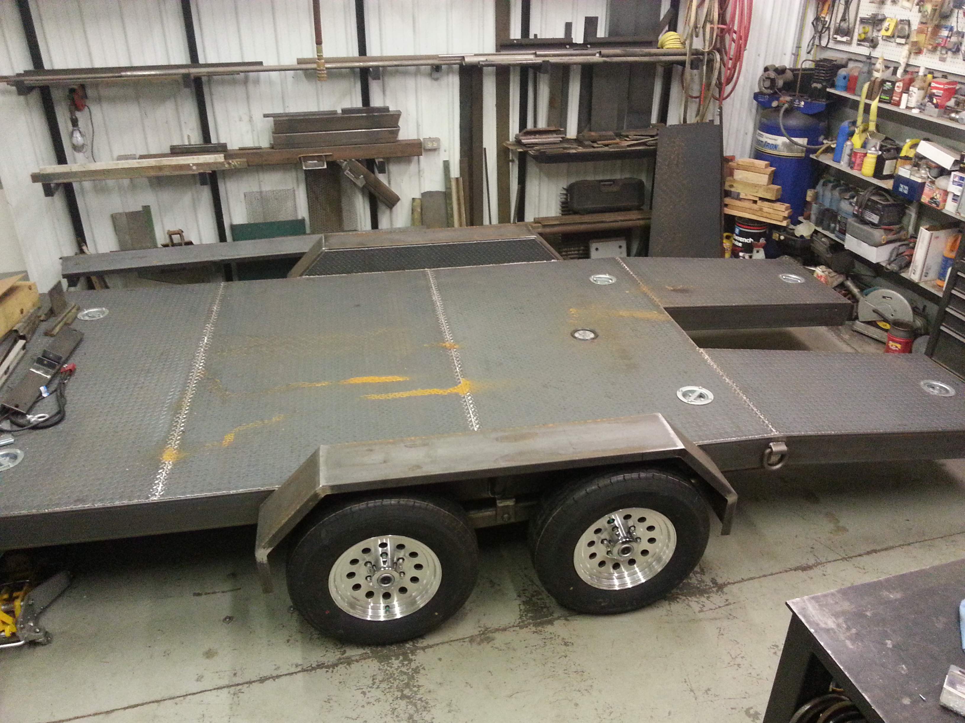

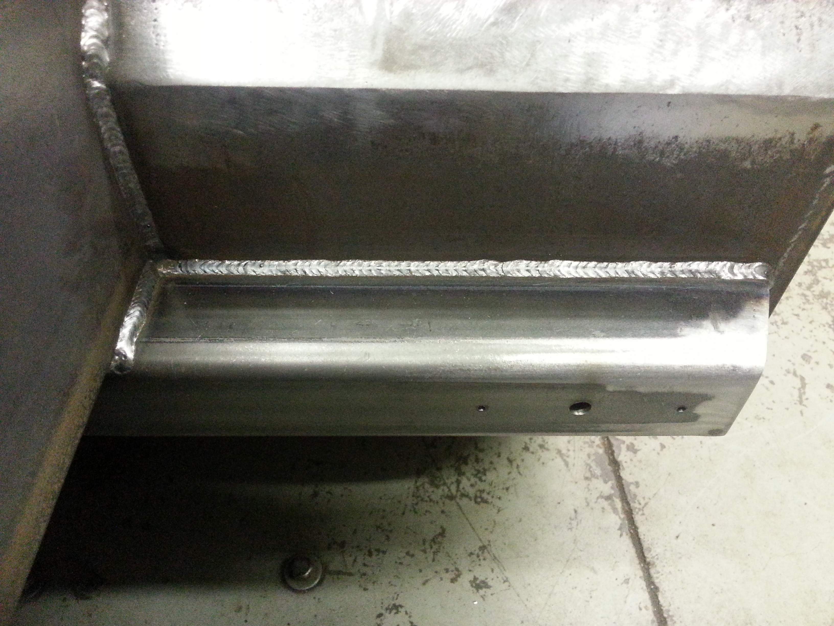

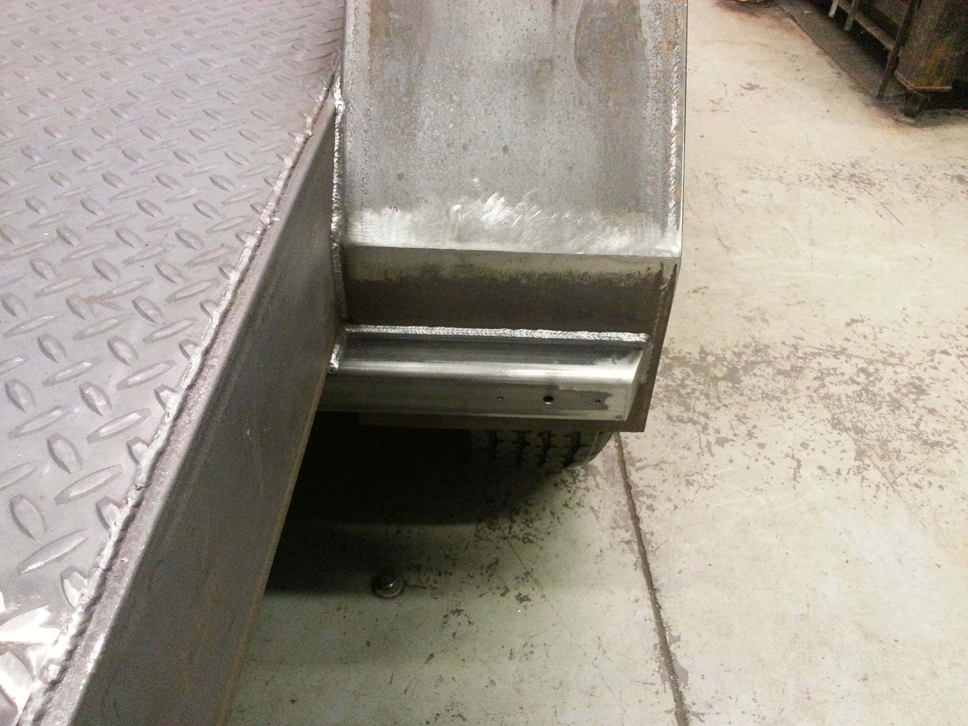

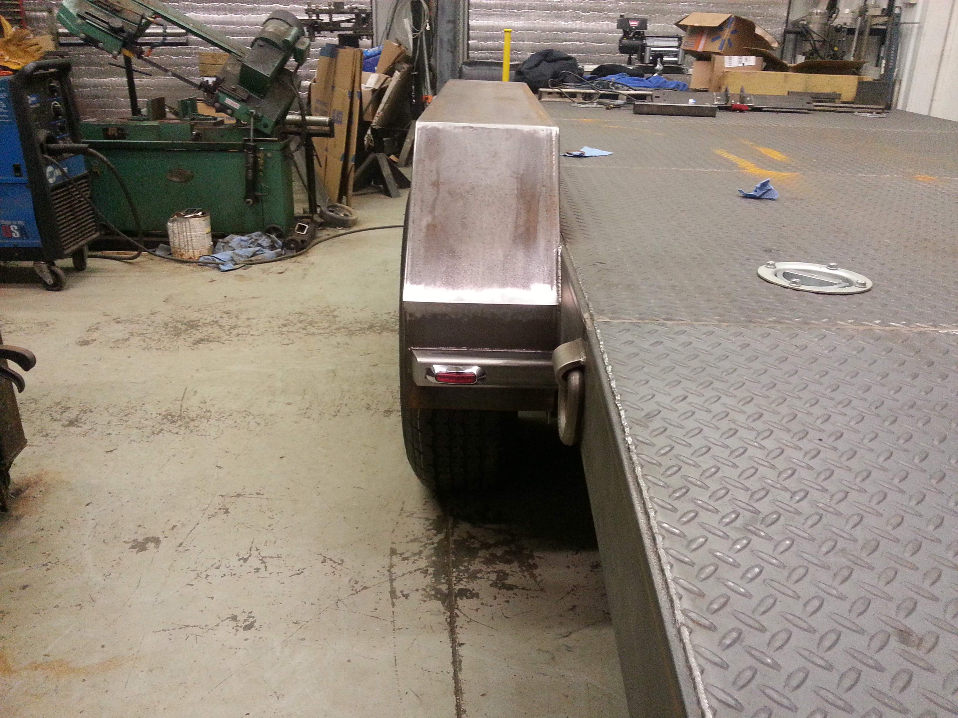

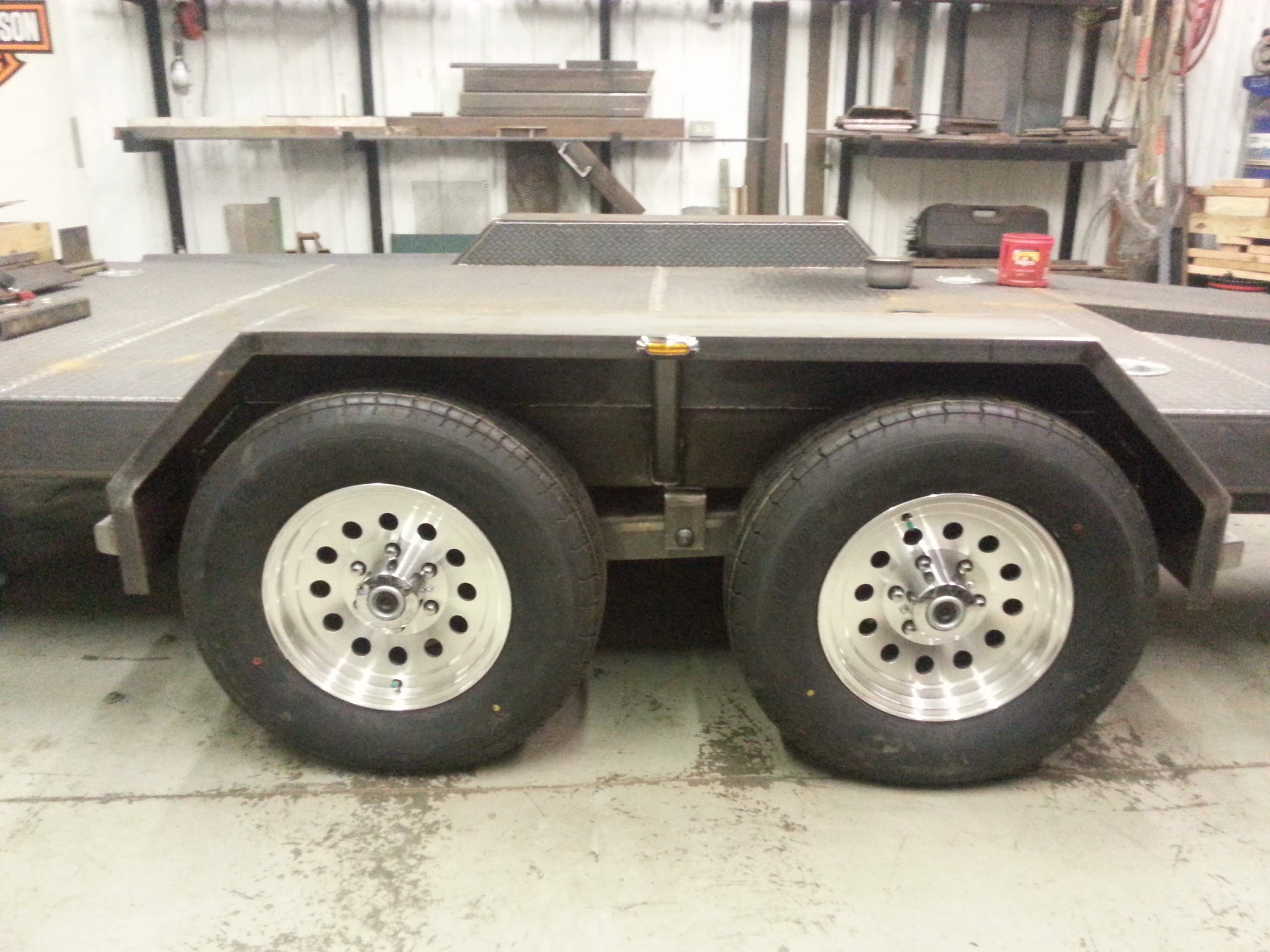

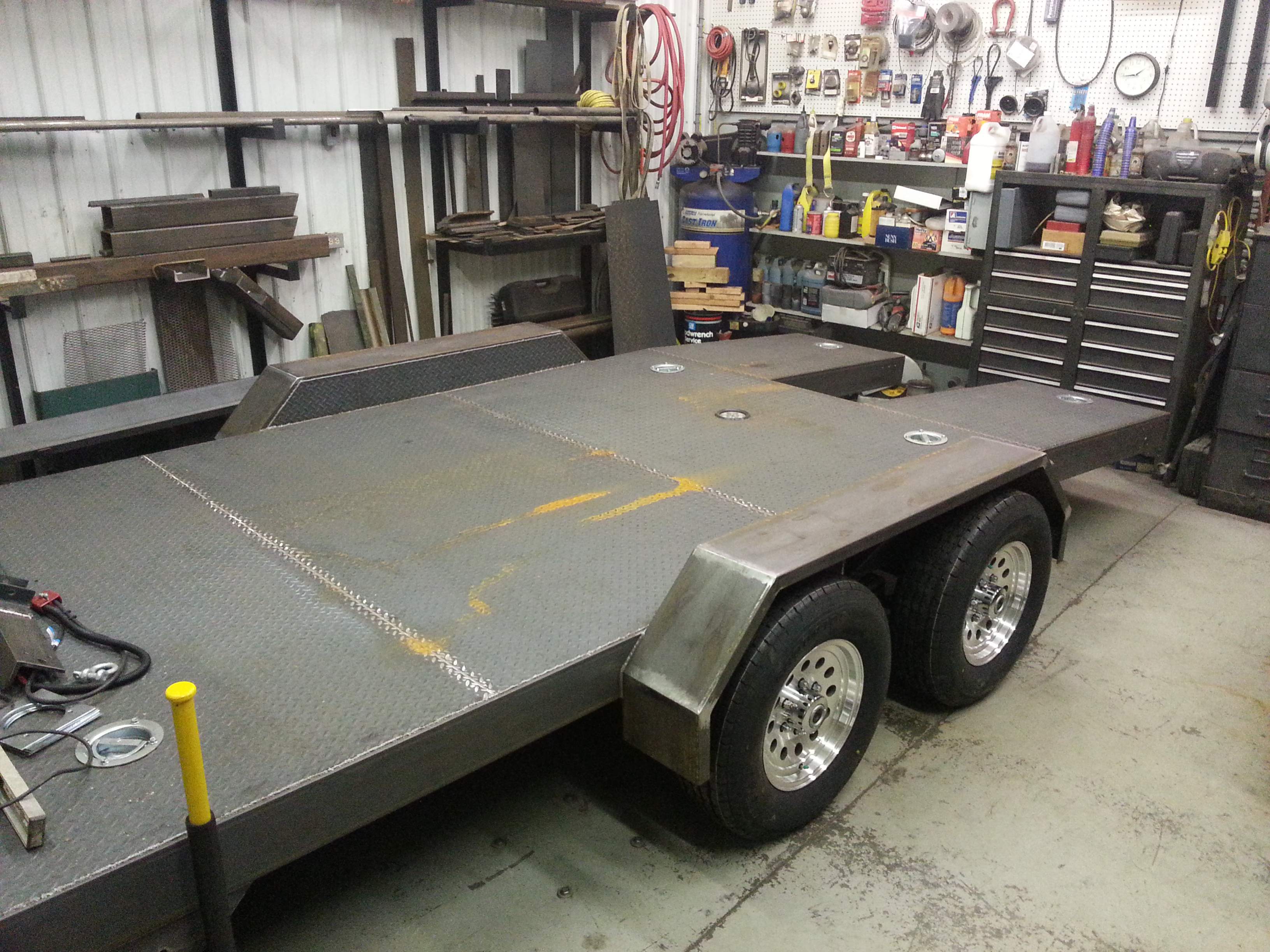

Extension receiver hitch. Before I get flamed too bad, it's only intended to tow another light-weight trailer (like a small utility trailer with say a Rhino or Rzr)
   / Split-dovetail car hauler trailer #102
Is that legal where you live?
#103

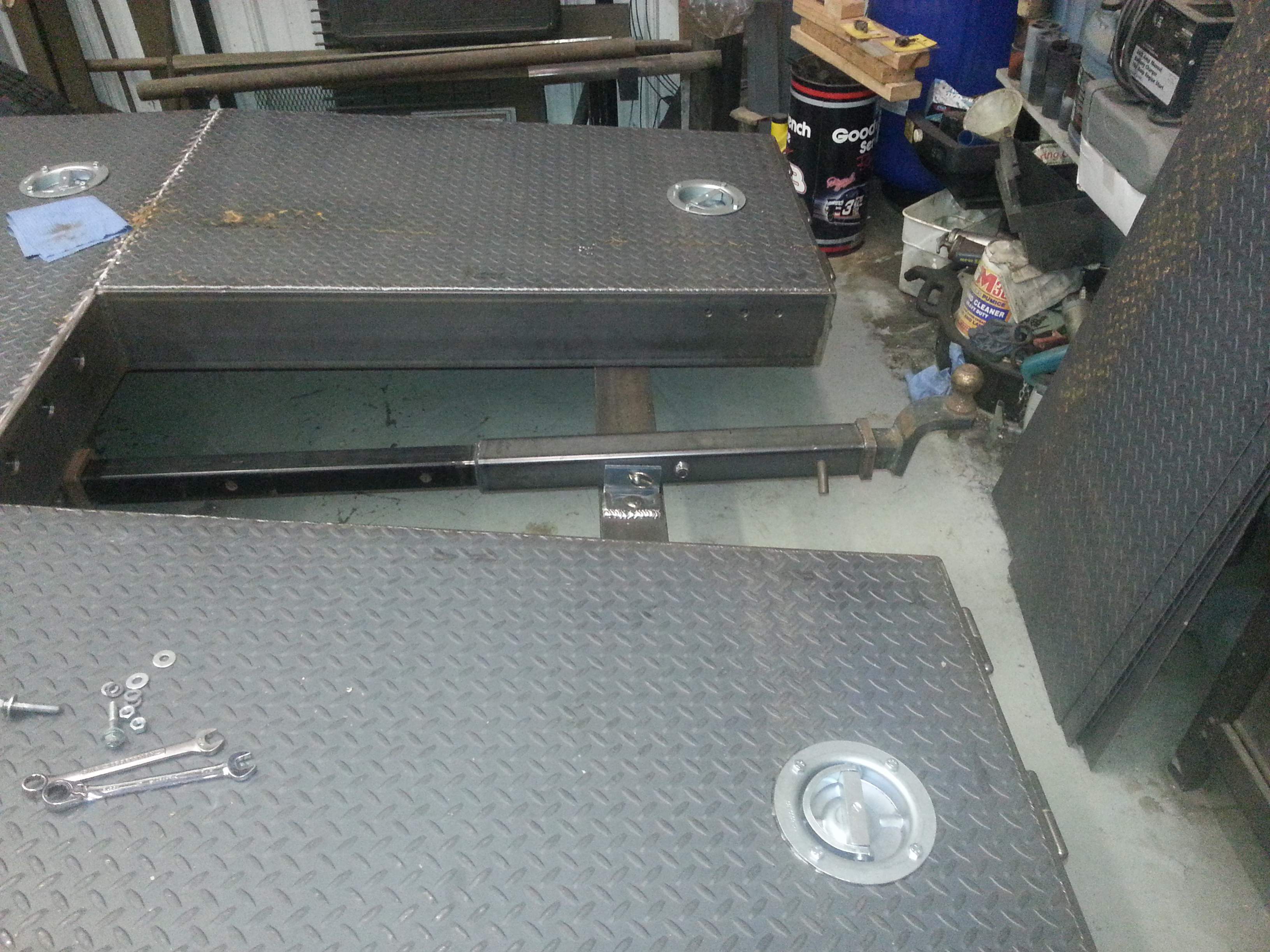

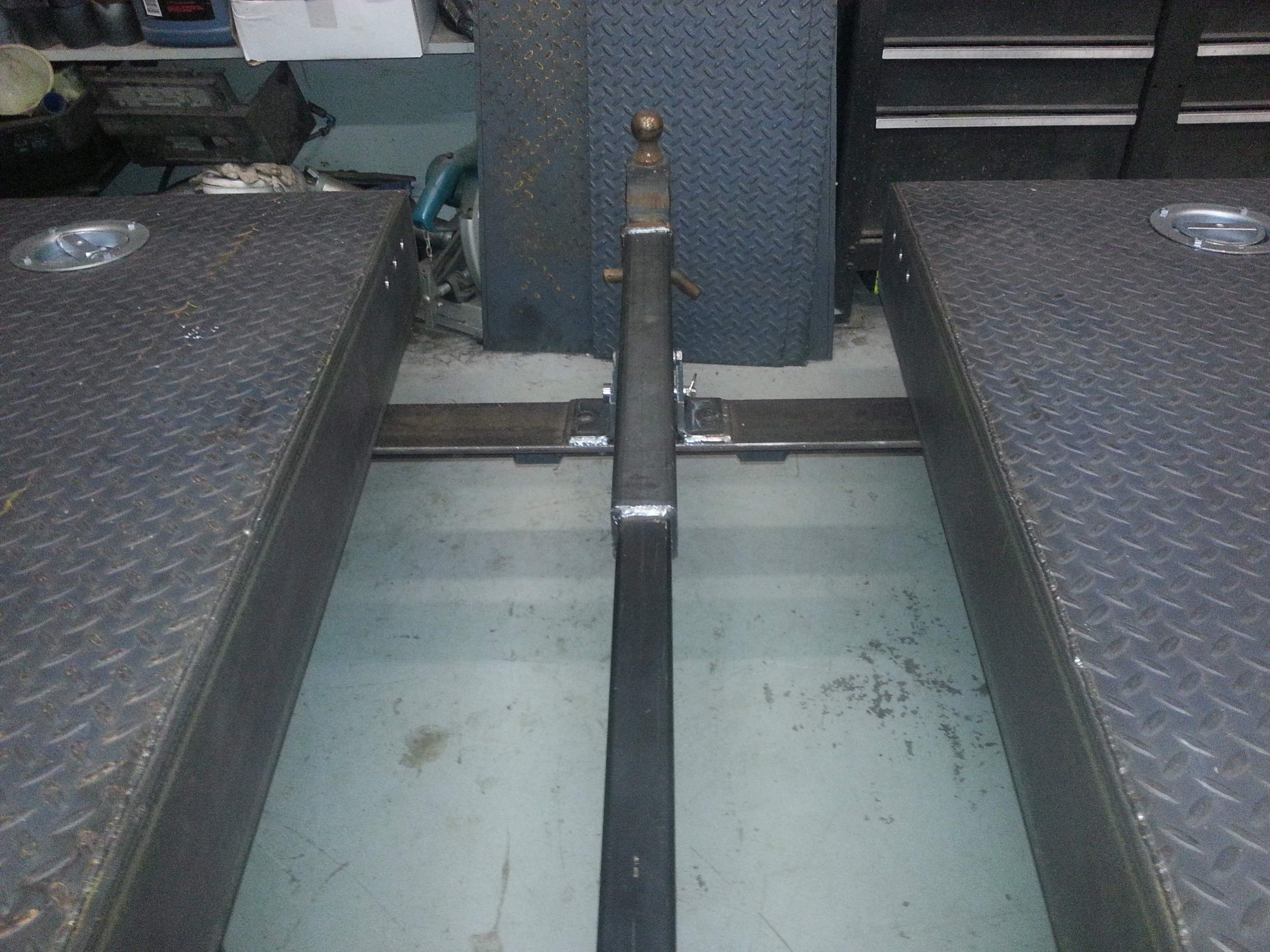

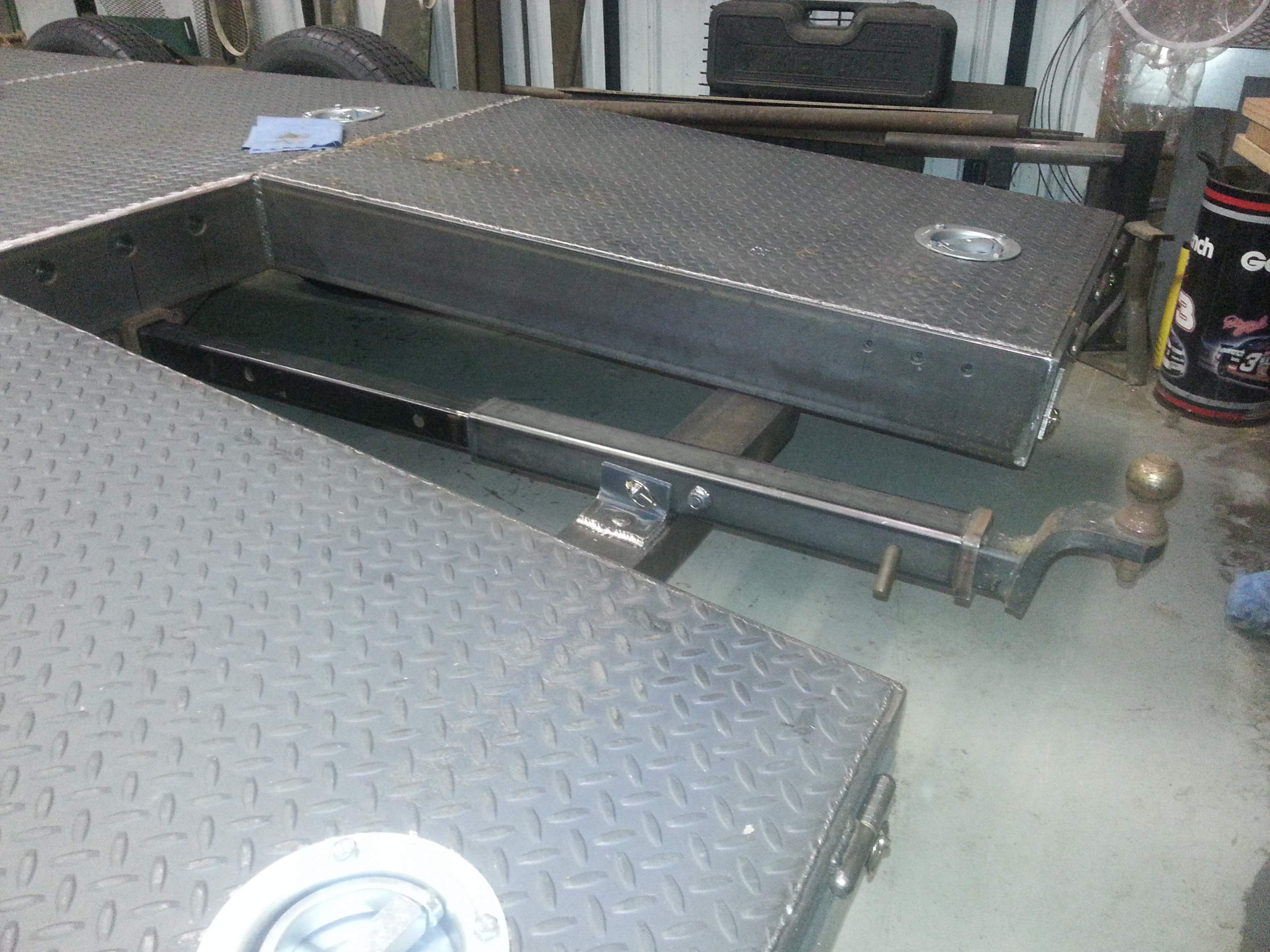

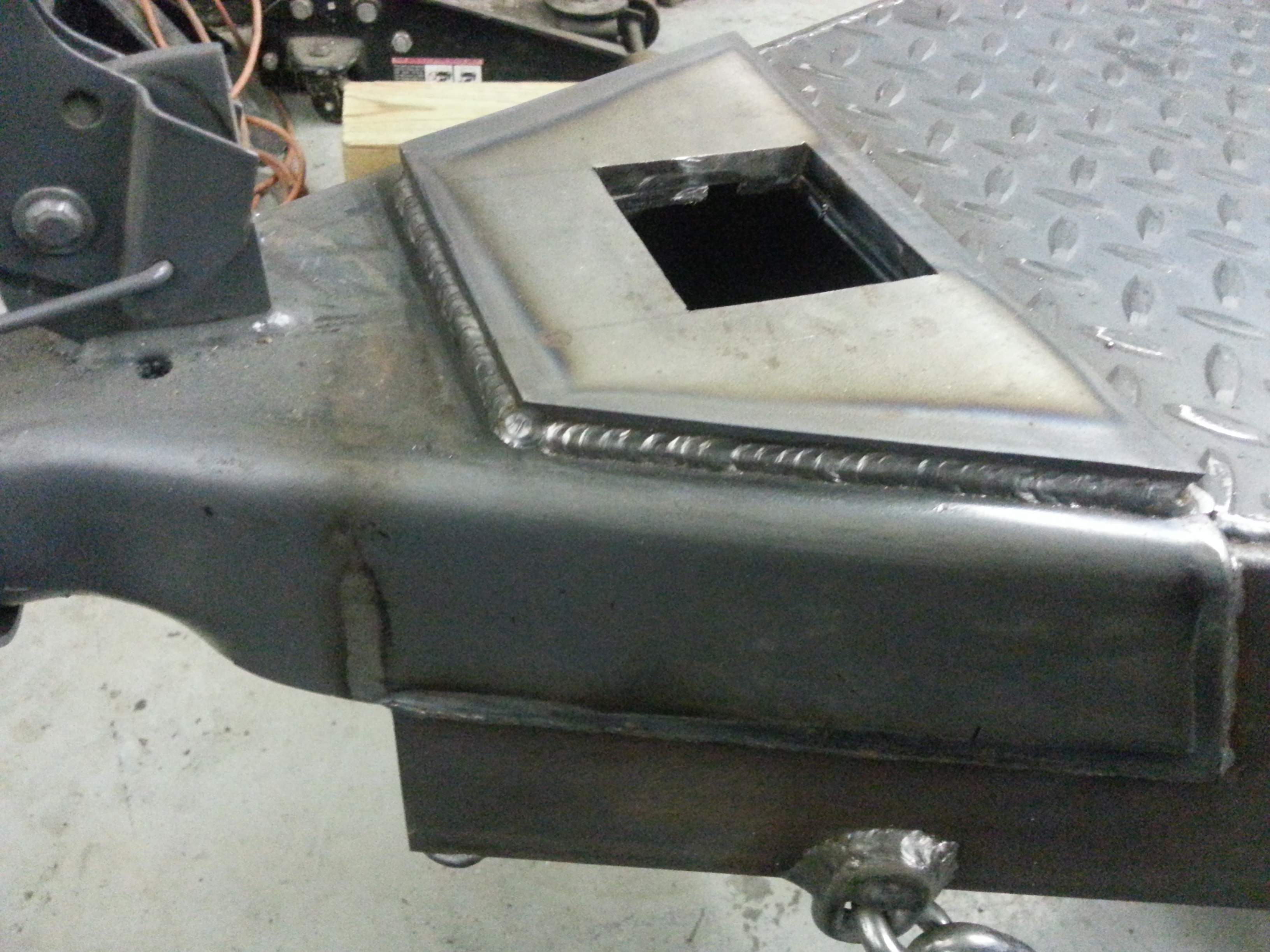

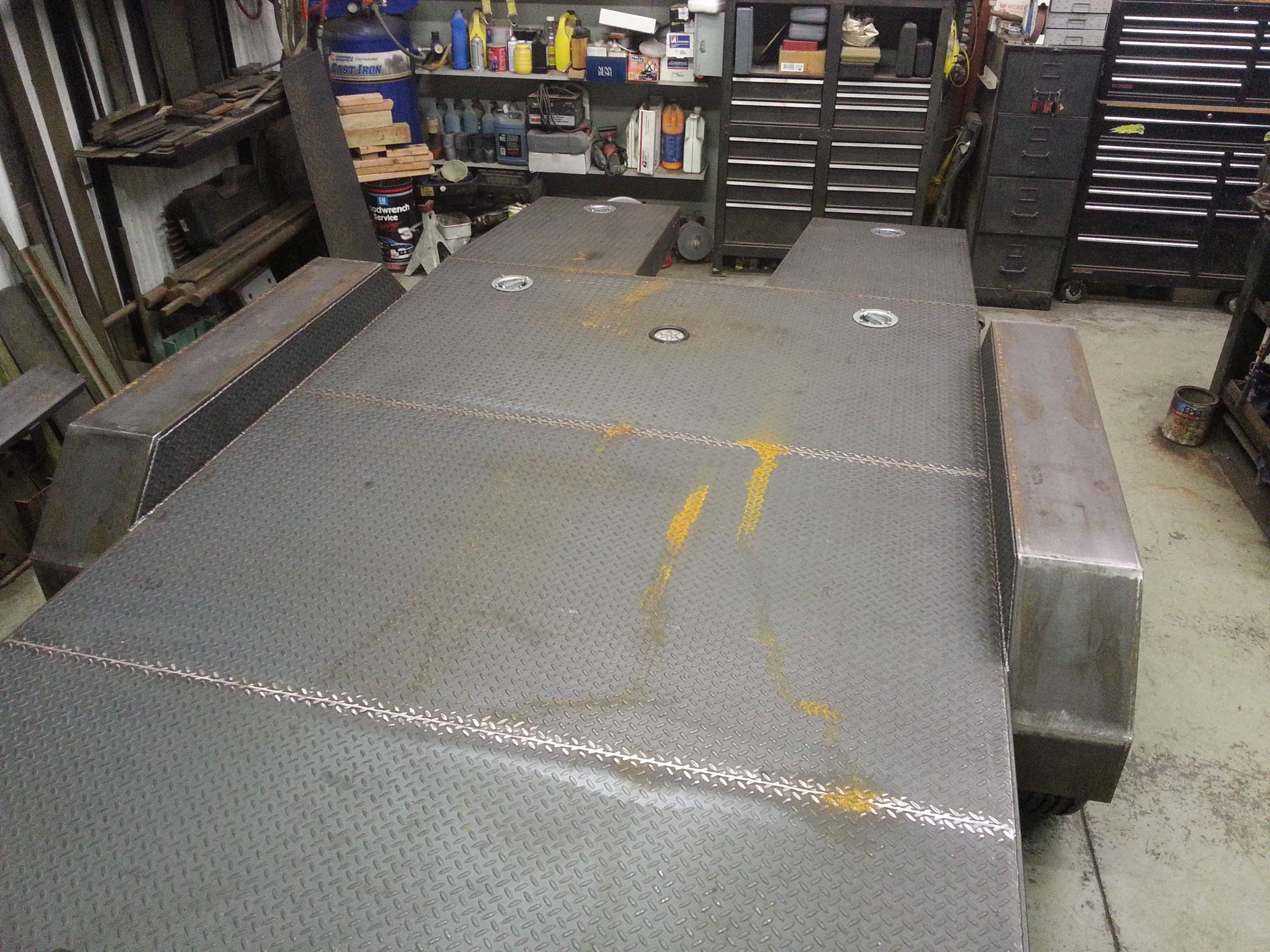

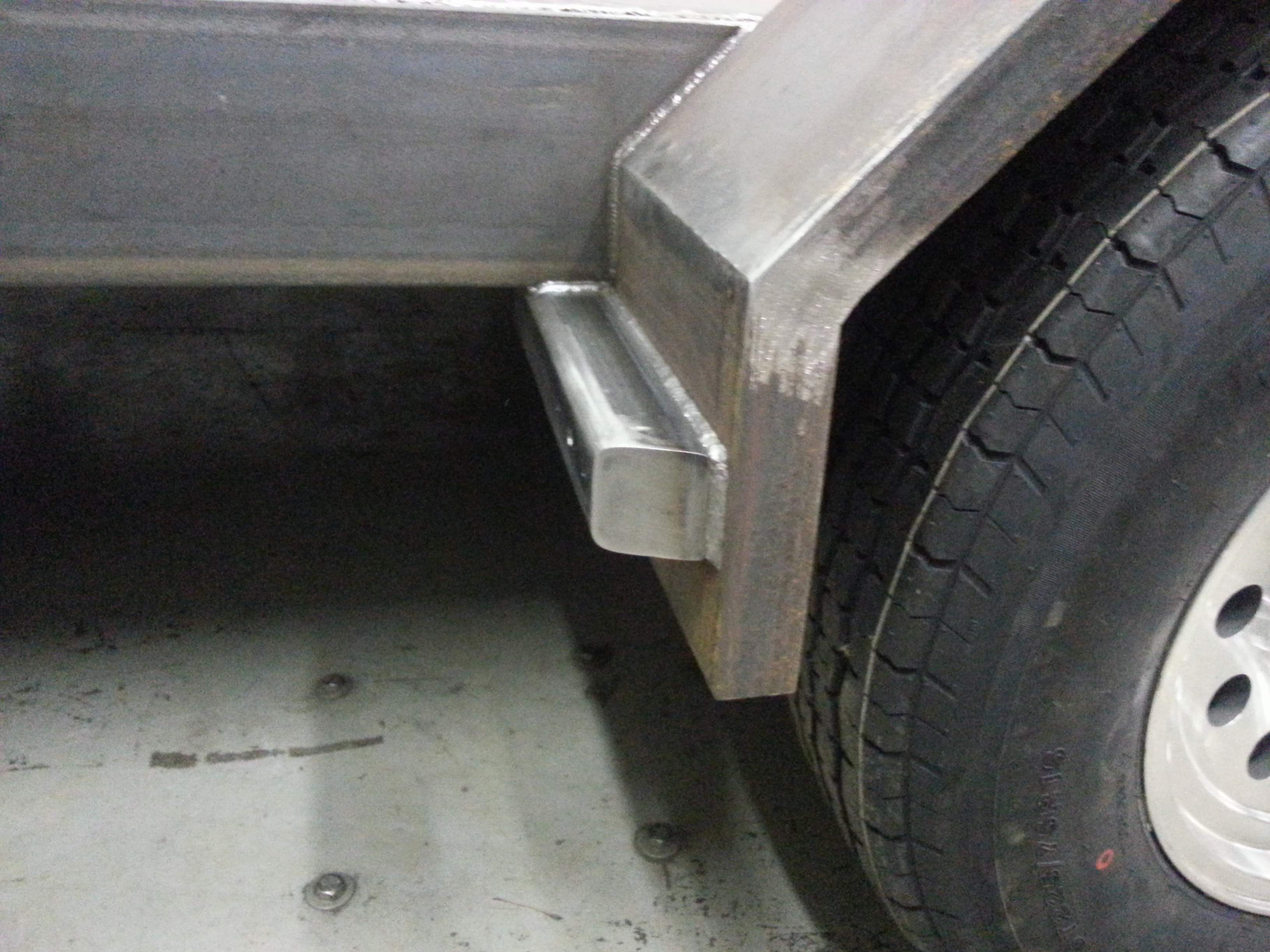

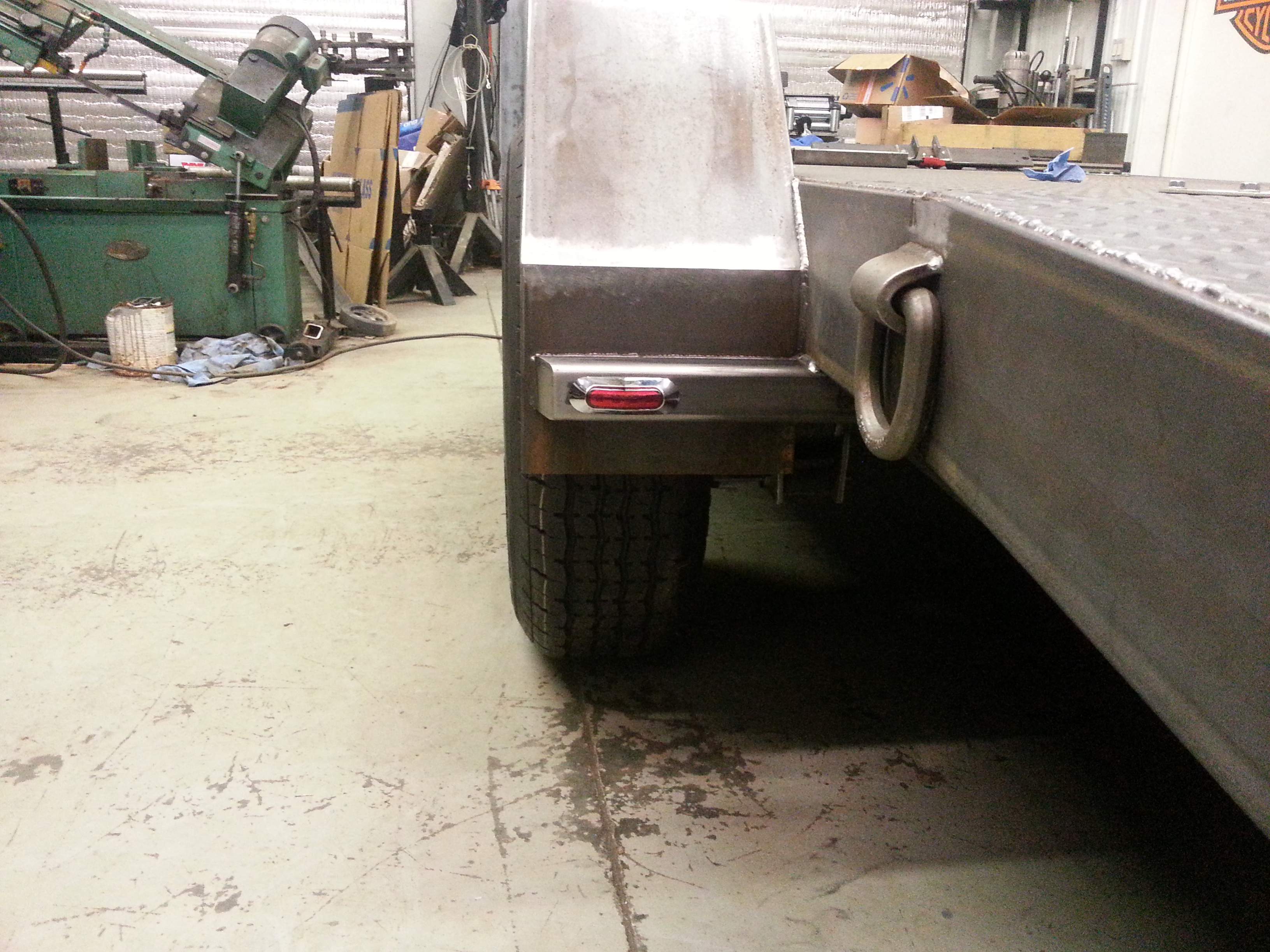

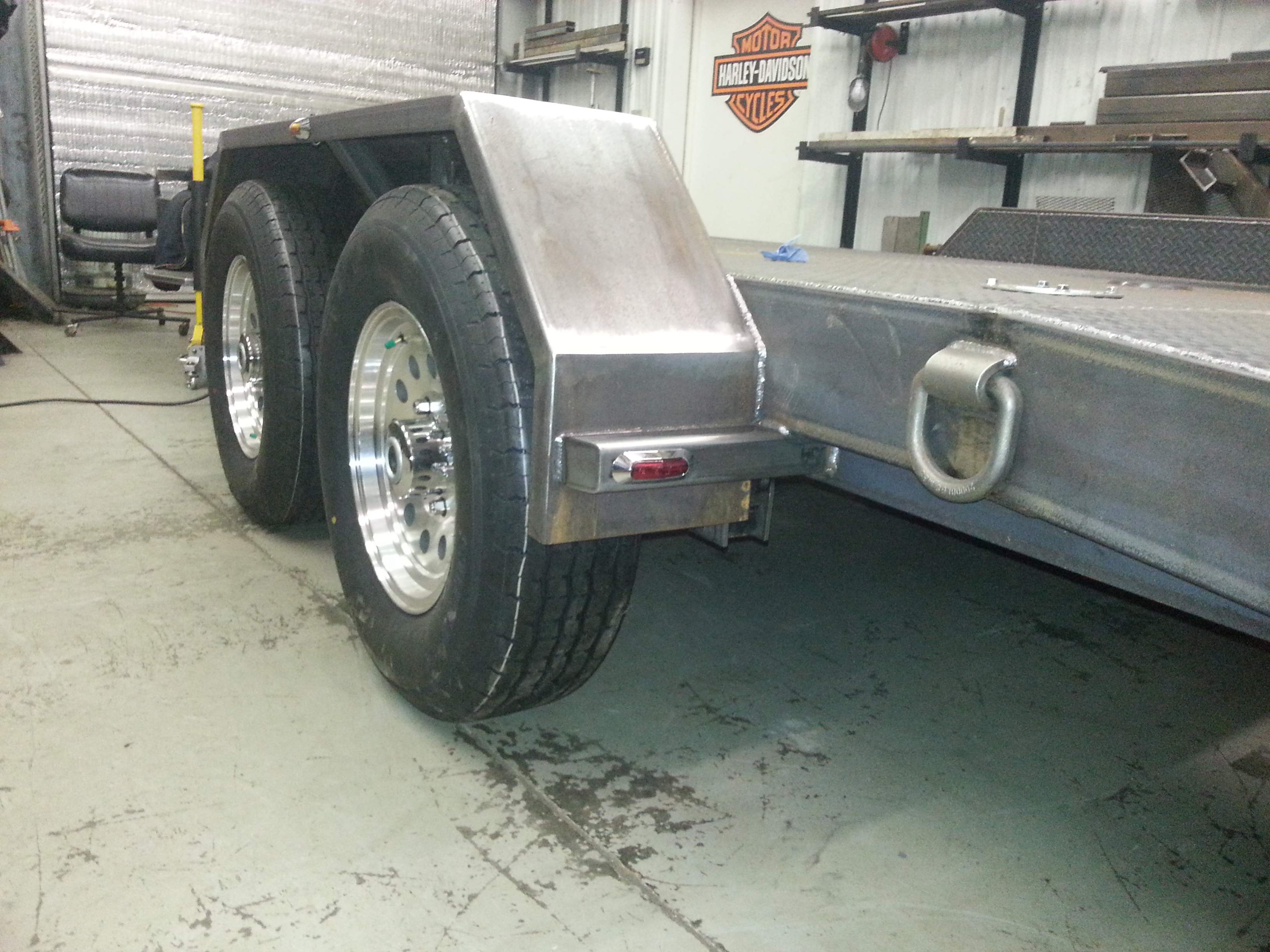

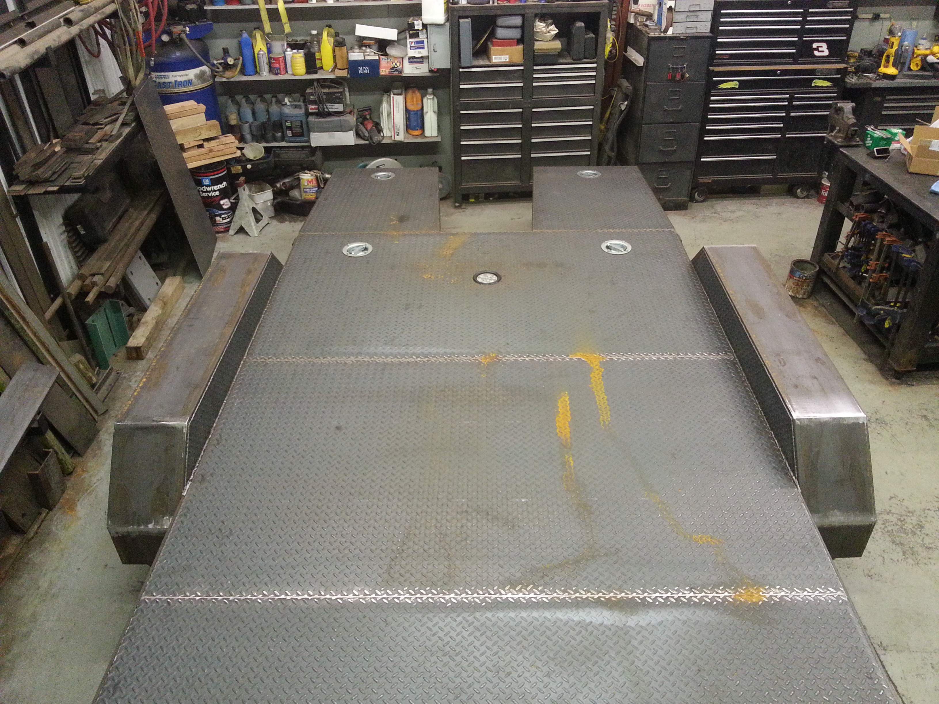

More pics of the set-up. It's still in the fab. stage, speak now if you see anything I've missed or need to do different. (That's just an old ball in the hitch to see what it looks like). It seems really strong, i'm thinking it will work fine for what it's intended for. Its legal in ky to tow tandem trailers. Again, if anyone see's any improvements or changes I need to make, let me know.

   / Split-dovetail car hauler trailer #105
Yes, every state has it's own law about tandem towing, I think it's legal in your state.
I've never checked to be honest because I never had the desire, I just heard it was illegal, of course that was probably 20 years ago our so. I see tandem semis a lot though, I guess I assumed it was some sort of exception or you had to have a special endorsement. I can't say I've ever seen a pickup doing it here.

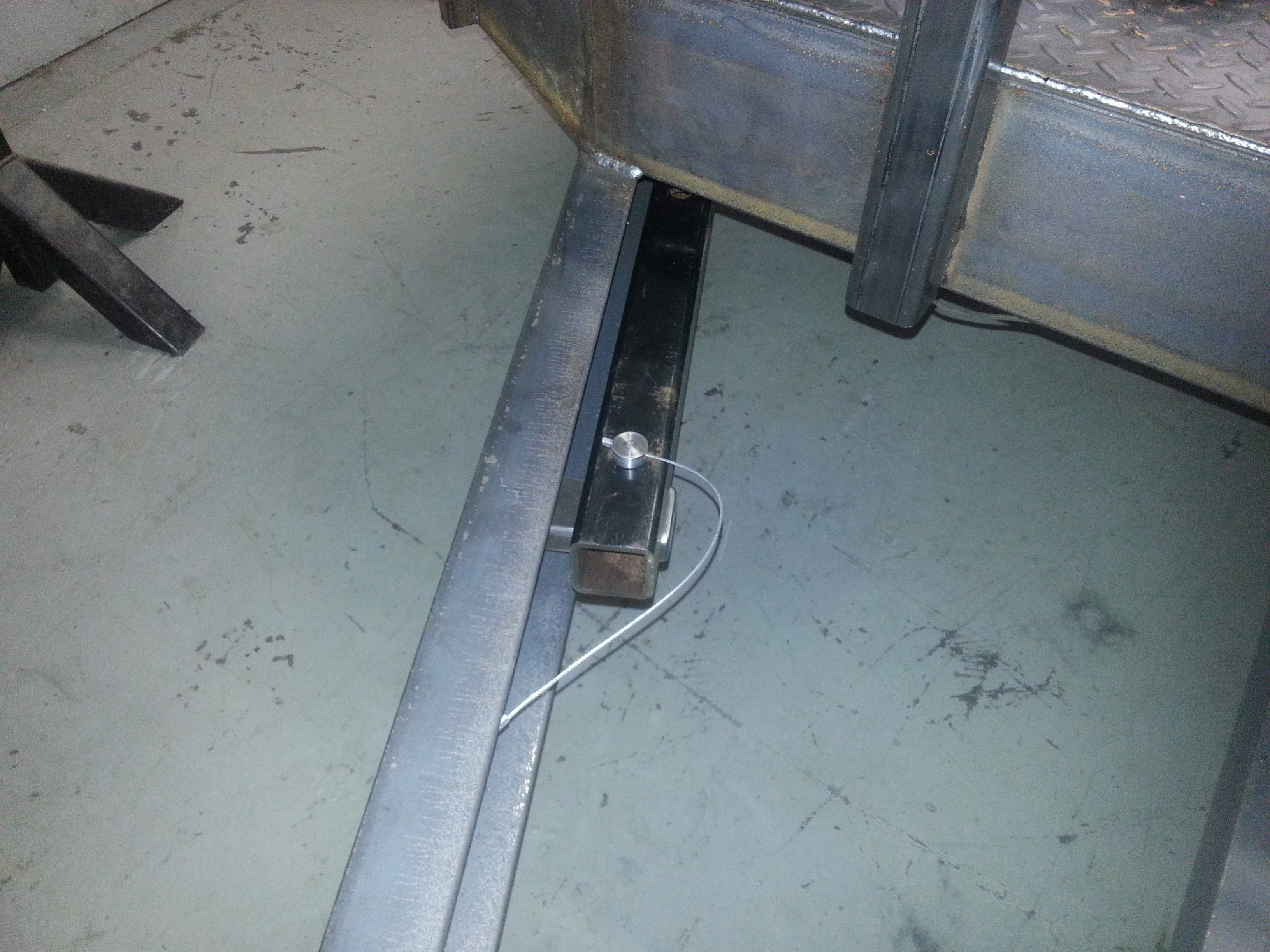

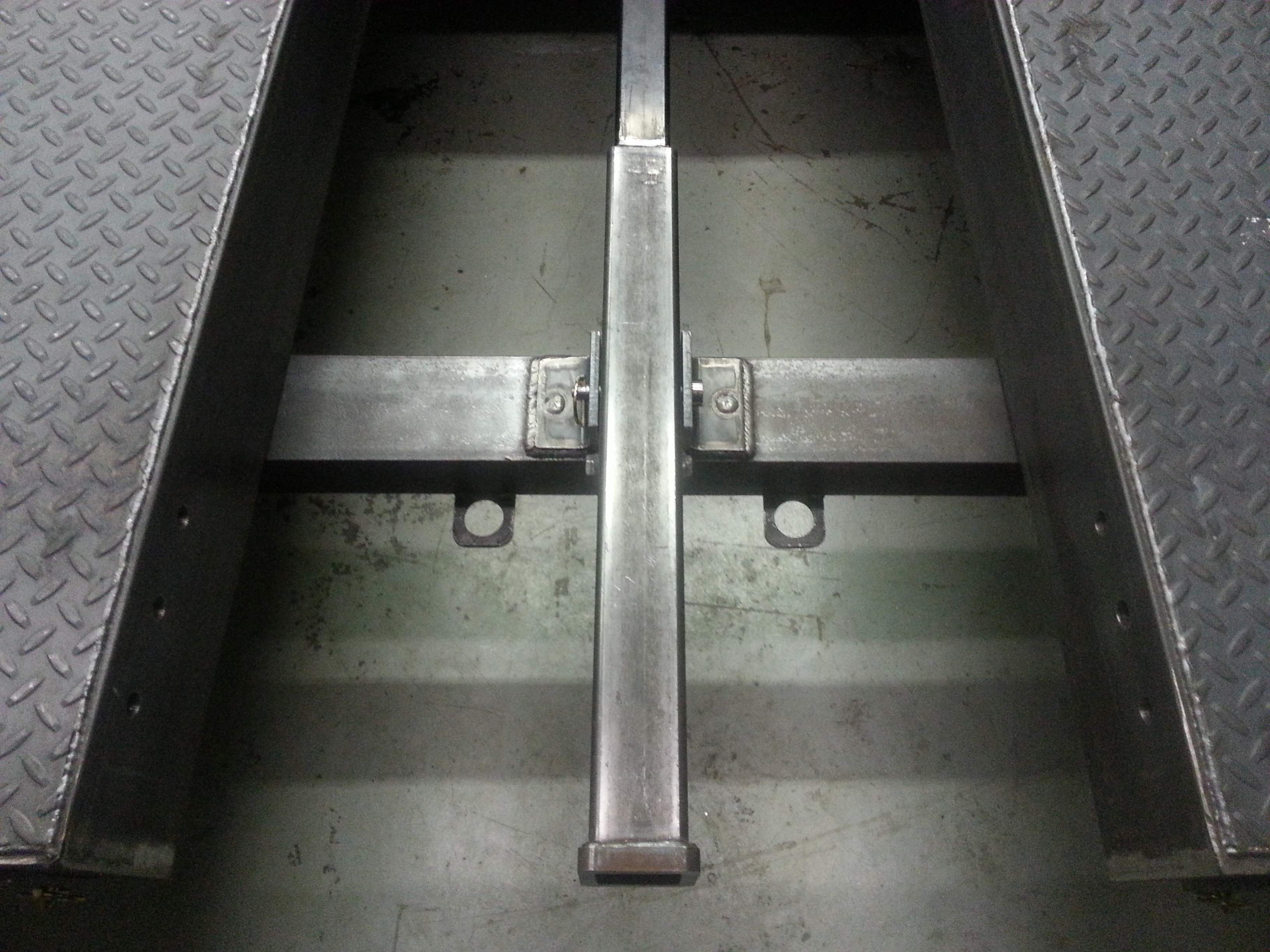

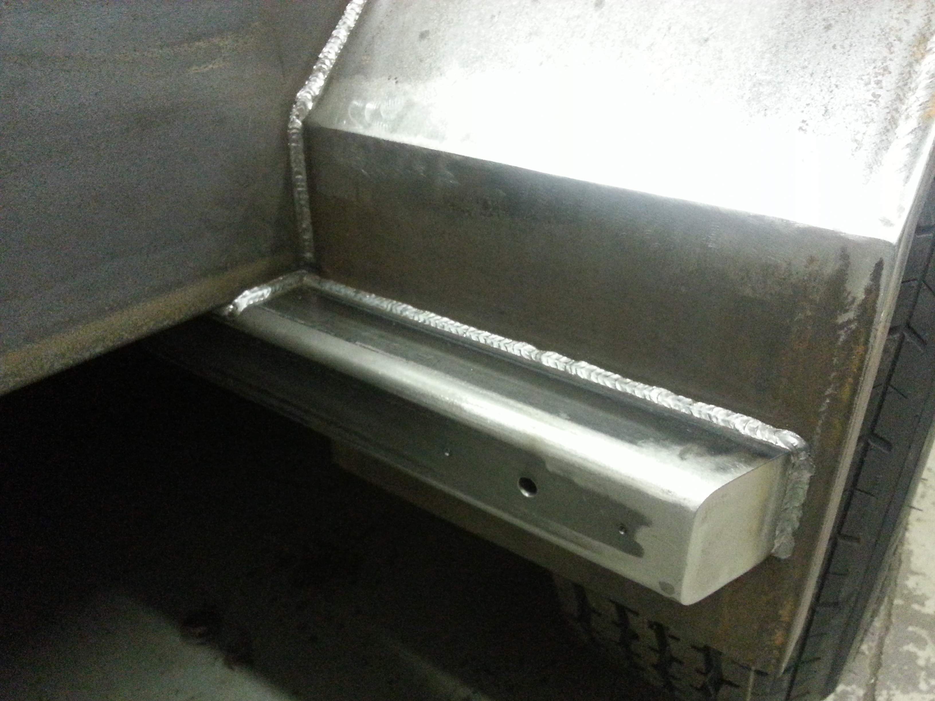

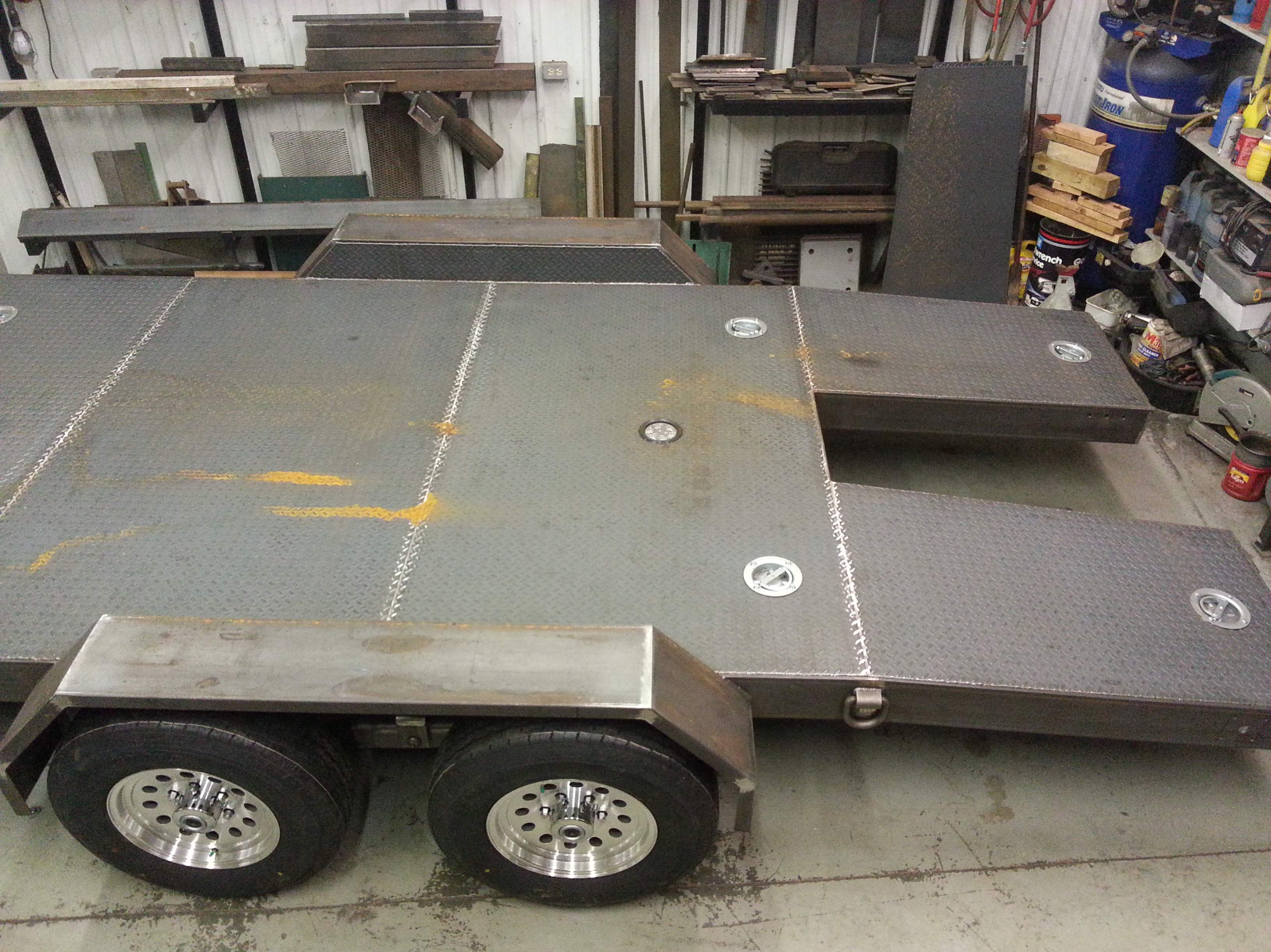

#106
The extension receiver stores in its own place inside the frame rails when it's not in use.
Yep, you're legal as long as you don't go over 60', i'm sure there's a weight limit too and more rules (as there should be) but it can be done.
   / Split-dovetail car hauler trailer #108
I have seen trailers that mount a swivel implement jack on each back corner. Swivels horizontal when not in use.
That photo shows a crank jack, but they make "drop leg" jacks that are even better to keep the back of the trailer from dipping -- you remove a pin, let it drop to the level desired, and then put the pin back in. Fast with no cranking. They come with a swivel mount too. Actually, there are weld-on swivel mounts that can be fit to any jack.
I used to use wood 6x6 blocks myself -- got in the habit of having blocks around for general rigging work, and they were convenient to stack under the tail of my trailer when loading/unloading. Threw them in the tractor bucket while transporting.
   / Split-dovetail car hauler trailer #109

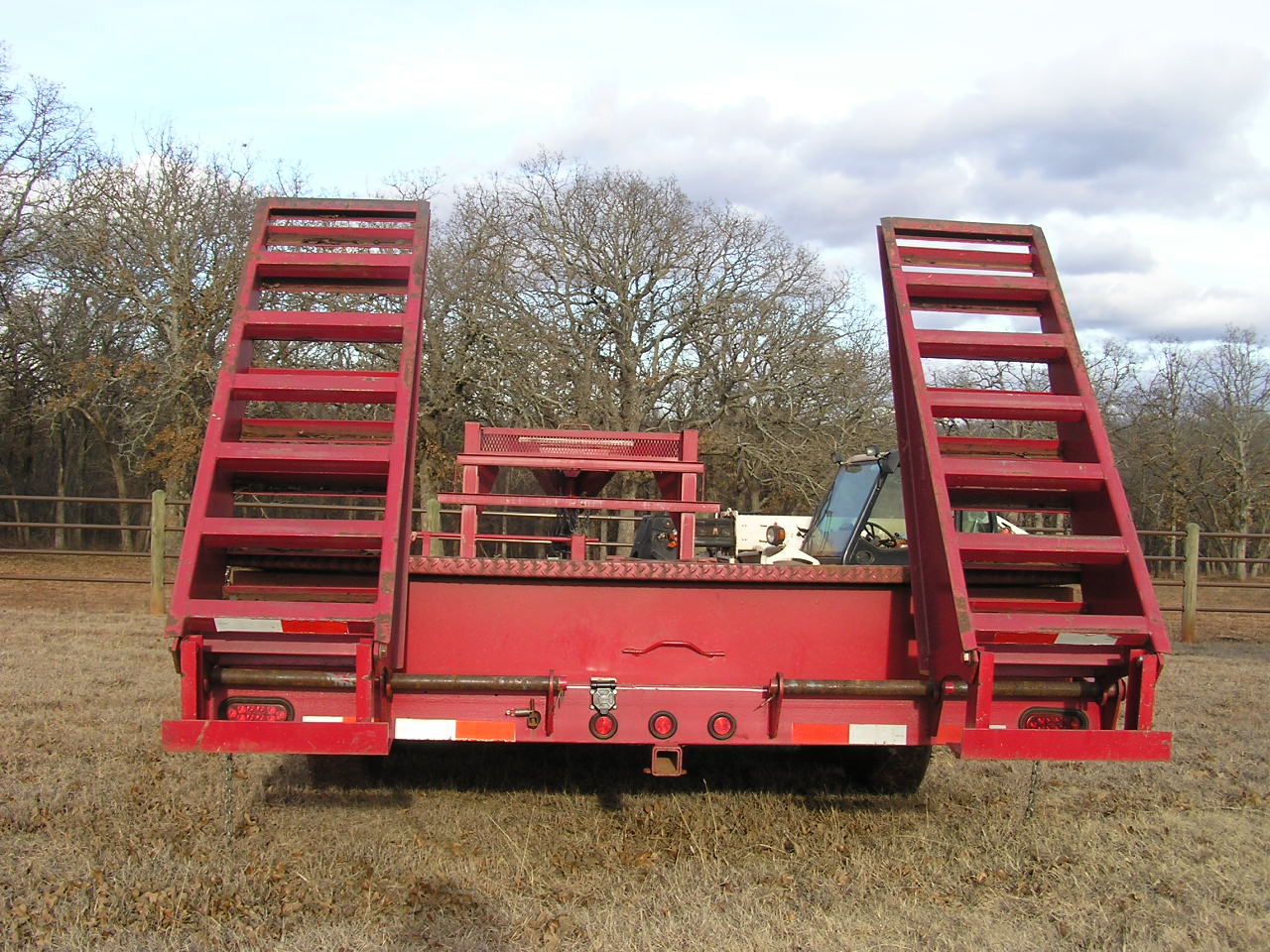

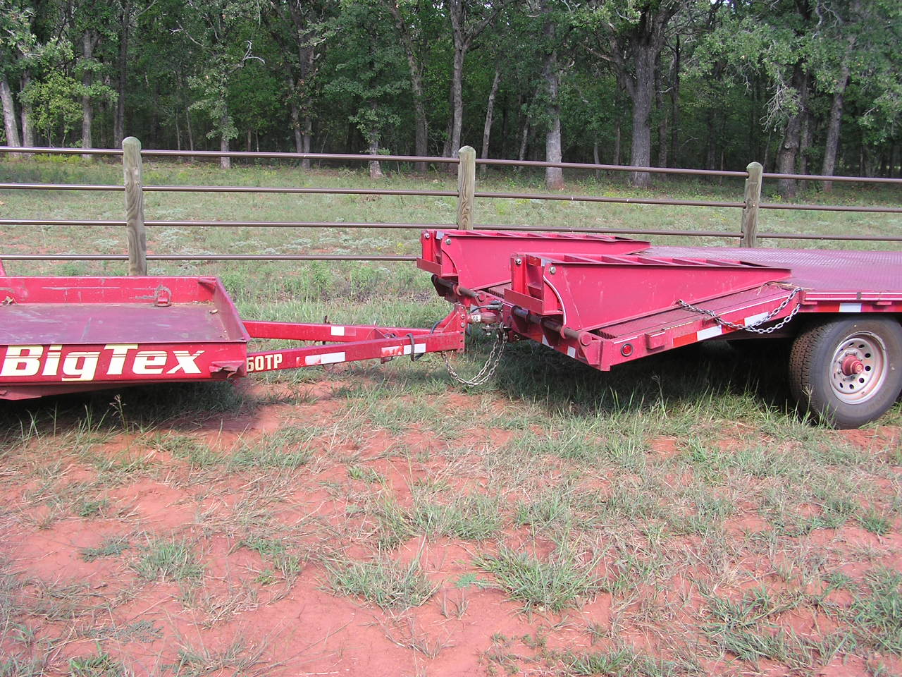

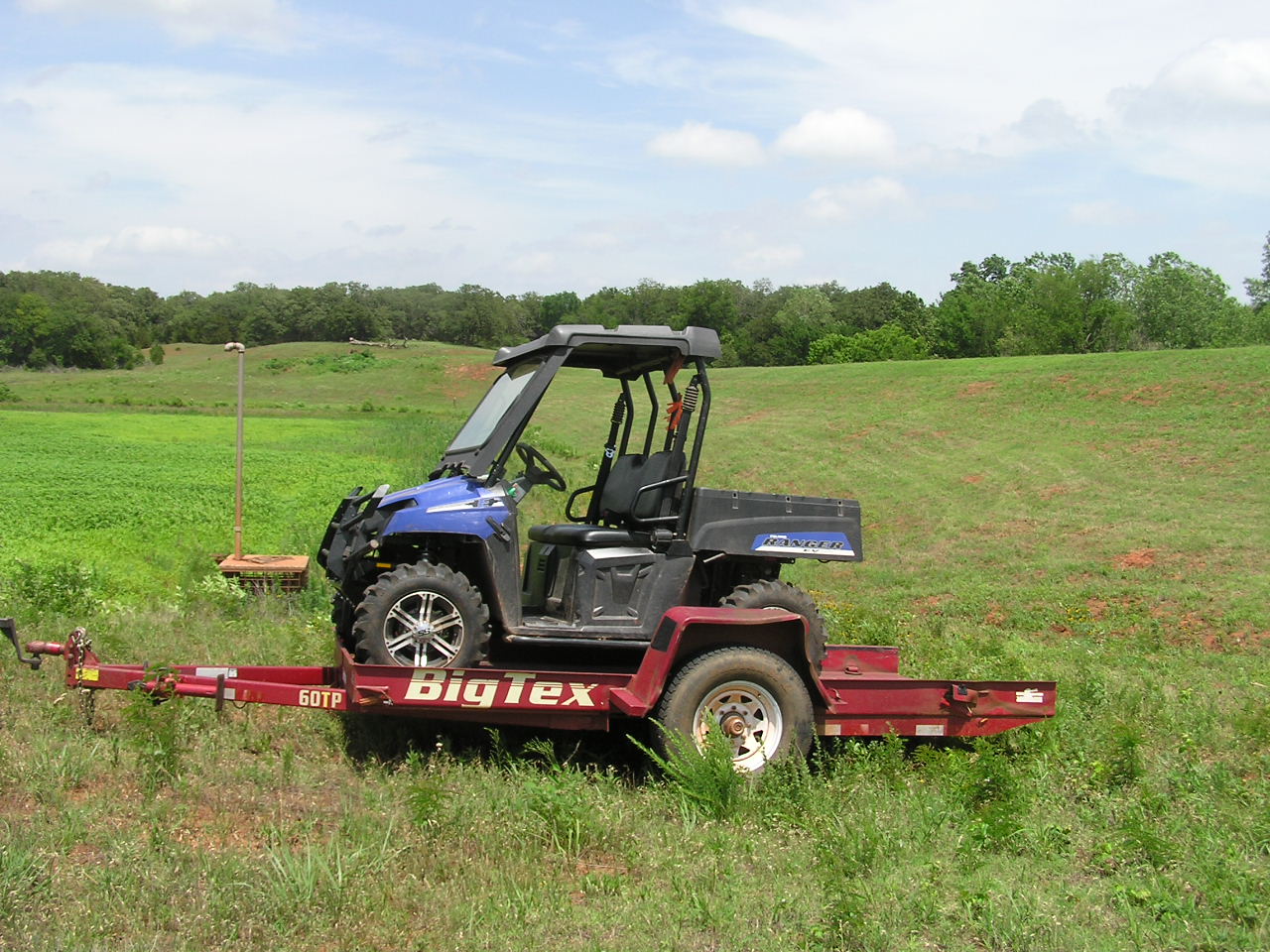

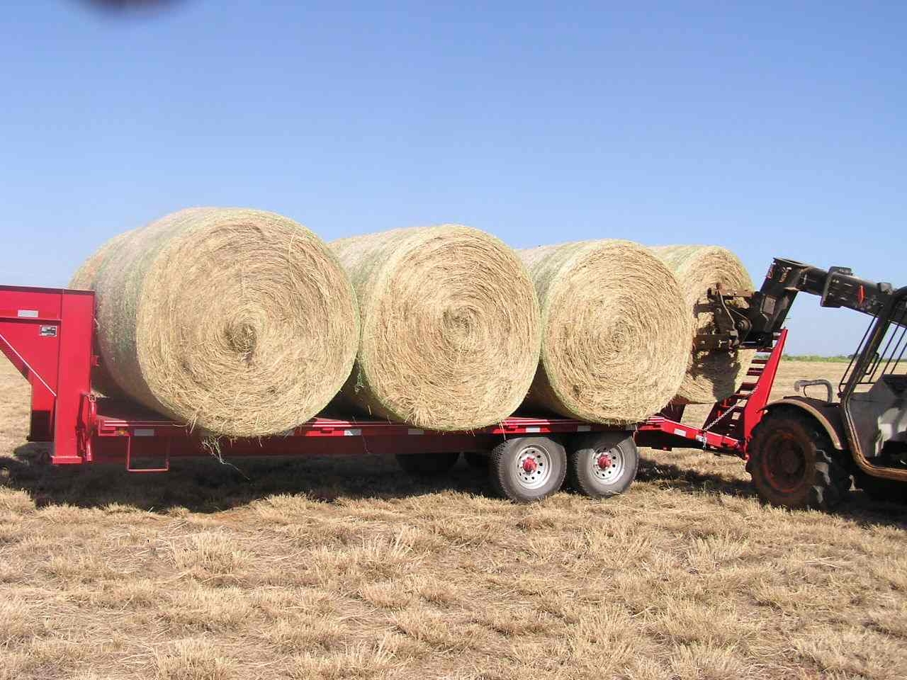

When I ordered my Delta trailer back in 2006, I requested a receiver hitch and trailer lights plug.
I have pulled the 12' tilt behind it a lot.
The main use was pulling a 16' deckover with 6, 5x6 round bales behind it and 8 bales on the Delta.
Picture taken in 2010, in the hayfield where we used to live.
With a Farm Tag on the truck it is legal to pull over width without a permit.
