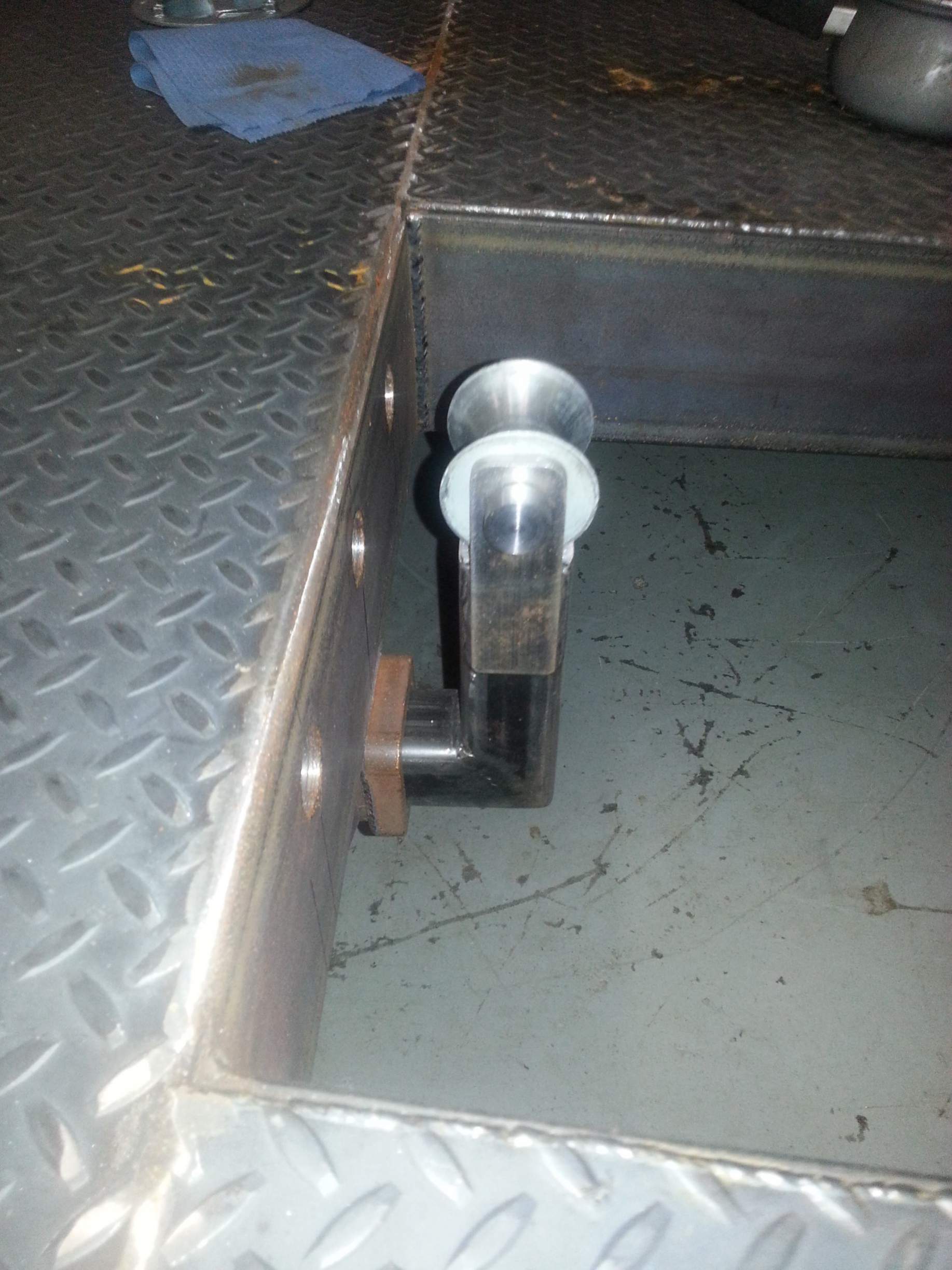

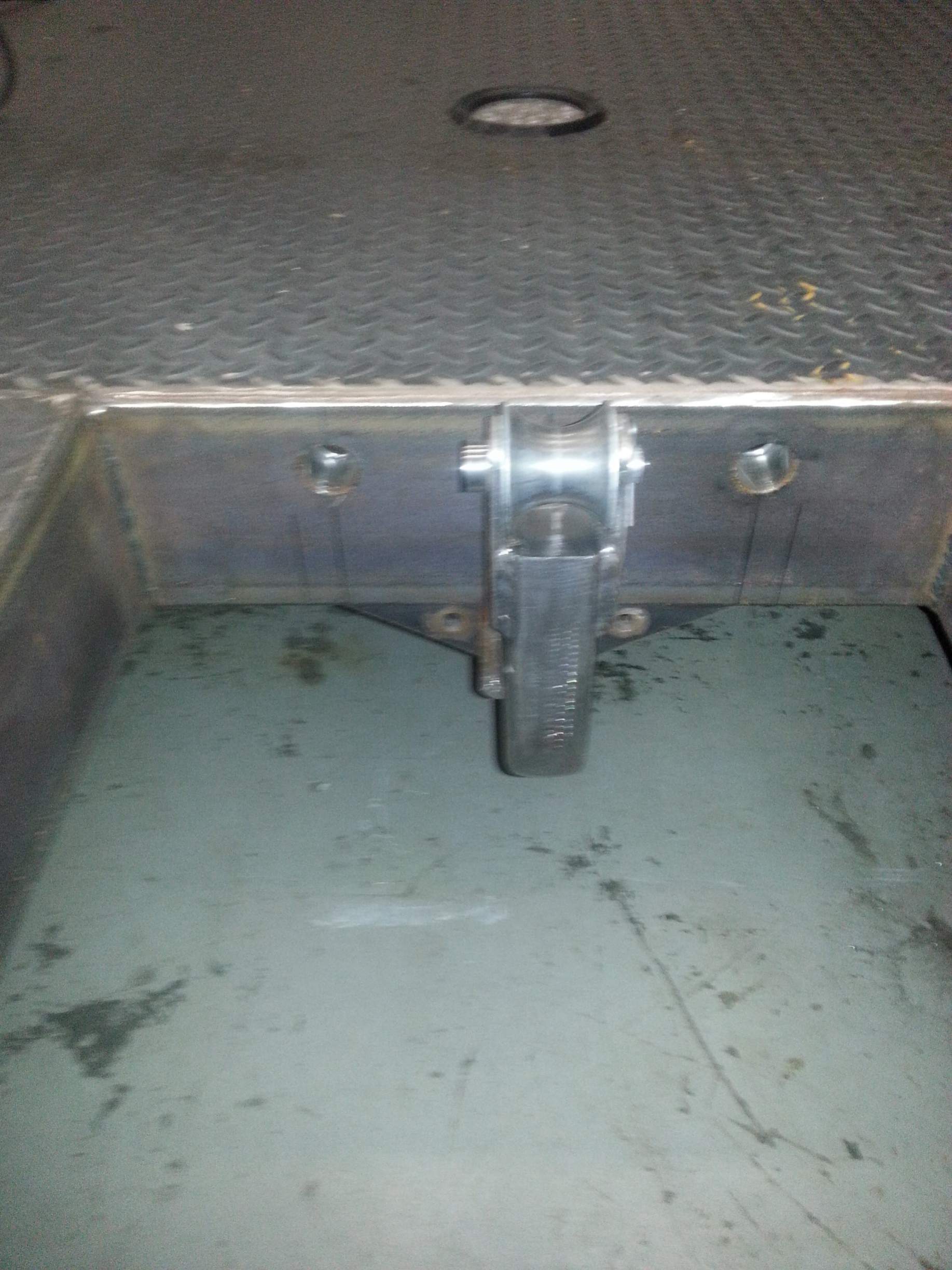

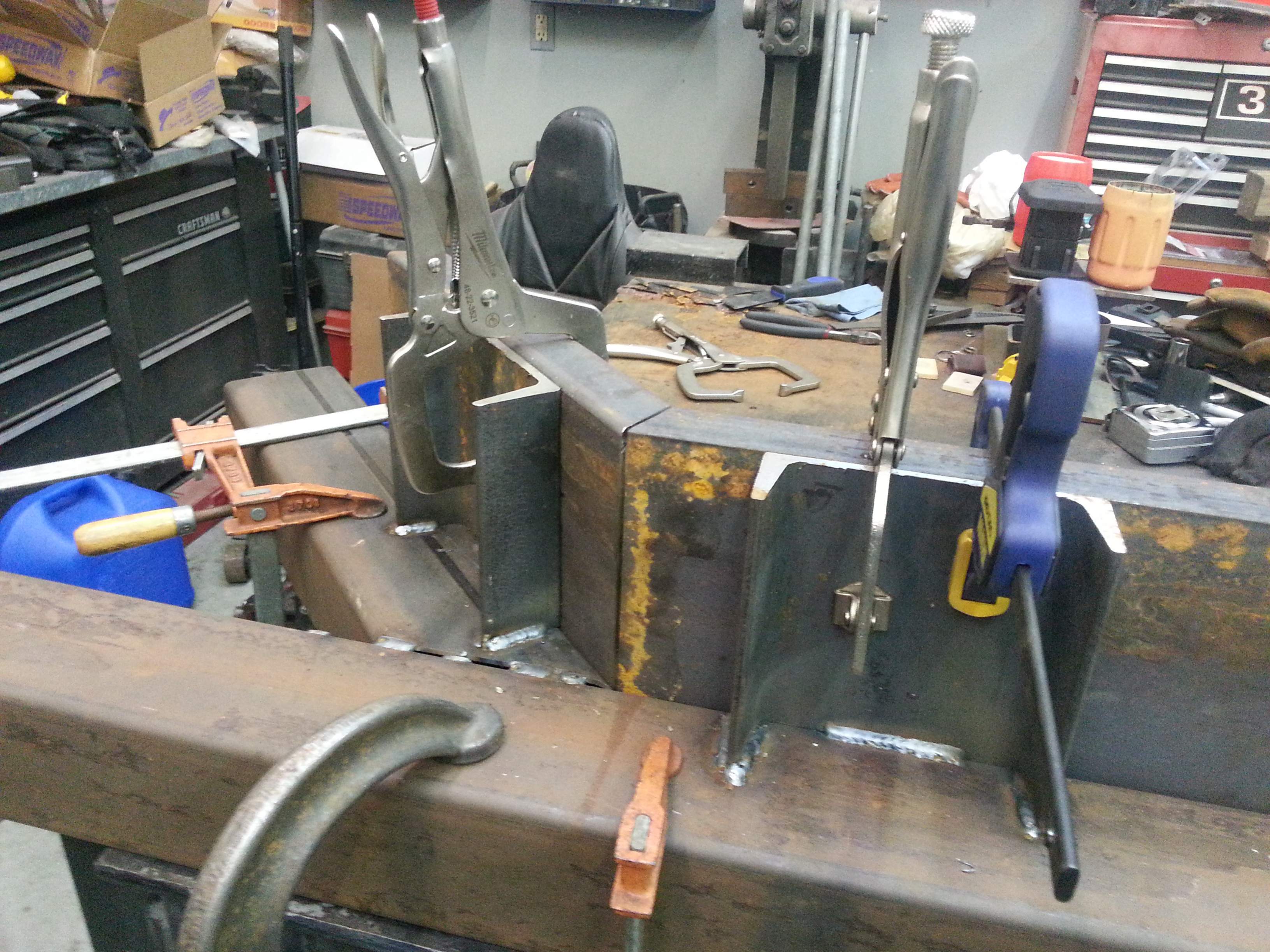

I've been working on some attachments for the hitch. Here's what I came up with for a winch cable roller

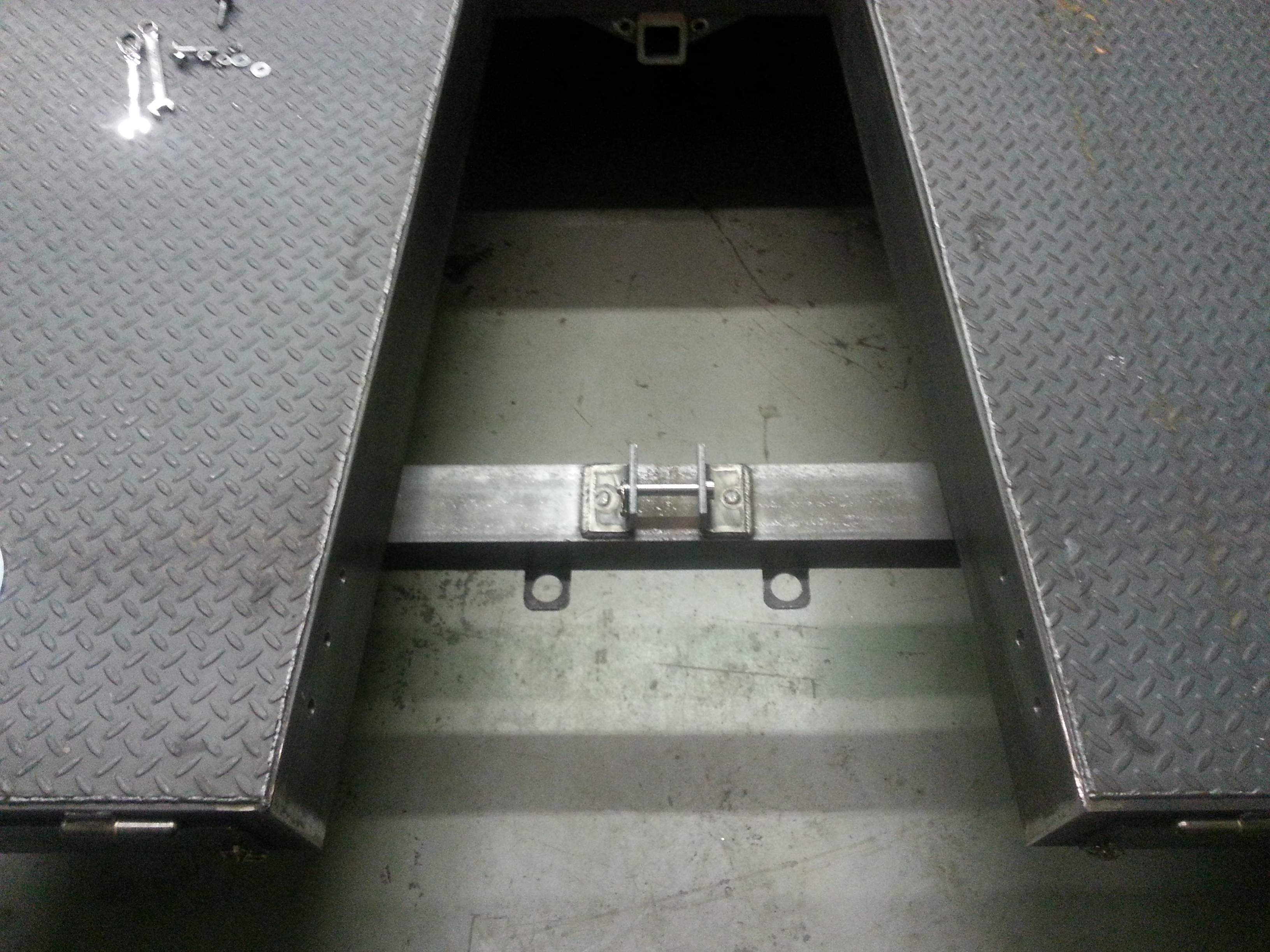

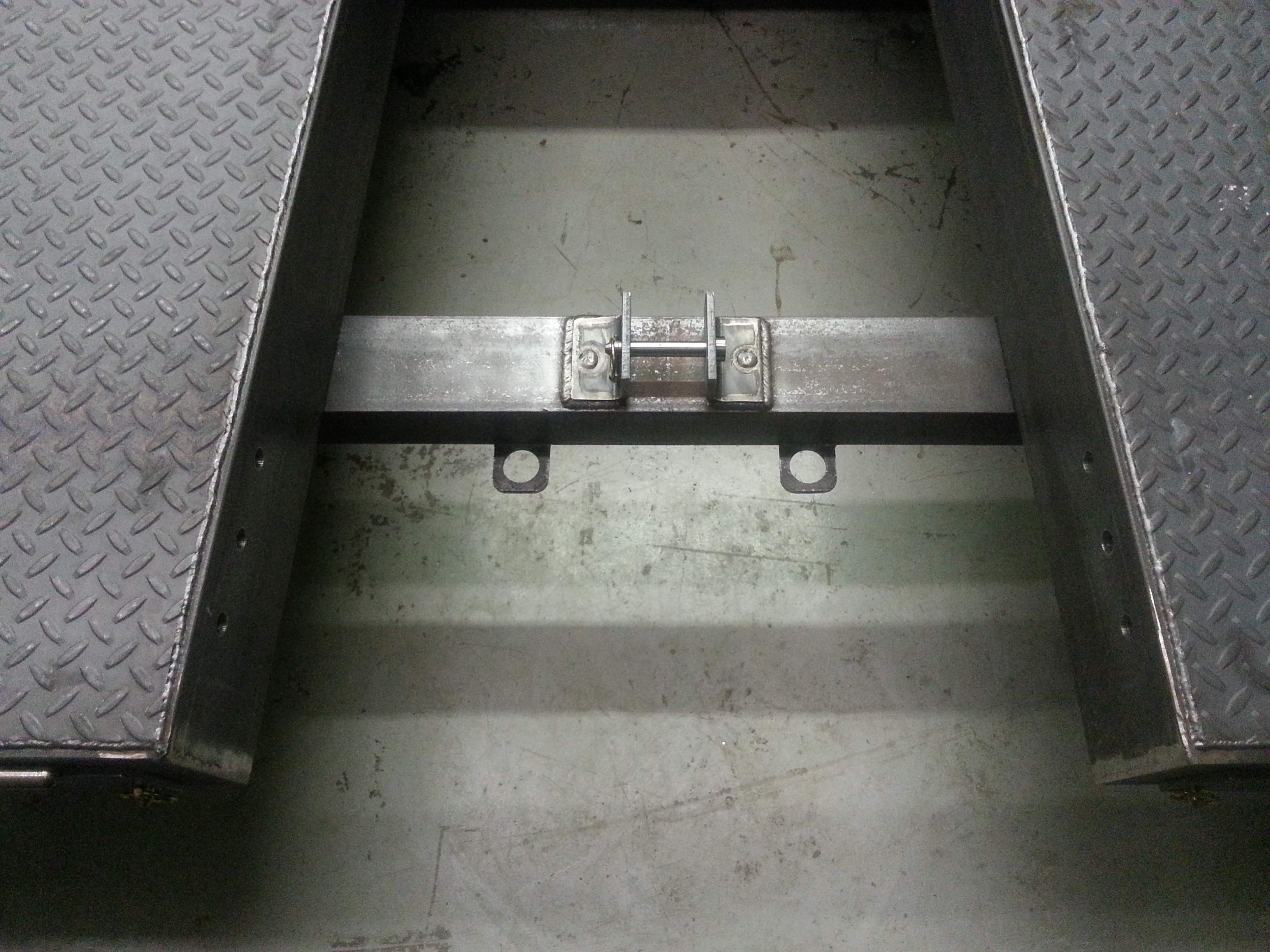

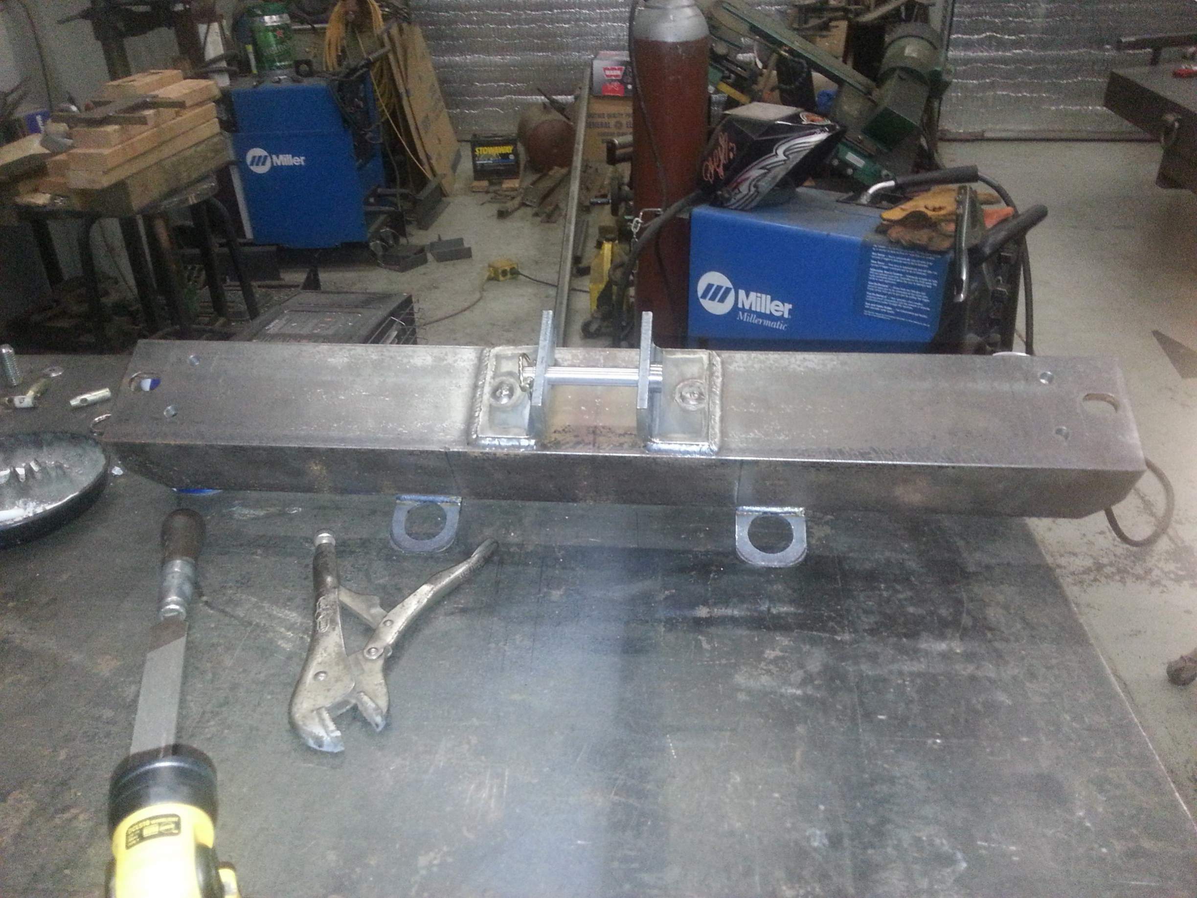

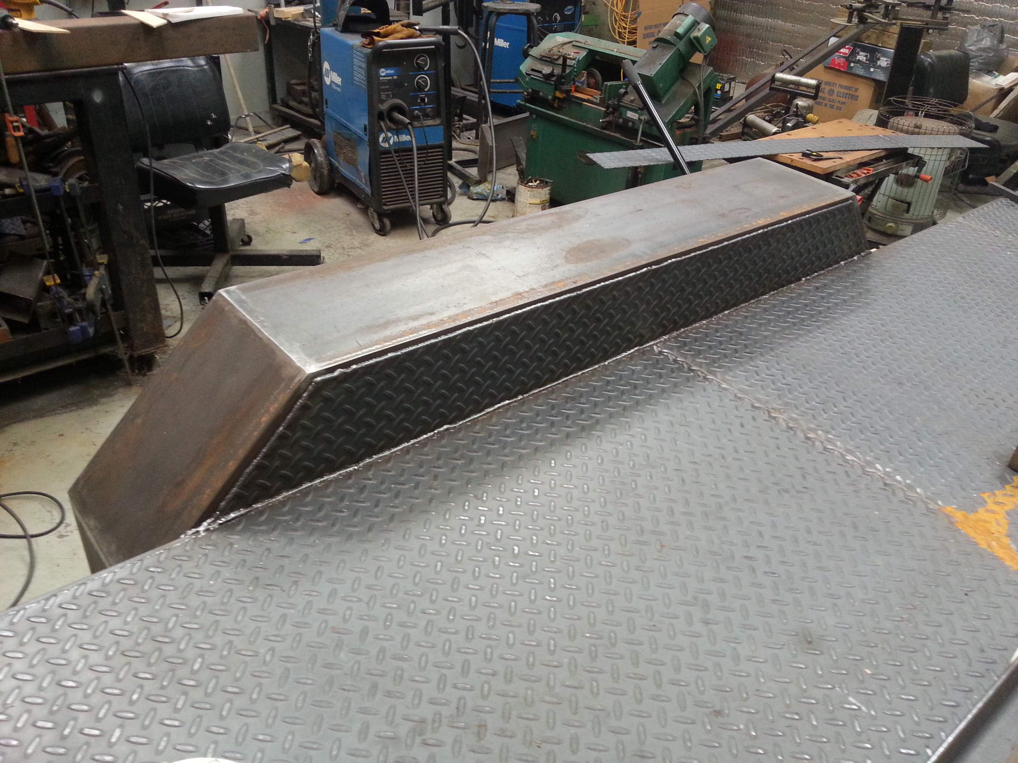

#92
A brace for another attachment. Can you see where i'm going with this one?

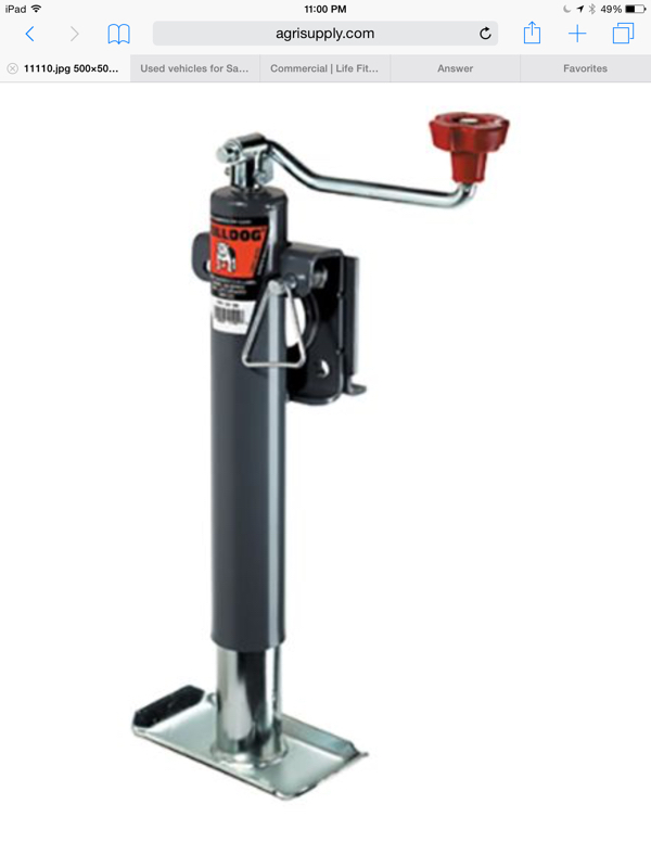

I have seen trailers that mount a swivel implement jack on each back corner. Swivels horizontal when not in use.
That's a good idea, I just hate the way they look on the back of a trailer.

#99
Here it is bolted between the dovetail. I used four grade 8 bolts, bolted in from the bottom. I also made the pins in my lathe (pin in the winch roller also) I turned them down from bigger grade 8 bolts and drilled them with a drill press.

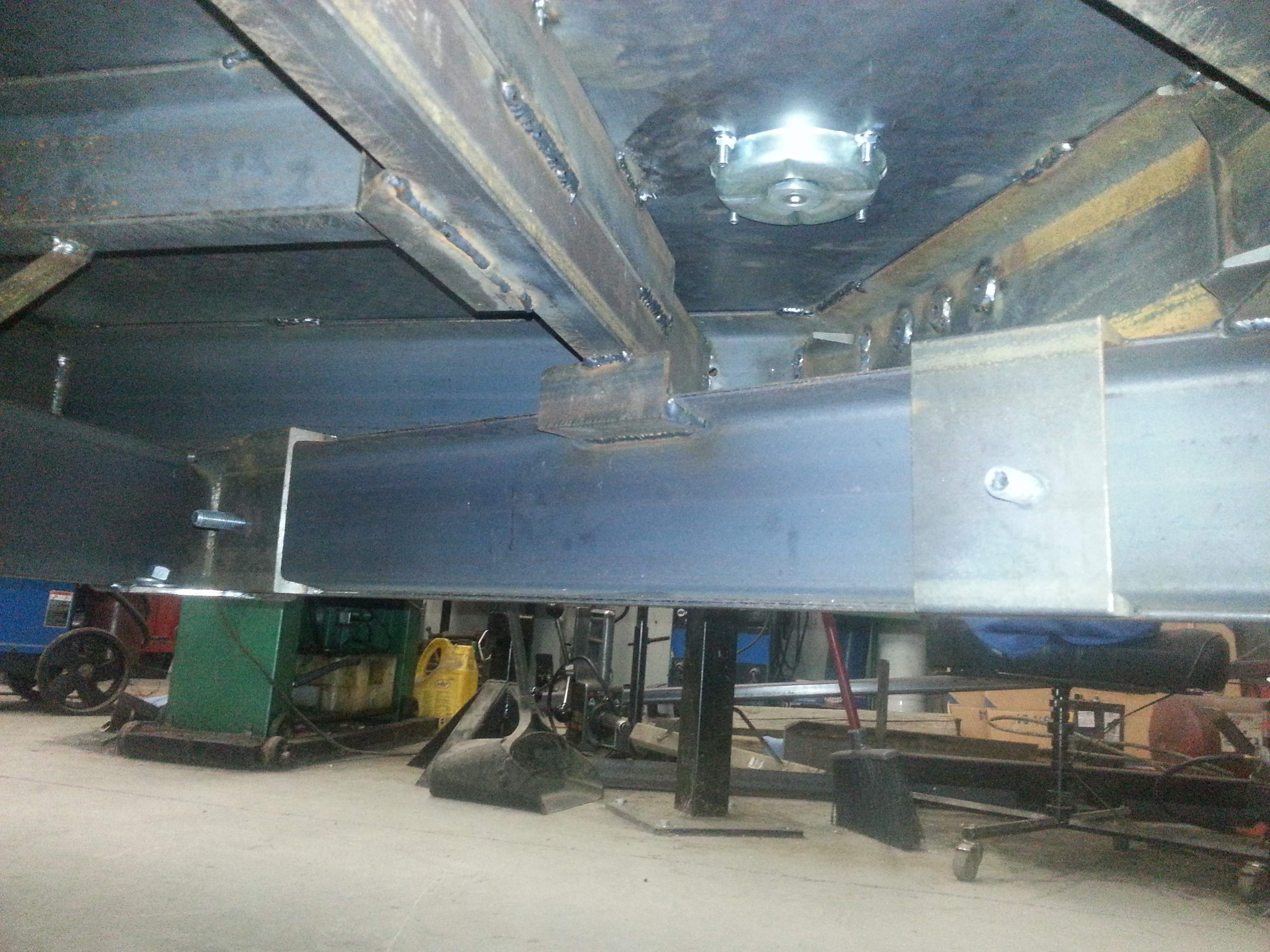

#100
When not is use (most or probably all of the time) it stores out of the way under the front part of the trailer.
