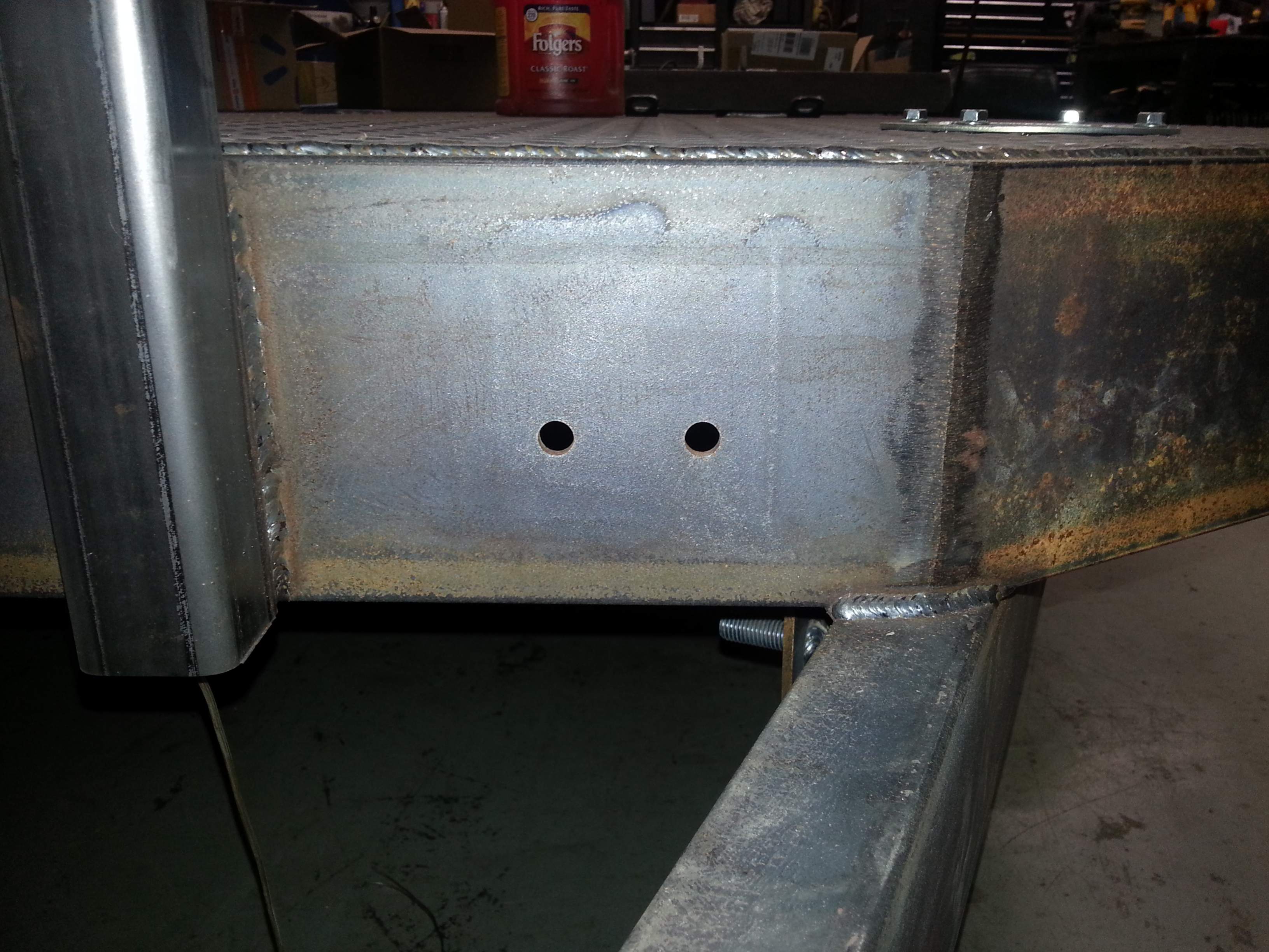

Holes for the toggle switches for the winch and bed lights.

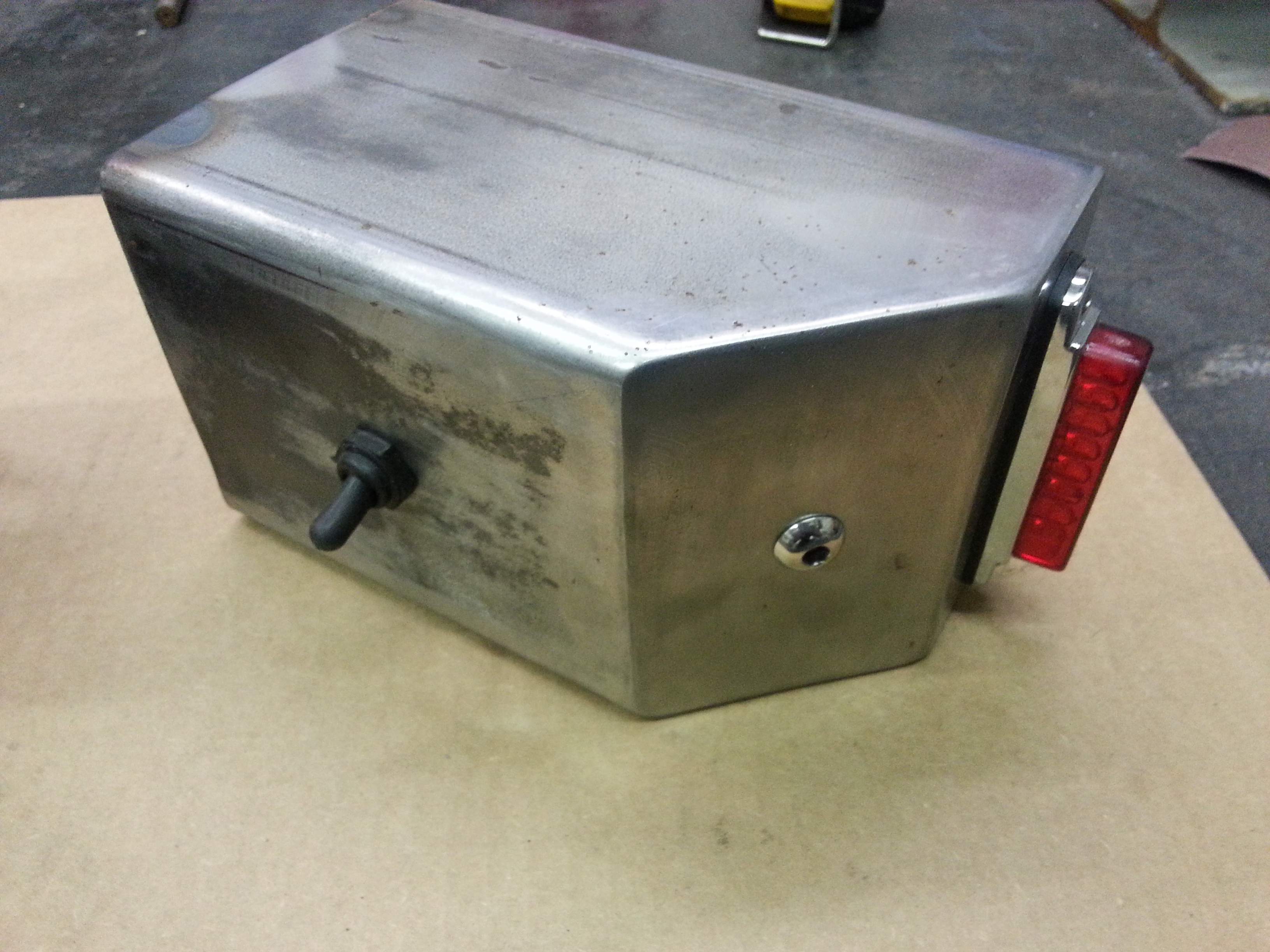

Toggle switch on the back of driver's side tail light for the ramp lights. All three of these "switched" lights will be wired to the onboard battery.

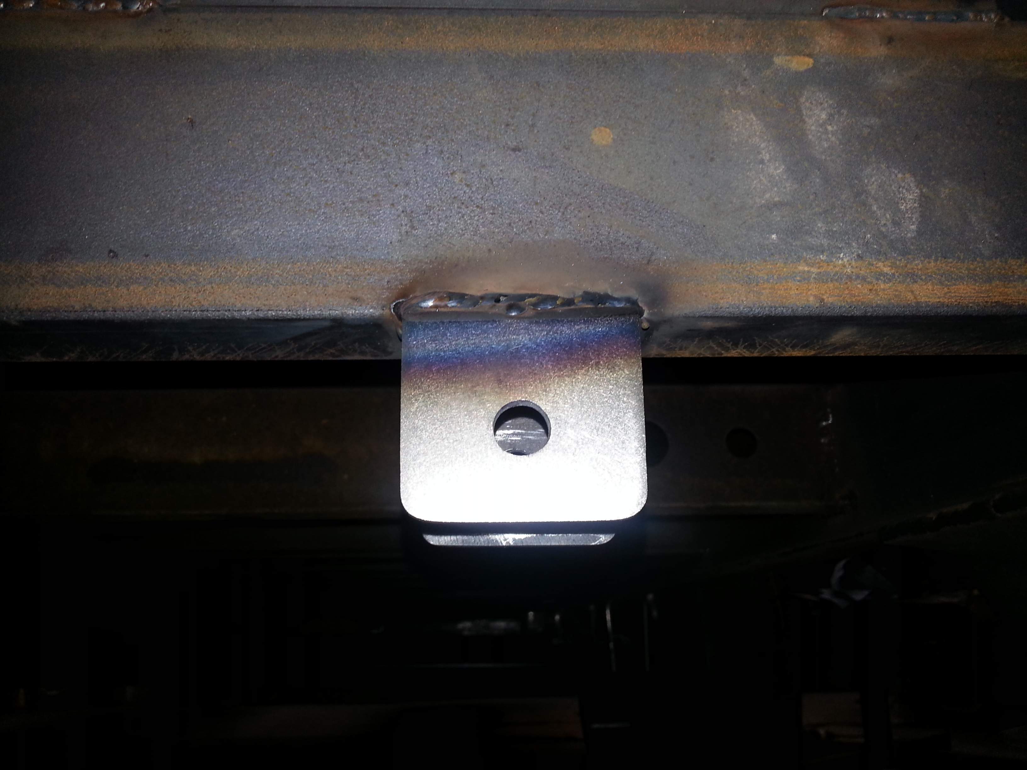

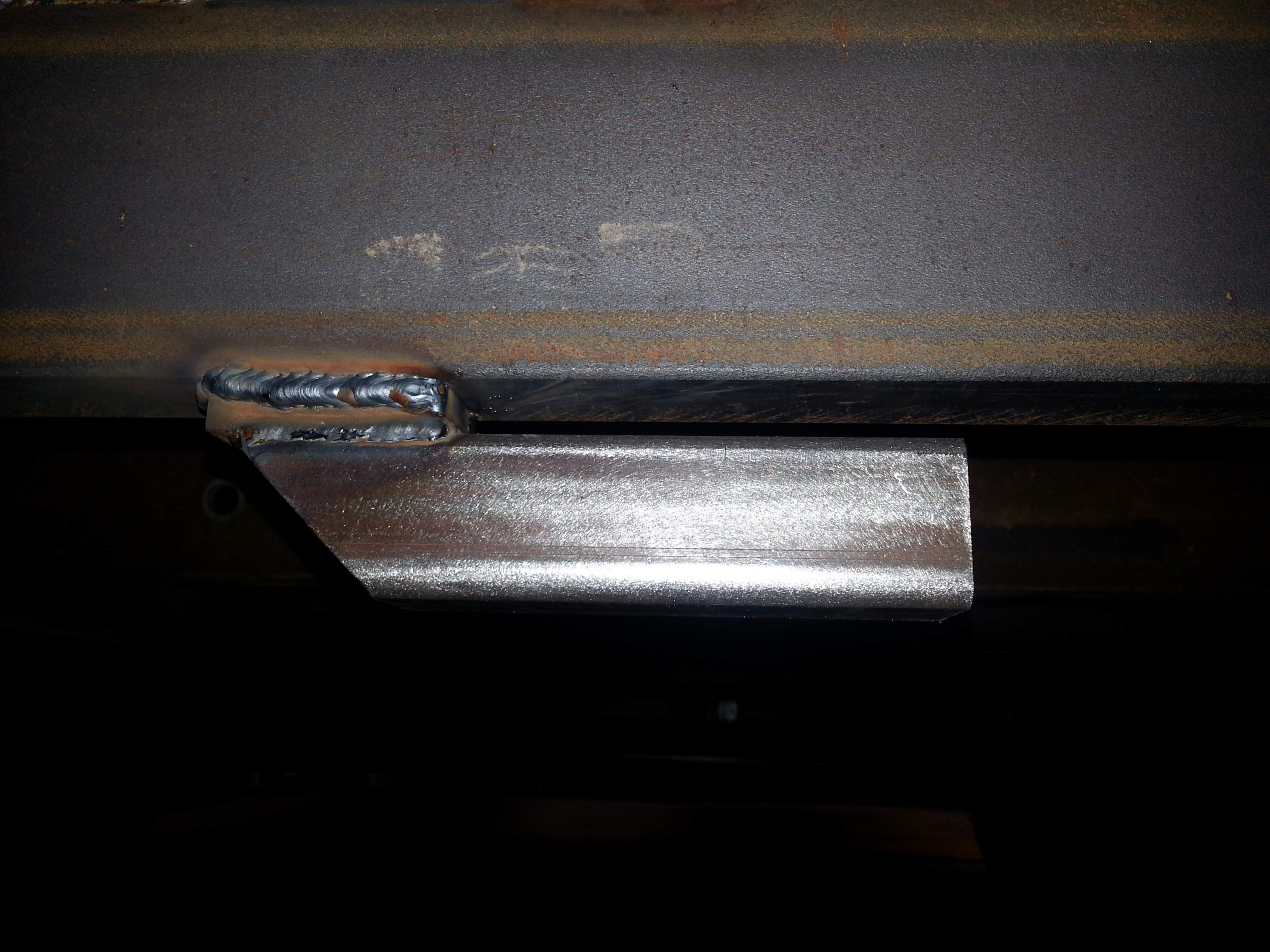

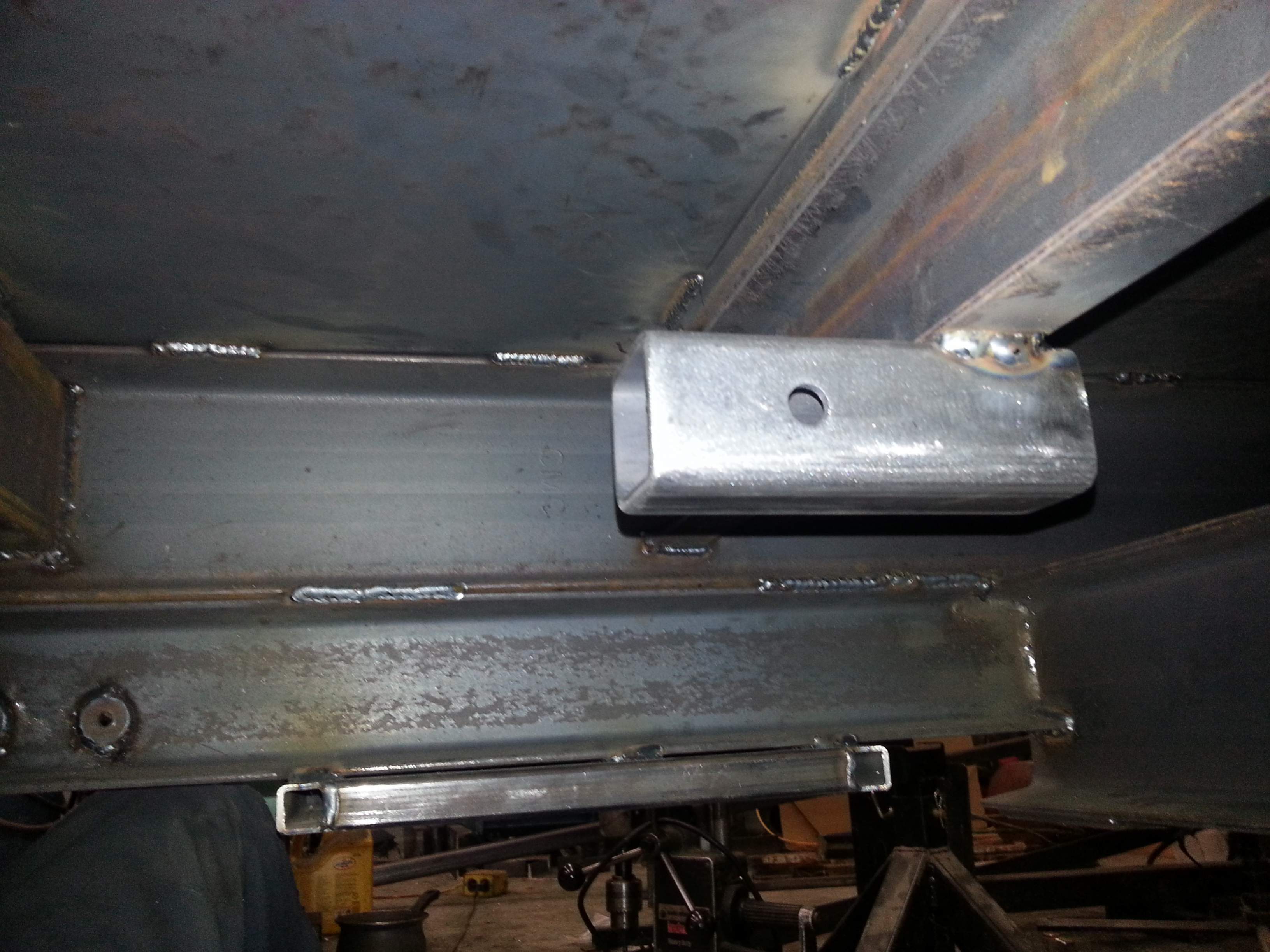

#173

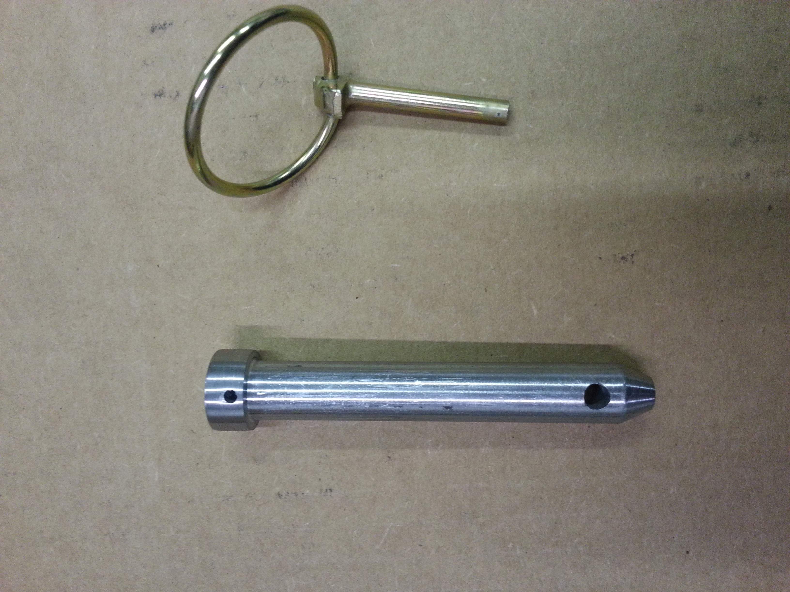

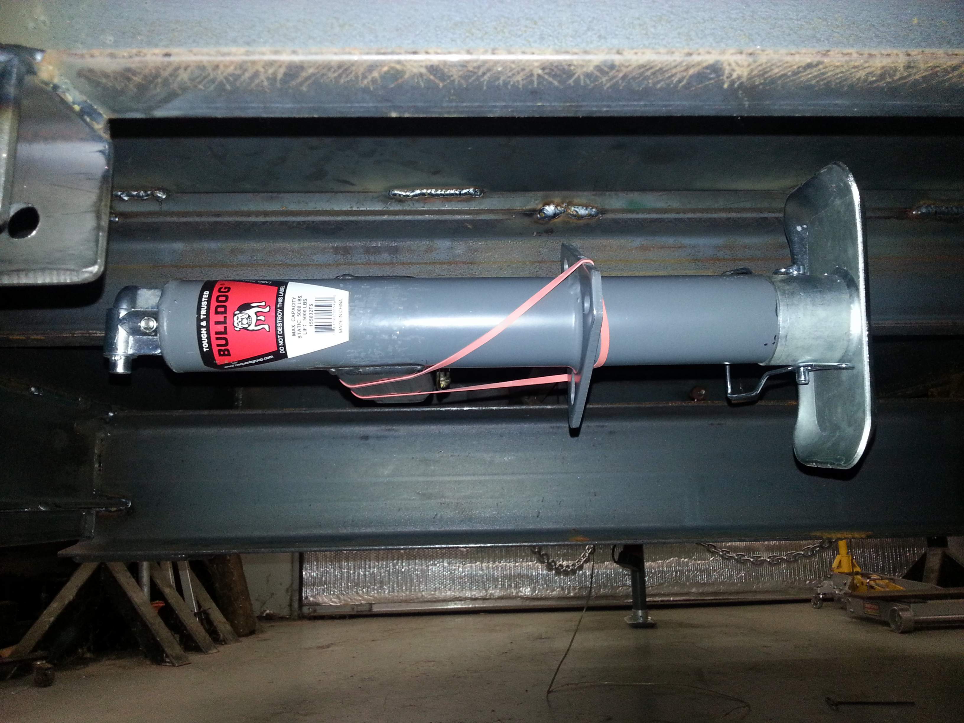

Mount to store the jack underneath trailer when not in use. The rubber band is to keep the handle from flopping around. It uses the same pin as when its in use.

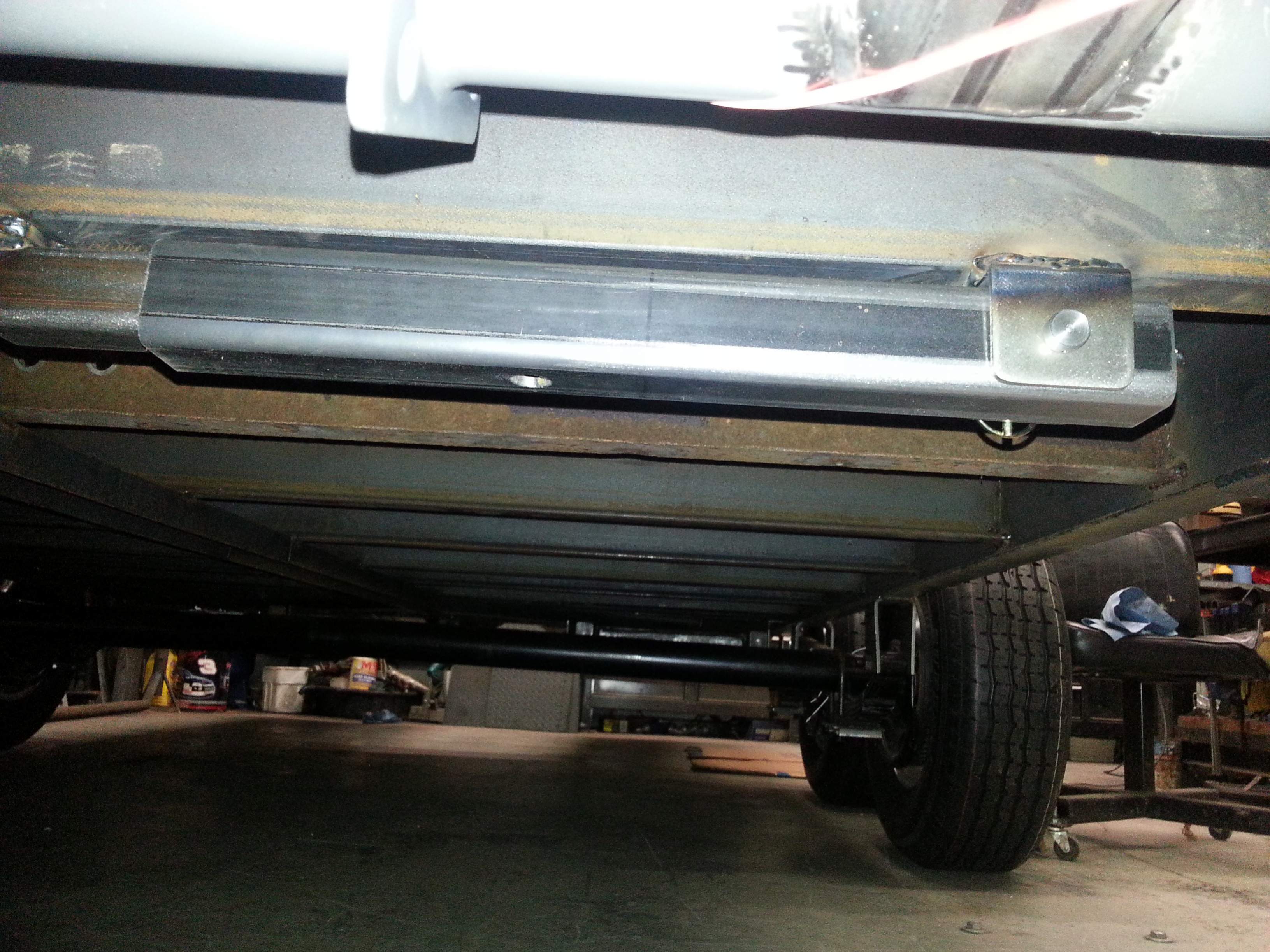

   / Split-dovetail car hauler trailer
#174
Mount and pin I made for the short jack extension.

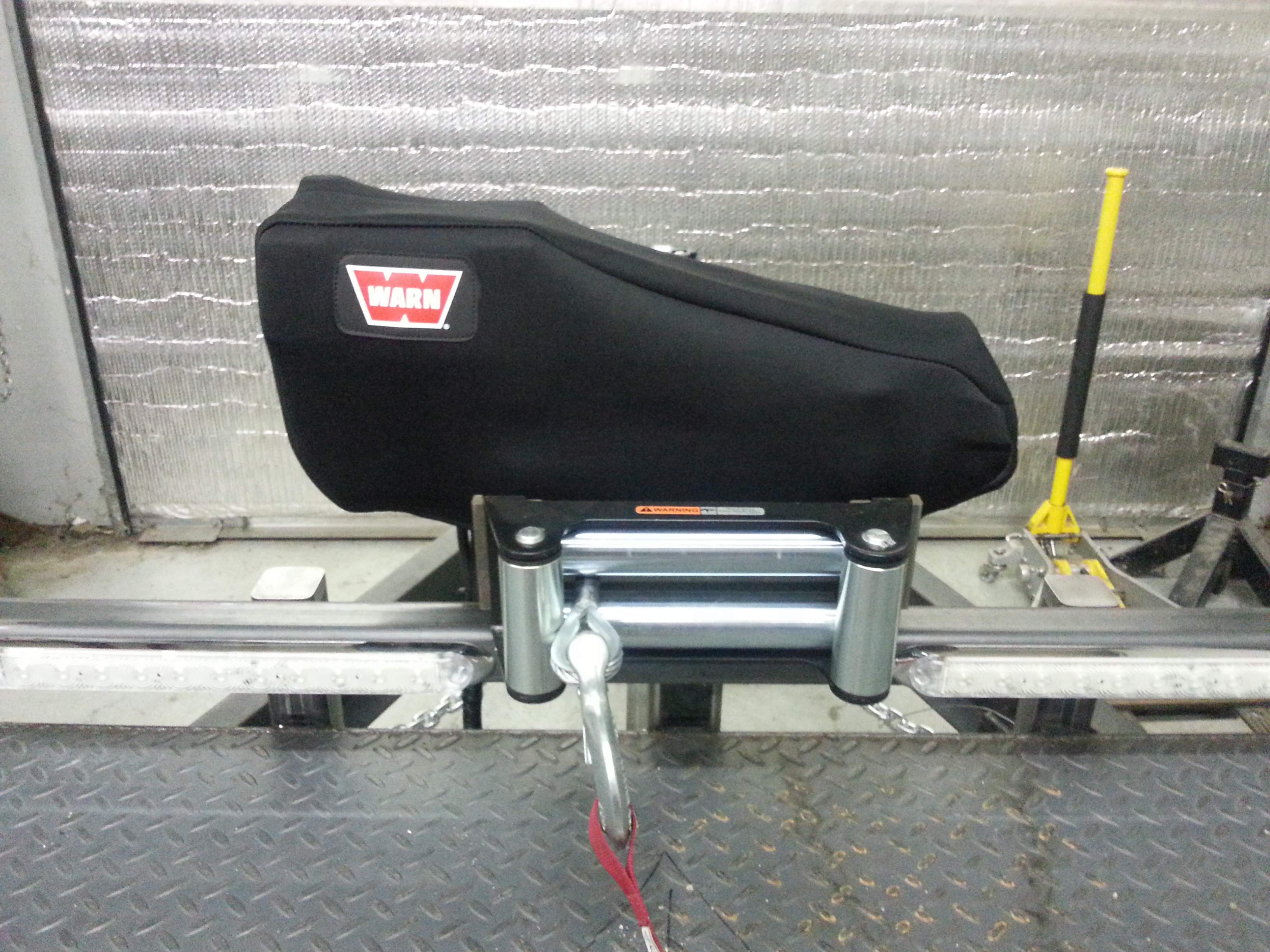

The winch cover I ordered came in.
   / Split-dovetail car hauler trailer #177
There are more gadgets under this trailer than on top of it. Very nice work.
