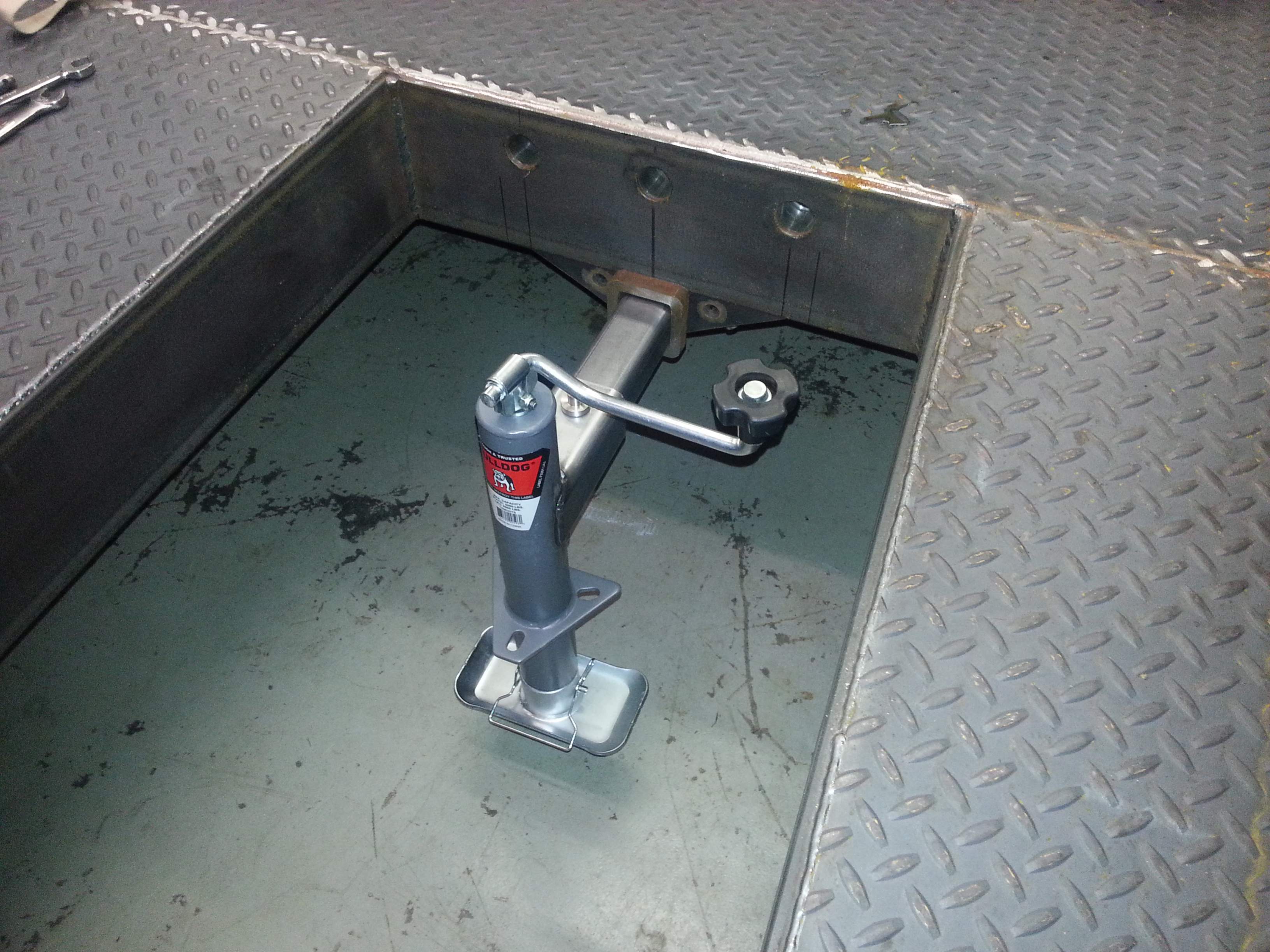

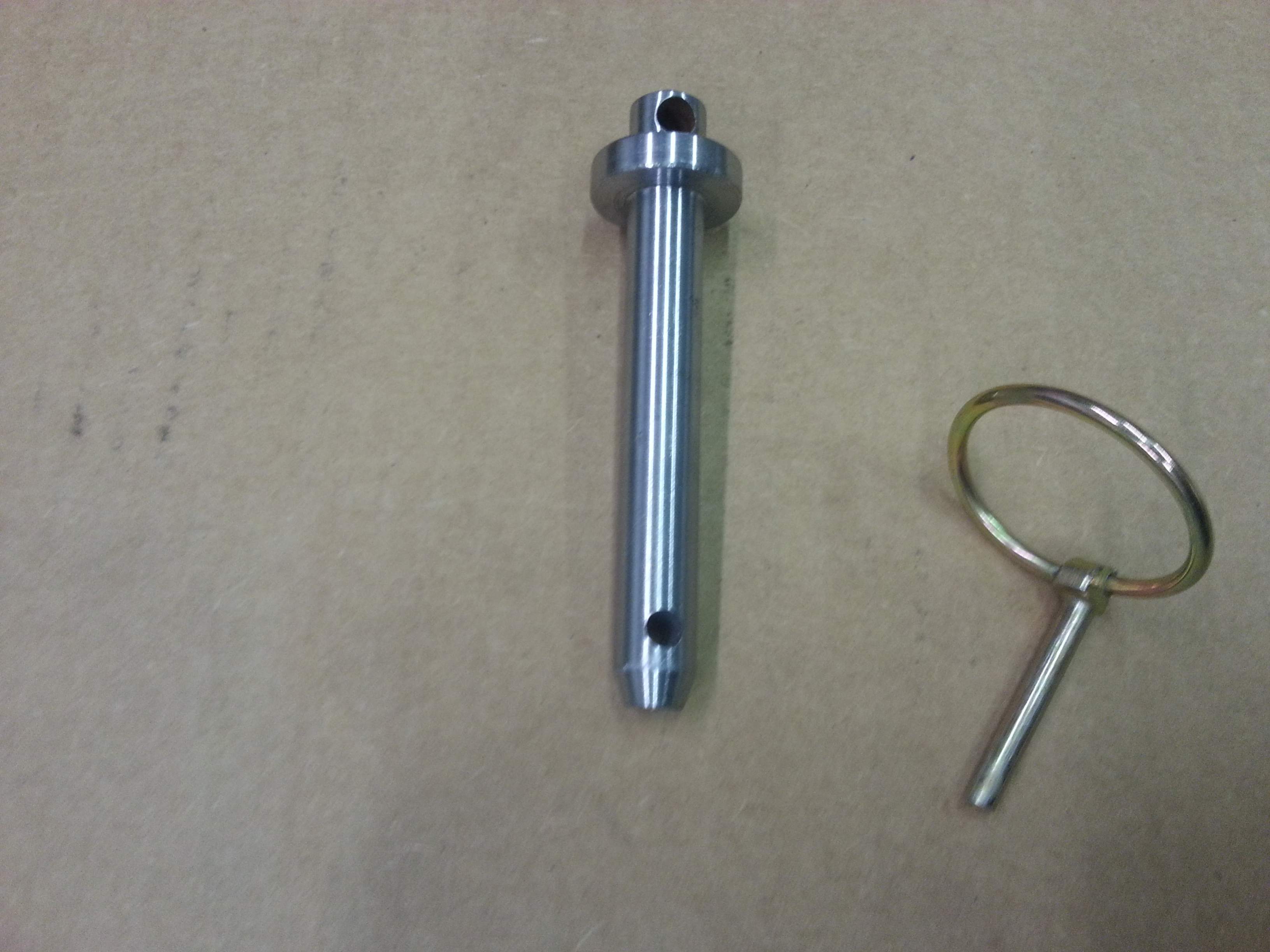

I've also been working on a removable stabilizer jack for the rear. I modified a 5000lb tongue jack, i'm not sure if it will work or not, but thought i'd give it a try. I wanted to extend it out from the back of the trailer to make it as stable as possible sense i'm using just one. Here's the extension and a pin I turned for the jack.

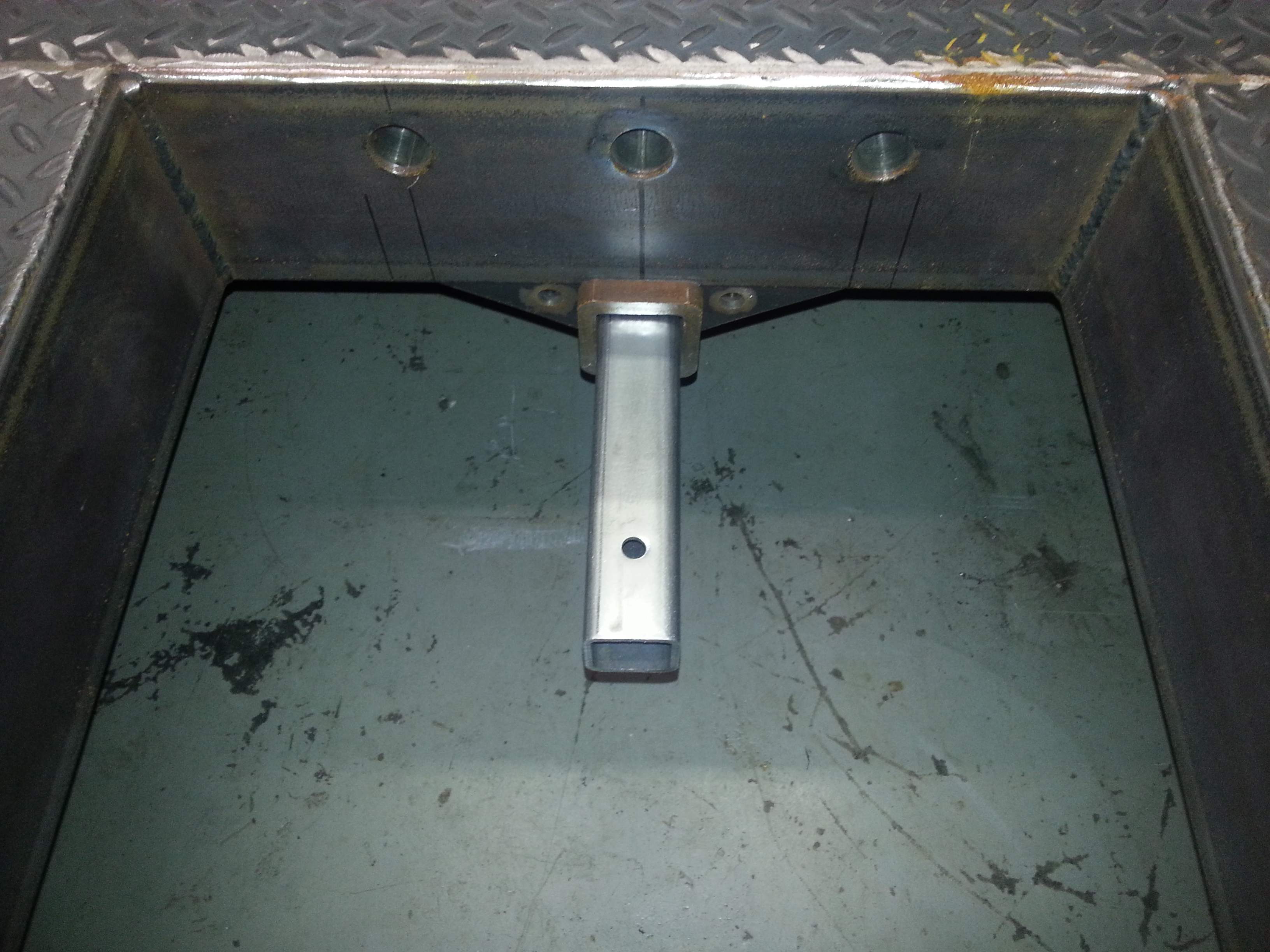

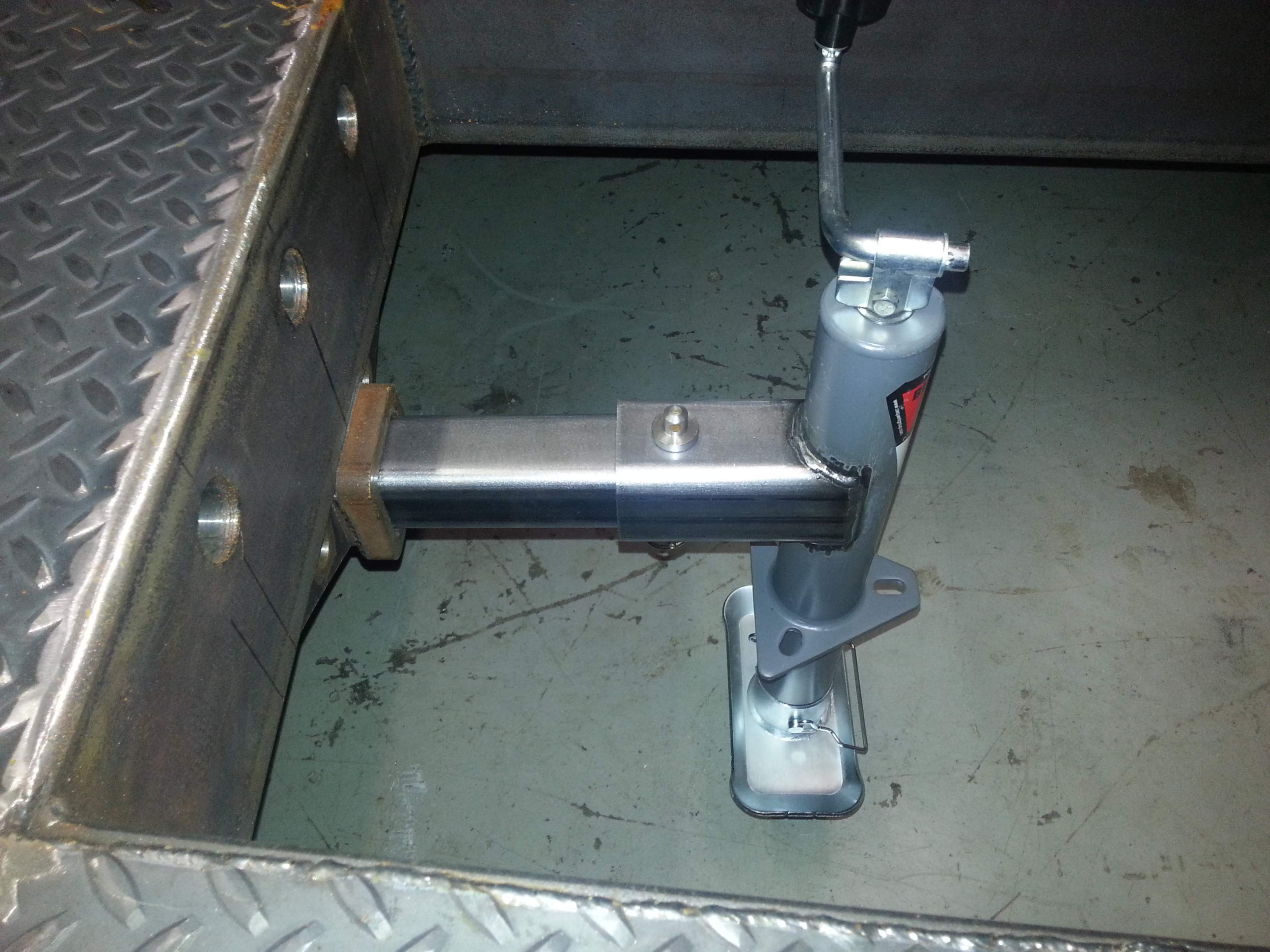

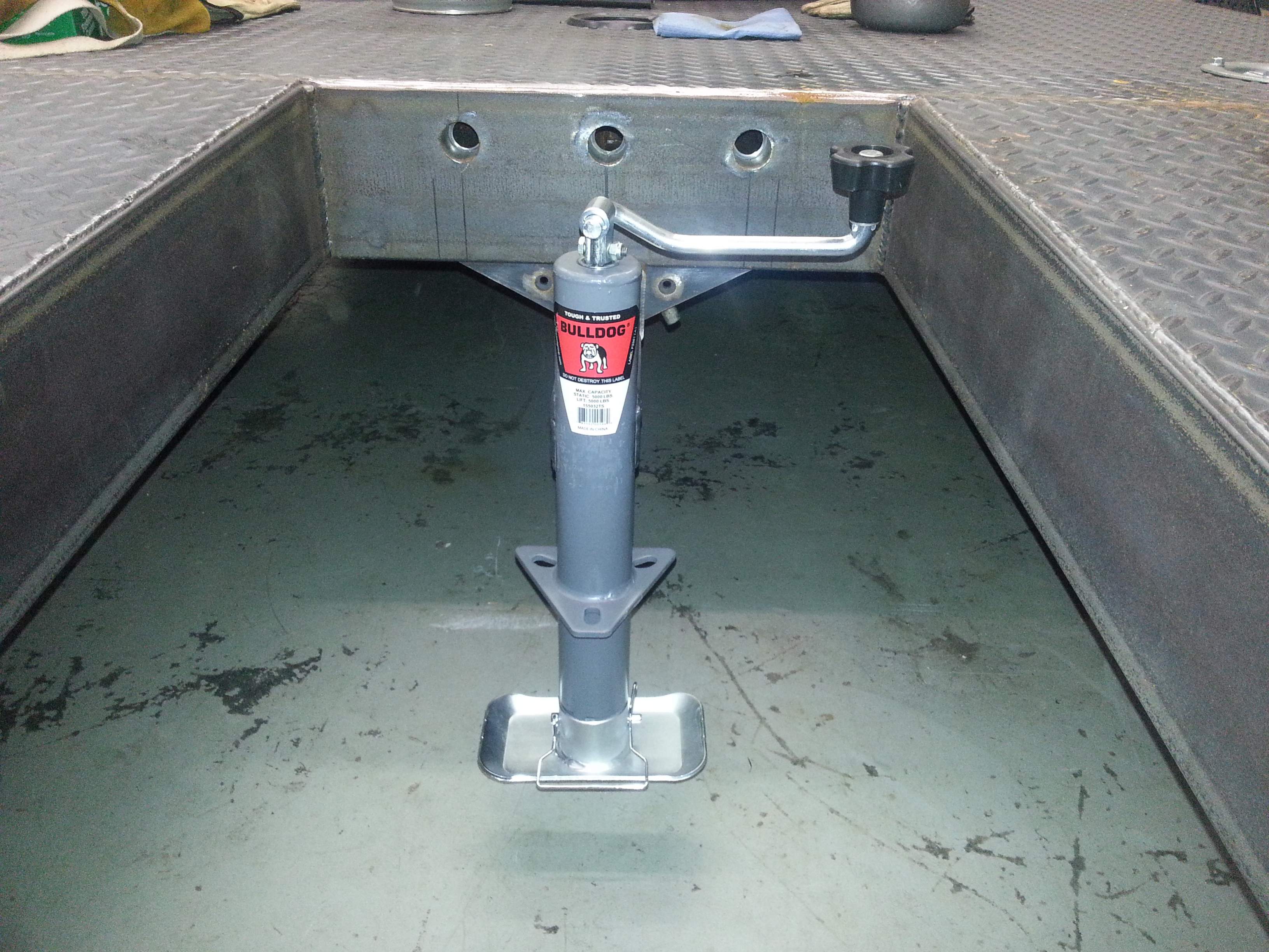

Here's the jack. I had to cut-off about 8 inches from the bottom and weld on a receiver plate to mount it. It still needs a little TLC, but I think it might just work. I think I can mount the roller (for the winch cable) to the new receiver without too much work if needed.

I can't wait to see how you will store this. You came up with great ways to store the other stuff.
