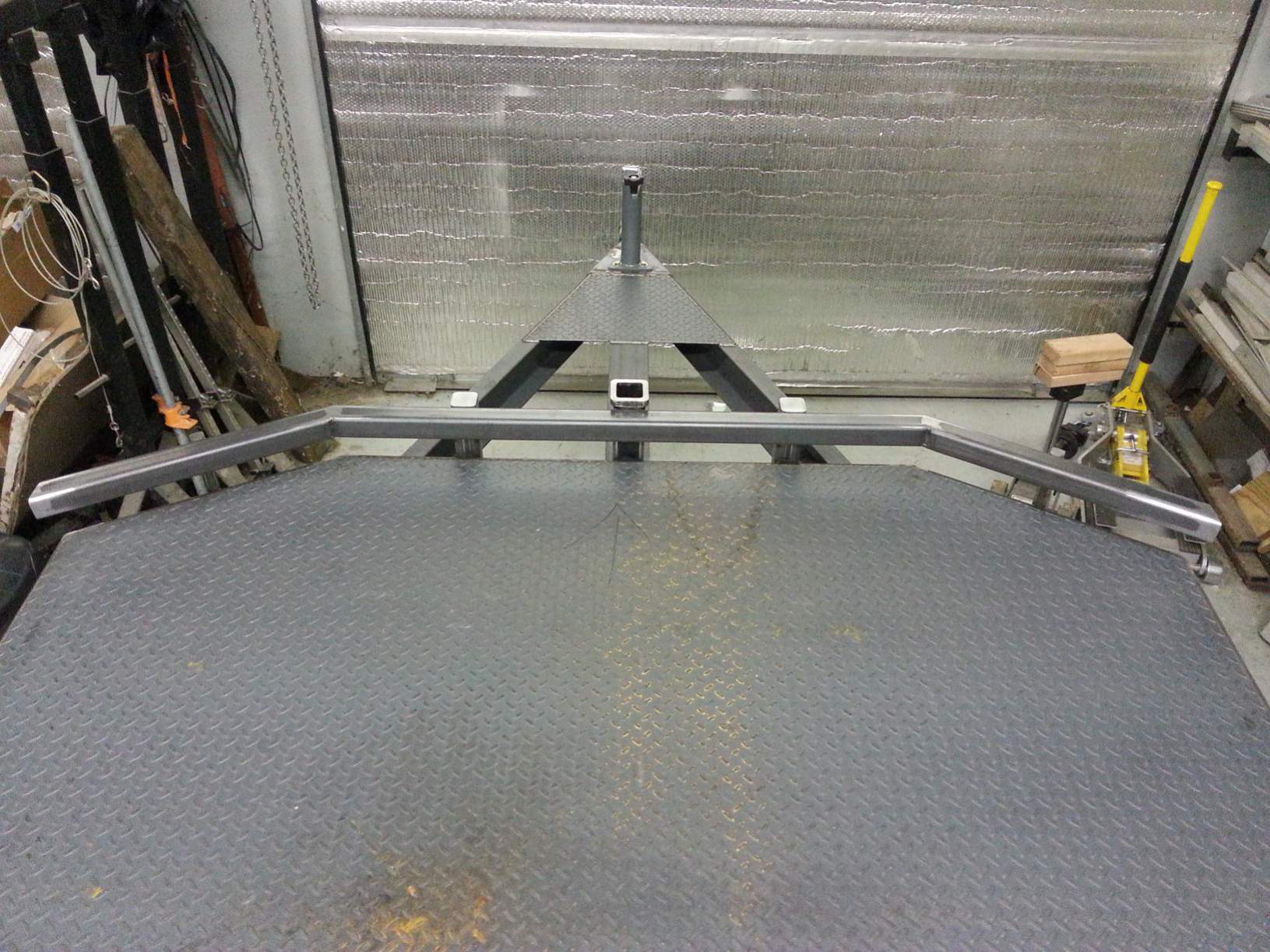

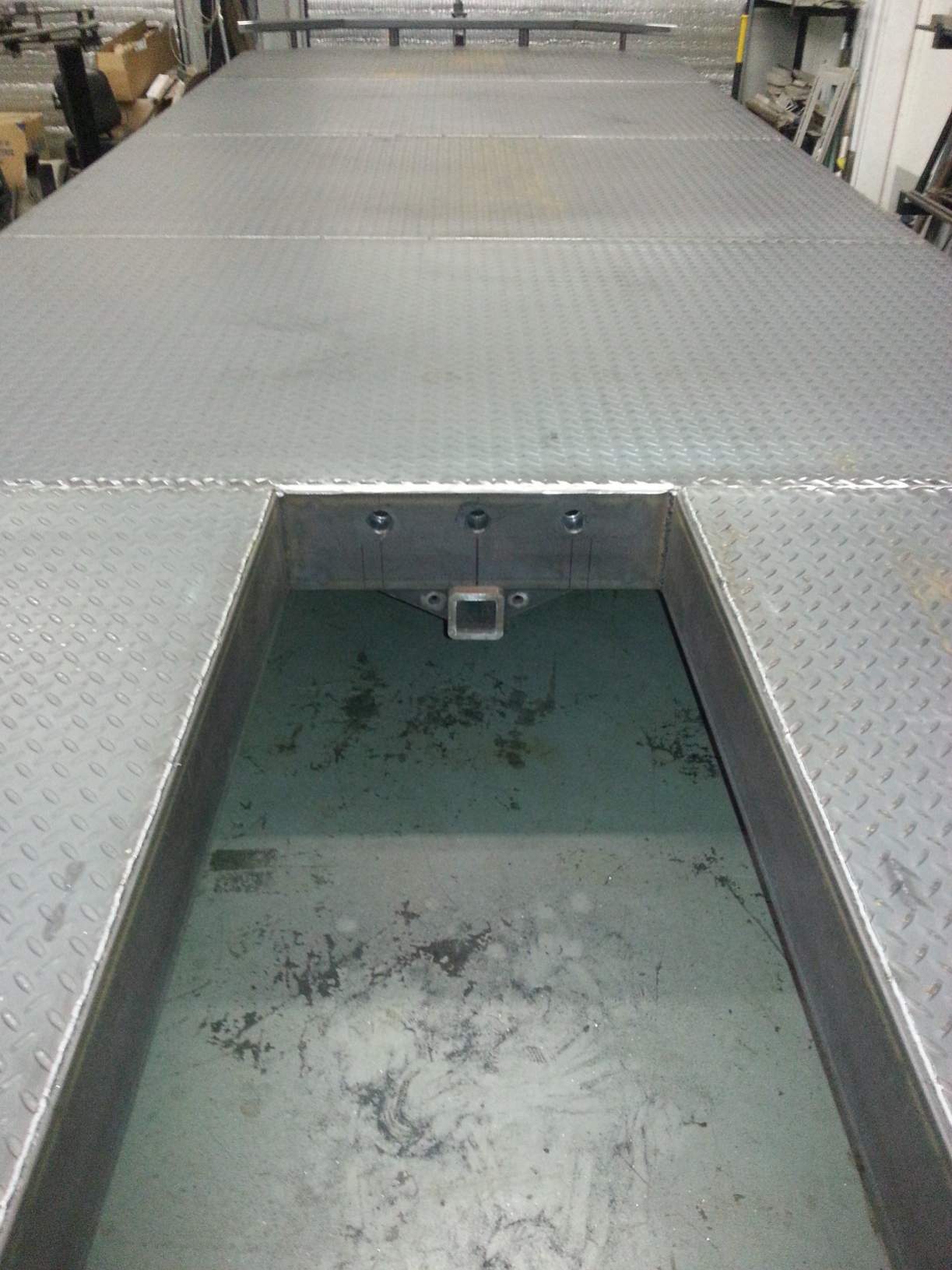

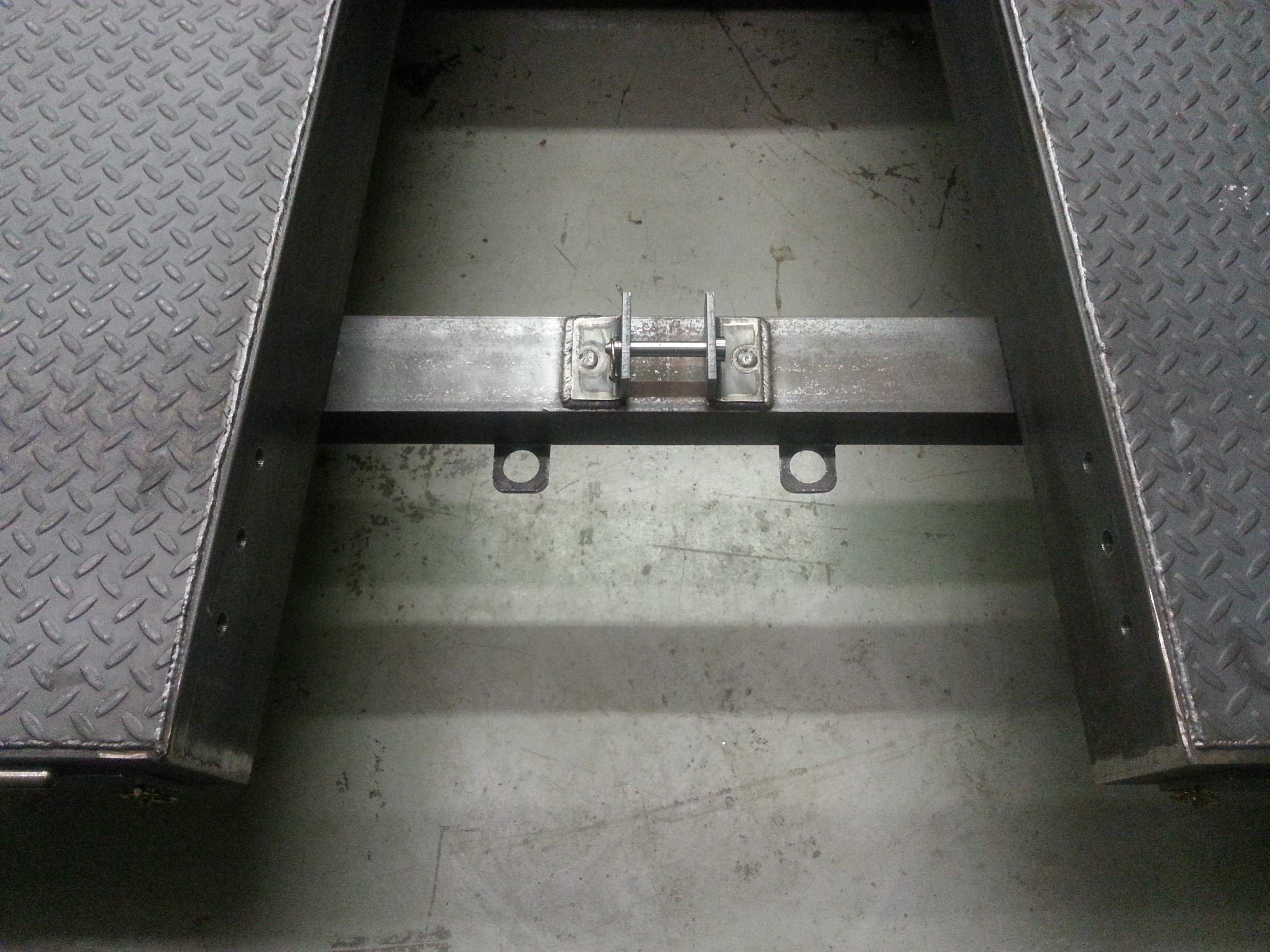

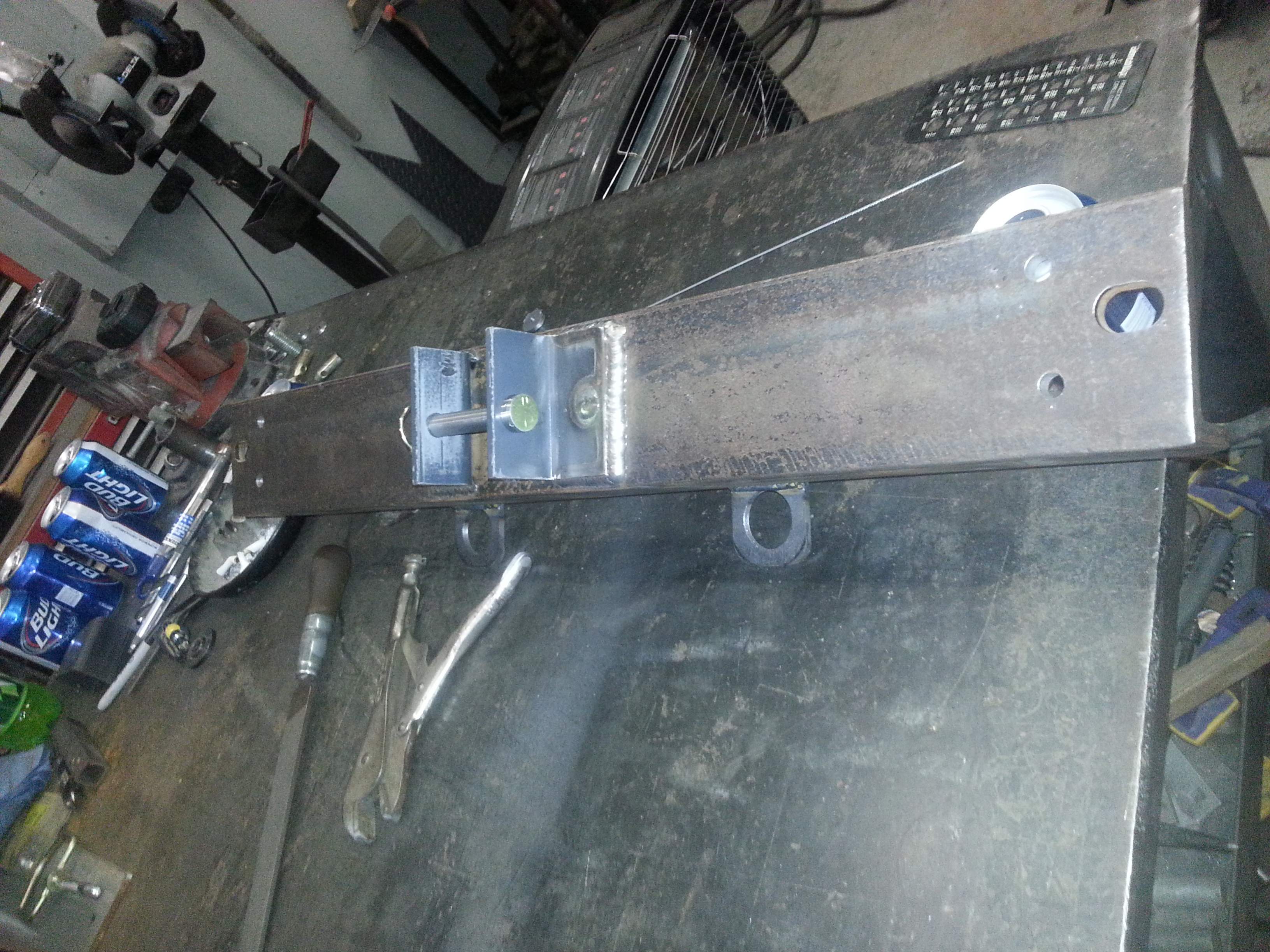

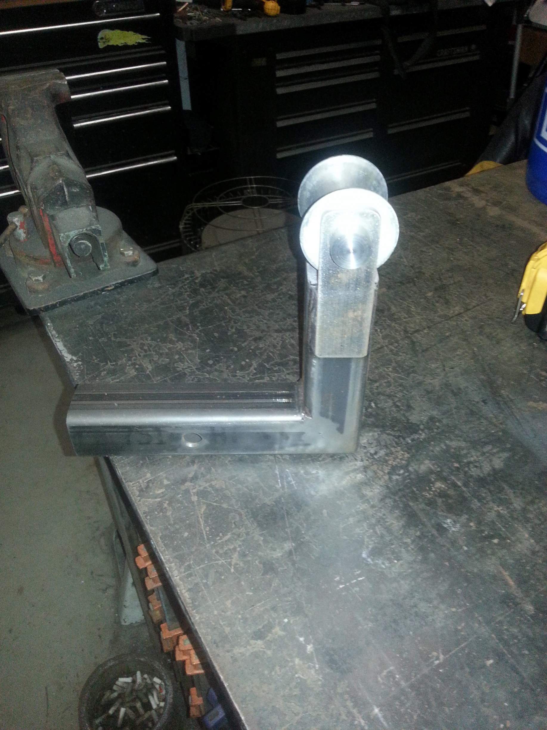

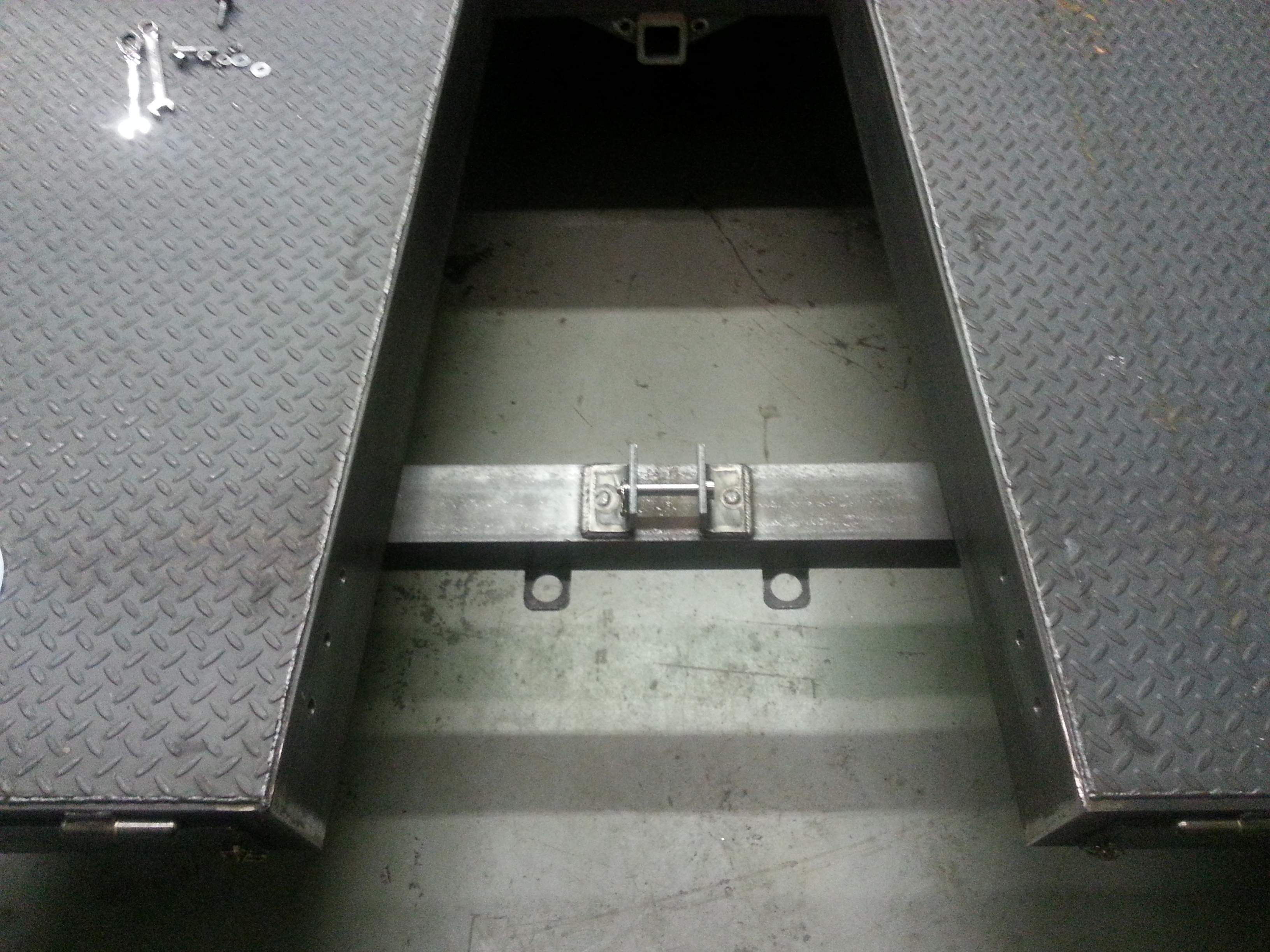

Receiver made and mounted for the winch.

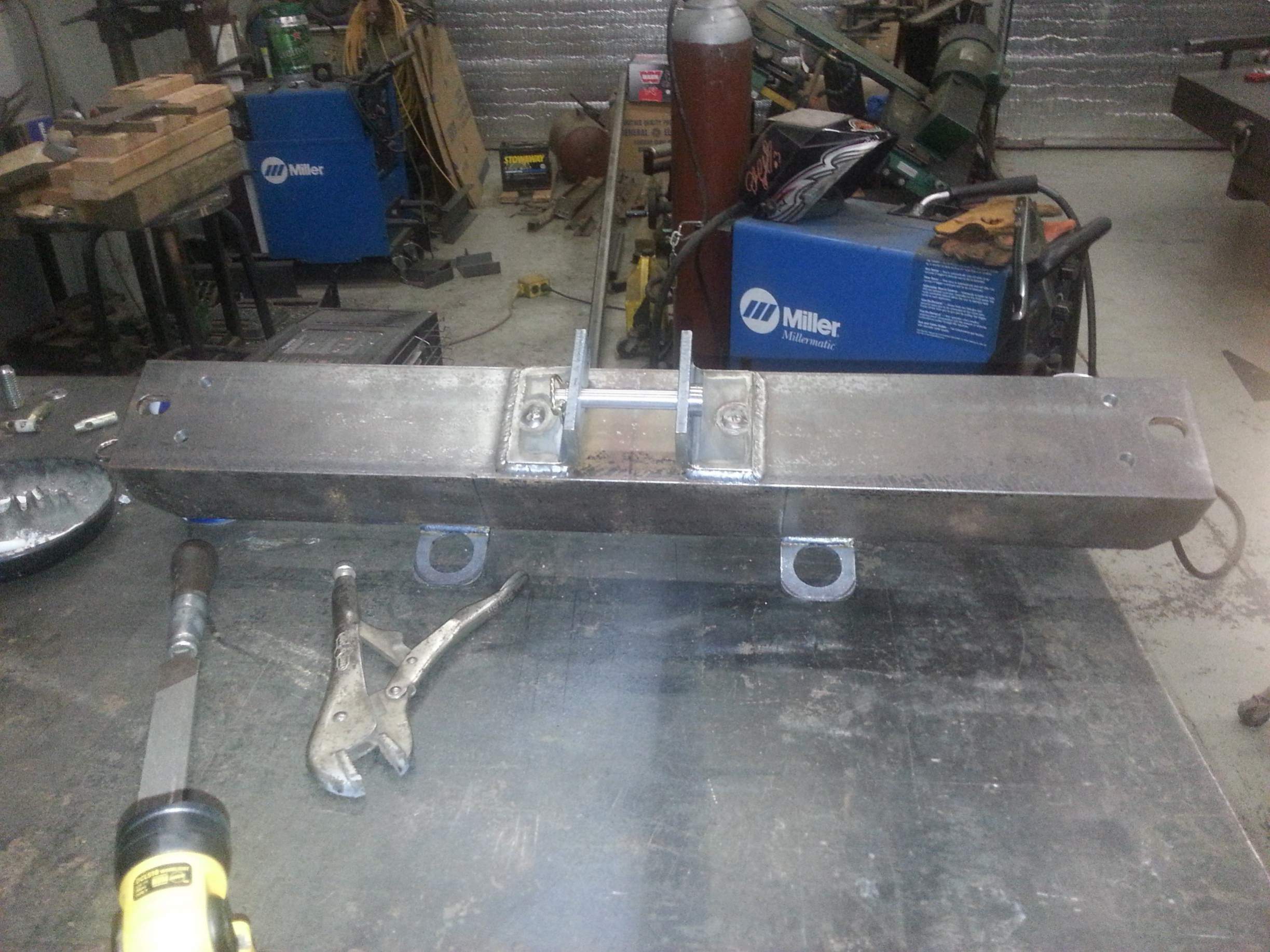

#42

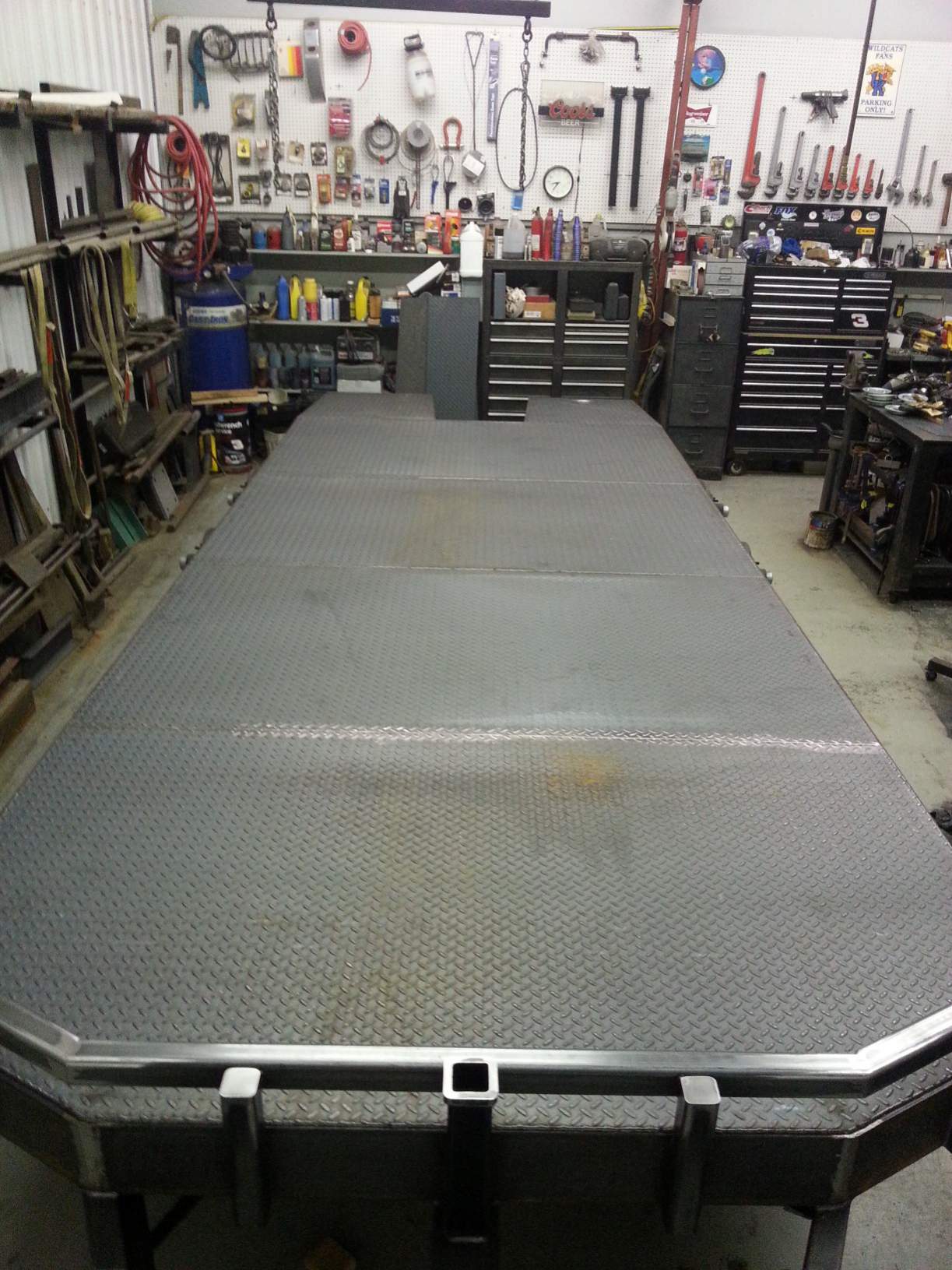

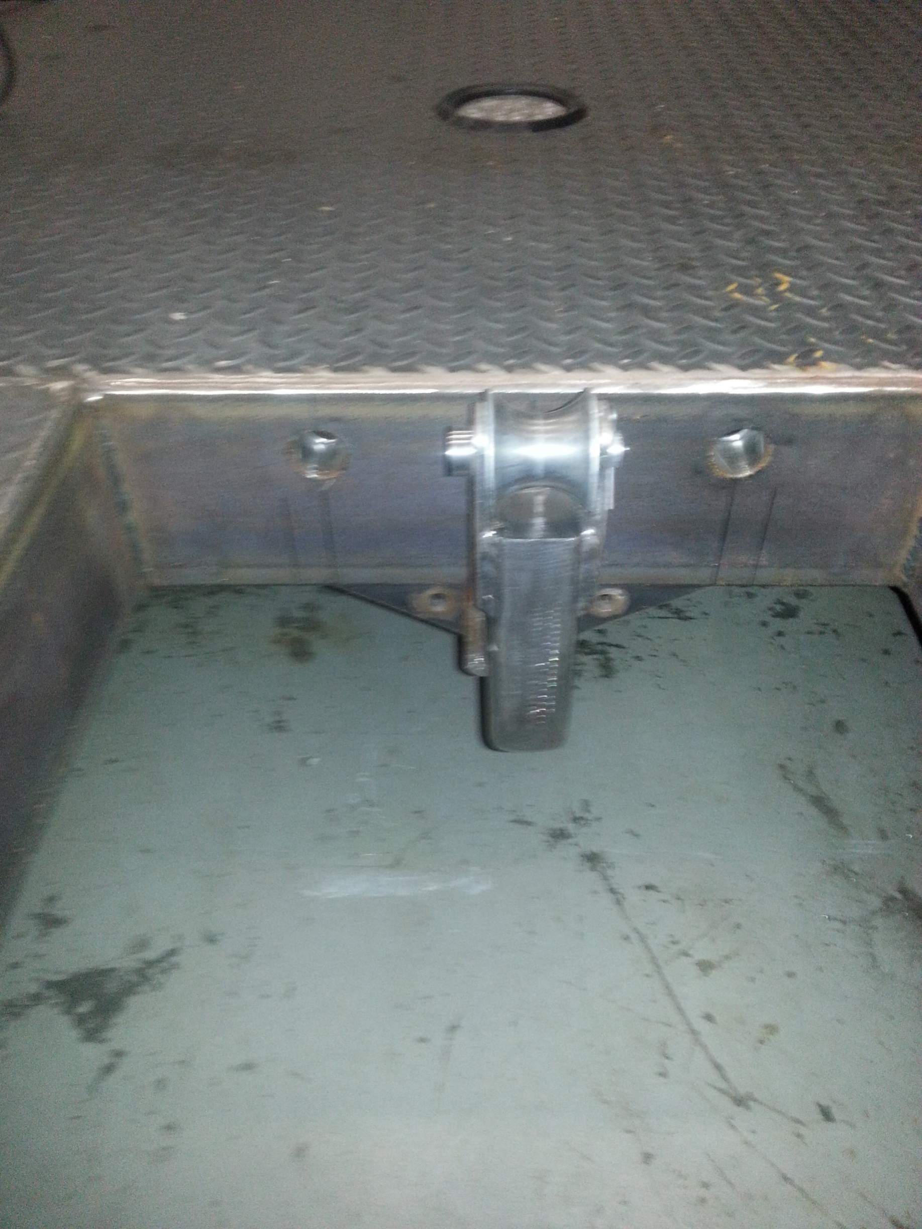

Receiver welded on the back, also recessed holes for the running lights.

   / Split-dovetail car hauler trailer #43
Seems to me a larger trailer cant turn with its drawbar in the dovetail split, hooked to this receiver ? whats the idea behind a split dovetail ?
I used 6" channel for the main frame and 4" channel for the cross braces, I want it heavy duty.
With a checker plate floor, i'd rather put some extra in than a few very heavy ones. At a former employer we once built a 21 ton forklift transporter with crossmembers spaced a foot apart, and 4mm (9 gauge) diamond plate. Within 3 months the floor washboarded due to the pointload of solid forklift tires, so we put on a new 8mm diamond plate floor in.
I think the idea of a split tail is to be able to tie down whatever is on it easier, I just like the look of them. I'll prob. only haul vehicles with regular tires, I think 16" centers will be fine, if not i'll change it.

Trailer looks good. I too don't see how the hitch will work for a second trailer, unless you have an extension draw bar, or use it for a winch hookup, winch cable diverter, or D-ring/Shackle for added tie-down point. Regardless, it will serve many future uses.

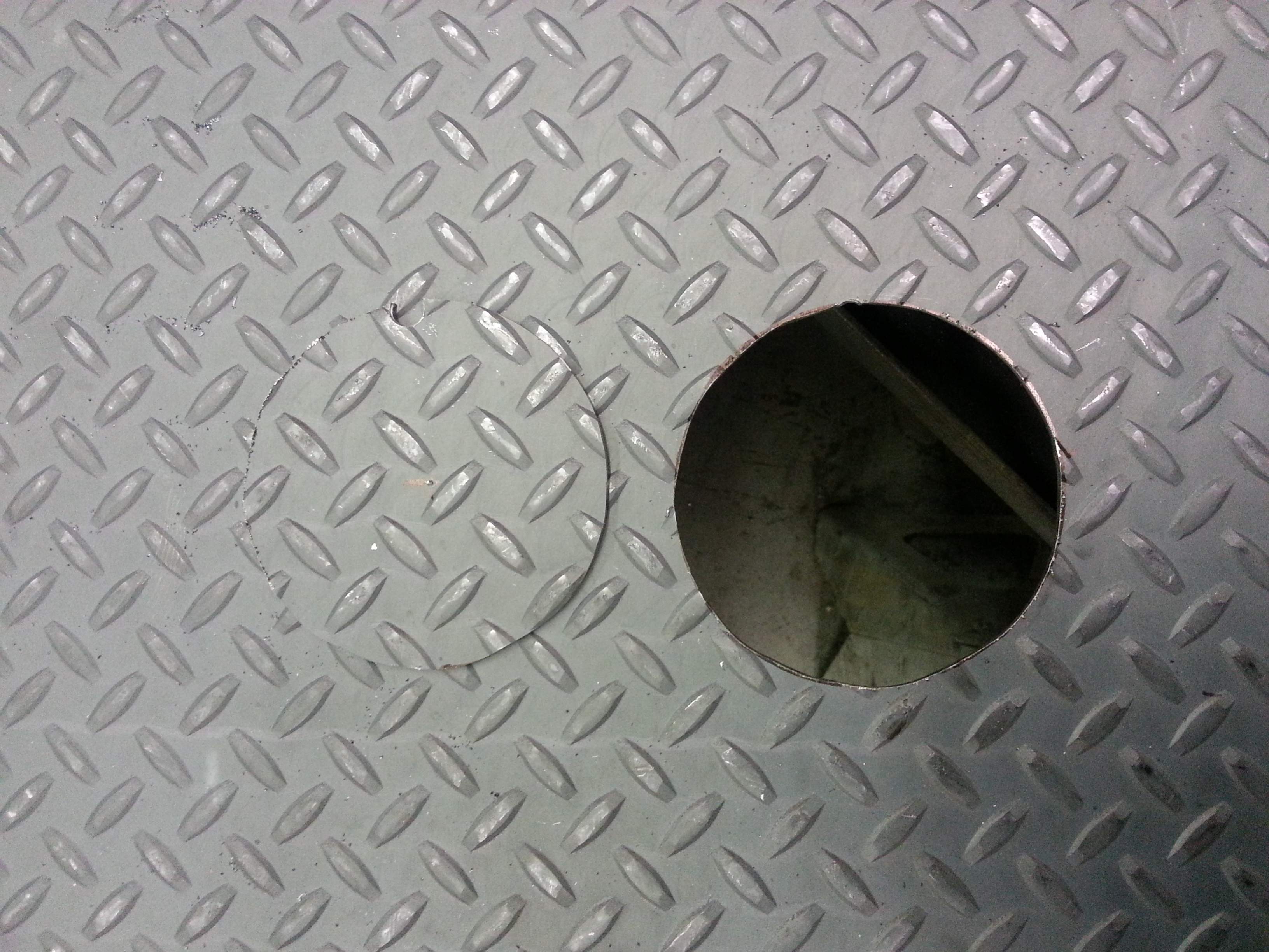

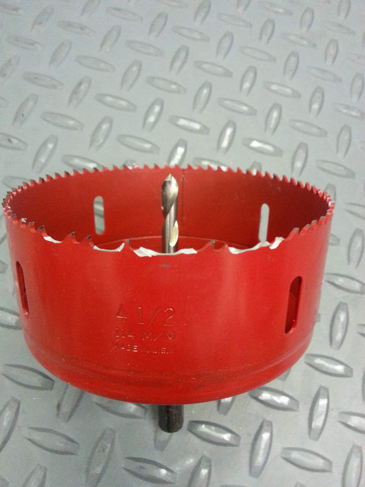

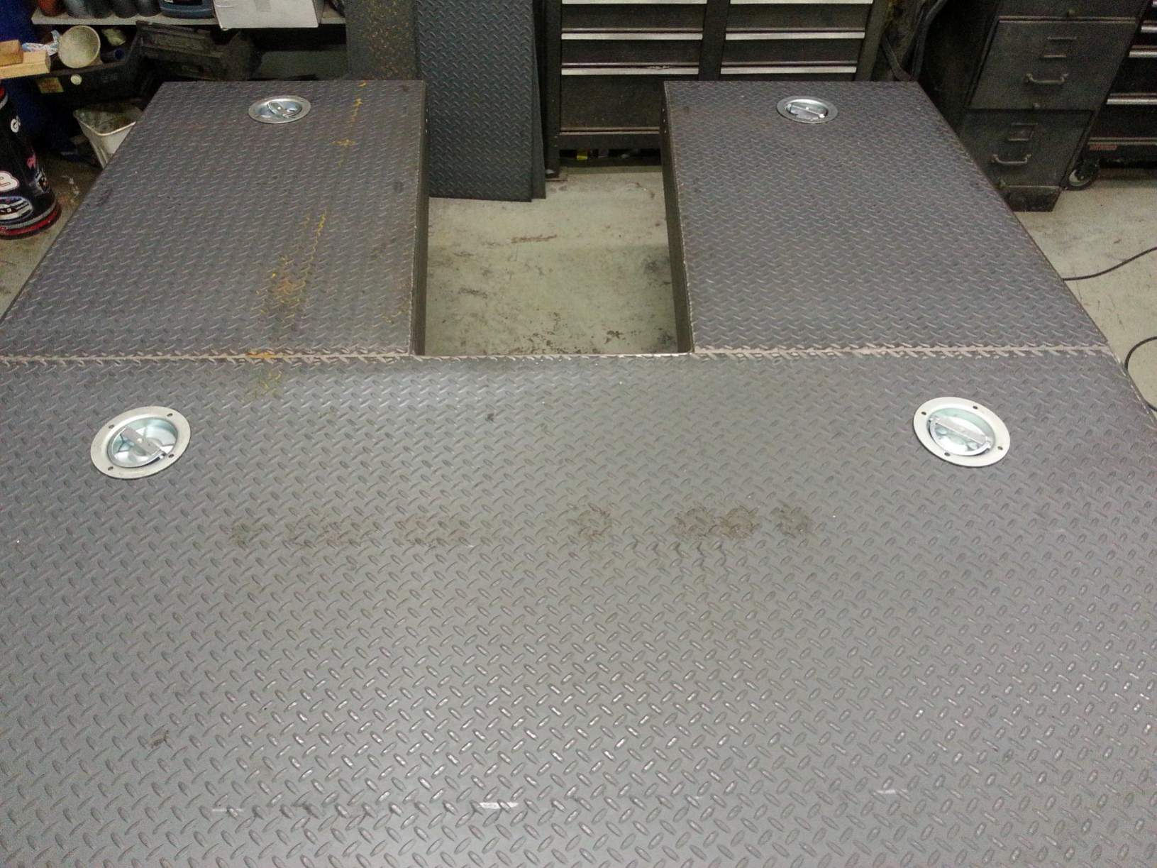

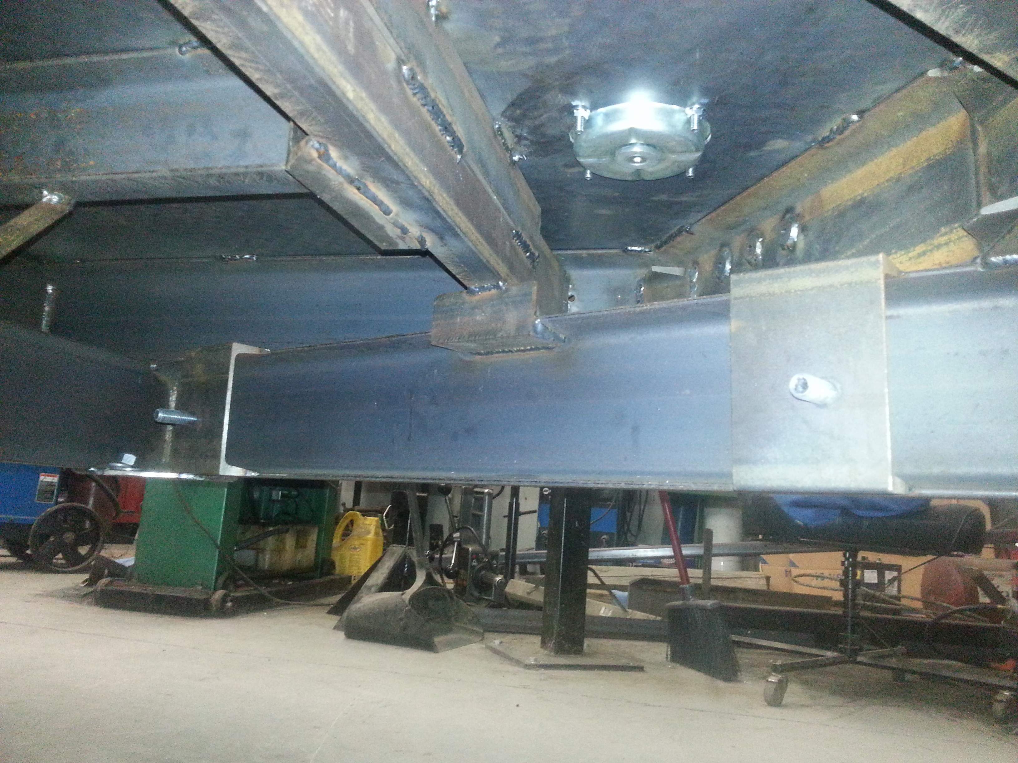

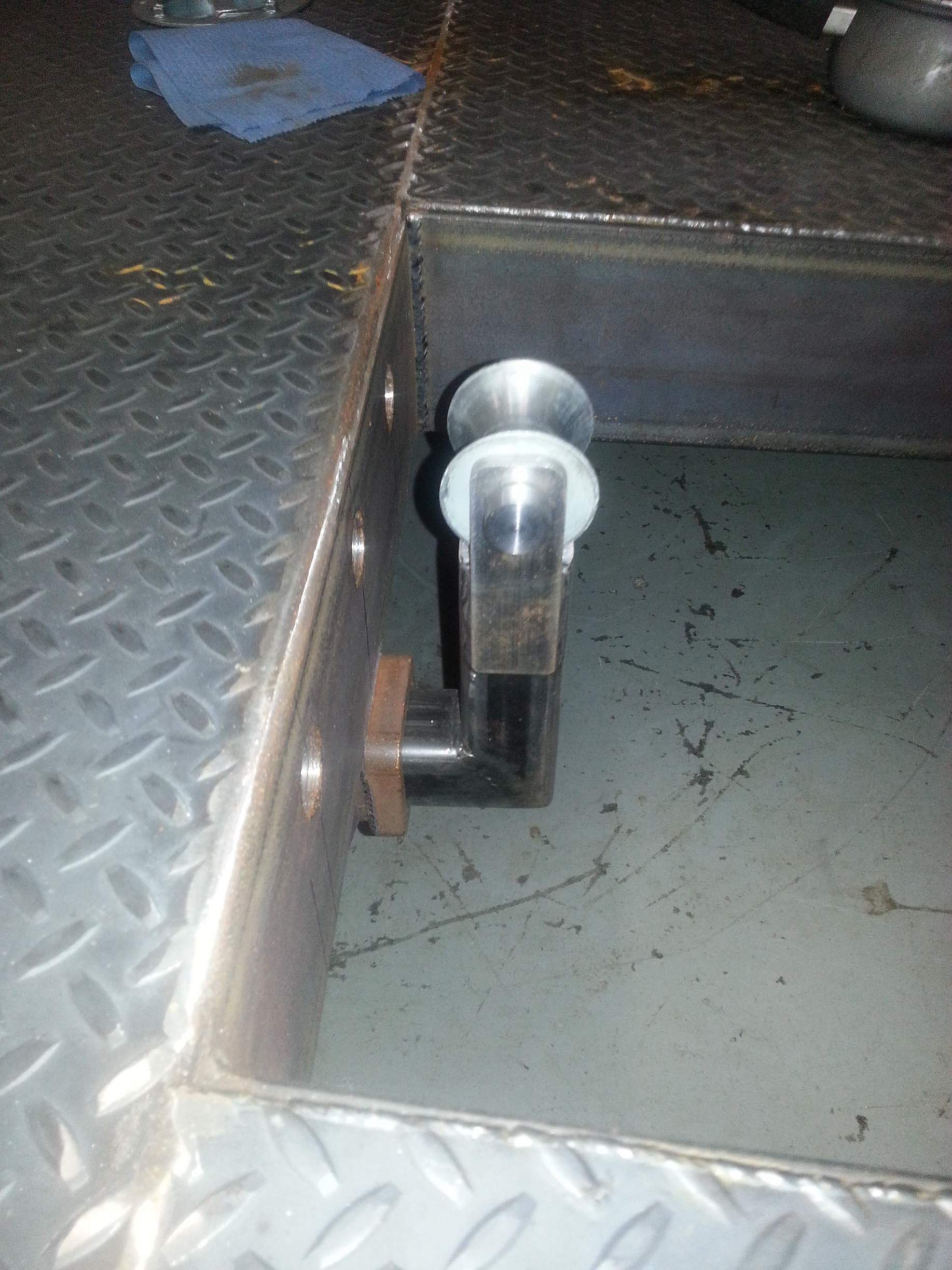

I tried to use a hole saw to cut the holes for the recessed D-rings, didn't work out, used my trusty jigsaw instead, worked like a charm. I decided to bolt them in instead of welding them in case I ever needed to change one. They are rated at 6000lbs each. I'm also installing backing plates on the underside.

A little clean up.
All of the above, plus some. I'm already working on an idea to pull a small trailer with it too.
