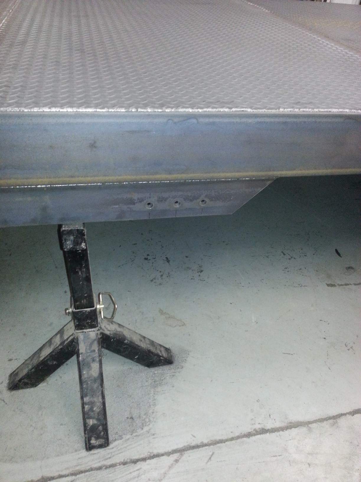

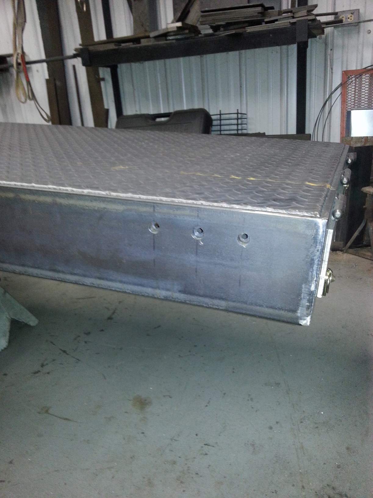

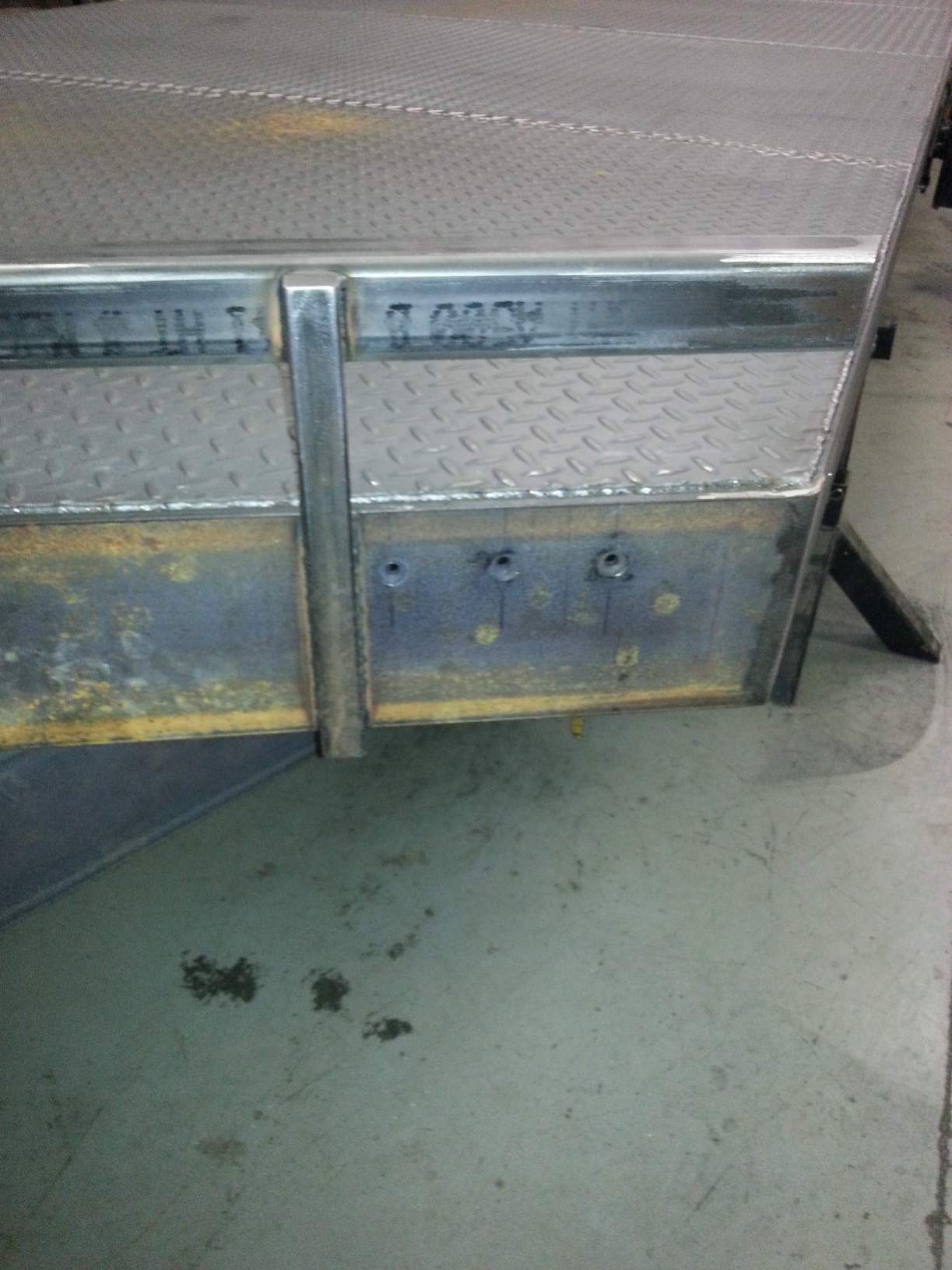

More recessed holes for running lights.

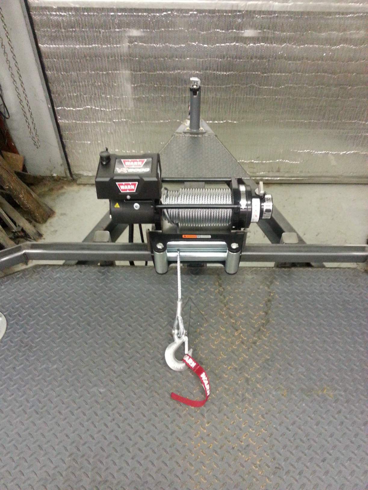

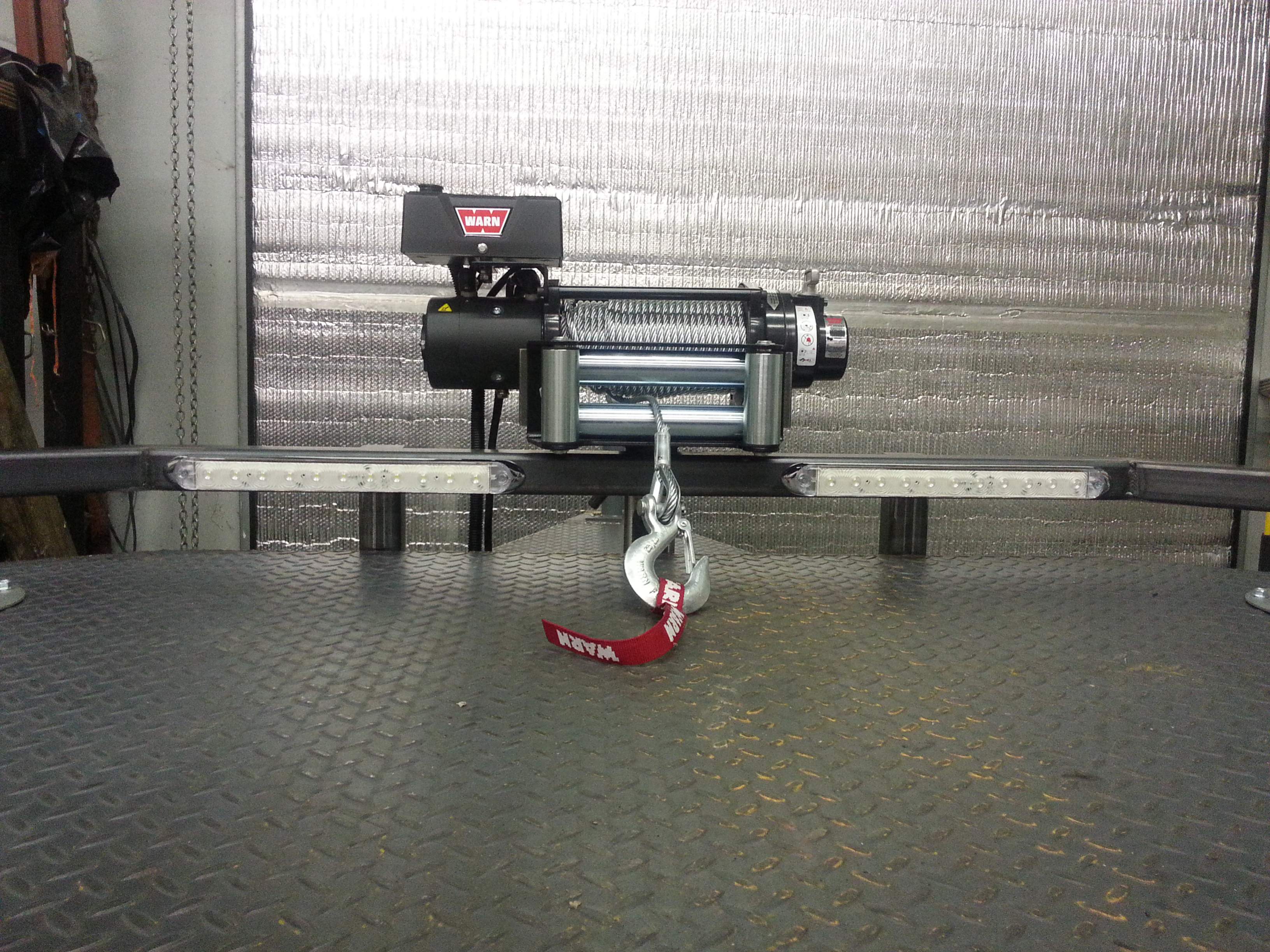

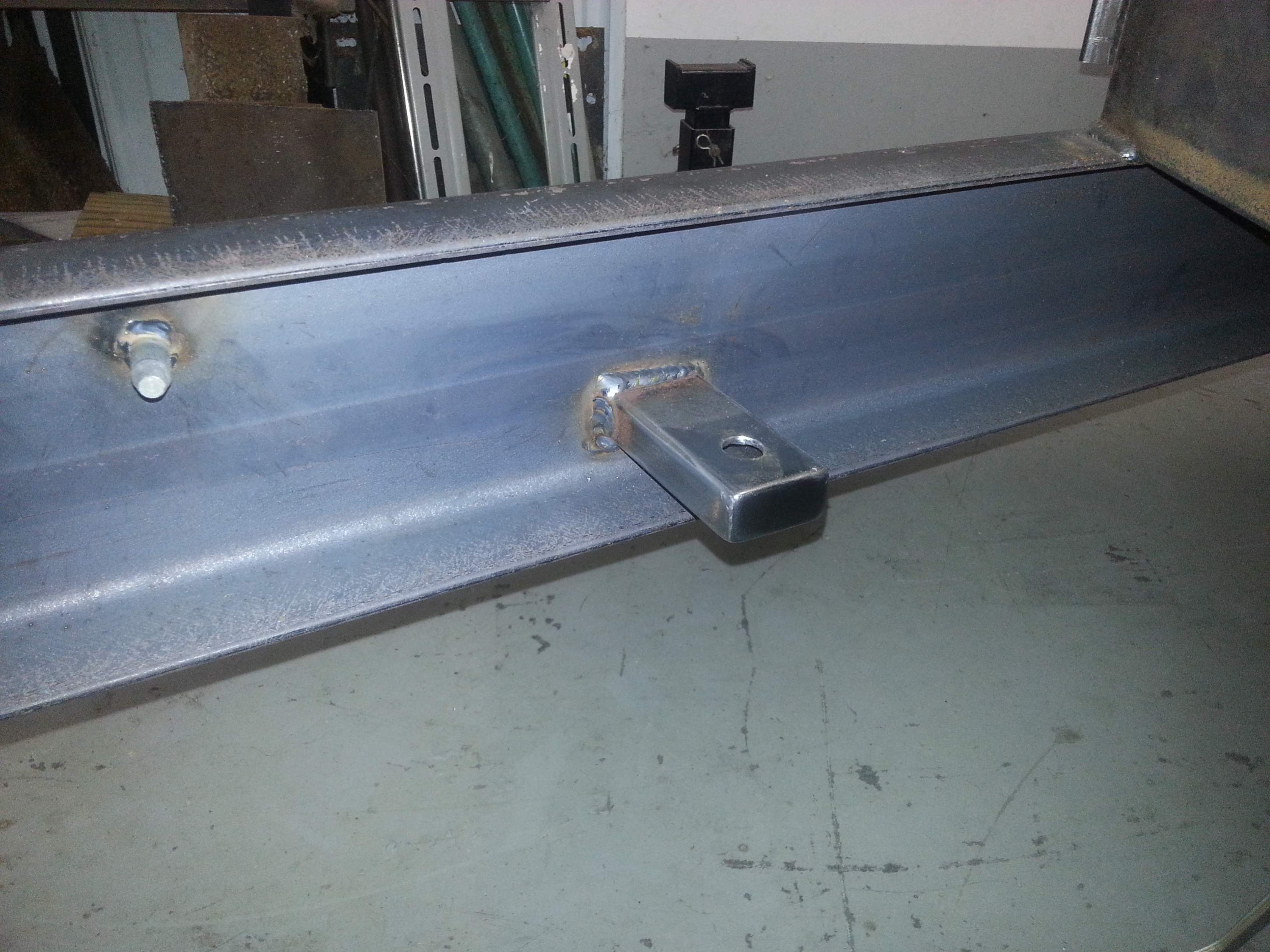

I got an 8000lb winch for Christmas...yes. I mounted it to a 1/2" piece of plate welded to a receiver tube. I had to fab up some mounts for the roller fairlead out of some angle.

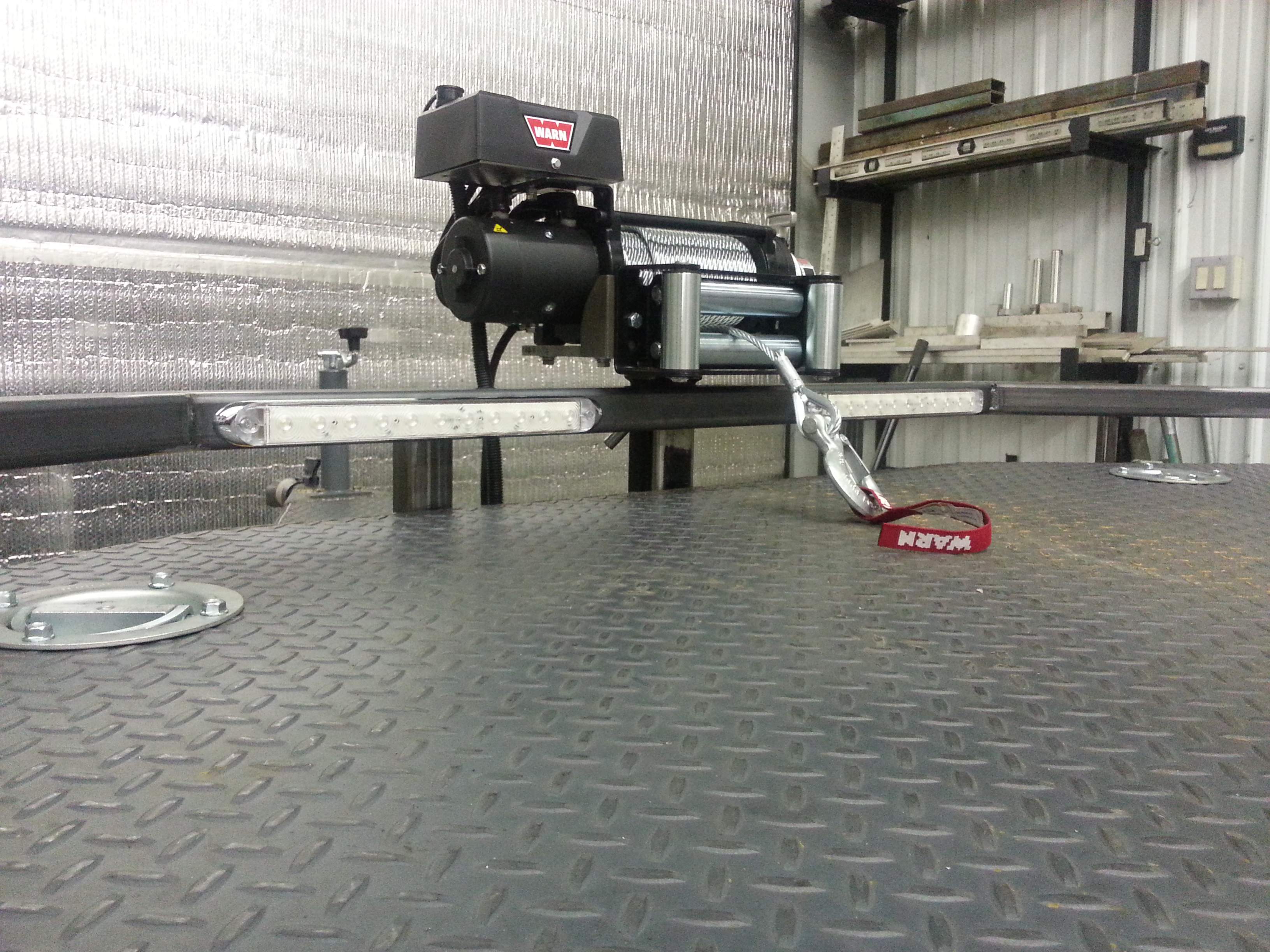

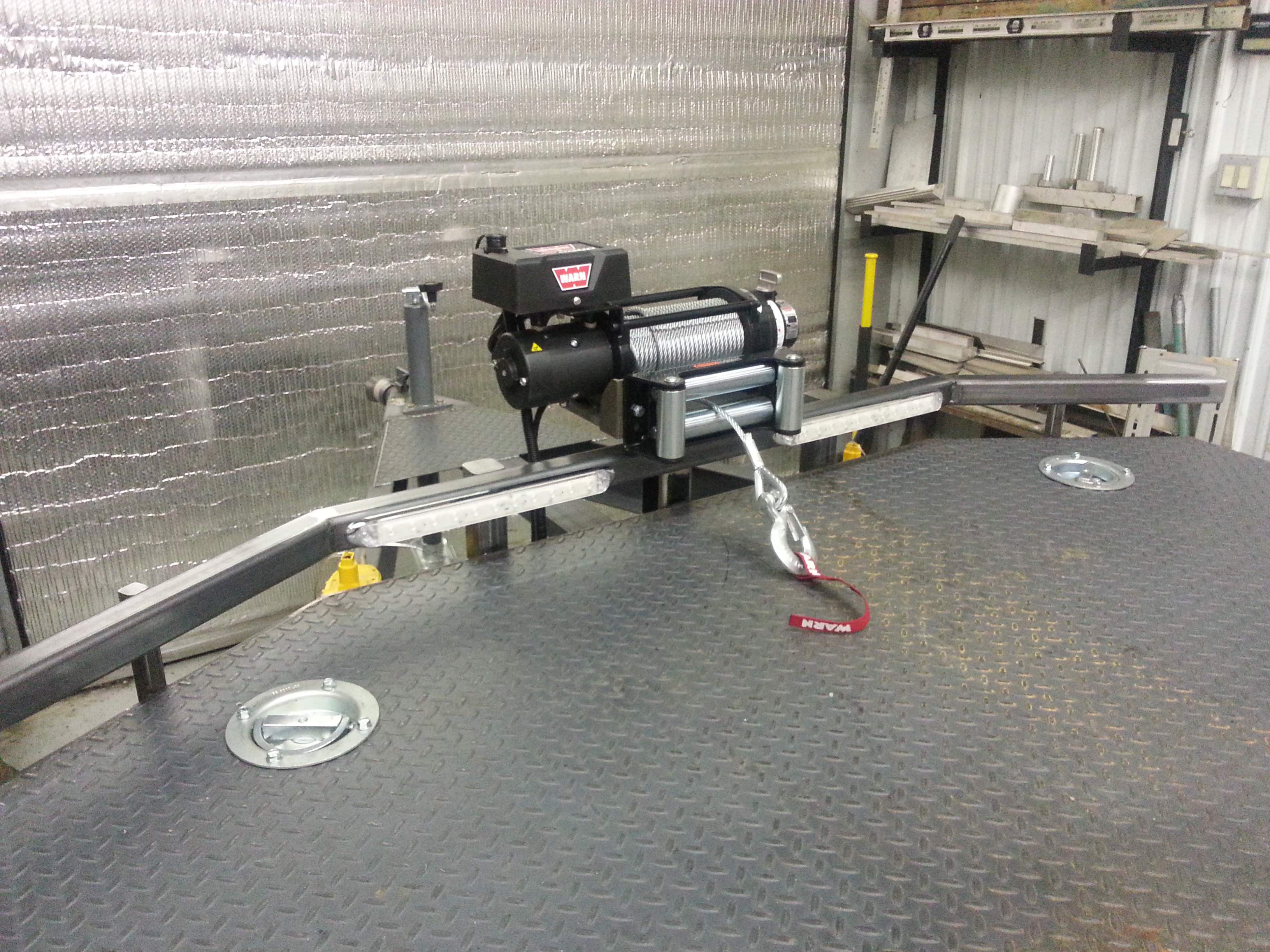

I also mounted some winch/loading lights.

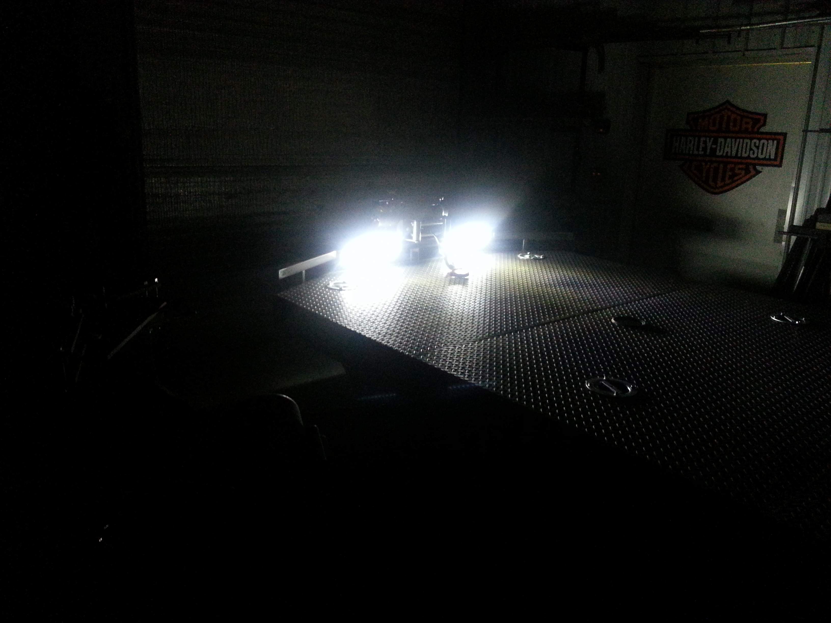

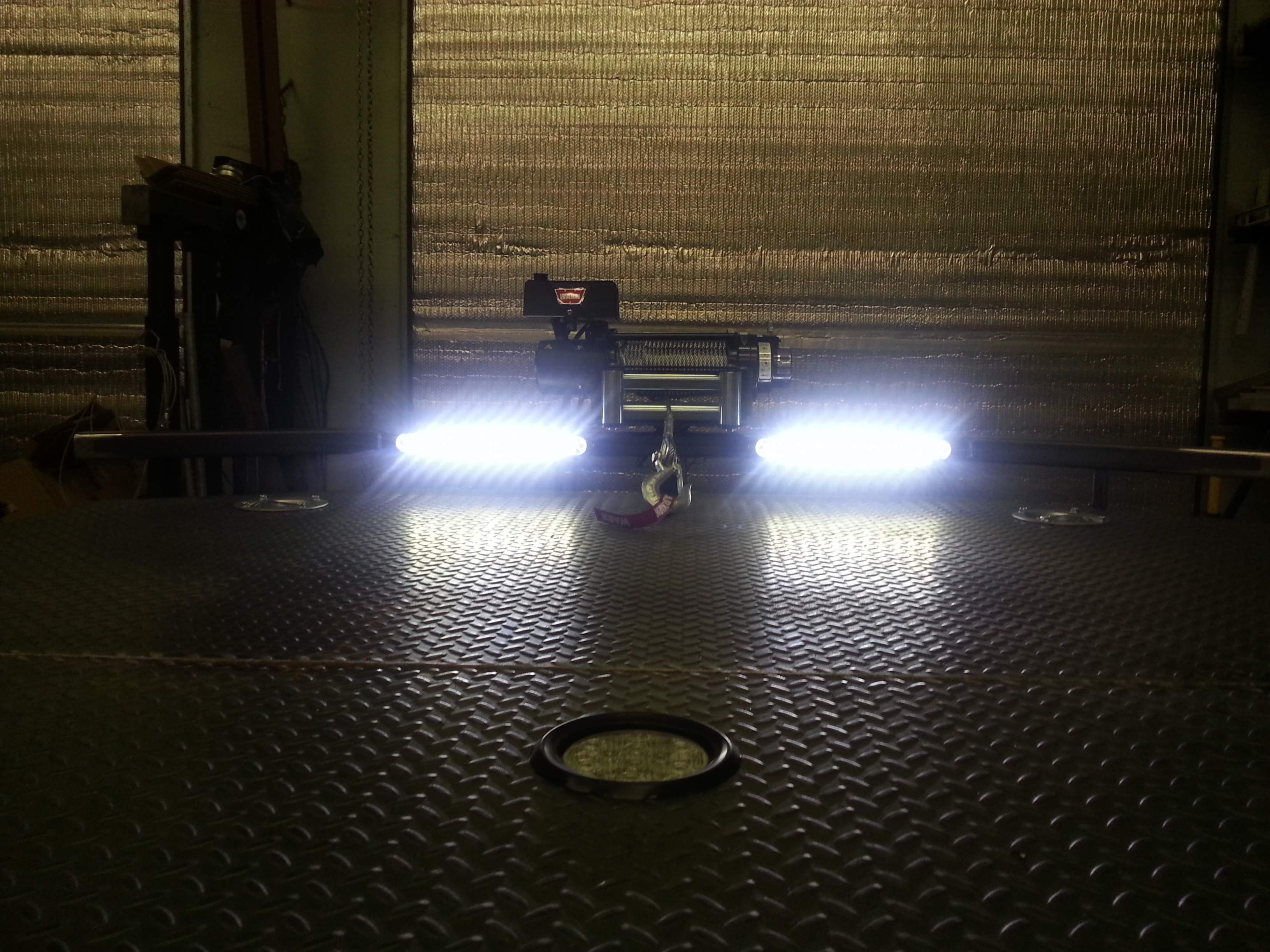

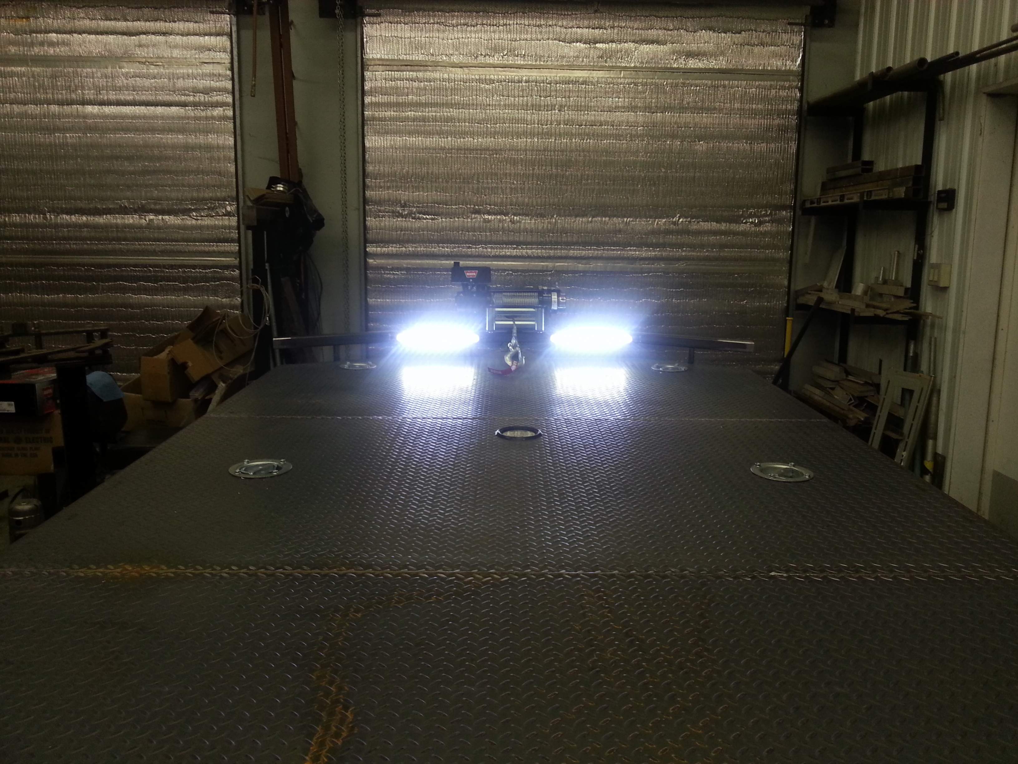

Lights on.
Nice winch. Like the way it's mounted. Have you planned a cover for it or will you store it elsewhere?

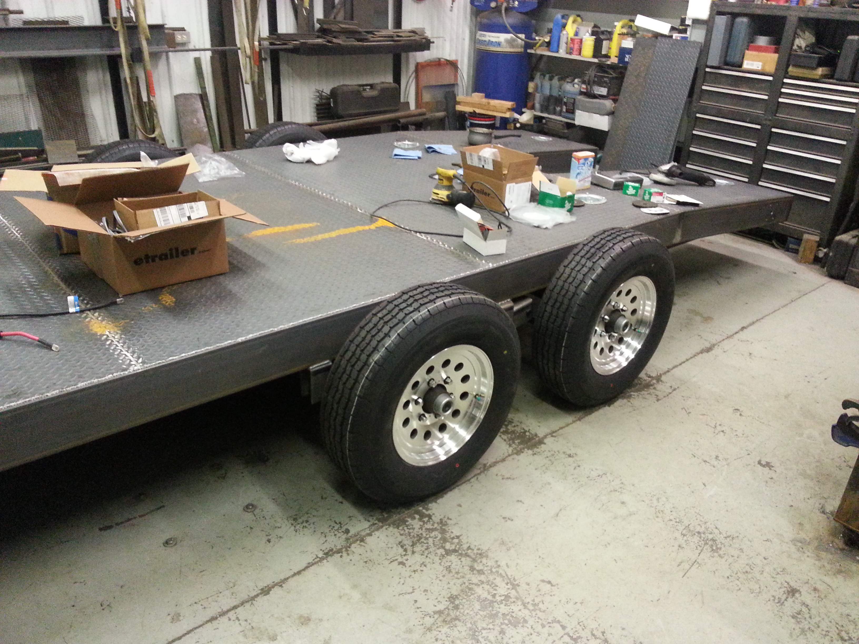

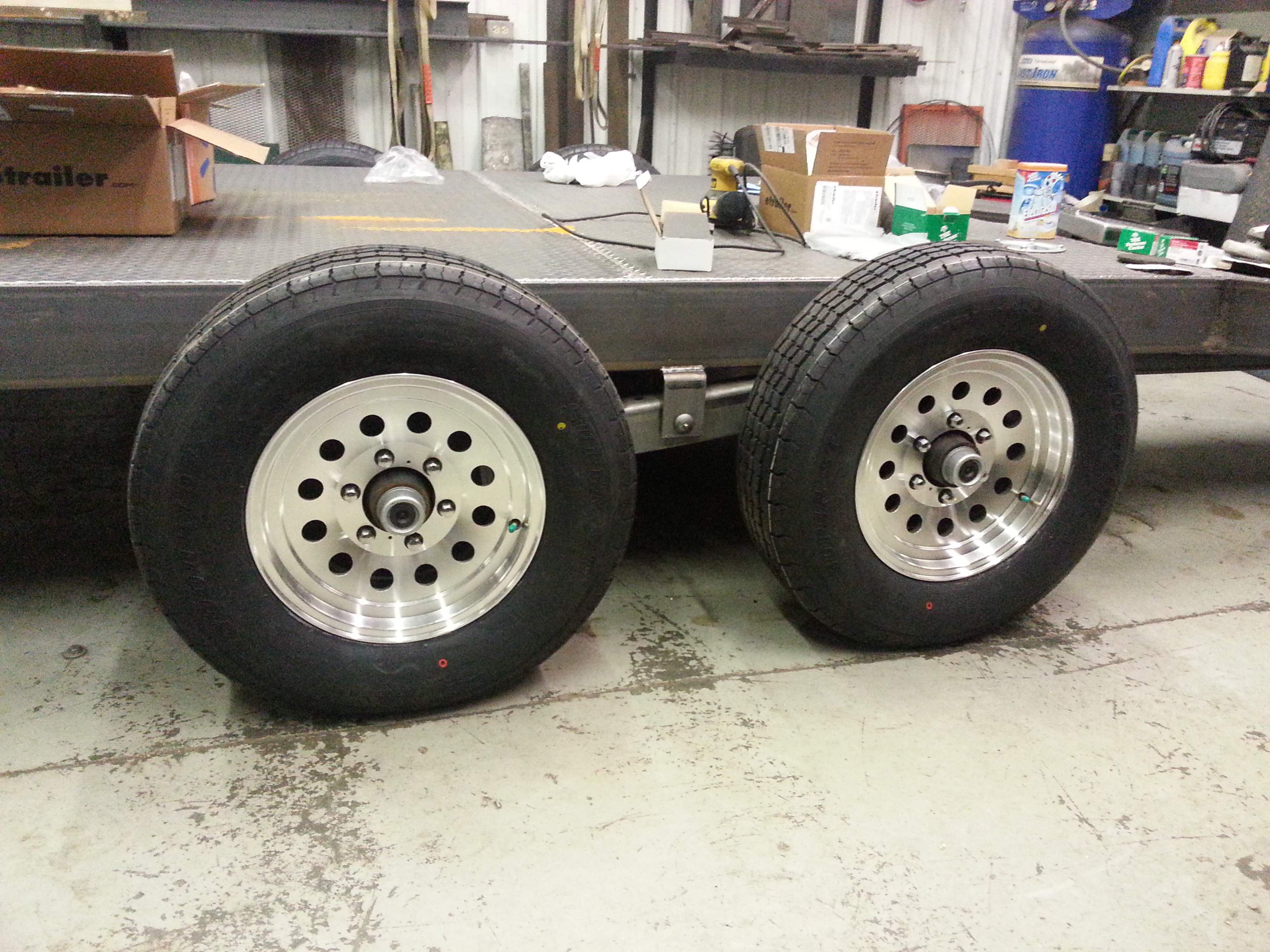

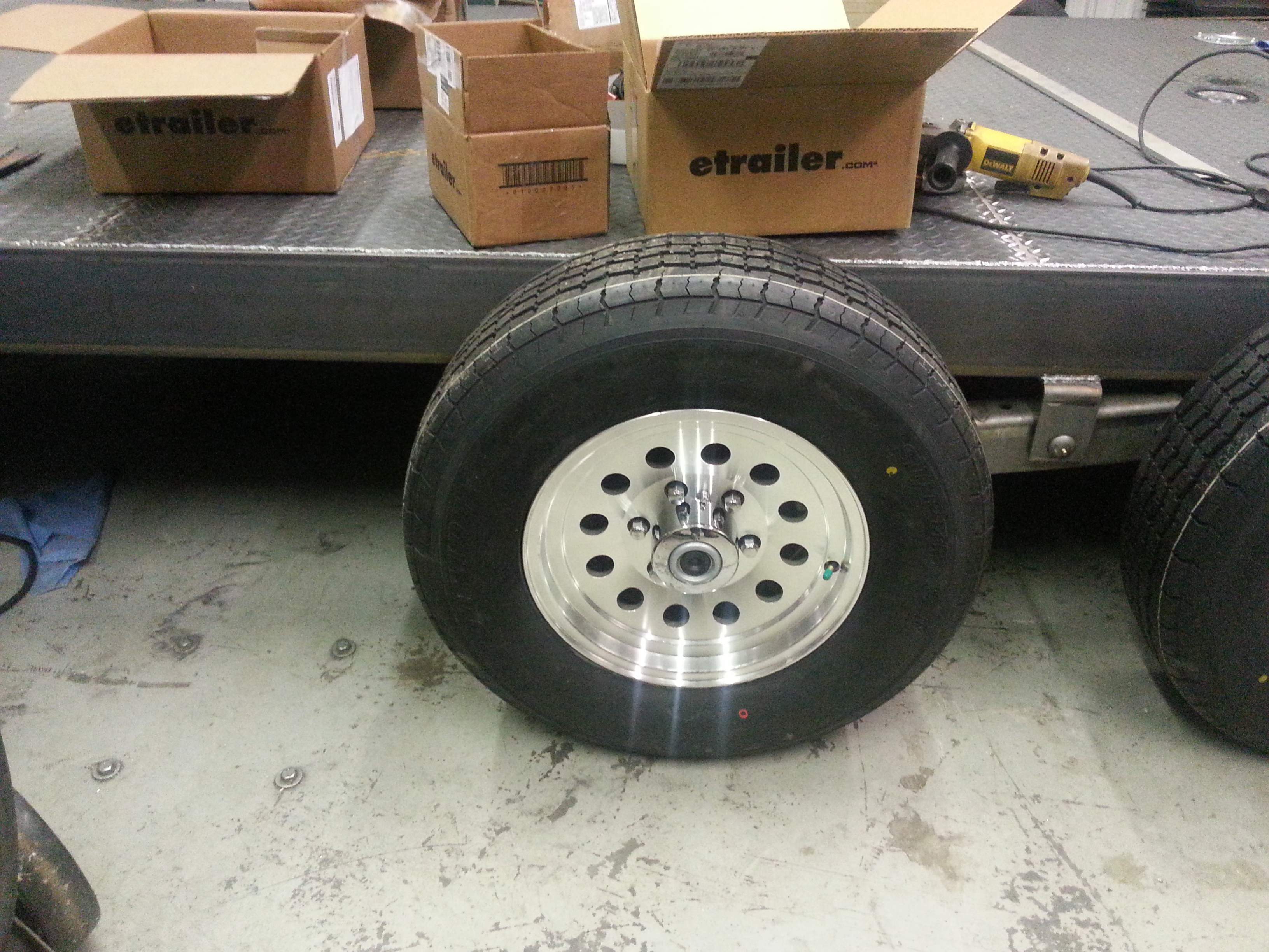

She's a roller. I got some wheels and tires for Christmas also. The axle caps were not deep enough, I ordered some open ended ones, just haven't gotten them yet. As soon as the weather gets a little better and I get the time i'm going to hook to it and see how well it pulls. Besides the fenders and a few other little things its about ready for paint.

#57
Yes I plan on getting a cover for it, but it can also be stored in my truck.
   / Split-dovetail car hauler trailer #58
I keep my 8,000 lbs winch on a cradle in the tool box and mount it on the trailer or the rear receiver of the truck also. The trailer is shaping up very nice!
