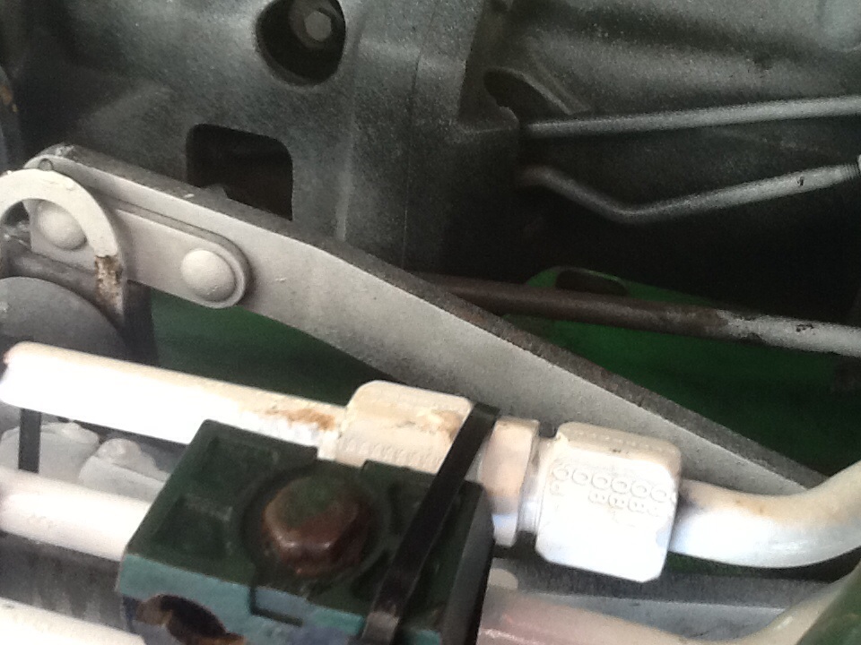

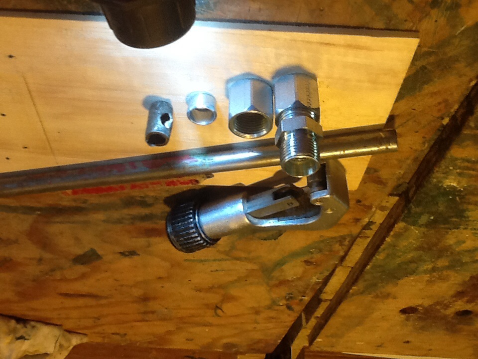

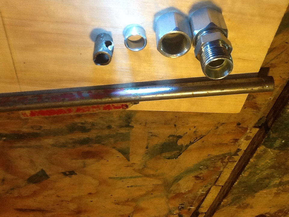

Just recently a curl function half inch hard line on the JD4200 420 loader split. All due to operator incompetence, tiredness or just plain lack of proper attention.
Without curl the tractor was backed out of the woods and onto the trailer. Had to use the hoe boom to lift and pull the tractor for a few feet as the subframe did not clear the trailer.
Got it home, ordered several compression fittings and picked up some tubing locally. Wire brushed the area and other lines, painted with phosphoric acid and cut out the bad section. Installed the female compression coupling and all was joy. Found some paint. ( white on hand. ) and sprayed it around. All done.

I was under the (mistaken ?) impression you needed to use JIC fittings like these for hydraulic connections.
What you did was much smaller and neater. Are those just standard compression fittings found in any hardware with plumbing supplies or something special for hydraulics ?? Thanks

They were high pressure fittings compression fittings. Don't think the standard hardware store will carry them. Cost eighteen dollars apiece.

Yes I have a flaring tool, tubing bender, pipe threaders and pipe vise.
The fittings I used do not require flaring. They are compression fittings.

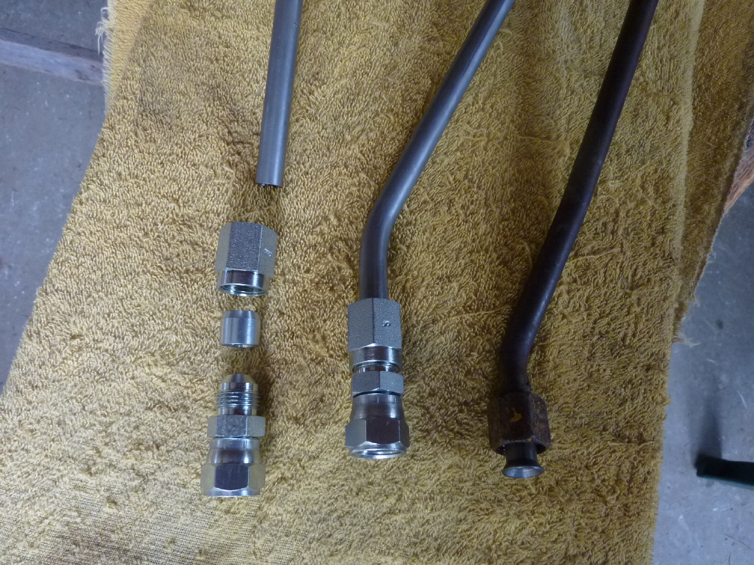

There's also these
27305 | Flareless Compression Tube Union
Available in same size or step-up/down, 1/2" unions are $4.38... Steve
There are lots of different tubing fittings, type of material and pressure ratings available.
Remember mine were purchased in Canada. The local hardware has compression fittings for around five dollars. They didn't meet my pressure requirements.
