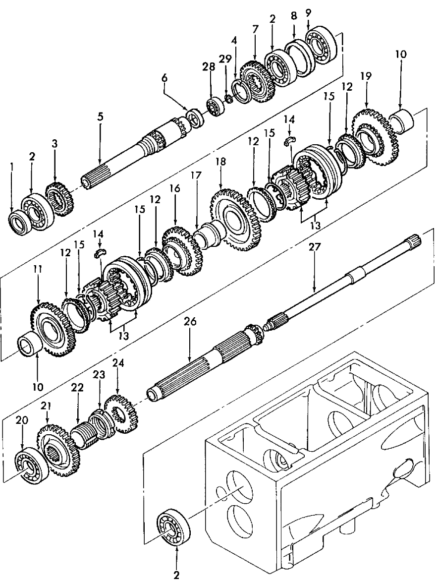

Any insight is appreciated. I'll attach a parts diagram. Shaft in question is #27.

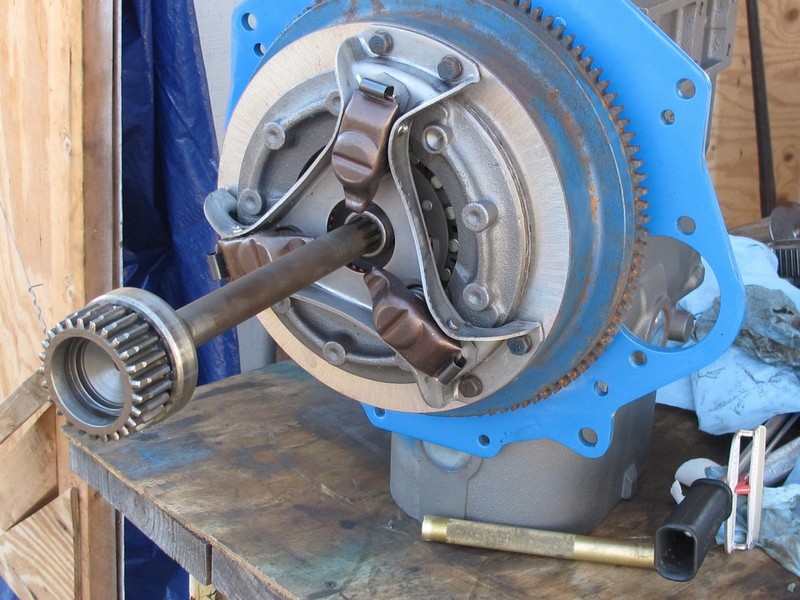

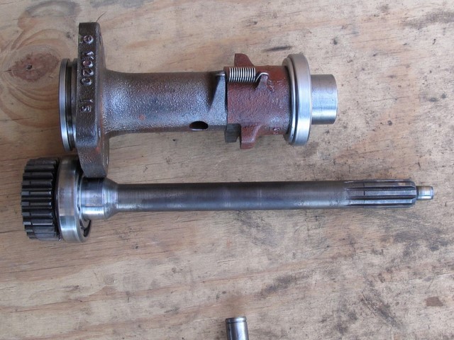

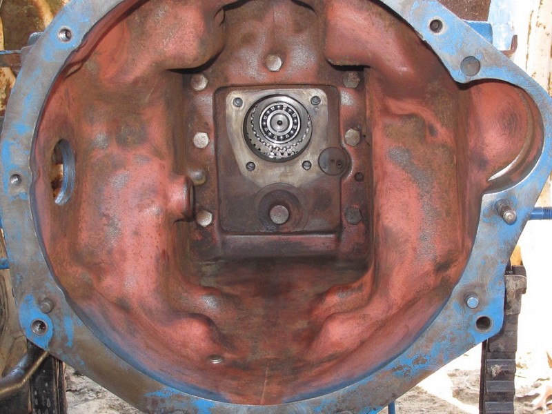

I was hoping someone with direct TC-45 knowledge would chime in by now. Attached you'll see pics of the same work on Ford 1700. Disclaimer; I yet to need to split my 1700 yet. Pics belonged to another individual with a lot of mechanical aptitude. He pulled the input shaft out from transmission to help it as aligning tool to position the splines on the clutch disk when he put the two ends together. The 4 bolt holes that you see on transmission case hold the input shaft in place. I looked at the your parts diagram and could not see the possible circle clip. I don't believe you damaged anything. Can you post some pics. Do you have the throw-out bearing holder the same as 3rd pic I Posted?

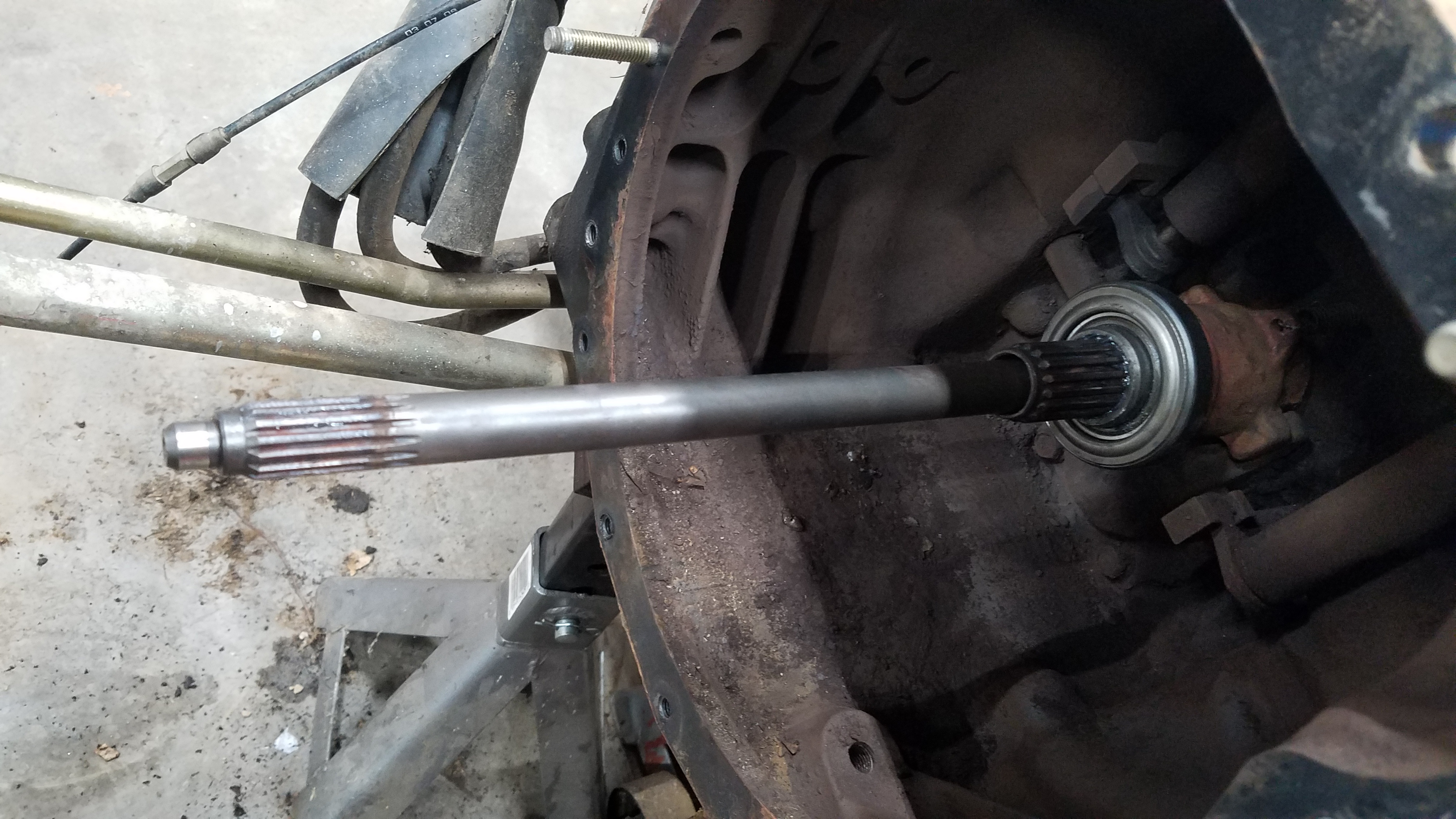

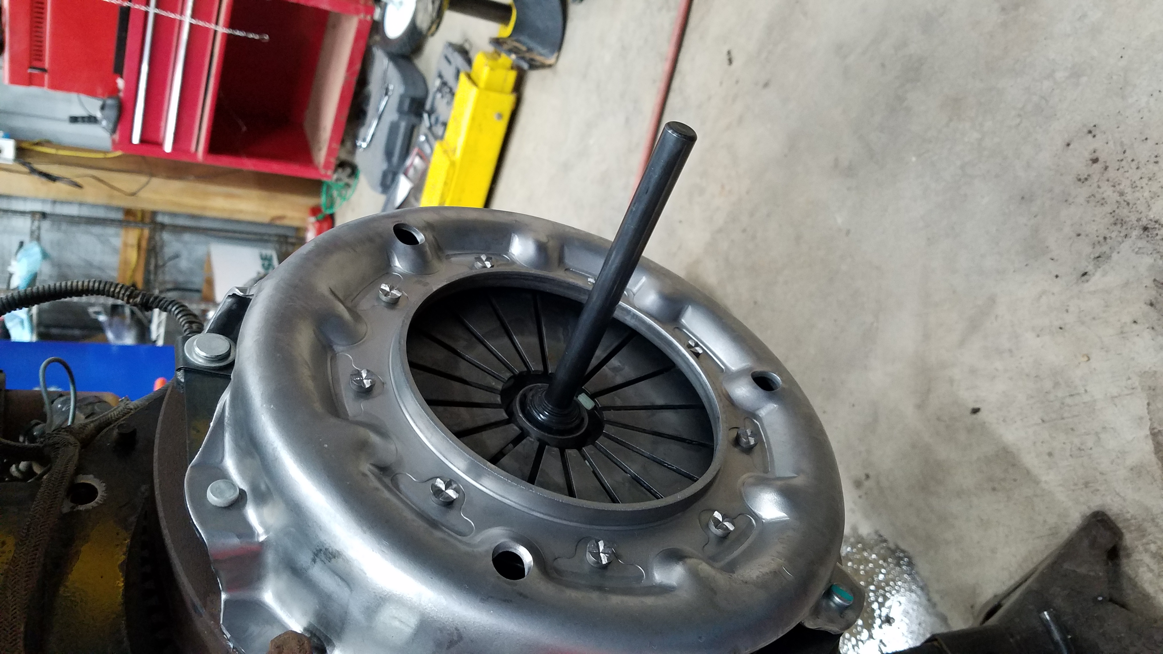

Thanks for the reply, JC. I've attached some pictures.
Yes, the release bearing hub is the same as the one you attached, but it appears the setup for the 1700 is different.
The setup on my TC45 is a nesting doll. The innermost shaft hosts the pilot (rod/shaft/whatever). This is the shaft that became dislodged during the split. That is the shaft that slides into the PTO damper that is bolted to the interior of the flywheel. This shaft rides inside of the shaft that connects to the clutch - the transmission input shaft.
The inner shaft can be removed with two fingers. It slides in and out very easily. When sliding it in, I don't feel anything rough as if anything broke. There are no marks on the shaft indicating any sort of trauma. I'm most worried about the possibility of a damaged seal somewhere up in there that will leak and destroy my new clutch when I get everything back together.
Here's a video of me pulling the shaft I'm talking about. Again, it comes out super easy. Video
I've attached a few pictures. We all like pictures!
Thanks again for the reply.
PTO input shaft pulled out. See the video above on how easy it comes out.
The input shafts in place. New release bearing installed.

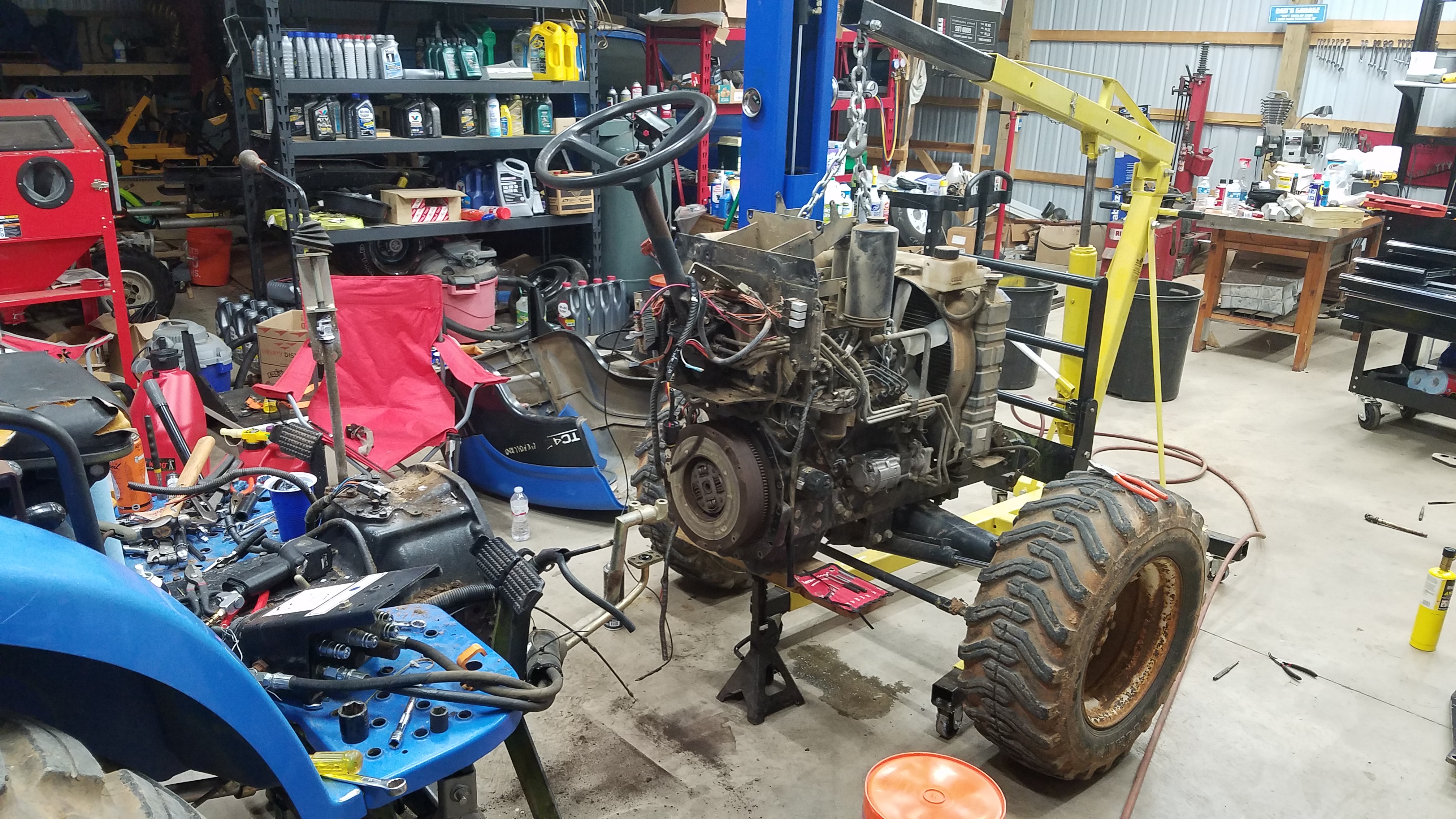

Fun times! If it all works when I'm done, anyway. :D

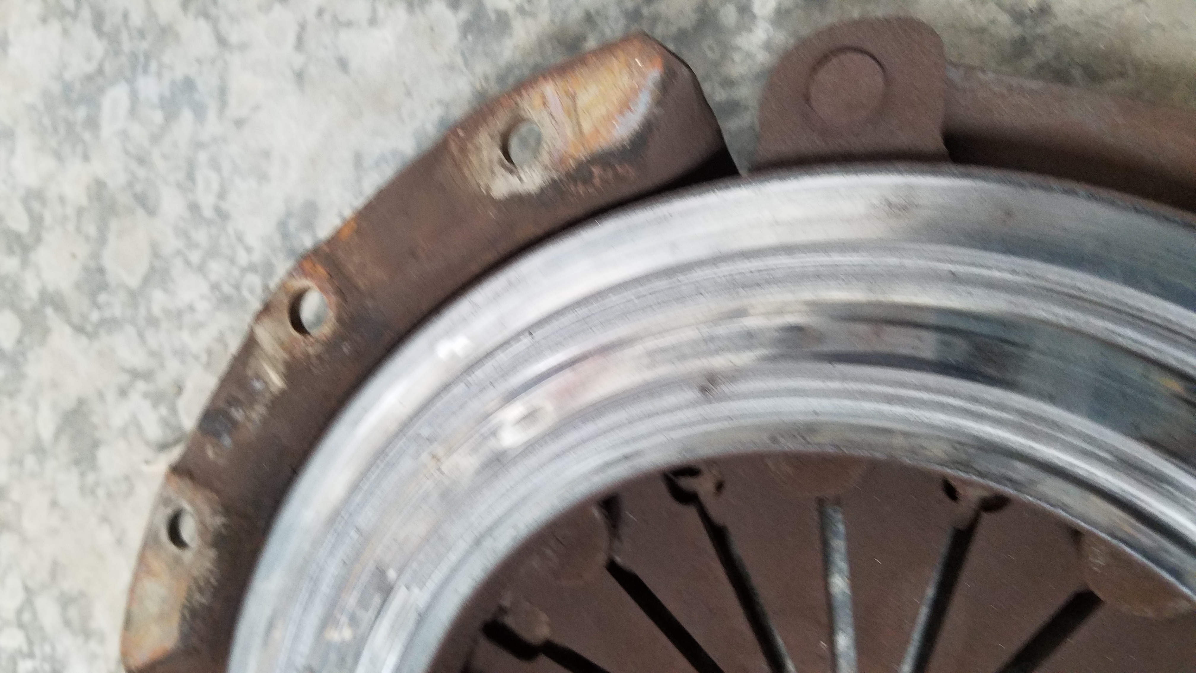

The rivets on the clutch were gouging the pressure plate.
The pressure plate side of the clutch. Down to the rivets. The flywheel side of the clutch disc isn't anywhere near this bad - the rivets are still buried beneath plenty of friction material. As such, the flywheel is fine.

The two have become one once again. It went back together pretty easy, but the clutch pedal didn't have enough travel to release the clutch. So, I pulled it apart and added some washers between the pressure plate and flywheel. That seems to have worked. I'll know once I go on that first test drive! But, pushing it by hand in the garage has given good results so far.
I was happy to get it back together, so I took the rest of the day off. I'll get around to the rest of it this weekend, probably.
