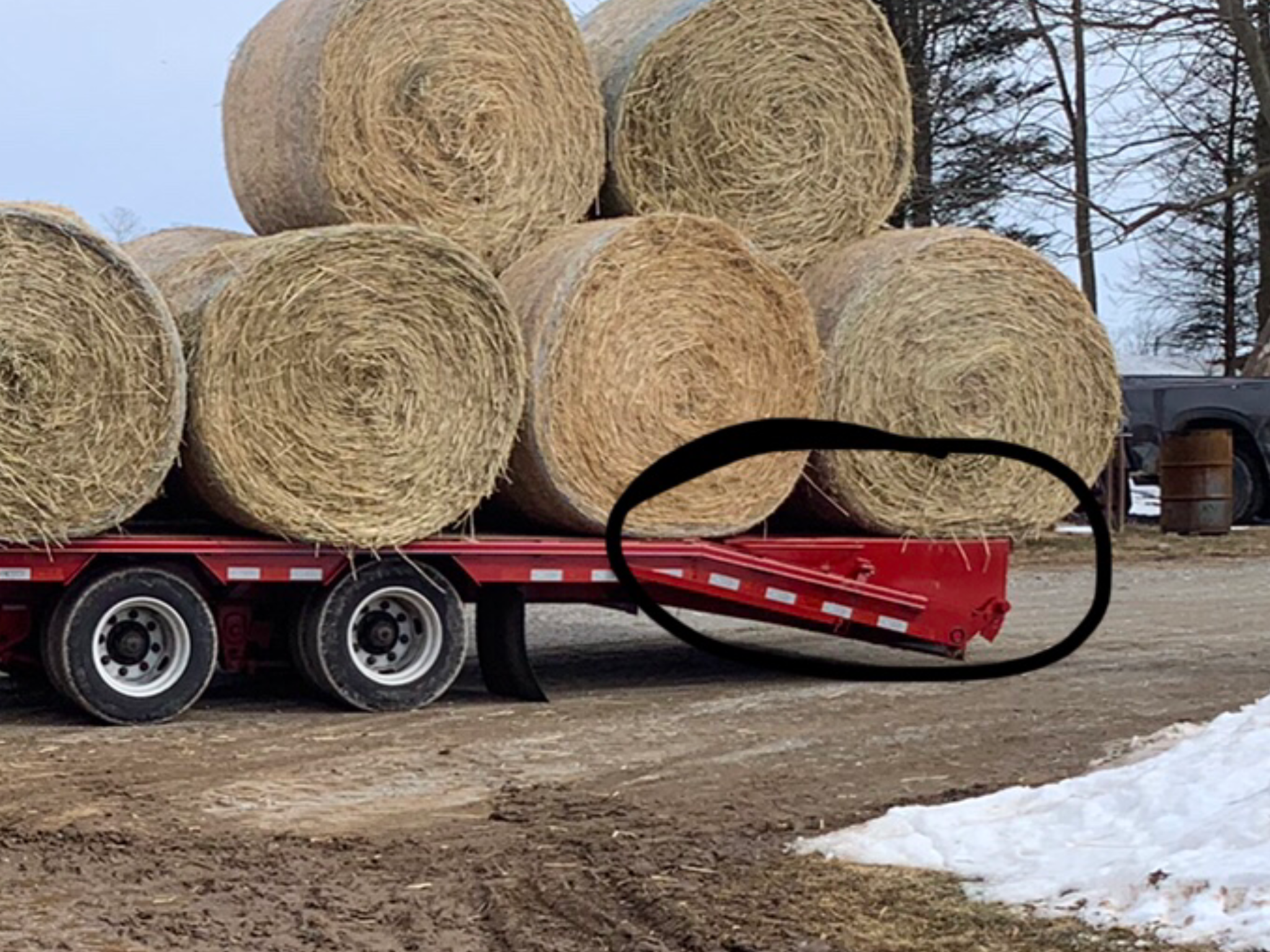

So now I'm looking at this ramp topic last night and see there might be a split "monster ramp" with diamond plate steel decking....
So that gives you the ability to load anything and also full length flat deck capability.....

Yep, I think I could handle these:
   / Split ramps for equipment trailers
#25
Have those on my 35' GN.
I want a smooth, but traction surface for 2 zero turns or other small wheel equipment when needed. Inverted angle iron may be a little rough.
