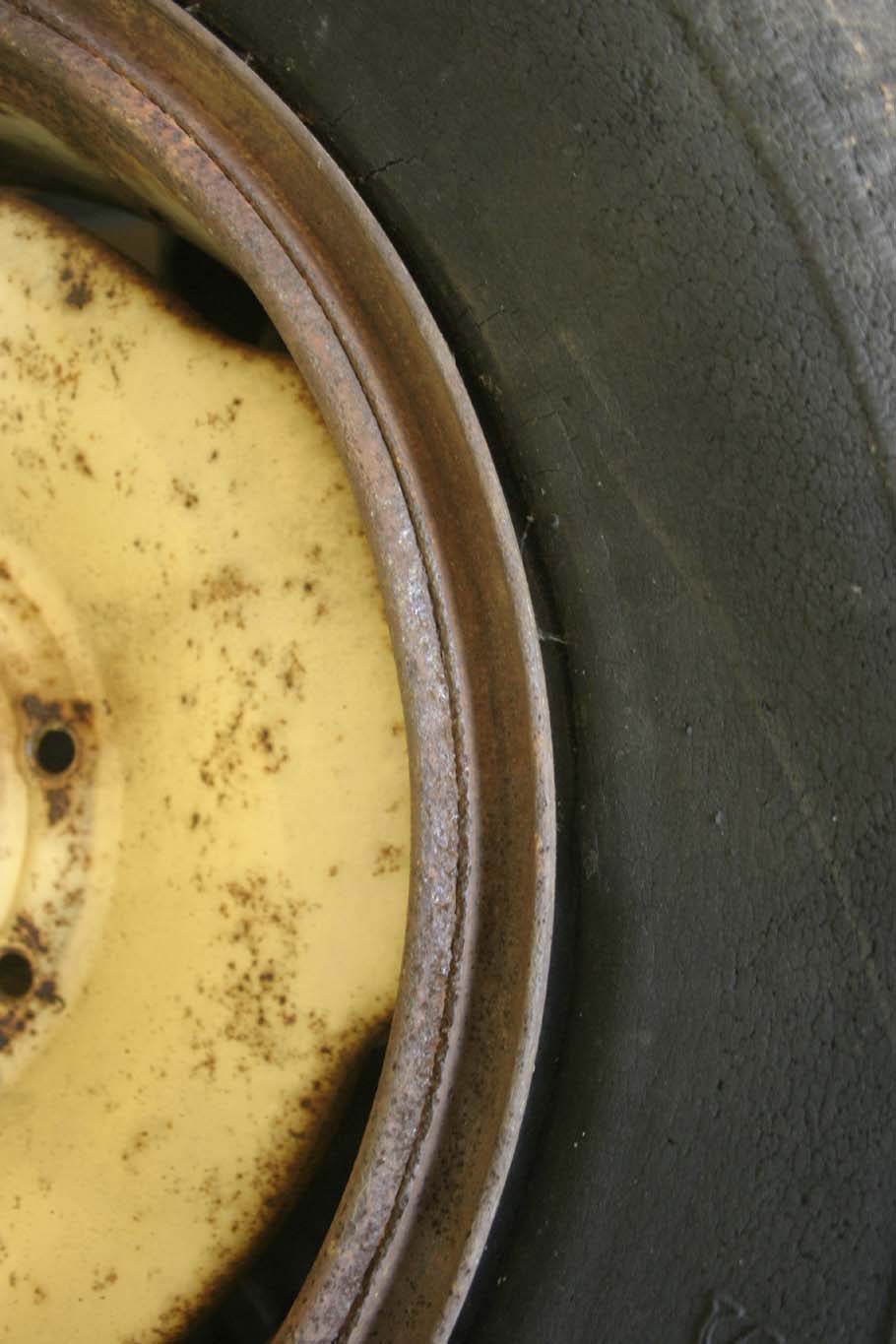

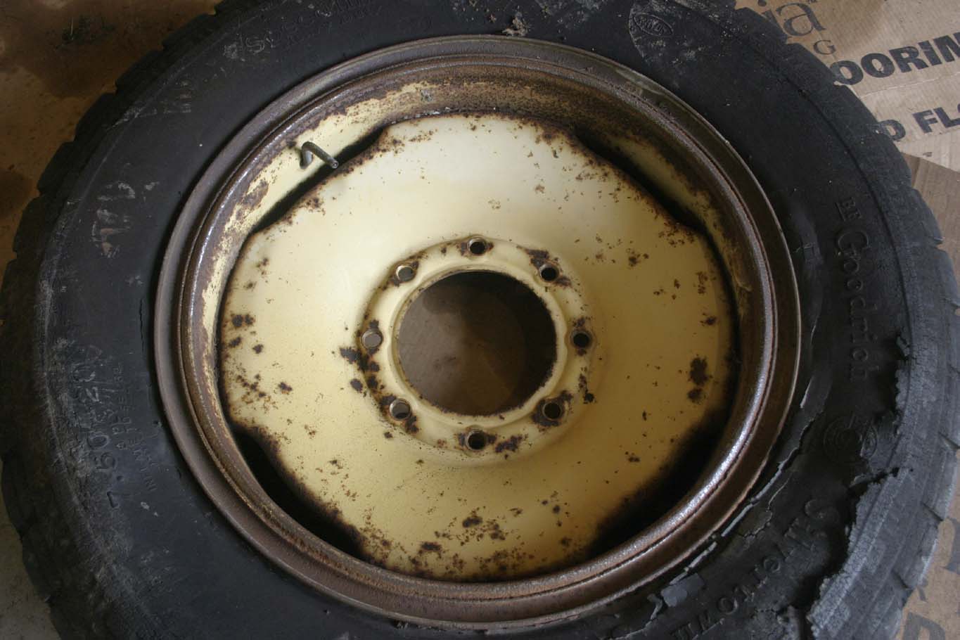

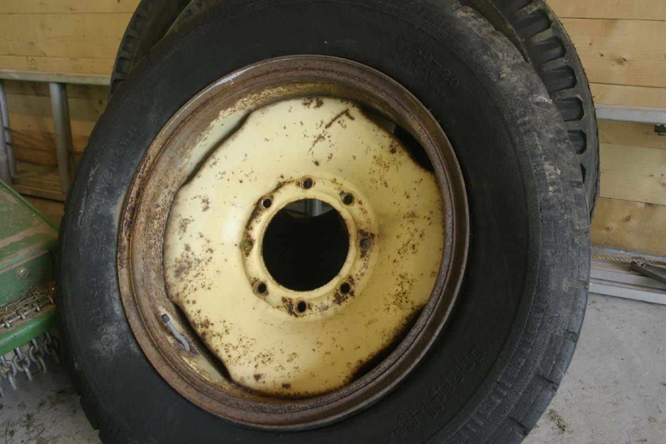

Here are a couple pictures of the wheels. This looks like a solid ring that goes around the rim. I don't see how it comes off. Do you think the rust looks too bad or are they worthy of being cleaned up?

If that ring had a break in it, and the notch mentioned by Iron Horse, it would be the "split ring" I've been thinking you had; i.e., the same as I had on my 1971 Chevy 3/4 ton pickup. And of course that's not what you have. Now I can't say for sure, but I think what you have to do with the ones you have is to push one side of that ring down into the "well" near the center of the wheel, then pry it off starting on the side opposite the one you pushed down into the well. In other words, you actually deform it temporarily from being perfectly round. And you remove that ring about the same way you would remove a tire from a normal wheel. While it isn't really necessary to cut the tire off first, it would make it a bit easier to push one side down into the well.

Whats on the reverse side of the rim Eric ? A 100 years ago i saw a rim with 2 sets of rings . The solid ring dropped on first which became the inner bead , then the tyre and then the split lock ring which formed the outer bead . As for the condition of the rims , from the photos they look in VGC .
/ Split rim Wheels #12
That's not a split rim, I think it was called a "two piece rim". Once you break that rim down you can remove the ring by prying it into an oval and off the main rim.
It's probably a little safer that a split rim but the mating edges must be in good condition.
Your best bet would be to find an old tire man and let him look at it and give you an opinion. Most tire places won't touch any of the old rims anymore because of the liability. The old style split rims are now illegal for trucks and trailers on the road and most DOT's even inspect for them.
