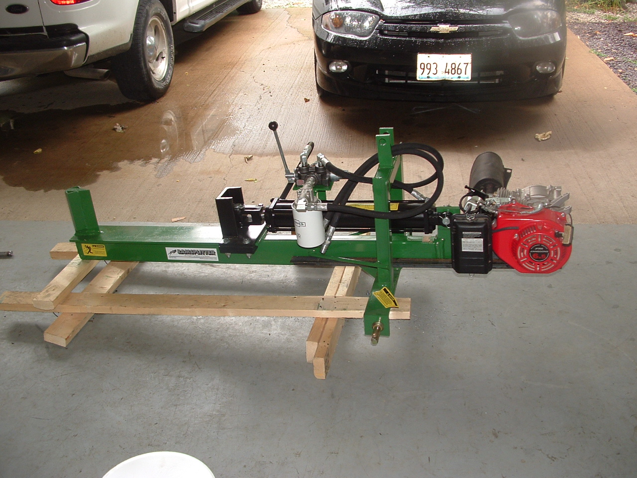

I have the gas engine ready to mount and the pump should be delivered today. I put the oil filter adapter on along with the filter. I'll be taking and sending some pictures soon.

The engine is mounted now. The pump has been delivered.
QUICK QUESTION??? When a pump turns clockwise to work, is that looking from the spindle end or the opposite end?
Thanks.
Joe
P.S. There are no markings on the case indicating direction.
   / Splitter
#15
The splitter is complete and works. I used a 5 gallon, thick plastic container for the reservoir. It does get air in it...I think adding more fluid would help.
I will be posting pictures soon, and disassembling for paint.
Thanks for all your help with this guys.
Joe

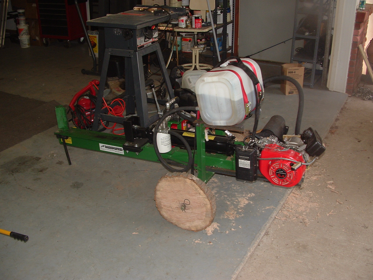

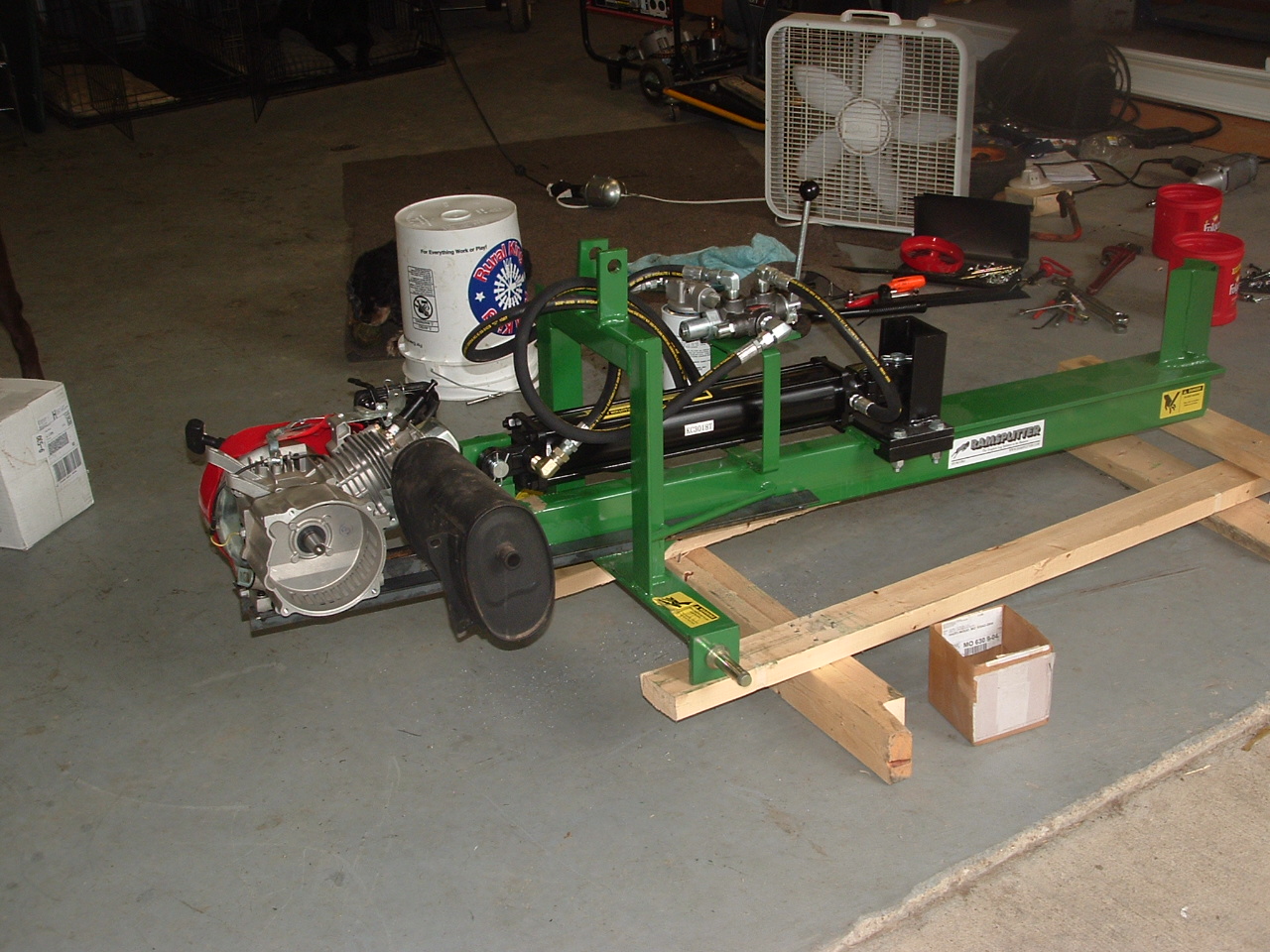

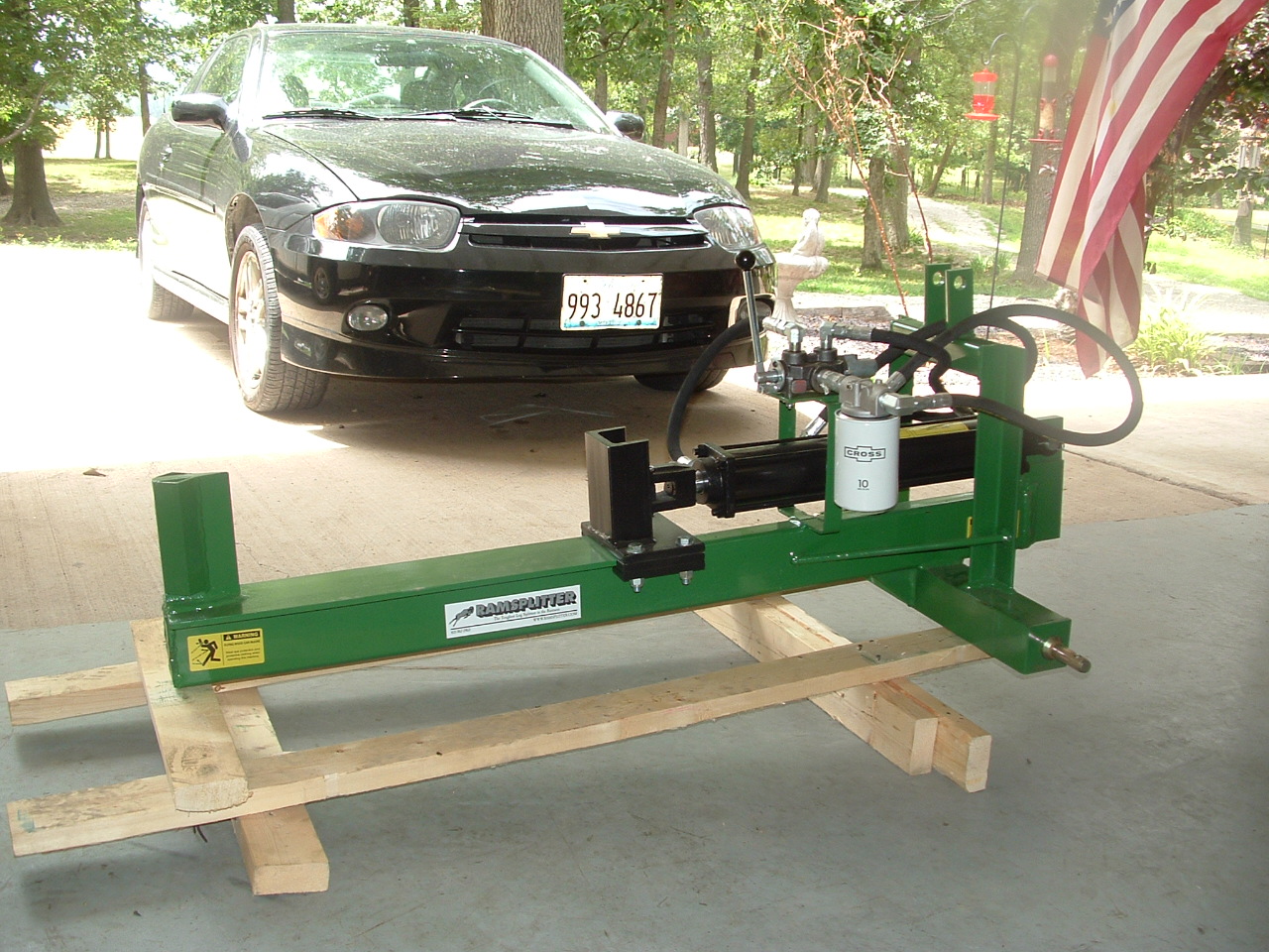

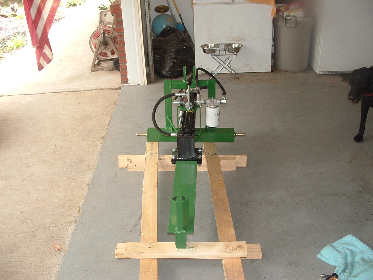

The pics are here. I've since changed the fuel tank and, umm, tires/wheels since these pictures. LOL:D I'll get some new shots soon.
Joe
