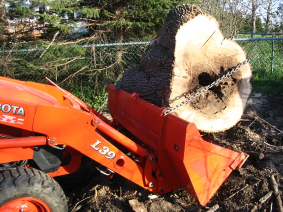

</font><font color="blue" class="small">( I think this baby is going to need the old wedge and sledge routine. Maybe since the center is rotted it will split a little easier. I hope so. My back hurts just looking at that thing.
Makes the L39 look like a little guy. It didn't even phase it though, loping along just above idle....Great machine.
)</font>
I removed a big ash just last fall. Solid all the way through, butt cut at about 30". Worked it up with wedge/sledge plus chainsaw. Also worked up the remains of an old, rotted in center ash year before. Both acted the same, Split nicely (except for the knots) but only after driving wedge well in - down to point 'oh oh, that isn't going to split' point when one more swing and 'pop'. Any knots/crotches got the saw treatment and the big clear rounds also got cut in half befoe wedgeing. While I am one who likes manual work (have a splitter but don't use it), there are times when the power route is the way to go.

IF the rounds are as long as you want them, and the problem is splitting them, all you need is your chainsaw and wedges. A 20 inch bar on your chainsaw will cut 40 inches if you cut on both sides of the round. Use the wedge to pop it apart the rest of the way.
If the rounds are longer than what you want, then use several wedges lengthwise down the log until the log is halfed or quartered. Then use the chainsaw to cut to length. You can cheat by cutting the log lengthwise with the chainsaw on opposite sides, then use the wedges. Don't be afraid to use as many wedges as you need for the job. It may take four or five or more wedges to do the job if the log is long.

Sky...I intend to use a large "eye" lag bolt. For the couple of really big one...I'll lag and lift with the fine hoe and positon perfectly on the splitter /forums/images/graemlins/smile.gif

Cut the rounds smaller. If you have them at 24" and cant handle them, slice them in half. If you still cant get it on the splitter they are a heck of a lot eaiser to split thin with a maul. I have done a couple of oaks for my father that were big. And there is a white oak on the property line that needs to come down. My 20in bar probably wont make it, soo this will be my first center bore.
10-12 inch splits will burn as well as 20-24 inch splits, better if you are really packing the stove.

Sounds like a good plan but don't get under one while its airborne!
