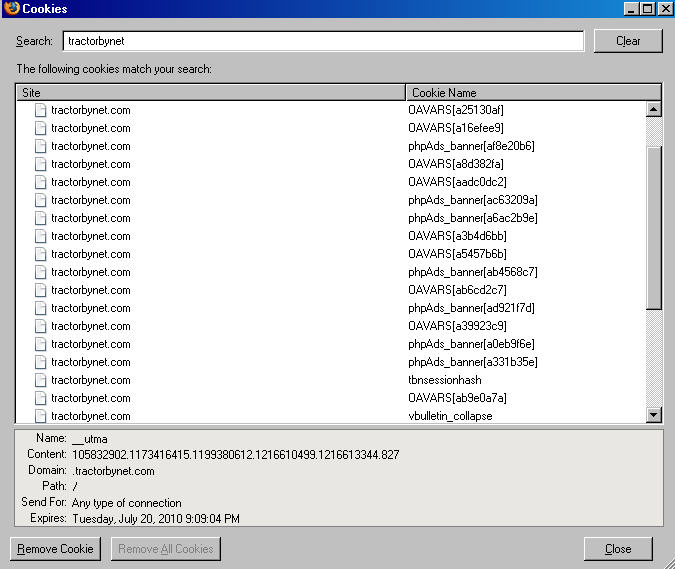

I have attached a screencap of my current TBN cookies. There are actually more cookies than show up in this capture, but you get the idea.
You apparently are looking via IE "show cookies" command. That is why I told you about the Karen's Cookie Viewer, because that will locate ALL of the cookies, so you can delete them. Did you delete ALL cookies, then re-login?

Once Firefox has been installed, navigate to the top menu bar "Tools" and select "Options" at the bottom of the list. Once that box opens, you can select "show cookies" and that will produce a list similar to what I have posted below.
Also, you will select the next check box, which is "Exceptions." Type in www.tractorbynet.com and check on "Allow". You might want to also enter tractorbynet.com, without the leading www., since that may also be one of the ways the cookies are setting themselves. I do not know.

When logged into TBN I have 32 cookies set. Two are tbnpassword and tbnuserid, both expire 28 Dec 2008 at the same time.
For the server to delete one or more of these, there'd have to be code on the server to determine which logged in user to send the delete cookie command to since it's not happening to 1,000s of other people.
The logical conclusion is this is happening in the browser not on the server.
