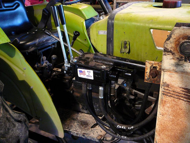

FWIW - in 2013 I replaced the original (dribbling) AICO loader control on the YM240, with a Prince lvt1gb5ab1 from Amazon. Both old and new are two-lever with float but the Prince mounts with the hoses coming out the bottom. That is valuable to me in orchard use with many obstacles overhead.
Both have the same control layout, curl-forward on the left stick with float at extreme forward. For another $100 there's an option for high speed bucket dump. I'm guessing that this adds the fluid removed, to the dump side of the cylinder, instead of just draining it back to the sump.

/ spool valve with float function? #6
Bottom, top, front, back and side. Just depends on how it's mounted. :ROFLMAO:
/ spool valve with float function? #7
... If you don't mind the levers sticking down instead of up.
Or, push the right lever to curl the bucket in.
Or, if you have the space, three elbows coming off each port.
Really, I had to study this before choosing the right valve.
/ spool valve with float function? #8
Mine didn't come with levers. I mounted the valve where I needed it then made my linkage and levers.
Some applications use a remote valve activated with cables. Just sayin' the valve doesn't care how it's mounted. 😎 Glad you got yours figured out though.
