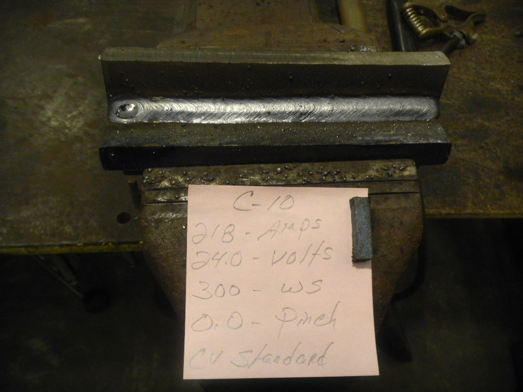

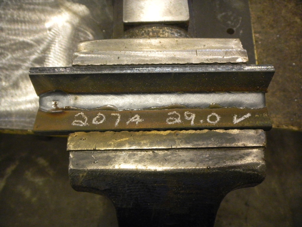

No! Spray arc is only good for high production work. Basically, it is a pain:thumbdown:. Metal has to be really clean. I played with it some, I was impressed with the speed:cool:. But it is not worth it to me!:thumbdown:
When SA speaks, welder hacks should listen. I was sort of curious about the whole spray arc thing as well. Case closed for me.

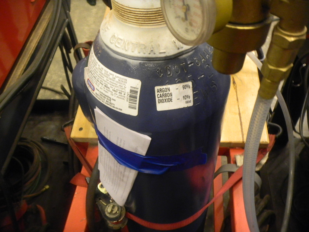

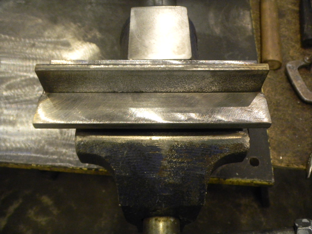

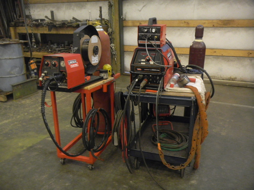

If you want some speed, check out metal core. A guy on Welding Web sent me a spool of metal core. This is very fast, and the metal doesn't need to be near as clean.:thumbsup:

I think it is rare that spry arc with .045 wire is needed for farm use, when you start getting into that size or bigger, it's mostly for high production and multi pas welding, .045-.052 is the main wire size at the shipyard, use on pulse mode and spray/mig on Miller 350s. I mostly use .030-.035 70s at home.
