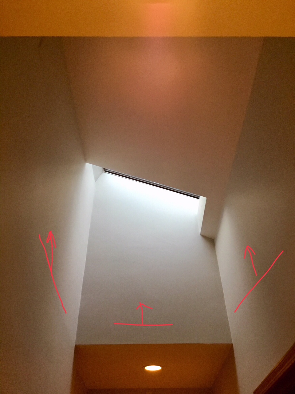

Not the skylights themselves, but insulating the columns (for lack of a better description) in the attic. The sheetrocked walls up to the shylights on non-vaulted ceiling. On the attic side, what is the best way to insulate? Obviously you cannot use blown in. Bats sag and pull away exposing gaps to the attic. Is spray on closed cell appropriate here?
   / Spray Foam Insulation #43
What R value are the skylights?
I do not know, they are existing. Surface area wise, the columns going up to the shylights are way more than the skylights themselves. At some point I may replace the skylights but as a separate effort than re-insulating the attic. If I had vaulted ceilings and skylights it would make more sense as Eddie says to remove them. But the non-vaulted ceiling geometry makes that more difficult and they are architecturally important (at least two of them anyway). Plus SWMBO says no way the skylights are going away.
   / Spray Foam Insulation #44
This goes back to what Eddie has mentioned several times. "Walls", meaning vertical surfaces require less R value than "ceilings", meaning horizontal surfaces.
So, if you are talking about insulating the vertical walls going up to the horizontal skylights I would say you need to stop air movement thru those walls. Beyond that, R value is of less importance.
So, if you are saying the vertical walls going up to the horizontal skylights are not insulated, I would say you need to stop air movement thru those walls. Closed Cell Spray Foam would best accomplish that in regards to an existing vertical wall.

I attached a picture of one of the skylight areas. I am interested in the insulation of the areas marked in red on the attic side. Below the red horizon line they are insulated by ceiling bats and I am thinking about adding blown in insulation on top of that as Eddie recommended in a post above. Above the horizon like line they are insulated by vertical bats between studs loosely supported by strings wrapped around the column going up to the skylight. Not the best fastening method. The bats over the years have sagged a bit and some sheetrock is exposed to the attic temperatures. One advice I had was to resupport and add another layer of bats horizontal. Reading this thread spray on closed cell seems to make sense. Since heat rises, these skylight areas could lose more heat than my walls depending on attic temperatures.

Nope, I guess not looking at his picture it looks like a conventional skylight boxed in with convention sheet rock construction.

Looking at the picture that was posted, I agree that spray foam is probably the best route to insulate the backside of it. I would probably buy a Froth Pak that is rated to cover about twice the square footage of the outside of the skylight and have at it. I would probably also pull the insulation back around the base so that you can foam around the whole sky light outside from top to bottom. The bottom part where the other insulation is I would just try to do a skim coat but the upper part you would probably want a couple of inches on.
Aaron Z
The above is probably the best solution.
However, If you have to use batts, you'll have a problem keeping them vertical unless you can staple them to the studs in that area. Another idea is to use chicken wire to tie the batts to for support before hanging them from the rafters.
Wind isn't a factor inside the attic area. The amount of air movement that happens from the vents isn't enough to create anything significant with fiberglass bats of insulation. I've only insulated a few attics with skylights and each time it was a little different. I put in fiberglass bats and staple them to the studs. Then I figure out where 2 feet of blown in insulation will come up the side of the skylight wall, and add a second layer of 24 inch wide R19 fiberglass insulation over what's inside the studs above where the blown in will go. Sometimes the R19 goes from the joists on up, it really depends on what it takes to get it into place. I've always been able to wedge this second layer in place so it remains fluffy, but tight with each other. Once that's all in place, I spray in the 2 foot thick layer of AttiCat. Years ago I used to use other types of spray in insulation and it required the mask and was very dusty. AttiCat is easy to work with.
I would not spend the money for spray foam for a roof with a skylight. They are such massive holes in the envelope that there is no advantage to spending top dollar for insulation when you have such a massive hole in your roof.

I agree that skylights do not make sense, but I bought the house, I did not build it. So they are there. The bats on the walls up to the skylights have partially pulled away from the studs and Sheetrock so I need to do something with it. The builder back in 1988 simply put up bats and wrapped string around the attic side of the walls to hold the bats in place. I bought the house in 2015 and there have been no leaks. We get a lot of wet days out here so the roofer must have done a good job. Interestingly the ceiling does have a vaulted area adjacent to two of the skylights and when we do get cold weather the snow stays on the vaulted sections of the roof longer than the area immediately surrounding the skylight area. The insulator did not do as good of a job as the roofer. This tells me I have enough loss through the side walls of the skylight column. Hence my questions. Thank you all for your input.
