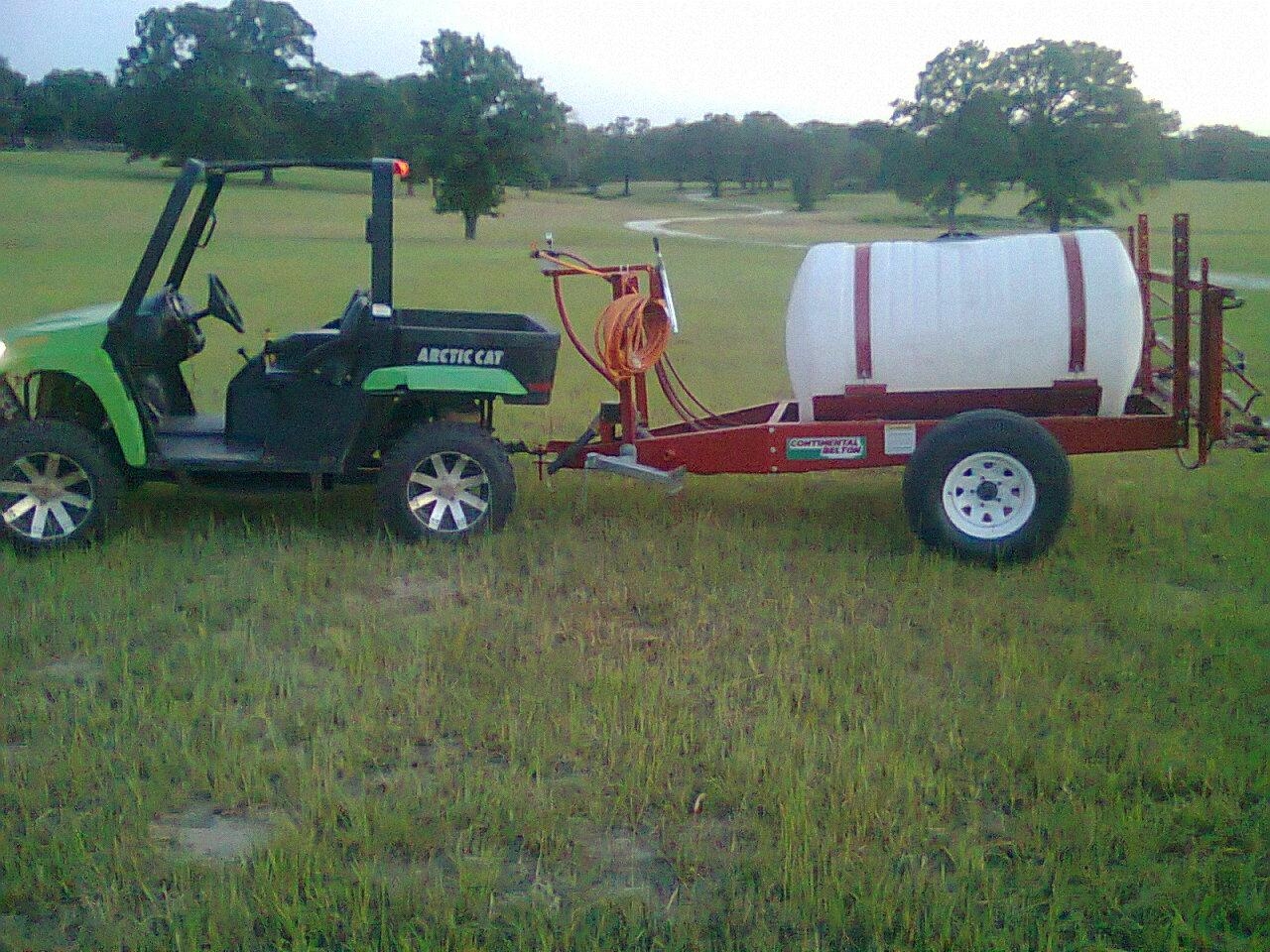

I went ahead and got the 300 gal.trailer with 21ft boomprowler00.JPG no the prowler its just pulling it back to the house no pto:D I would figure out what your gonna need to spray(how many gallons) on your 10acres. Mite not matter if you get 50gal.or 60gal still may have to make 3 trips.
Just my opinion I would go with the boom....
If I was spraying my 10ac.pasture(with grazon p+d) I would mix 1 and1/4 grazon to 150gallons of water,run 35psi,2nd gear-high at 4mph...Just an example
