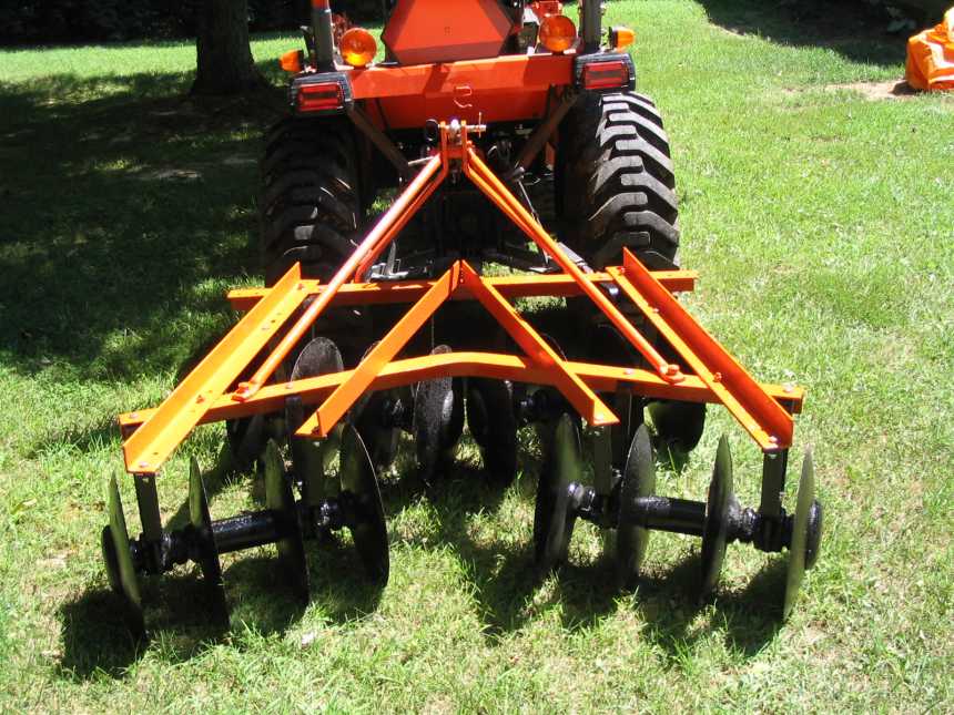

I called the closest place that can mix auto paints...told the guy what I needed... He told me paint was $43 a qt...$130 a gallon... EEEEEKKKKKKK !!!!!! GEEZE has the price of things GONE UP!!

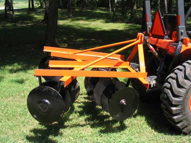

And a couple of pics...just to show the halloween colors...lol
