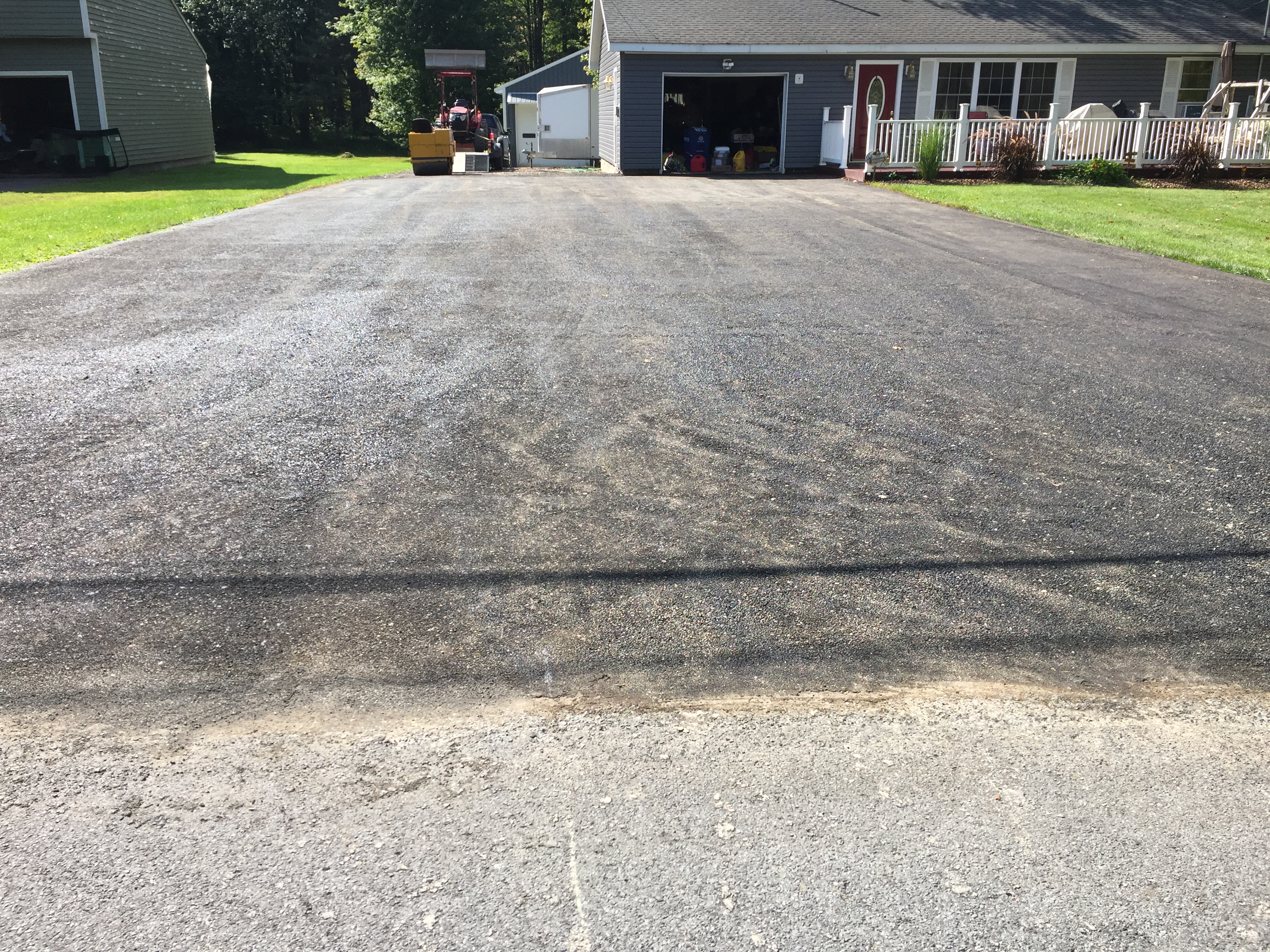

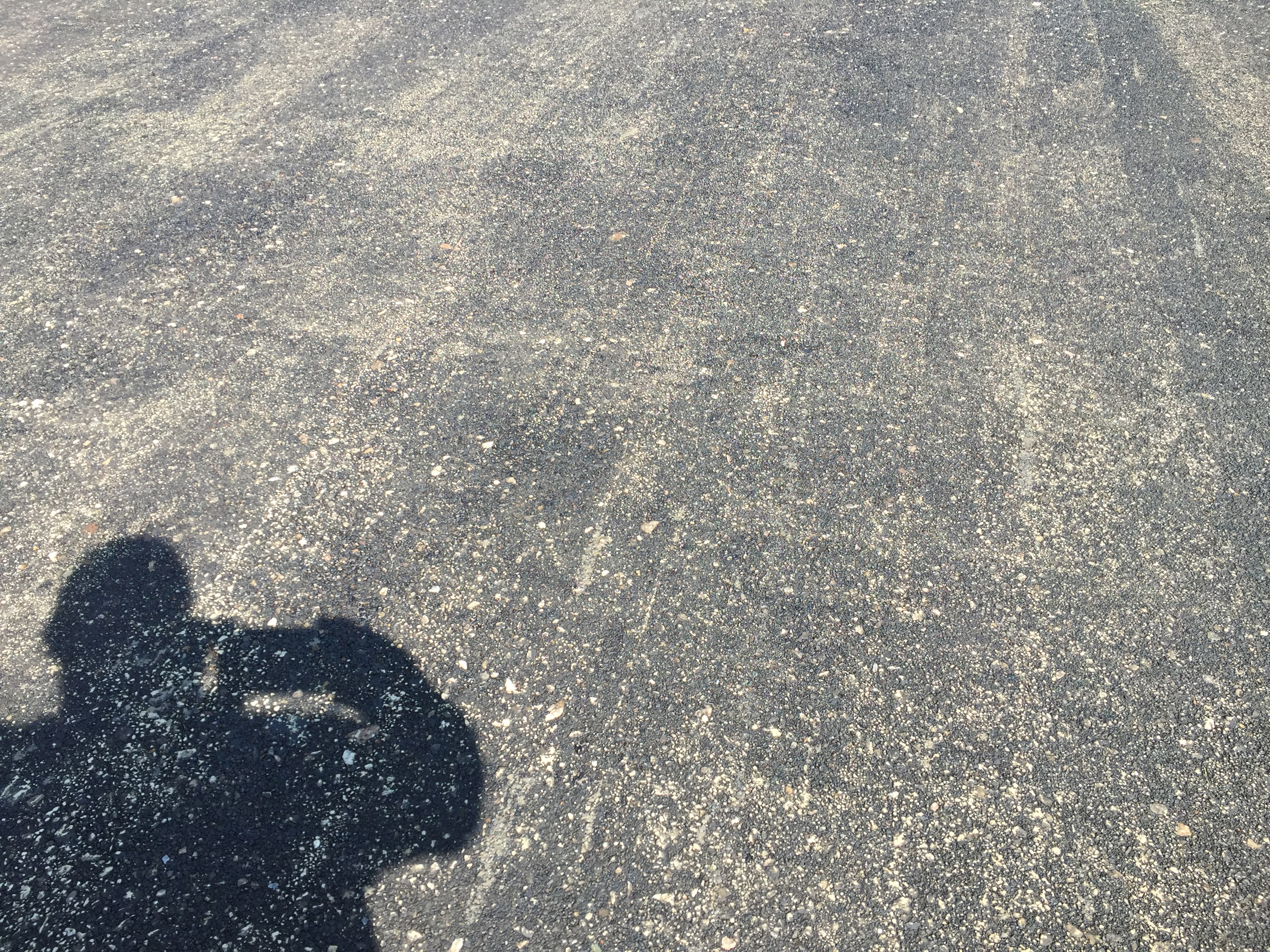

Finally got around to finishing spraying the whole driveway this morning. I have a little over 15 gallons on it. When the sun finally came out today and we got above 70 I had to turn the water on my roller as the asphalt got sticky. So far so good. IMG_7460.JPG

I would've thought the stuff to use on asphalt millings after it's put down is the driveway tar coating stuff in the 5 gal pails at HD.
I thought so too. You can see in the pics where there is a spot darker than the rest. I tried two pails and it peeled right up. The diesel did stick it back down better. It was kind of like putting sealer on gravel.
