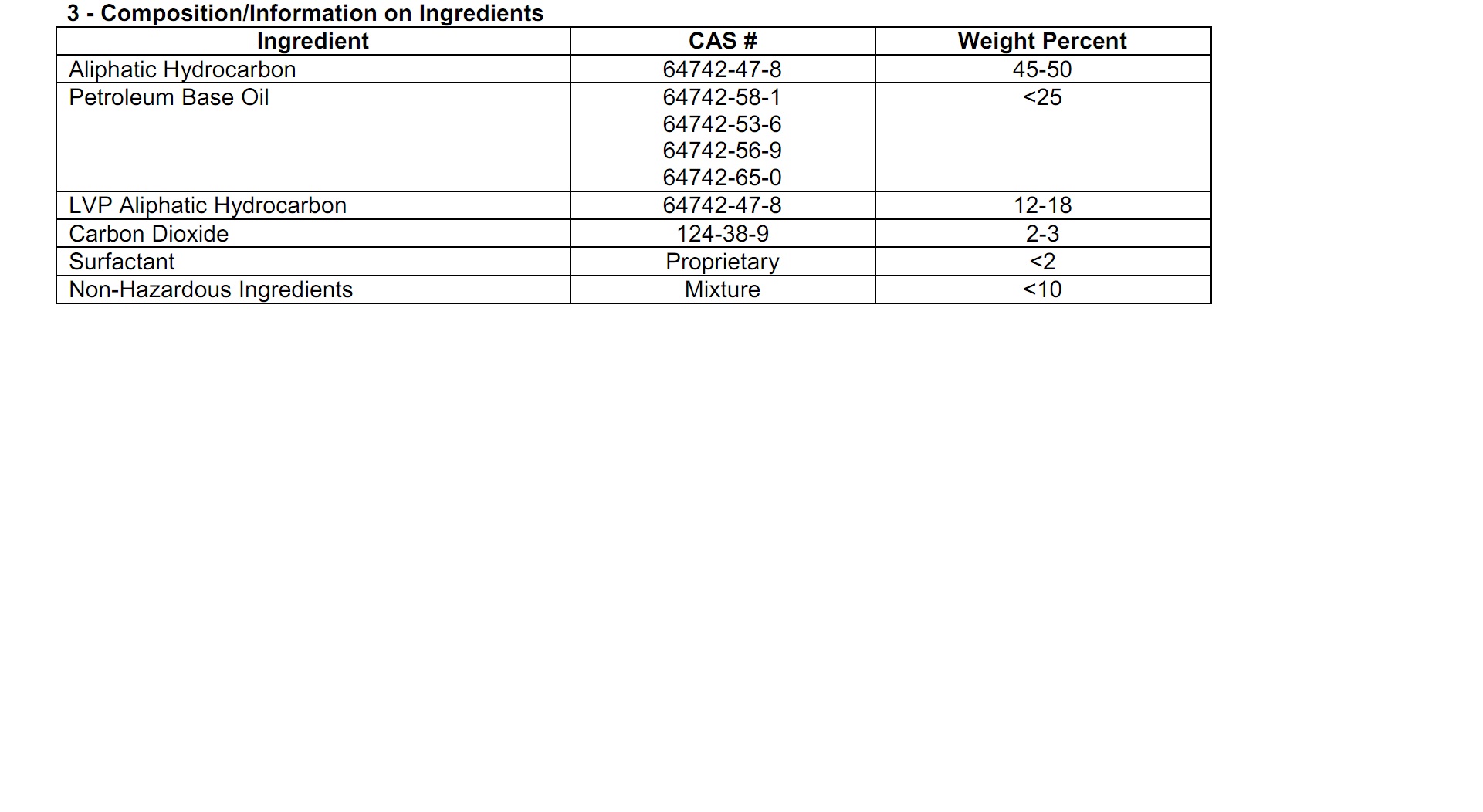

Yes Fluid Film works (ive used that too) but its also $49/Gal. For a quick washdown of a fert spreader its way overkill and honestly it might not work as well due to its thick sticky texture. Diesel, by being thin and not lasting as long, means the fert spreader is good to go the next time its needed without requiring any cleaning before use. The diesel "penetrates" the surface without any buildup of sticky residue.
The much talked about WD40 is essentially 90% petroleum distillate... Not much different that diesel IMHO.
