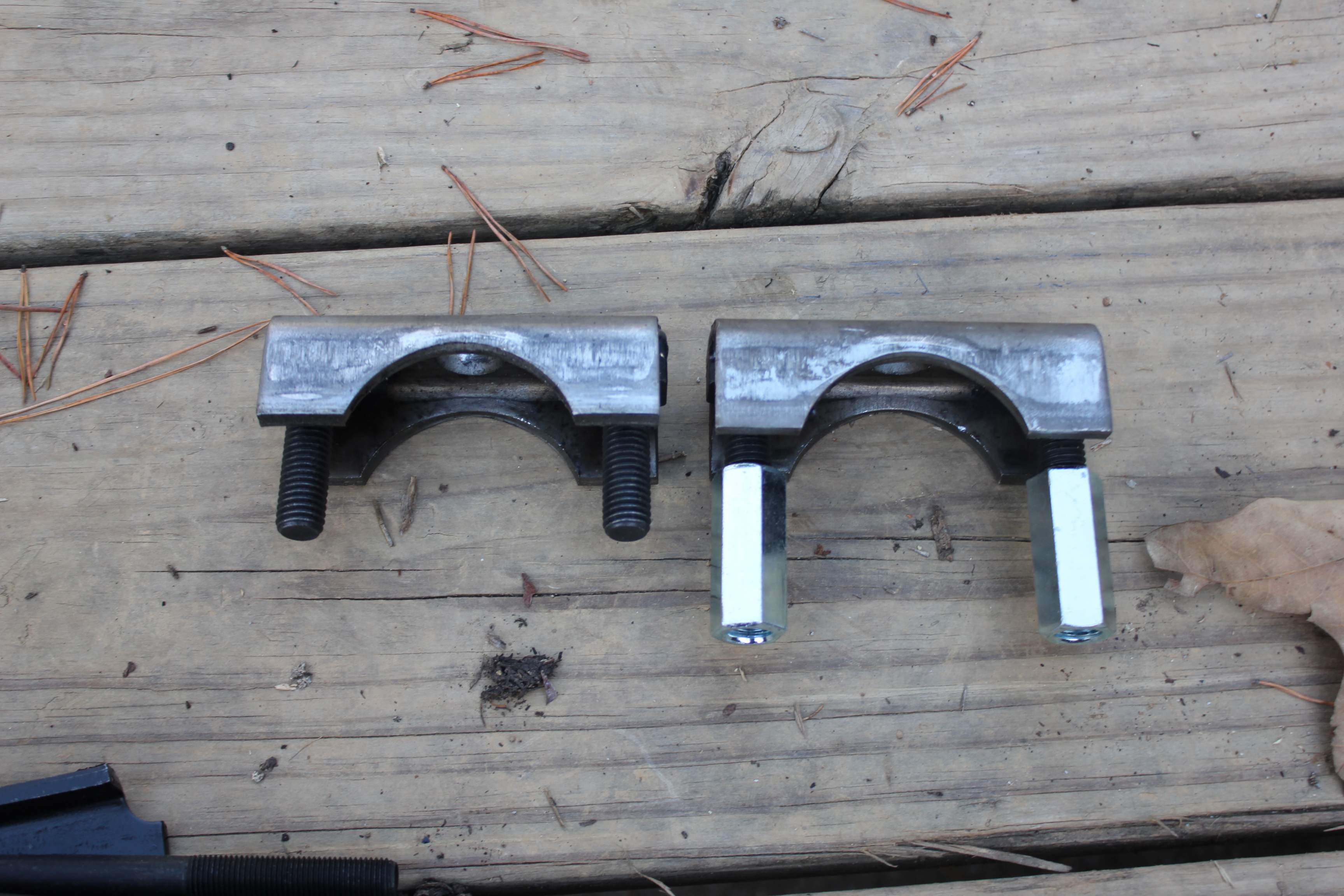

Here are the new spring perches provided in the Dexter kit. They're basically just standard spring perches with bolts welded to them--literally. Bolt heads and everything. Not even, like, all-thread. The one on the right has the threaded spacers installed. These spacers butt up against the existing spring perch on the other side of the axle, to transfer load to it, since this one will not be securely welded on. These threaded spacers are the "magic" that allows the kit to work without having to weld the new perches to the axle.

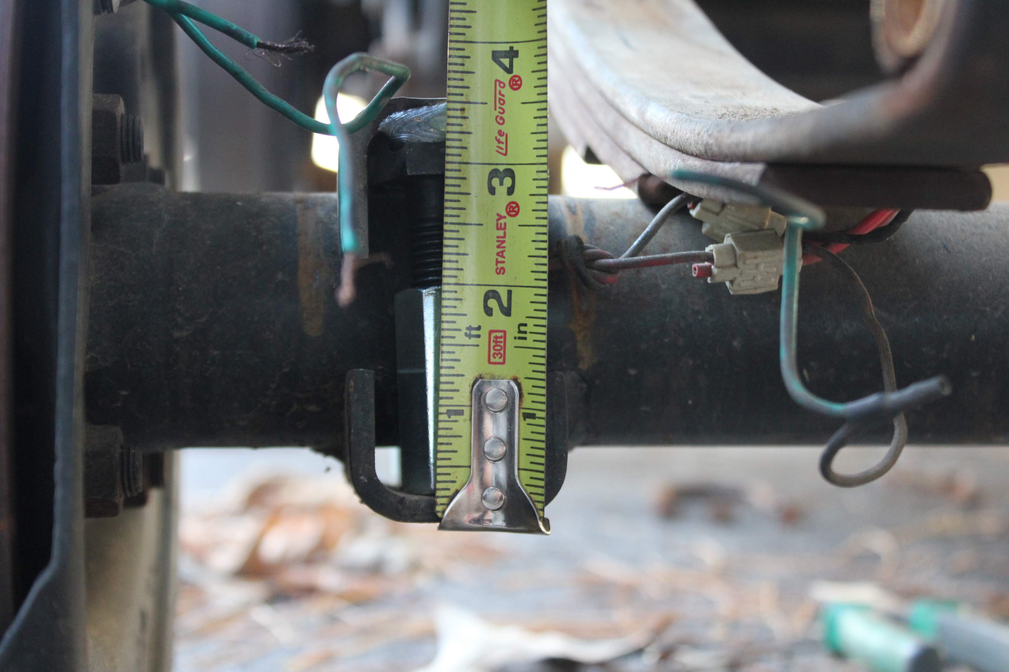

Here, you can see the new spring perch on top and the old one on bottom. The spacers must be adjusted so that the new perch is within 1/32" of parallel with the old one, and so that the new perch is tight against the axle. This was easier to do than it might seem like it would be.
Now that I see how it all goes together, I have a better sense of why tack-welding the new perches in place might be good. There is nothing except the pressure of the U-bolt holding the perch in place against the axle. There's no way that the perch is going to come out, but it's not out of the question that the perch could slide laterally against the axle. I dunno. The manual says, "strongly recommend" the welds, but the lazy man in me says, "Ahh come on. Surely the U-bolts will squish it all together nice and secure." What do y'all think?
I am actually attending a welding workshop tomorrow, so I put off the question of whether I'm going to weld them or not until after I get back. No way would I trust myself to weld on new perches, but if all I was doing was tacking it on to keep it from sliding, I might give that a go. I'd still rather save myself the trouble if I could, though.

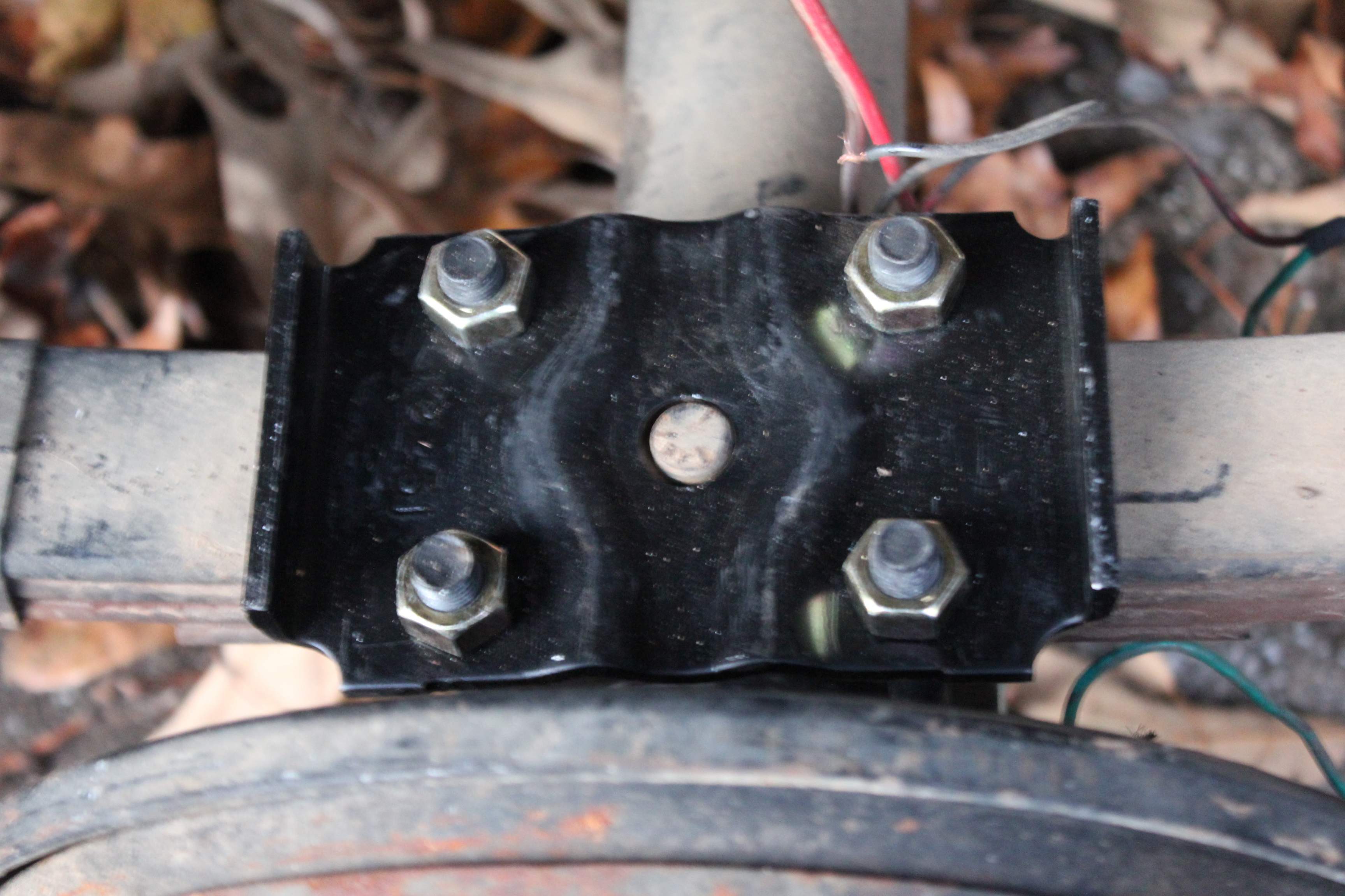

I got some time to do some more work on this project today. Reconnecting the axle required lifting it into position and then installing the U-bolts. This was hard to do by hand, so I propped the axle in place using a wheel chock as the final spacer.
Then I hand-tightened the nuts, ensuring approximately the same number of threads on each nut.
Finally, I used a torque wrench to finish the tightening of the nuts (no photo of that part).
A funny side-note. I had just convinced myself that I was confident enough to do the "optional-but-strongly-recommended" tack welds on the spring perches, and spent a little while practicing on scrap with various types of rod and amperage settings to try to dial in what I wanted. When I finished all that, I went to weld the trailer, and realized the fatal flaw in my plan: my welder's 6' power cord and 10' leads wouldn't get me over to where the axle was. And I had no interest in cutting the wiring and moving the axles. So I just skipped it. Perhaps an extension cord for my welder should be on my shopping list!
