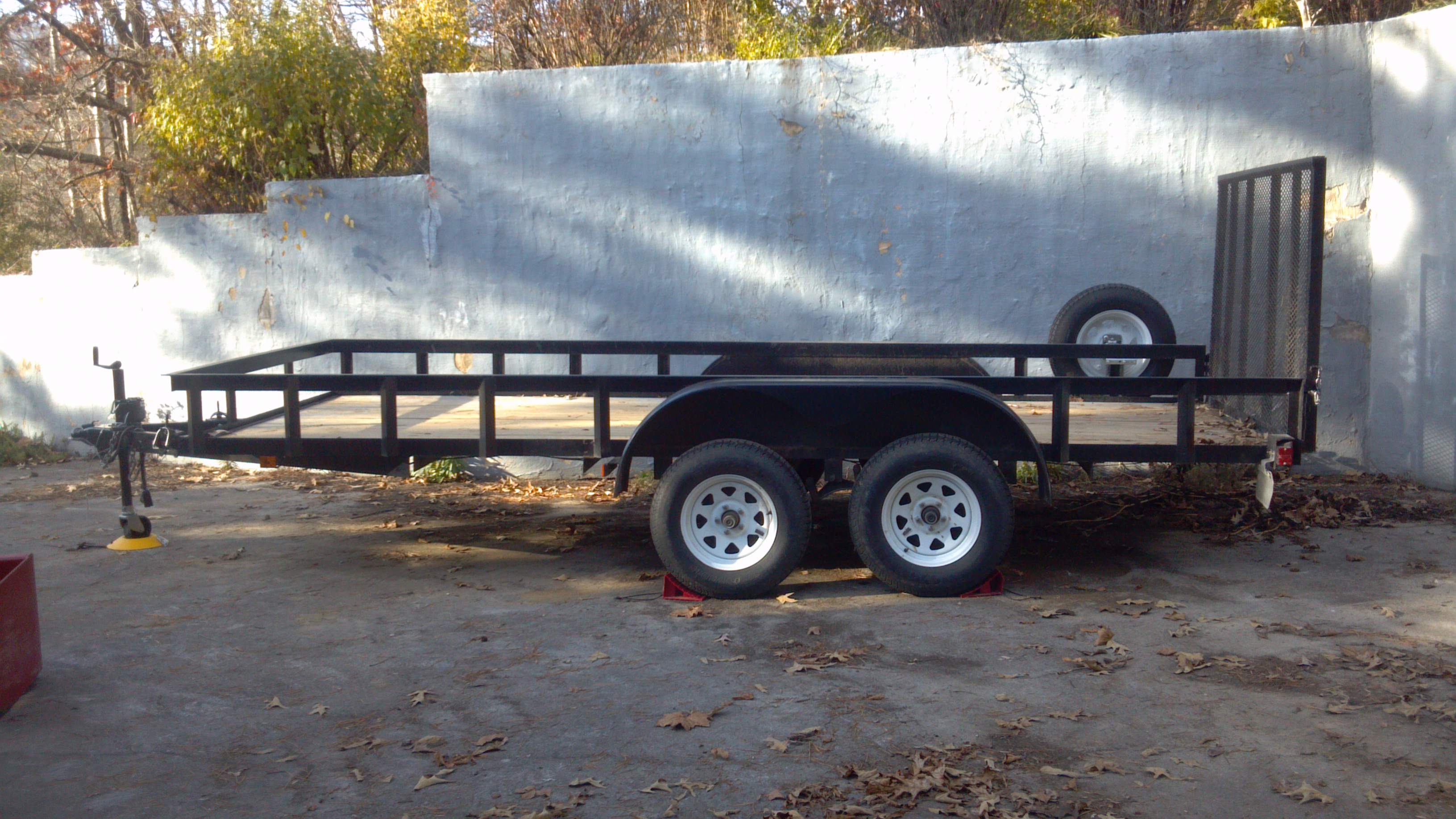

Ok thanks, did you get any pics of the your trailer as it sets now, did you have to change your hitch ball height?
Dave
   / Spring Over Axle (SOA) trailer conversion
#27
I took a picture for you today, Dave. Unfortunately, I don't have a "before" picture for you to compare it to, but just imagine it 5" lower ;)
I did have to change the hitch ball height, but that was sort of the point. With the ball at its old height, the torsion bars of the WD hitch scraped the ground. I actually had to buy a much longer shank for my WD system in order to get the head low enough to let the trailer ride level. Raising the trailer let me go back to the original shank, which is significantly lighter. You may think I'm just whining, but the difference in weight between a 6" shank and a 13" shank is probably 30 lbs. They're solid 2" steel.

I am sure it is set up the way you want it now but to me it just looks funny with all that room in the wheel wells. Looks like some of the 3/4 ton trucks that certain brands make and put tiny little tires on.
Chris
#30
The problem is, it is simply unusable with a WD system at the ride height that it was, and I can't go over 3500 lbs on my current truck/hitch without a WD system. I suppose I could have addressed the issue with a class V hitch and no WD system, but there are other benefits to a WD system that I would rather not give up. Also a class V hitch runs about $300, while the SOA conversion was about $100.
If I'm really motivated, maybe some day I'll grind out the tacks holding the fenders on and lower the fenders...
