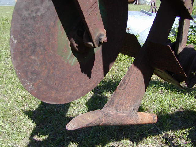

I have plowed in water lines with this old gopher poisner. You can glue your pvc pipe together & let it dry, then attach to the rear of this & plow it in, if you do not have tree roots or rocks.
Once it was plowed in, I could slide 100/150' of pipe through the ground as if it was laying on top.
