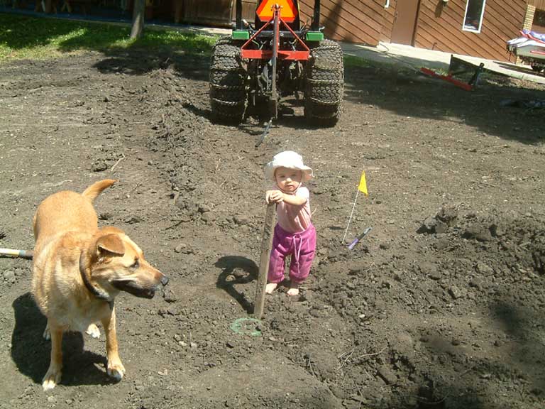

   / sprinkler systems--anybody tried it? #22
Photo from last summer. Pulling poly sprinkler pipe with sub-solier.
My helpers.
They all look good, but only the green one was very helpful.
- Rick

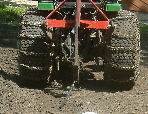

   / sprinkler systems--anybody tried it? #23
Detail of pulling setup.
Poly pipe is tied to bottom of subsoiler with bailing wire.
Leading edge of poly is lugged with a large bolt.
- Rick
   / sprinkler systems--anybody tried it? #24
I have an older pt-1445 that I use for just about anything, including trenching. I have PT'S older trencher/stump grinder. It trenches to about 12" I use a three point subsoiler also. Roots are the worst problems that you will run into. After you run the subsoiler the length of your run, go back to the start, hook up a a chain welded to the cap of 3/4"
threaded fitting or the size that you need to the subsoiler. Glue the pvc using cleaner, and the blue stuff, it dries in about 2 min. Screw the pvc to the threaded fitting, Start lowering the subsoiler gradually to the depth you want and run down the same line. when you get to the end, pull a little extra past the stop point. I have done quite a few of the these systems from the basic valve to the electronic controllers . It's mostly common sense with a little experience.
j.j.
