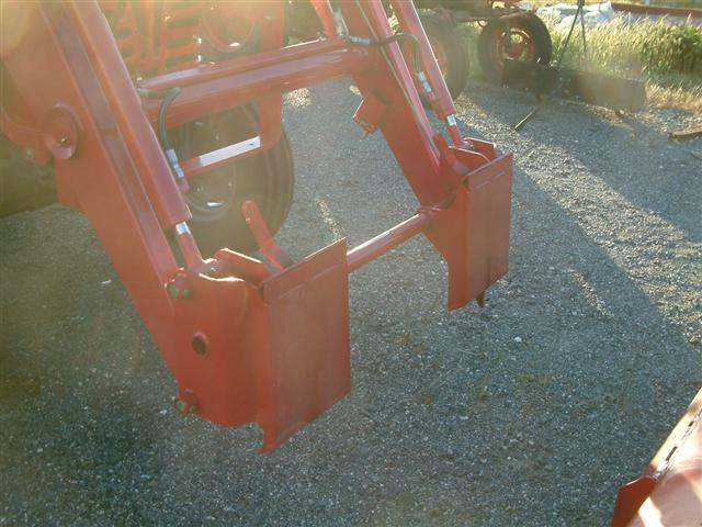

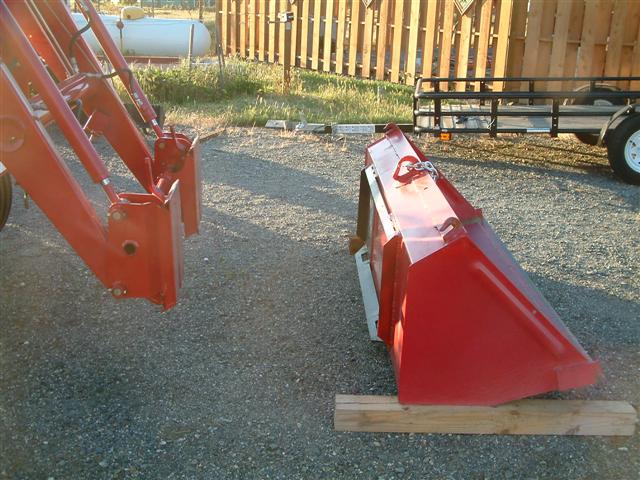

I assume your FEL as a skid steer quick attach adapter on the ends of the arms. Here's the QA on my Mahindra 5525

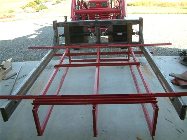

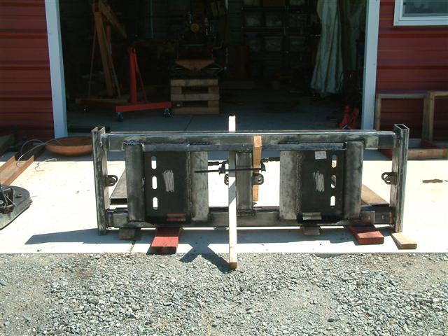

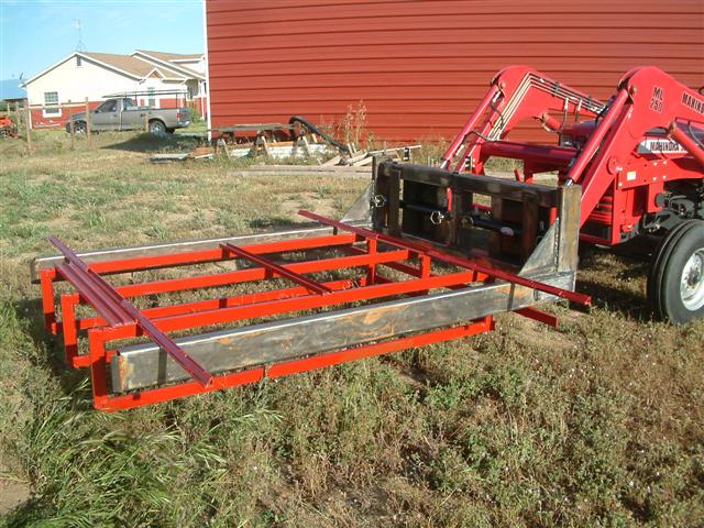

I couldn't afford a store-bought accumulator-grapple, so I made my own. It's an 8-bale squeeze (2-twine small bales) with a detachable accumulator that
rides on the arms of the bale squeeze.
You can get an idea of the design of the accumulator from these photos.
The bale squeeze has a skid steer QA plate welded to its backside
The accumulator was pretty easy to build from rough sketches.
View attachment 185668View attachment 185669
View attachment 185670View attachment 185671

I have about $1.5K invested in that homemade bale squeeze/accumulator- includes the steel, hydraulics and $125 from eBay for the skid steer attach plate that's welded to the back of the bale squeeze. It was a winter project several years ago.

Situation: bales scattered over the hayfield--use the accumulator to gather bales in groups of eight. When this step is done, remove the accumulator from the squeeze (it's detachable) and pick up the bale groups one at a time and stack on transport device (generally a flatbed trailer). Once that's done, my job is over (I have no need for baled hay around my place--no animals to feed) so I don't get involved in unloading bales.
That photo I posted doesn't show the four brackets that are welded to the tops of the squeeze arms (two on each arm) to attach the accumulator.
