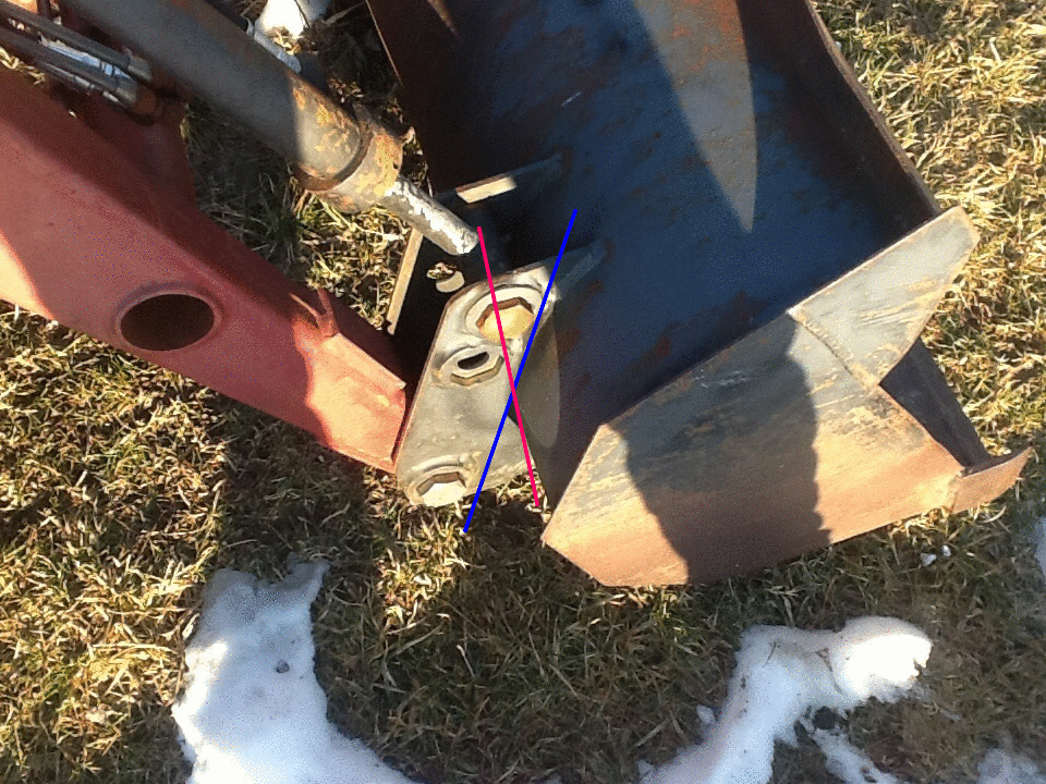

If you simply cut the blue line in your pic and welded the new plates on there for both sides, you would have exactly the same roll back as you have now, just an extra couple layers of plate in between. If you have oodles of dump angle to sacrifice to gain additional roll back, I'd consider following 1/2 the blue and 1/2 the red lines along the back of the bucket keeping the ears as big as you can. Fill in the triangle that is left between the 2 tips of the now removed ear to get back to a straight surface to weld onto your new QA plate.
I'd really think twice about making new ears. Why cut those perfectly good ones off, toss them in the scrap only to make them again???

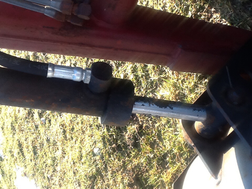

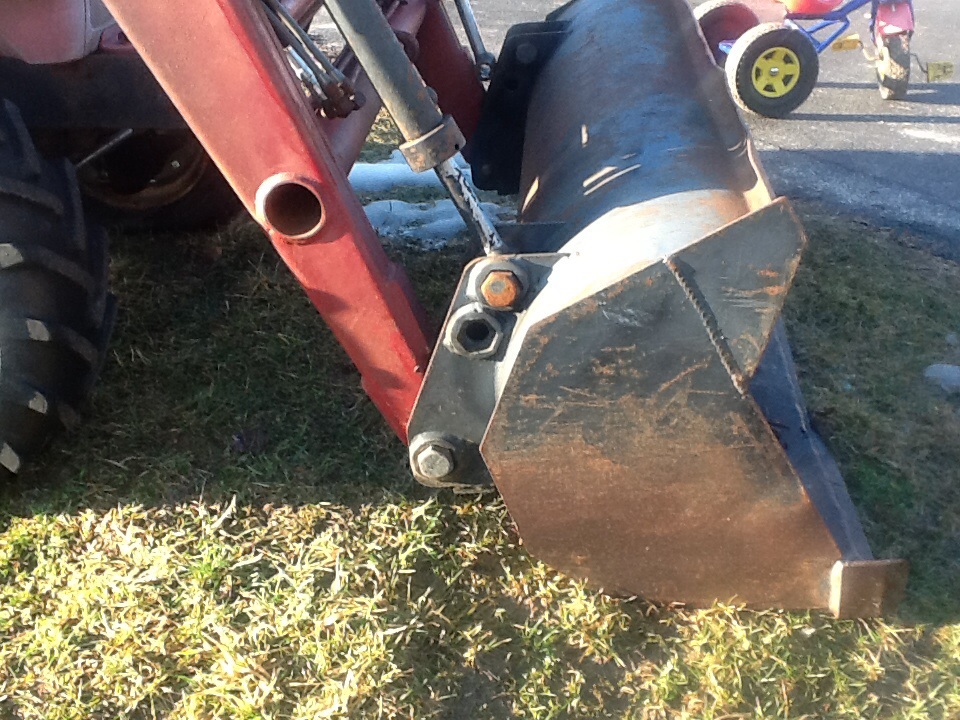

The pic I posted already had the curl cylinders retracted all the way. It doesn't have much roll back as is.
The cylinder rods could be shortened 3-4" but that seems more trouble then it's worth.
If i cut on the blue to save the ears then I would have to add a wedge shape piece to them get the right angle on the latch boxes, I would then have to add an opposing piece to the bucket to get the angle right for the adapter plate.
It seems like less cutting and welding to just make new ears and cut the existing ears at the proper angle for the adapter plate.

Doesn't seem to have much roll back at all. Are those alternate pin holes for the curl cylinder, would it have more roll back using them? If so, would that be a better starting point for planning the ssqa modification?
OK, next raise the loader all the way, dump the bucket all the way and take a side view.
Yes, that's exactly what i was trying to describe.
I have to disagree with you on that one. Cutting 8 triangles and welding them in vs cutting 4 new plates for the ears, drilling 8 big holes in the perfect location and then adding the build-up for the pin bosses.
