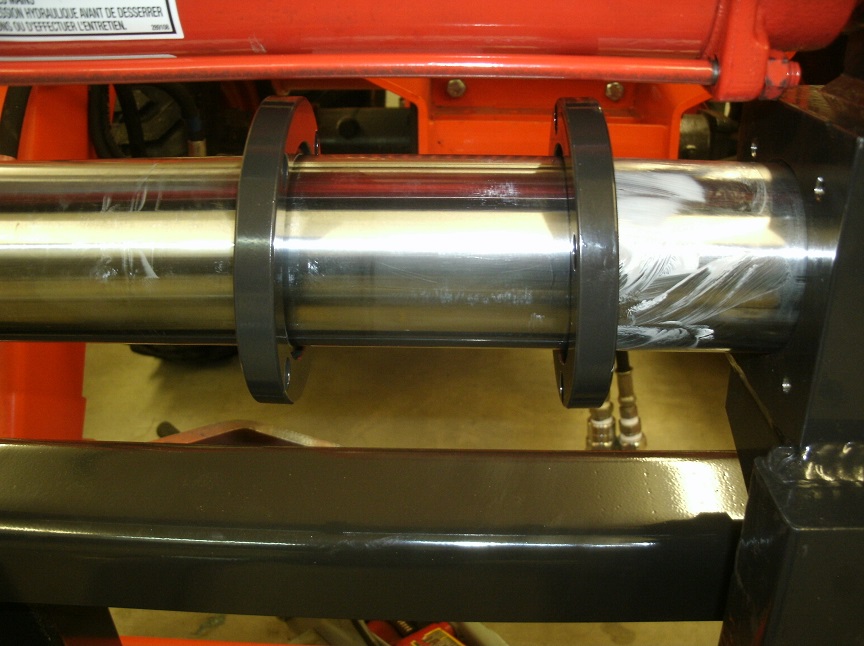

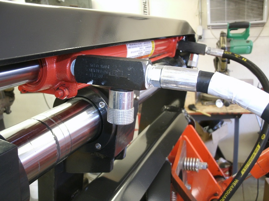

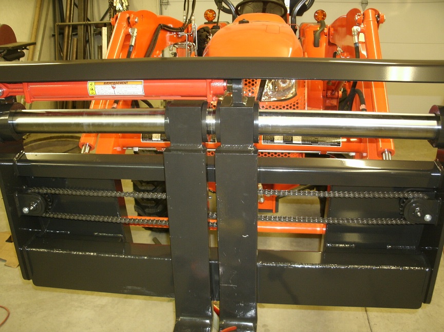

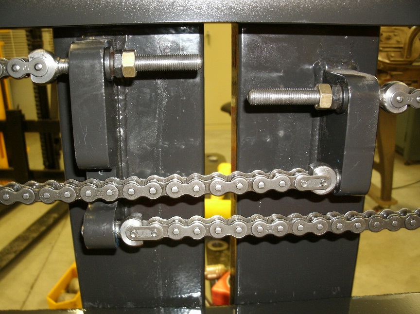

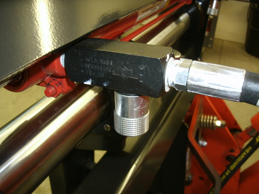

Assembly day has arrived. Kept reminding myself during the week to remember to load the wiper seals on the shaft before attaching the forks. (Okay, I forgot) Otherwise, assembly went real well. I got a couple of Parker flow control valves off of Ebay so I can tune the speed of adjustment both ways.
Took it outside for sea trials and cycled it a few times to get the air out of the cylinder. Adjusted the control valves until I had the speed the same in both directions. Was a little 'choppy' until I added some 30wt oil to the support blocks and it smoothed right out. That answers my question to which direction to go.....oil it is!
My wife took some video of it in action and I will try and post it tomorrow.

   / SSQA fork build #134
Yep, better than the best! :thumbsup:
   / SSQA fork build #135
Very nice ! Very industrial looking quality.

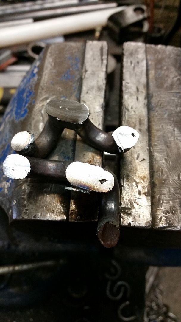

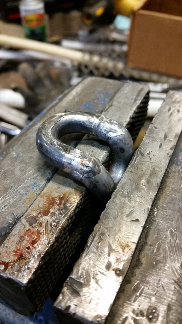

So how well will the chain hold up when you're digging stumps? :laughing:
   / SSQA fork build
#138
If I have any problems, I'll just send them your way. Seems you weld chain pretty good!:laughing:
   / SSQA fork build #139
I don't know man, I failed x-ray on my test links. :laughing: Of course I welded them 3 hours past my bedtime after I'd already had a 12 hour day and wasn't trying for perfection. Still passed the bend tests. :D

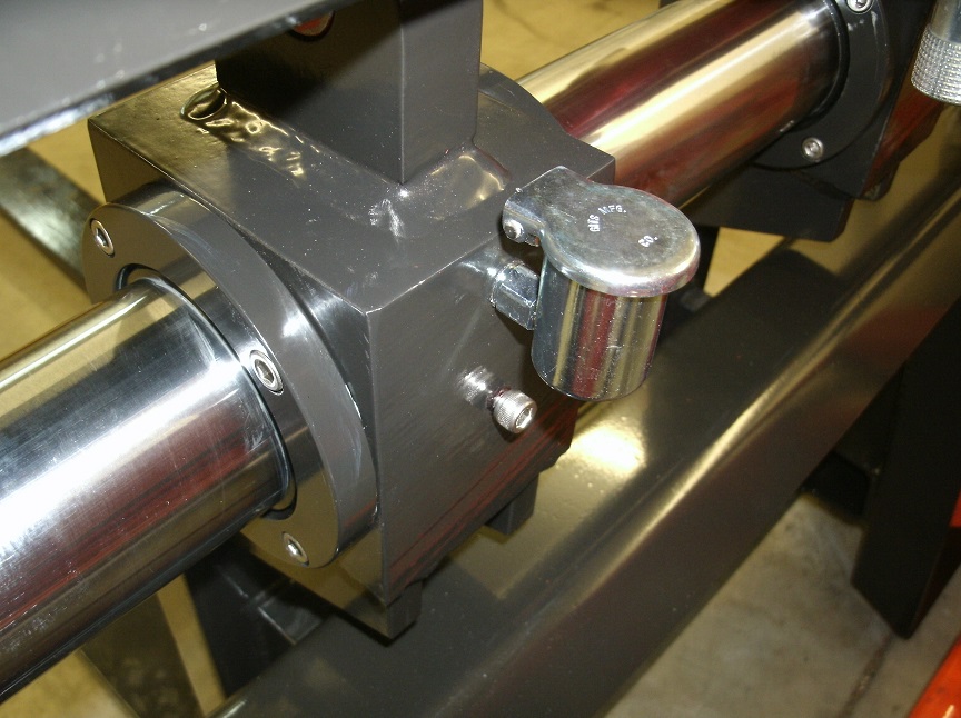

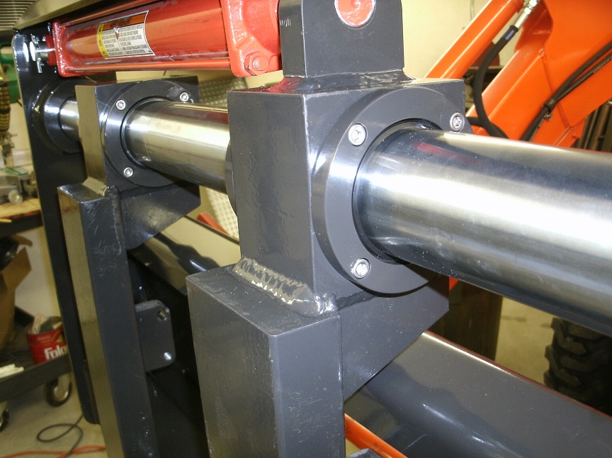

Just taking care of a few details before I declare it finished. Since I'm going with oil, I got these larger oil cups that will hopefully hold enough oil to last a while. Also locked down the adjustment knobs because I'm satisfied with the speed.
I want to say thank you to everybody that responded with the nice compliments, it was truly appreciated! And a big thank you to countrybumpkin for taking the time to post the image that had me modify my design and made it much simpler!
Now it just has to stand the test of time.
