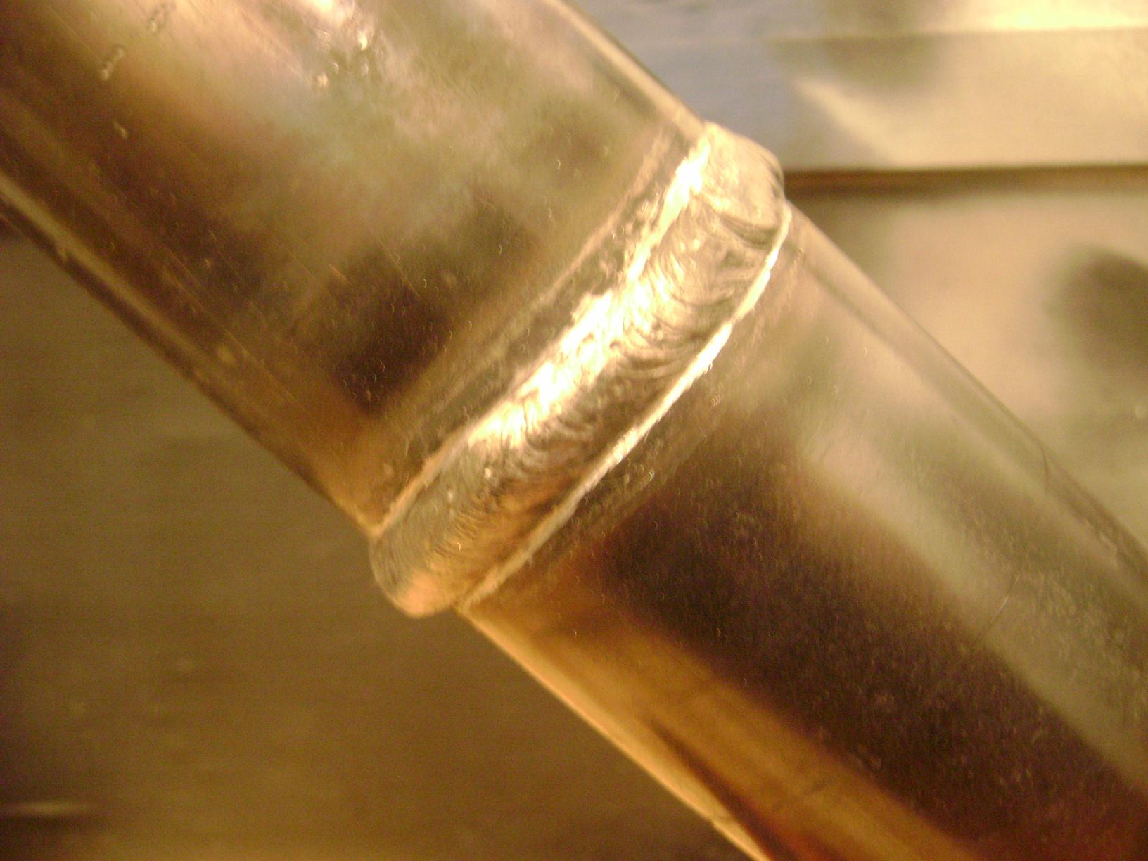

The problem with 1/8 rod is having to carry that much iron around a small diameter pipe. 3/32 is less iron to carry. I'm not good enough to carry 1/8 around a 2-inch pipe, 2 1/2 sch 80 or 3-inch I can handle it.
Here is a 2-inch sch 80 pipe welded with 3/32-inch 7018.

That's what mine looked like, but I ground that mess off and started over.
Not. :)
Fine job, as always, Shield.
   / SSQA frame repair #23
Darn he makes pretty welds don't he.

Good job on the repair. Did you actually work the grapple while it was half disconnected (certainly without you noticing) or it was bent by the weight of the grapple alone?
Ps: Shield Arc must be a machine. I can't squirt mustard on a sandwich in such a straight line let alone weld around a pipe.
