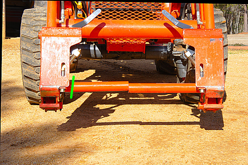

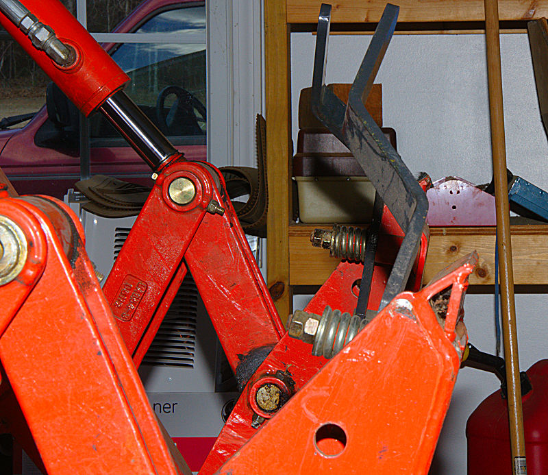

While using my grapple last weekend, it detached from one of the QA plates and ended up twisting the tractor's QA assembly cross-tube. Details of the experience are in the Owning/Operating forum.
After looking at things closely, I believe what happened is the weight of the grapple pulled the remaining still-attached QA plate forward, resulting in permanent misalignment of the plates. However, the cross-tube itself isn't bent; it's just twisted (but not visibly deformed). The plate is *slightly* bent, but not enough that it won't work. (It's the left hand plate in the first pic below.)
A new SSQA assembly is about $650, and if my proposed repair doesn't work, I'll just buy a new one.
My plan is to cut the tube, realign the plates, then weld a 1-foot sleeve over the cut.
The tube is 2.39" OD. About the closest sleeve I can find online is a 2.5" ID piece from MetalsDepot: 1020 DOM Structural Round Steel Tube 3 OD x .250 wall x 2.50 ID.
Anyone have a preferred source for this type stuff? Do you see any downside to my repair plan? Any other advice?

Personally I don't think you need the sleeve. That pipe is more of a spacer than anything of real structural value.
Quite a few years ago I had to do something similar to a neighbors new Jinma tractor. He only had it a month and decided to remove the front end loader. He could not get the loader to pin back up to save his life. He came and got me, right away I could tell the loader support arms, (pipe) were welded out of rotation. I cut them with a port a band, beveled each side and made a full penetration weld in the correct rotation while bolted in position. Still working fine to this day!
Well the only thing working fine on that tractor! :laughing:
/ SSQA frame repair #3
I would talk to the local auto body repair shop. Someone with a little know how and a frame rack will set everying straight in less then ! hour.
/ SSQA frame repair #4
You could try heating a ring around the pipe, and place the tractor close to a tree or wall and use the hydraulics to rack / rotate the mounting plates.
It would be my luck that one side or the other would move back towards the tractor tho! Then I would have a bend in the pipe to go along with the rack / out of rotation. :(

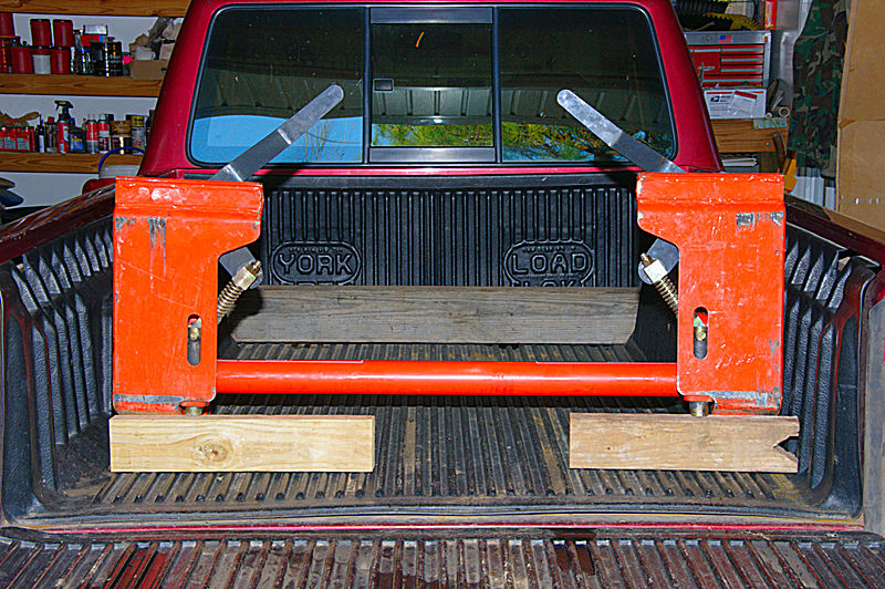

The d@mned tube is bent. :(
It's displaced about 3/4" at the center. The bend appears to be where the tube meets the QA plate -- the left hand plate as you stand in front of the tractor looking rearward.
Second pic is with the (raised) bucket attached to ensure the SSQA plates are properly aligned.
Sledge hammer hasn't helped so far.
Jay

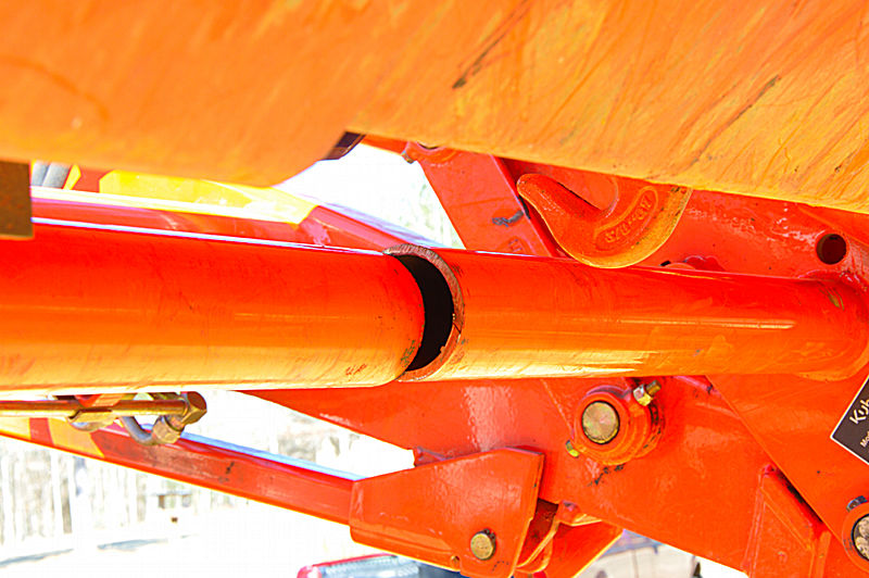

/ SSQA frame repair
What do you guys think about this: Cut through the pipe on a slight angle at the green line, rotate the cutoff tube section and grind the ends to get the best fit under no stress, then weld both cuts.
Or would it be better to make a vertical the cut at the green line, then grind the cutoff tube section at both ends at an angle to fit?

i would put a straight edge across the mounting pads on both sides, and use that as a guide.
you do want them to end up parallel, right?
far as the tube, a good bessey clamp should pull that back together.
the question is, will pulling the tube back together result in aligning the mounting pads.
you can tack a snipe to either of the pads and then use whatever leverage you can find to bend the mounting pad assemblies individually. odds are one is bent worse than the other.
if you get the pads back where they are supposed to be, shouldn't the pipe get fairly close on its own?
edit; oops, missed some of the particulars. if the loader arm to pad mounting brackets are all good, why not just cut the existing pipe off both ends and put a new, slightly heavier pipe in its place?

Yeah rjmack, the pads are good, but the crosstube was slightly bent right where it connects to one of the pads, resulting in the offset you see in the pictures of post #6. Your proposed solution would work.
The tube was also twisted, and making the cut in the middle (see post #6) allowed me to eliminate the twist by simply curling the freed pad, but of course I was then left with the offset due to the bend.
I made a second cut as I proposed in post #7, which left me with about an 18" section of removed tube. I then beveled all the severed tube ends in preparation for welding.
I attached the bucket to make sure the pads were properly aligned and left it attached while I fit the severed tube section back in place. I had to grind a little here and a little there off both ends of the tube section in order to get a decent fit without placing tension on anything.
Finally, I "welded" the tube back in place. I use quotes because I've never welded pipe before, and it looks truly wretched, but it's solid. The crosstube now has a noticeable bend in it at the weld joints, but the pads are lined up right throughout the full dump and curl range.

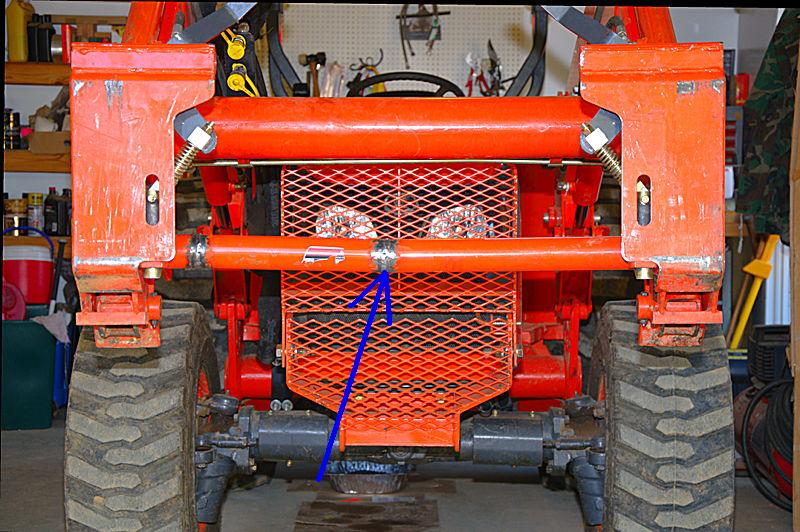

Haven't quite had the six pack yet, but working on it. :drink:
I went back and did a little grinding and ran another bead that didn't cause me to weep. It should be fine.
Now that it's been primed and painted, it ain't half bad, aside from the crooked crosstube. Plates are square and I've tested my bucket and grapple for fit.
Here's how it turned out before painting. 7018 1/8" at 125 amps on the Everlast PA160. (MAN, am I glad I bought that thing last summer!)

I may have welded a little more pipe than you have, but on that small of diameter of pipe I would have used 3/32-inch 7018, at 75 to 80-amps.
/ SSQA frame repair #17
If you had a torch you could fix that bow in the tube. Heat a oval underneath the tube where I drew the arrow. Heat to almost a cherry red, than take a wet rag and place it on the red oval.
DO NOT HEAT ON TOP, NO MATTER WHAT ANYBODY SAYS! :laughing:

you nailed it on one axis anyway, and the welds don't look to 'muscular'...
should be good:thumbsup:
i was lucky when i got the first damage to my machine. small dent in a hard to notice spot.:)
Heh, if you've welded ANY pipe, you've welded more of it than I have. :laughing:
I went with 1/8" rod because the tube looked to be 3/8" wall. May've been 1/4" though; I didn't measure, just eyeballed. I thought about using 3/32" rod, but I wanted to be sure I got good penetration.
