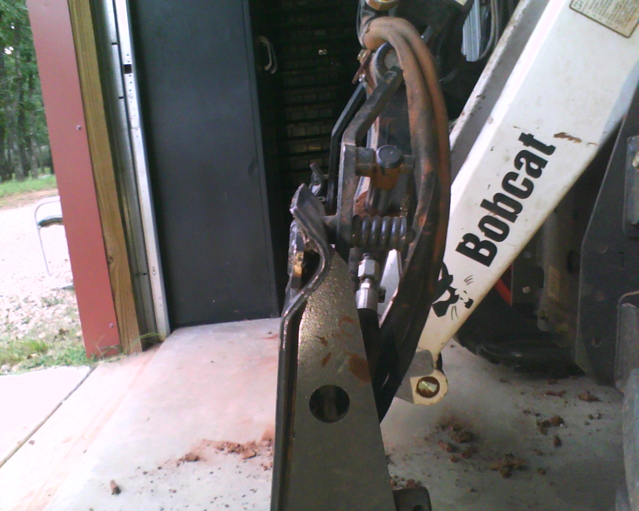

I looked at my loader today and discovered the pins are fine, but the holes just aren't tight to them.
This is as far out of time they'll go.

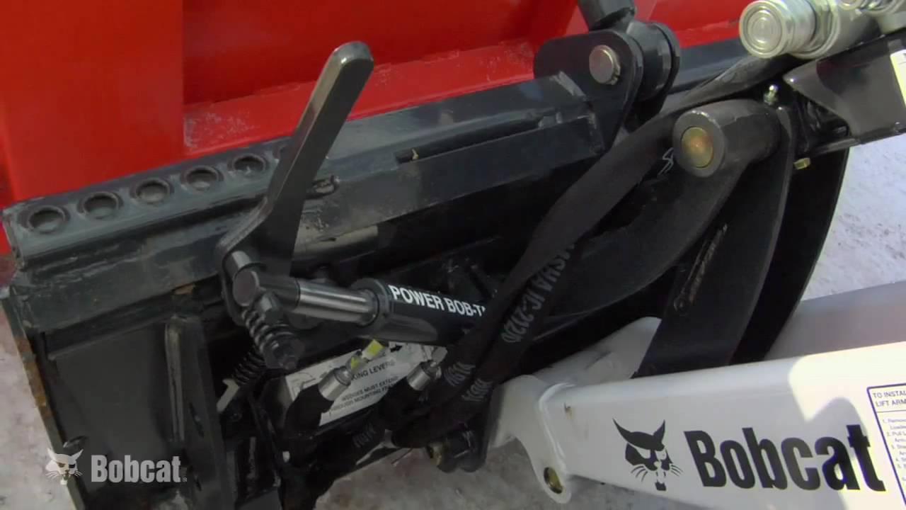

Shouldn't be a problem if you allow for it in the cylinder mounts on the handles.
They will be in line when up against the attachment and rolled back, ready to latch.

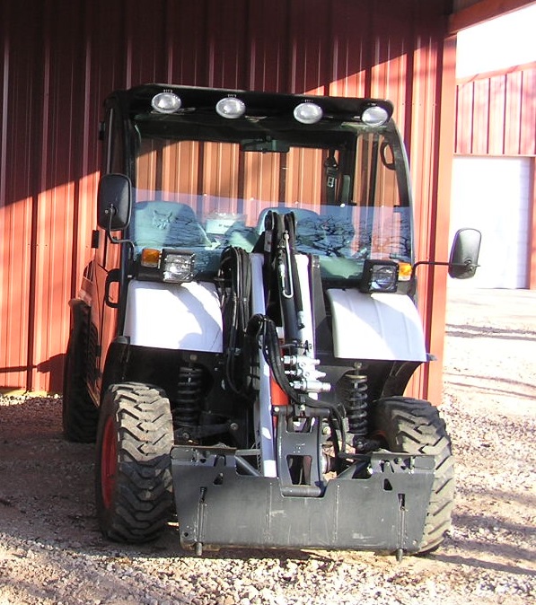

This is how Bobcat did it on the Toolcat, two cylinders with very little slop because they can't move out of line, like your handles.

Bobcat had to use two because one wouldn't clear the center linkage, I was just showing how it attached to the handle.
