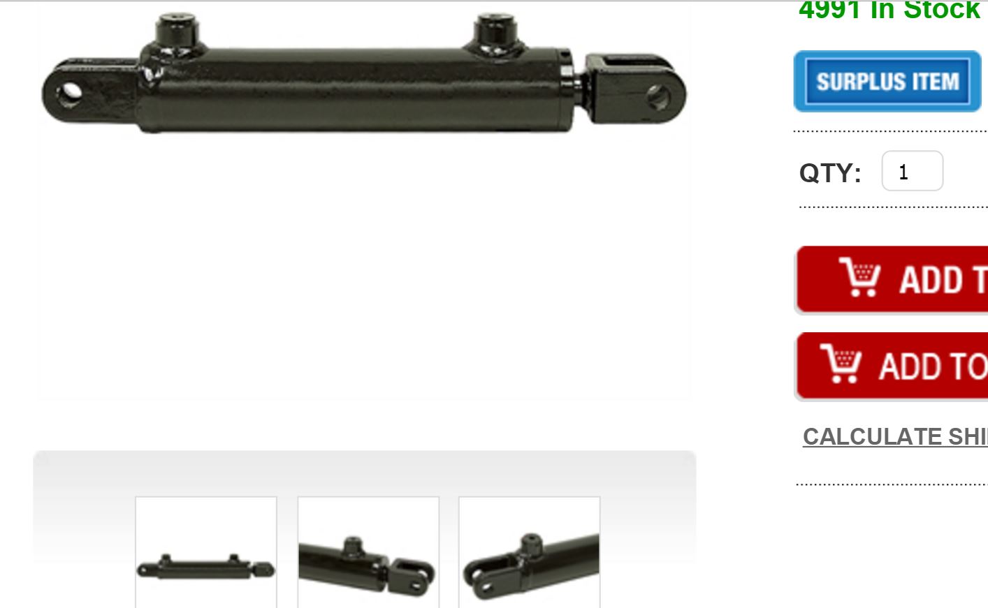

Power will come from a second diverter on the front of the boom. I have a grapple circuit already - I'll run that to my diverter and the switched circuit will control the latches.
If I have the tools here to do it, I'm going to bring the SSQA mounts and the torque tube home. My cylinder is at home. It's a little guy with 6" stroke.

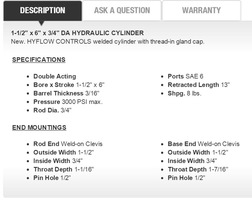

   / SSQA pads fixed together vs not fixed together - why? #26
Pn: 9-8841 1.5x6x.75" 19" open/13" closed 3kpsi max
Thanks, I was curious about the end mounts:
#27
End mounts, port locations, and even length of stroke mean little to me. ;)
