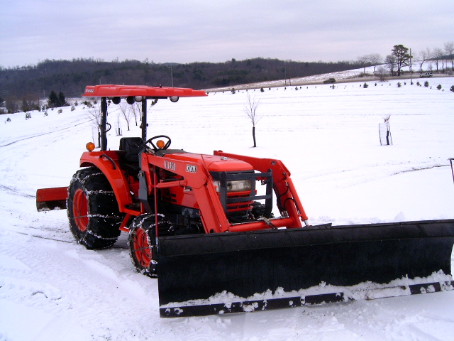

I've never plowed with a tractor snowplow setup so excuse my ignorance. With a plow on the loader arms does the tractor front or tractor rear have more of a tendency to "swing out" due to the longer lever vs. a frame mount?
Yes, you do tend to swing out when plowing with the FEL. I like to use tire chains on all 4, in which case getting pushed side-ways is not an issue. I'm working on dirt/gravel so I don't have to worry about tearing up asphalt. As mentioned by others, the FEL is great for stacking snow, breaking drifts, etc. There just isn't any "perfect" tool for moving snow. Blowers, FEL plows, frame mount plows, and truck plows are all useful. I even use a UTV for quick plowing of light snow, but that doesn't replace my truck mounted blower or my FEL v-plow.

So far there have been 235 views on this topic asking if anyone has damaged their loader arms with a snow plow mounted on them. No-one has yet. That has to mean something.
I don't believe Kioti recommends putting chains on all four tires. When plowing, what end tends to swing sideways, the front or rear? I take it that front chains prevent front swinging.
I've run 4 link ladder chains on all 4 for snowplowing on my DK 35.
Its not a problem.
