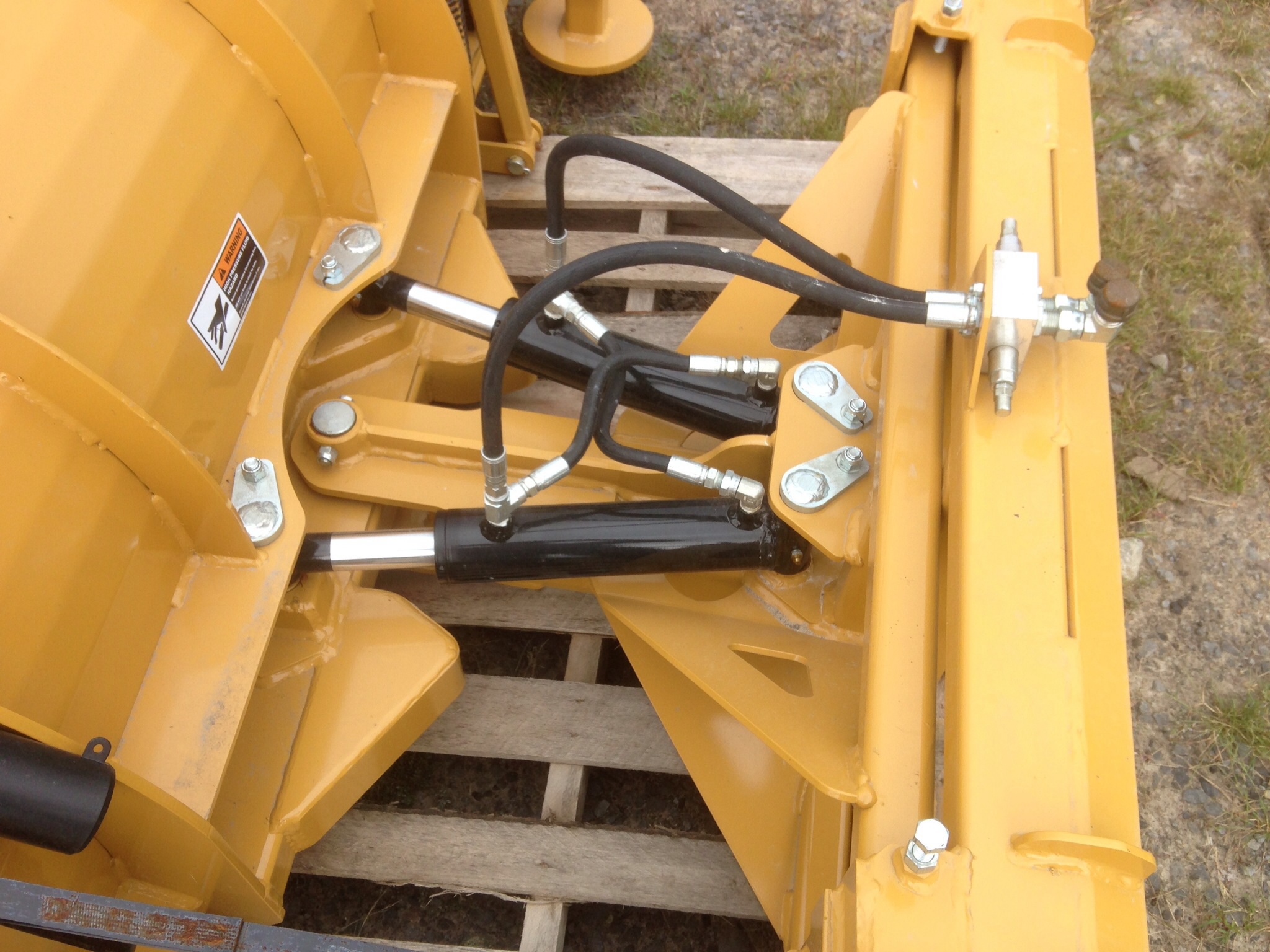

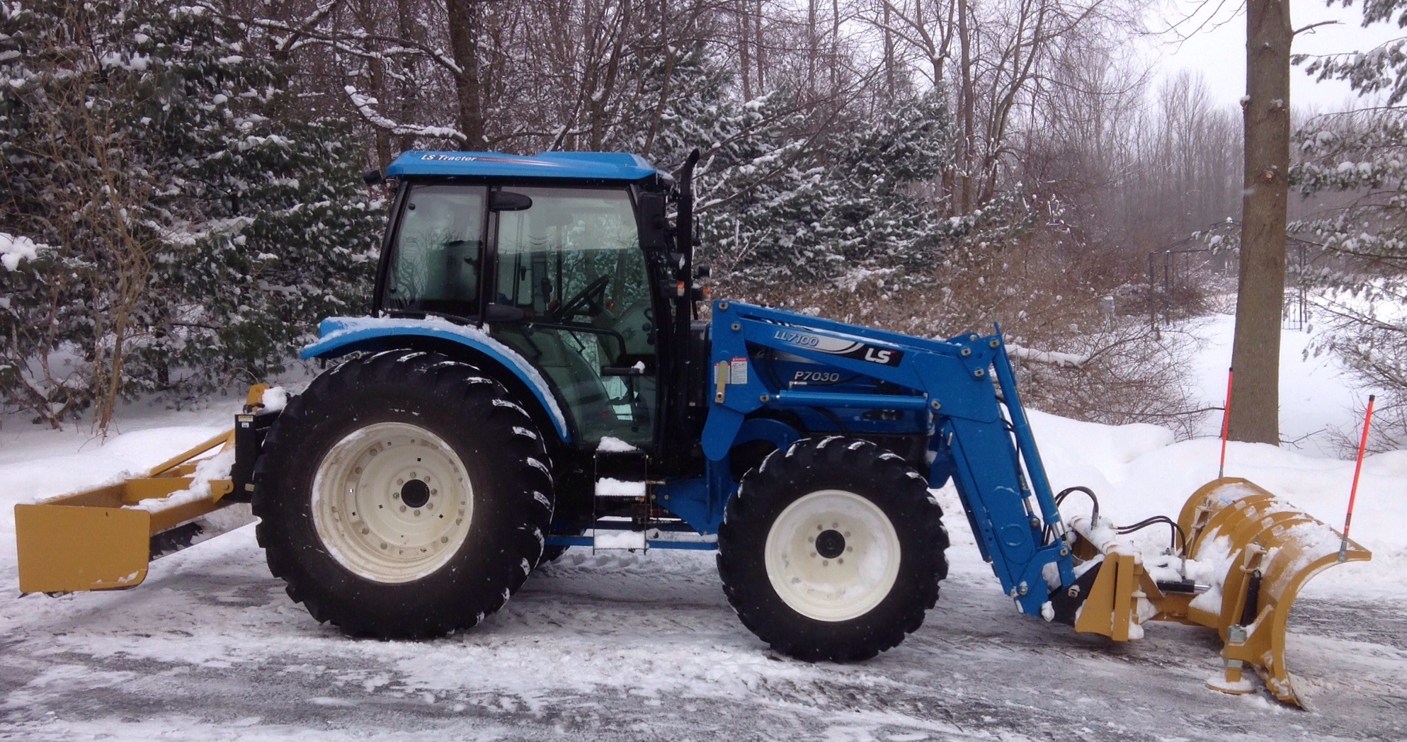

Having lateral float, a spring trip edge and a cross over relief valve will pretty much eliminate any damage to the loader or blade. I have a 1/4 mile gravel drive and 300 feet of blacktop by the house and it works great, as long as you don't plow when it's a soupy mess. If you have a lot of freeze thaw cycles it can drive you nuts. Around here it freezes in November and stays that way until April. This year I think it was May.......:laughing:

Out of all this I saw where one loader on plowsite was bent by a snow pusher. Snow pushers are solid mounted and no trip springs like a snow plow.
The next site a members claims he bent his loader arms 40 years ago with a snowplow when he hit a bolder.
When I googled the tractor by net twisted Fel arm thing I did not see any of the loaders mentioned being twisted due to using a snow plow. NONE
