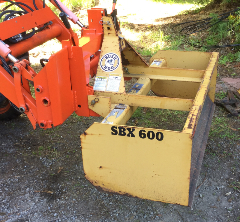

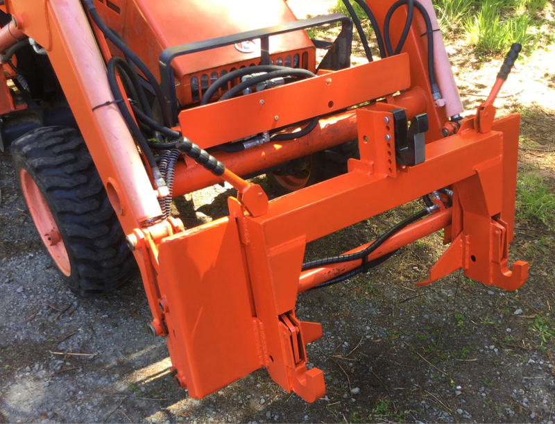

Using it to move box blade to workshop. Much better than lifting with chain.
Looks pretty much like mine, only not ugly & rusty. My SSQA plate has bracing across the bottom that yours doesn't. Doubt that is going to be a significant deficiency with all the other bracing from the 2 parts welded together.
So handy for moving & loading stuff. Nice for working under my flail too (after blocking the loader arms for safety).I put my trailer mover on mine up there rather than on back.

Yes I saw that Titan SSQA to Three Point adapter. As an alternative to the $1000 versions it is a good option. But, it does not have the Quick Hitch, nor do any of the other commercial versions, except for the Craigslist item that countrybumpkin mentioned. To the best of my knowledge, if you want a SSQA to QH adapter, you pretty much have to make it yourself.
   / SSQA to Three Point Hitch Adapter #24
$100 SSQA plate, $100 QH, $50 for a welder to stick em together if you can't weld. Maybe $100 if you want him to put on some angle plates to put more rollback on the QH.
