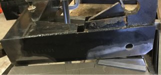

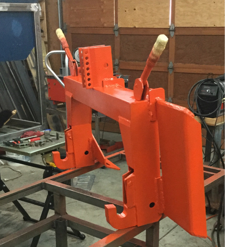

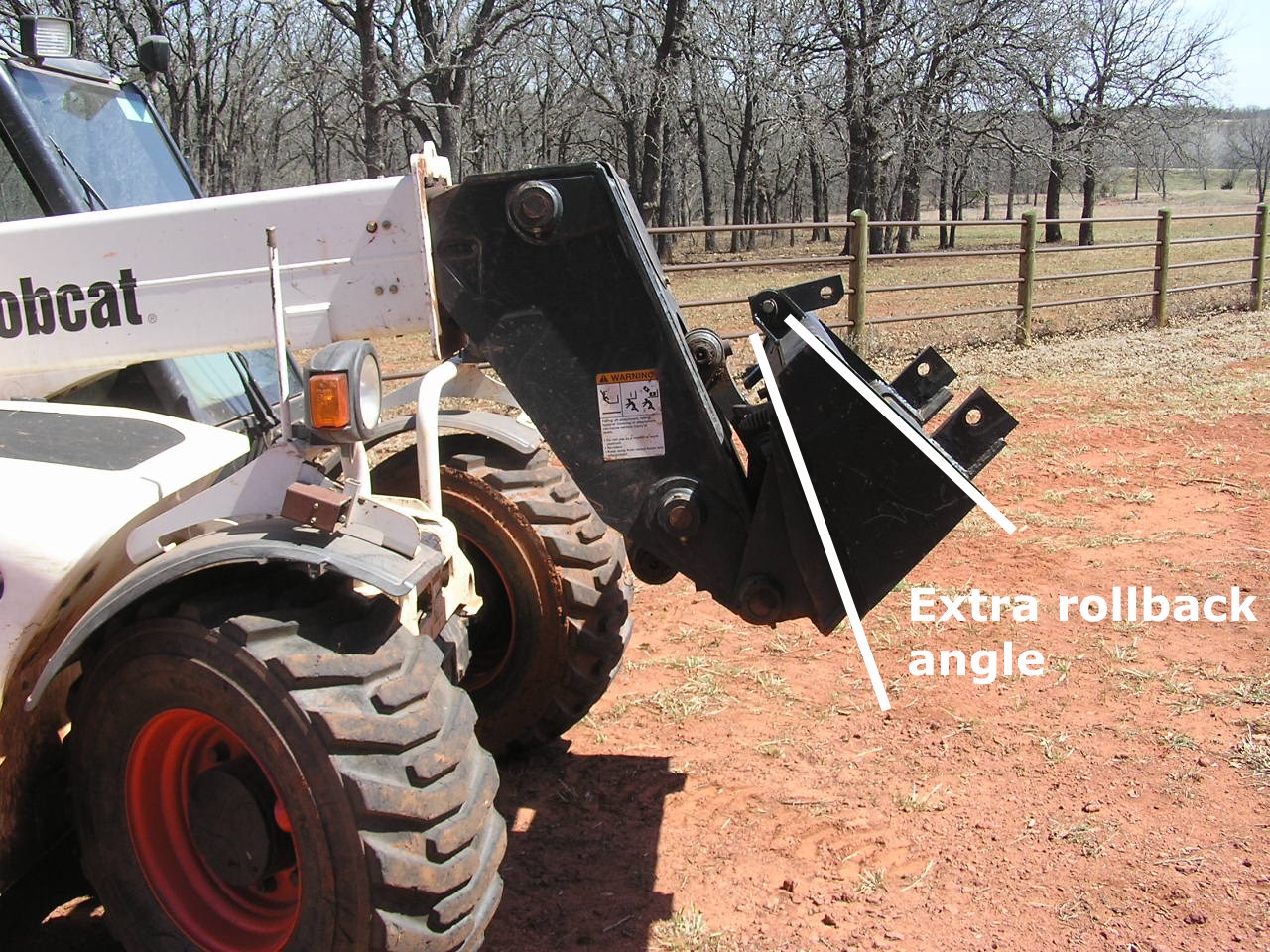

I did the same thing, QH welded to a SSQA plate. Haven't painted mine yet. My only regret is welding it flat & not giving the QH some rollback.
I was able to get some rollback by grinding and positioning the QH. Picture shows it. More would be better but also a more complicated build.

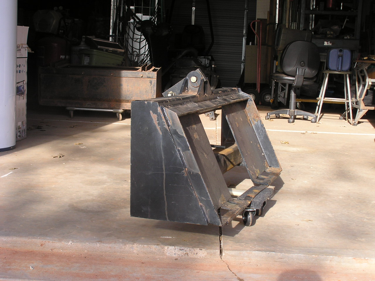

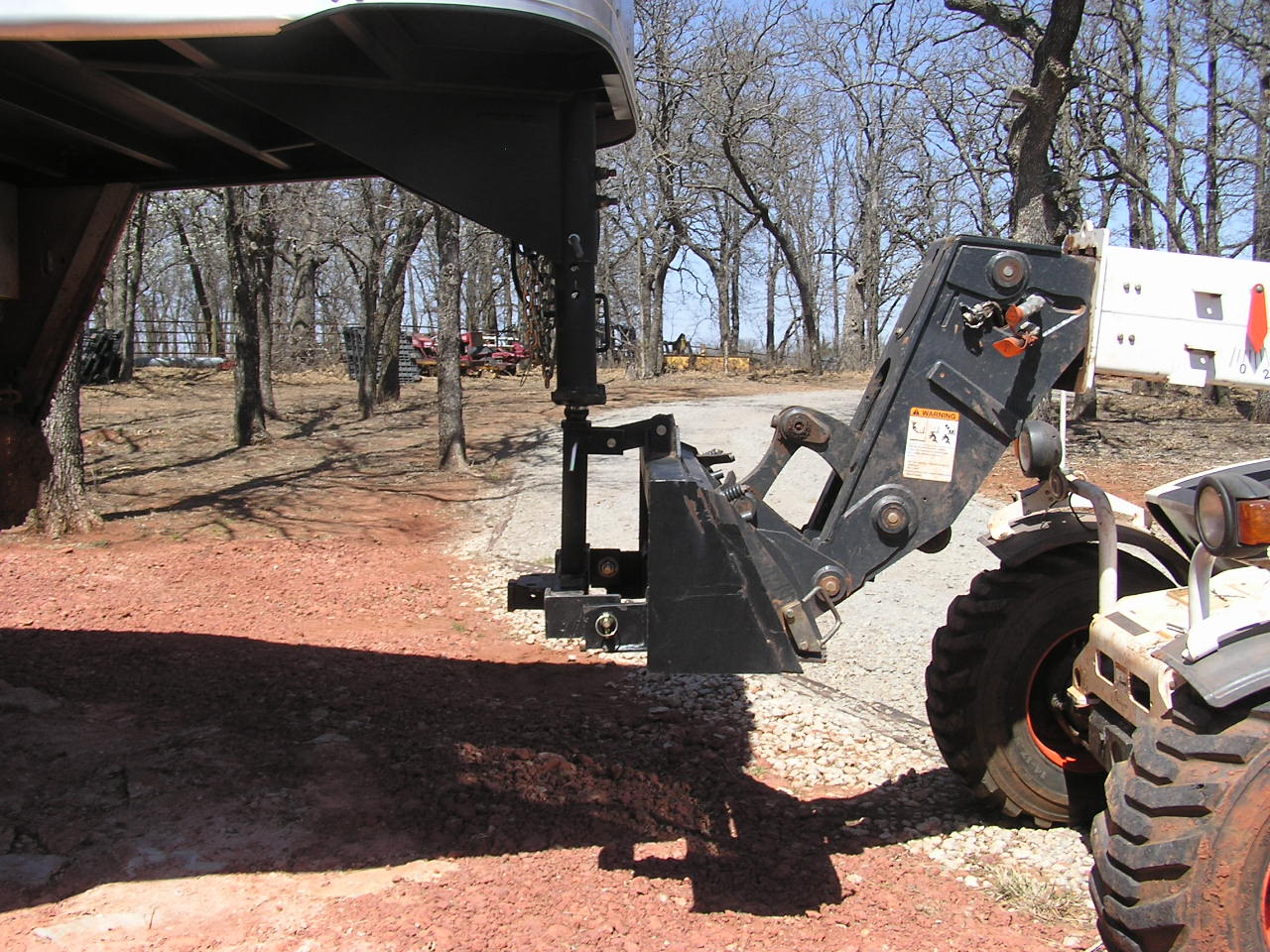

#13
******. Now I'm committed to building me one of these! Any pointers before I weld 'em together? Size thickness of the Titan plate?
The plate is 5/16. The bar across the top is 3/8. I got this style so can see through to the ball on my trailer mover for easy hookup.
   / SSQA to Three Point Hitch Adapter
#14
One thing I thought about is gussets on the "wings" at the side. Decided not to. The QA lips top and bottom add a lot of stiffness. I don't think it will bend under intended use.

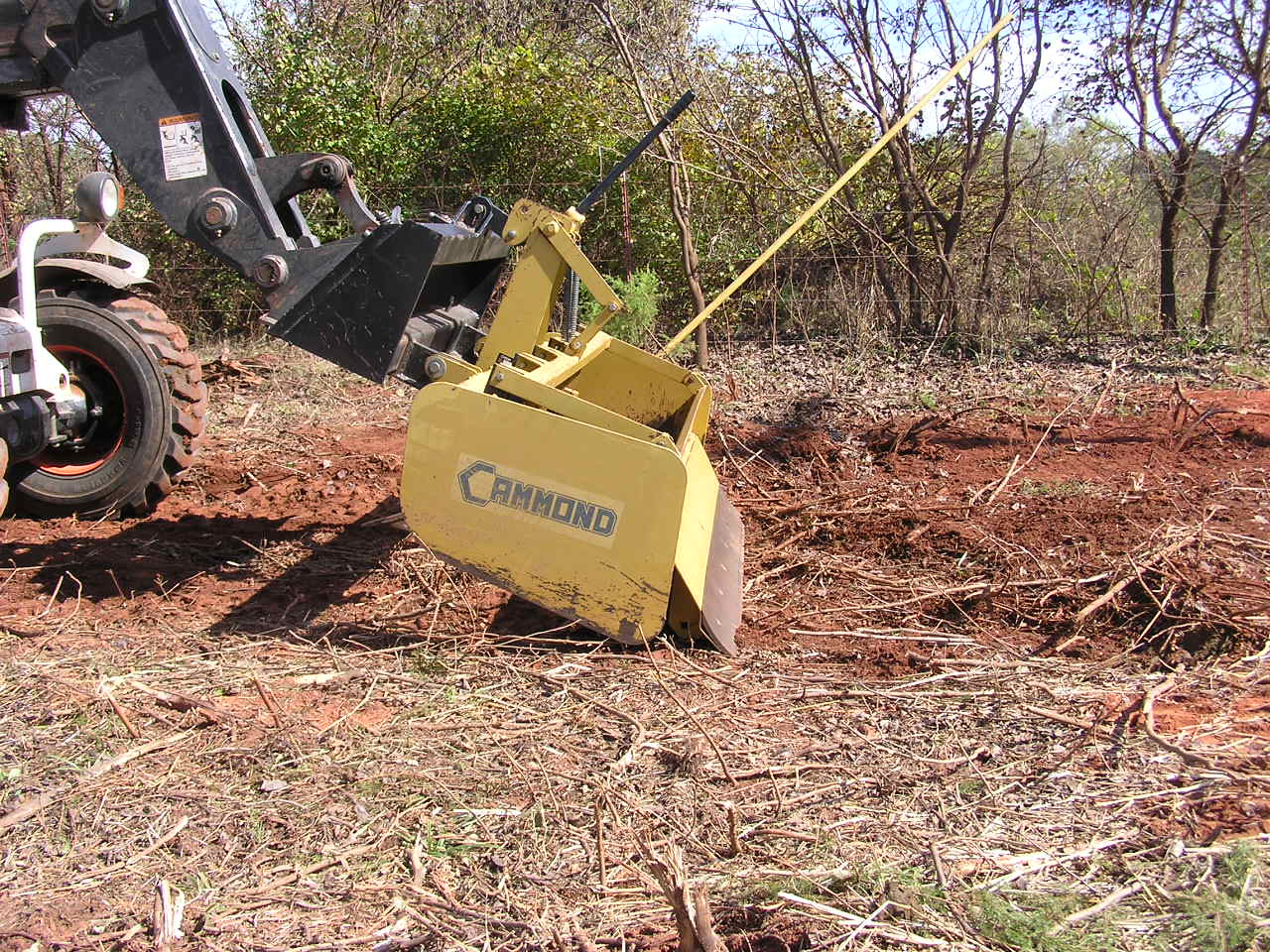

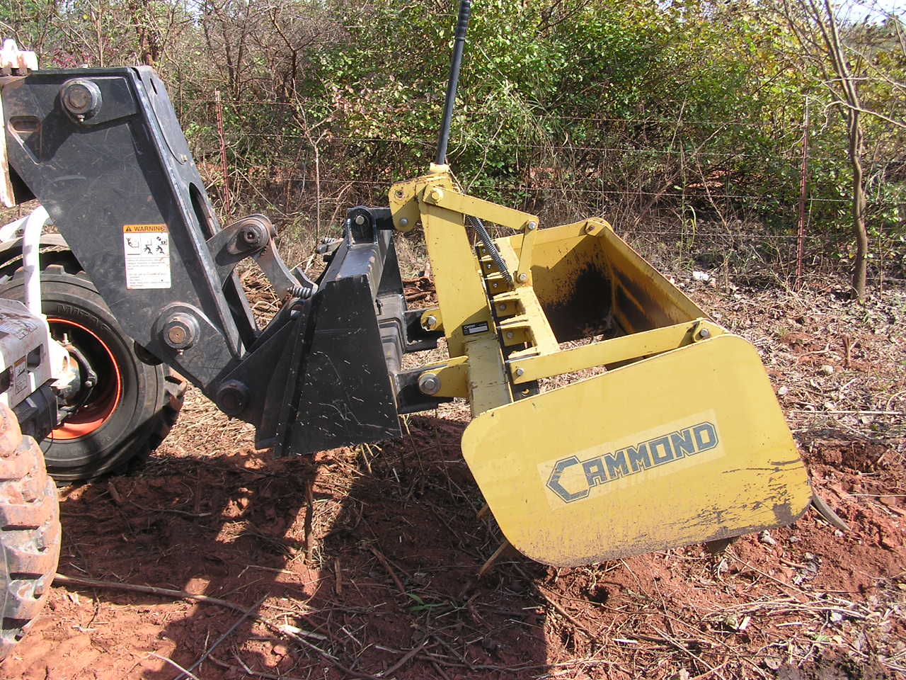

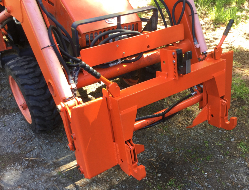

The 3 point adapter that I bought has a lot of extra rollback built in:
   / SSQA to Three Point Hitch Adapter #16
Xfaxman, that's a great setup you got there. No doubt it will fit just about any 3ph implements!!!
   / SSQA to Three Point Hitch Adapter #17
Thanks, it is cat2, so I have to use bushings for some things.

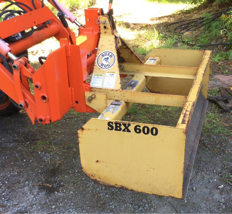

#18
Xfaxman that looks great. Btw I used hook gussets following your suggestions in other threads.

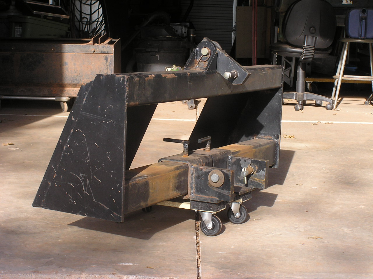

Using it to move box blade to workshop. Much better than lifting with chain.
