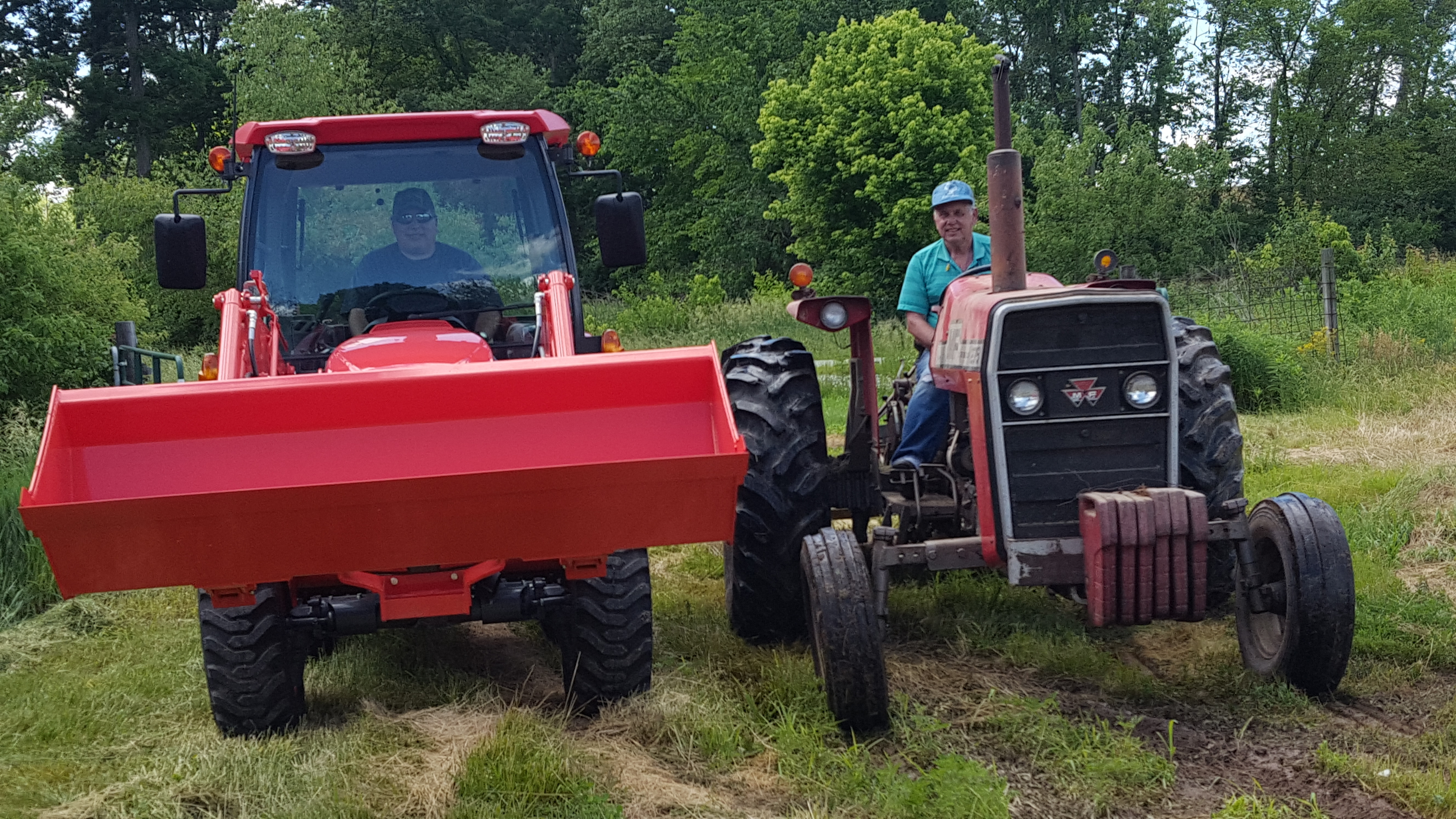

You can see the width difference in between these two. My dad will fly around like a mad man on take on any hill, I have to be a whole lot more cautious.
