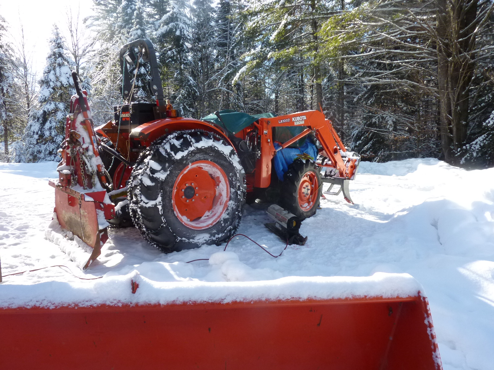

I have always used Stanadyne Performance Formula year round as a fuel additive and anti-gel. I have also bought my fuel at the same truck stop for over 15 years and trust thier fuel. Well today I plugged the filter - never happened before. It was cold, minus 5 F and the tractor soaked at minus 22 all night. In trying to figure what happened I notice that the Stanadyne spec states that the plugged filter temp is reduced by 25* F. I never realized that was all. So I guess all these years I have been unknowingly relying on the fuel blender to help winterize the fuel.
Anyway the question - Stanadyne says use a 500:1 ratio, temperature independent. My question is, if I use a lower ratio will I get a larger temperature reduction ?? I ask because I see Power Service instructs you to double the additive below 0 degrees F. However PS does not publish (that I can find ) how much temperature reduction you get by using it. That would be good to know too. Thanks

Jelling is only one issue that can cause restricted fuel delivery. Ice accreting on the filter(s), the tank outlet strainer or freezing in the fuel lines is just as probable.
Water condensation in the fuel tank is unavoidable especially in humid climates but can be minimized by trying to keep the fuel tank as full as possible. Main fuel filters and water separators (where installed) have drain fittings on them. How many of you drain them regularly? Many fuel treatments help the water to collect and slide off the filer so it can be drained but if you don't drain the filter housing it will freeze up in cold temperature and restrict the fuel flow. Treating for fuel jelling won't help ice blockages. If you have a metal filter canister you can use a heat gun or your wife's blow dryer to melt the ice in the filter or on the tank strainer or fuel lines. then drain the filter to get the water out, collecting it in a clear container so you can see how much is in there. Do that at every following start up until you don't have any more water come out.
I understand about the potential icing problems but in my case it was gelling not icing. I have clear filter bowls and could see the yellow wax that filled them. When I removed the bowl/filter assembly it was a real education for me. They were filled with a thick yellow heavy gravy like substance - messy stuff. And my fuel tank looked like tapioca pudding with little yellow specs suspended in it.
I put the 911 in the tank and let it set for a day. I cleaned as much wax off the filters as I could in a warm place and filled the bowl with 911 which started dissolving the remaining wax imbedded in the filter. When I put the filter back on the motor and opened the fuel valve new wax stared to collect as fresh fuel flowed in but then started dissolving. After I started the tractor I added regular PS as instructed. Everything is still good today at 5* above. We will see Saturday when it is -25* again.

It's been so cold I haven't even tried to mess with my gelled fuel problem. This morning was 3* F above and it got up to 15* by noon. Figured this was my best chance. Snow tomorrow then back to 25 below for the weekend. I just followed the directions on the 911 Power Service bottle except I put it in the tank yesterday and let it sit for a day. Today I did the filter thing, made a little tent over the tractor, and ran my salamander heater a couple hours for extra insurance. It started just like it was summer - I never thought clear fuel could be so beautiful. I won't let this happen again. Once is enough. I will never use month old fuel in December again.
Now I am a Power Service fan !!!
gg
Just remember PS 911 will un gel the fuel it will not stay that way. You need to add the white PS to keep it un gelled. I see you added it but some people don’t and then they claim that 911 is junk, they just didn’t read the directions. Glad it’s working.
