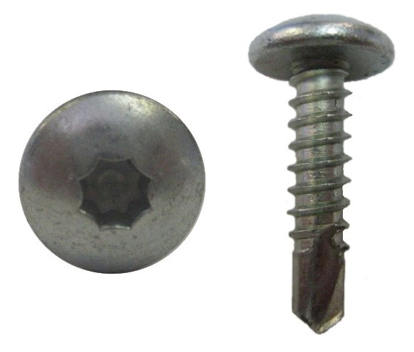

I noticed another screw head not on the chart. It is called double-square. I ran into them when I had to replace an aluminum panel on a Haulmark trailer. You can get eight point driver bits but a regular square bit fits too.
