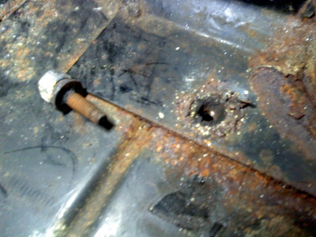

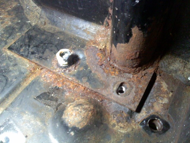

The "Torx" or "Star" heads are awesome for wood with an impact driver...but ask any Jeep owner what they think about Torx used in metal applications and you'll hear "I hate them suckers"!!! In the course of rebuilding my 91 Wrangler every Trox I've pulled has been replaced with a hex head bolt. In most cased the Torx heads strip out even while using high quality Torx bits. I've had to use my Mig to weld nuts onto most of the Torxs to remove them.

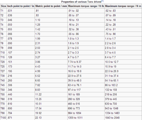

I'm the OP.
Thanks to everyone for your replies. The overwhelming consensus is NO, they're not supposed to be that tight.
I think what I need to do is take down the sizes of all the star bits I have and compare them to the fullest sets I can find. It seems that I must be driving in some bits that are close in size to the holes in my screws/bolts. I never thought the bits were stepped so close that would be possable.
This list gives the sizes and measured diameter:
