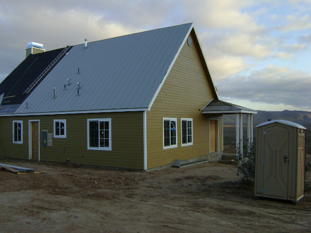

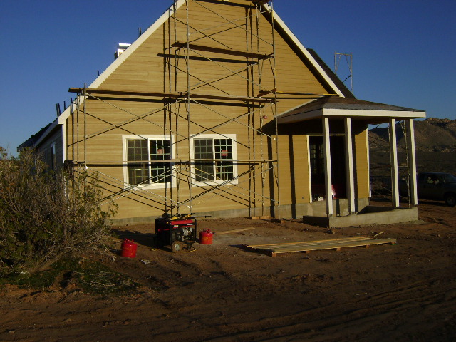

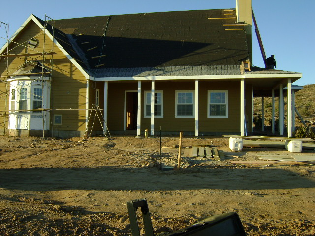

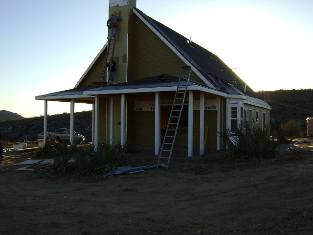

I worked up there all weekend, mostly painting the trim while the siding guys still had the scaffle set up. Getting the siding pre finished was one of the best things I did, I am almost done with my painting and I only used 3 gallons and two colors and about a day and a half.
The new roofer starts on Wednesday and once that's done drywall starts. The concrete guy came by to look at pouring the patio. He suggested stamped and stained but I haven't found a stamp I like yet. I like the idea of a granite look natural gray with a little stain to make it darker. Any ideas on stamping? I like the idea of it just being flat and smooth? He said it would be slick? no water will get on it since it's covered...

Nice to see your house is coming along well.
The thing about stamping concrete for me, is very few stampings avoid the faux rock look. I have seen some I like too. Maybe like you say it's finding the right stamp pattern. Deep stampings would be a pain to sweep.
Don't know about smooth concrete and slippery in your climate. If you have it power troweled and it's done well, it can be very, very smooth. I think it would have to have water on it to be slick, or some dew/condensation. Something to think about as it will get slick under those conditions, especially with a sealer on it. Maybe a stain for color and a light brush finish would suit you.
Once the roofer is done, your house will look really nice.
