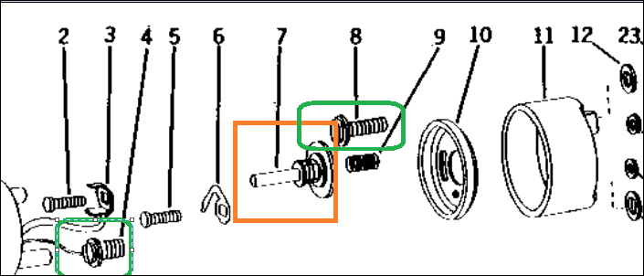

It will surprise me if ign switch is at fault. Low battery voltage or arc spots can cause washer(outlined in red) inside solenoid to stick to stud heads(outlined in green). Did you disassemble solenoid cap & chec k for arc spots on outlined components.

There was on the old solenoid. So i bought a new one and same problem. I took the ignition switch out and with a multi meter checked from the battery lead on switch to the solenoid lead on switch while the key was in start position and it toned good. When i let go of the key as if it has started it toned good too.Starter Solenoid.jpg

Ok. So i took the starter out and took it to a garage that my wife works at and one of the techs there bench tested it. He said the starter is fine and he be leaves that my problem is the spacer and the tip of the starter is no longer sitting in the grove witch is letting the gear over through the flywheel and the starter gear is becoming hung up and not retracting. So i have ordered the new spacer for $9. Just waiting on parts to come in. I ordered #'s 6,7,8

Ok. So I have received the parts for the starter and put them in. It starts up and the starter is acting normal and it seams that it is easier to start. Not a long slow crank. So maybe this was an issue for awhile and it just got worse.
