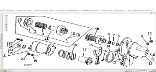

Ok. So i took the starter out and took it to a garage that my wife works at and one of the techs there bench tested it. He said the starter is fine and he be leaves that my problem is the spacer and the tip of the starter is no longer sitting in the grove witch is letting the gear over through the flywheel and the starter gear is becoming hung up and not retracting. So i have ordered the new spacer for $9. Just waiting on parts to come in. I ordered #'s 6,7,8
   / Starter keeps cranking
#18
Ok. So I have received the parts for the starter and put them in. It starts up and the starter is acting normal and it seams that it is easier to start. Not a long slow crank. So maybe this was an issue for awhile and it just got worse.
Thank you everyone for all of your input.
