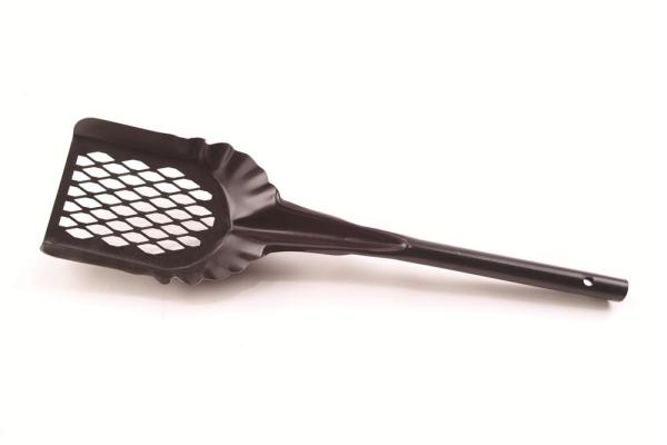

I bought a metal cat litter scoop to sift out the coals from a nearly dead fire to help getting it restarted. It doesn't work as well as I'd hoped. The easiest solution is keep the fire going.
