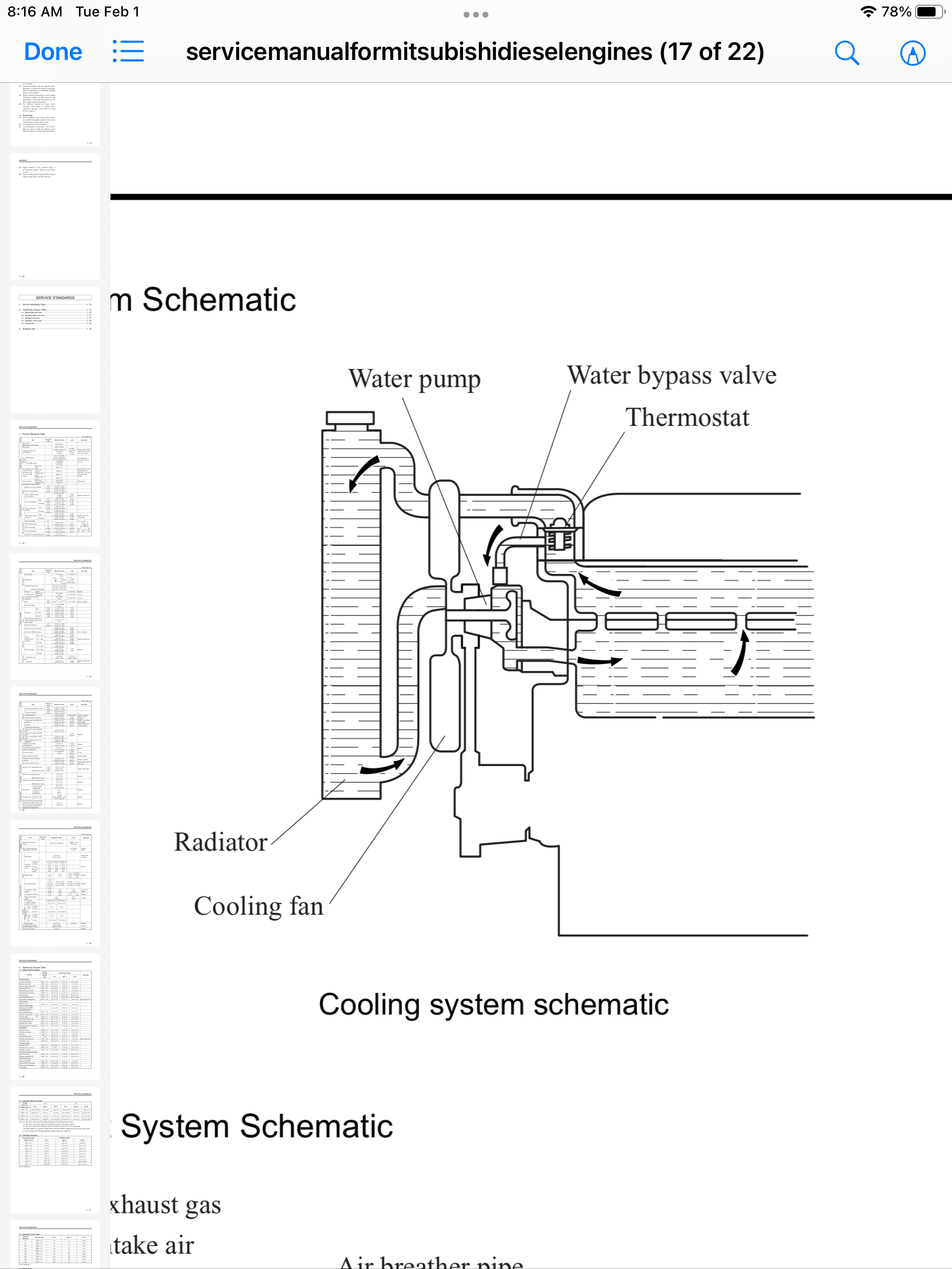

Just two comments, on many diesels mine included there is a flow path with the thermostat closed. 7BD76AAD-105F-459B-9D7C-4F8C6B4F849F.png5B6EE028-F7FB-4A20-83B1-B2BC39DC89C0.png

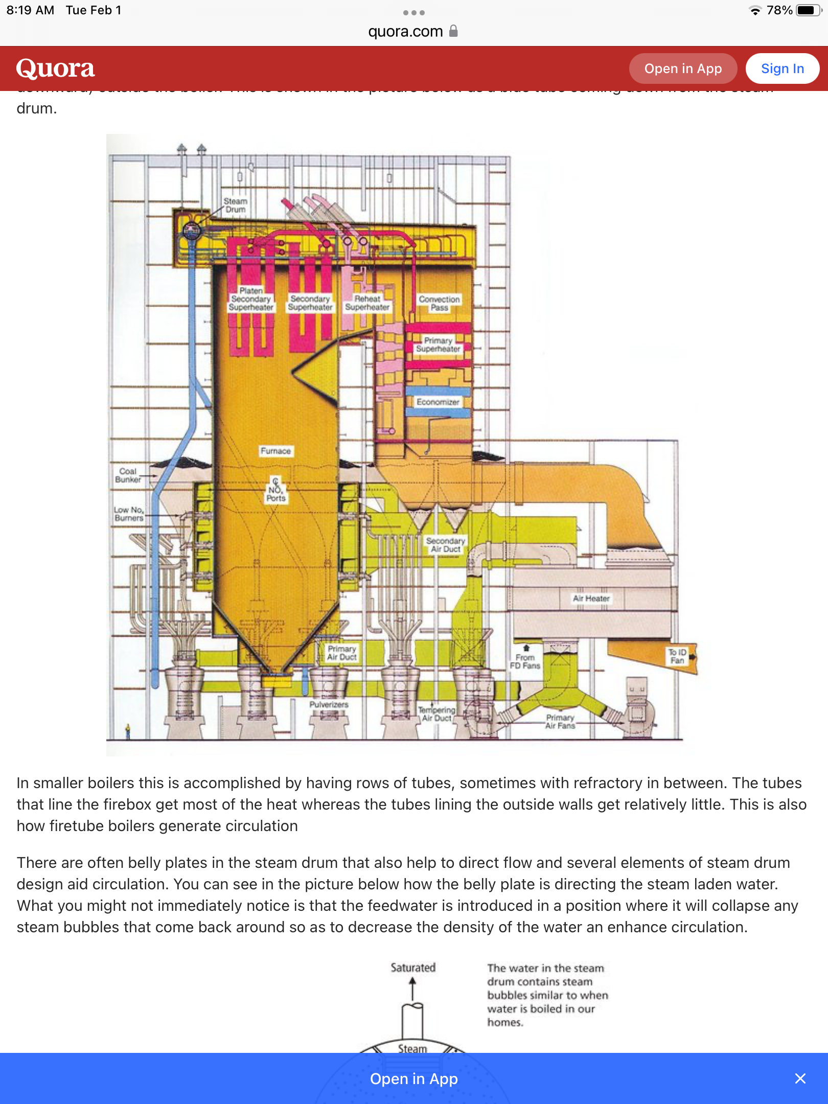

Second the water will circulate with both types of heaters. Called natural circulation. Happens because of the density difference, ie heat rises cold sinks. Same principle some large boilers or powerplants work on, at least that’s what I was taught as a power plant engineer. Block heater probably better because typically higher wattage and better location.

Just two comments, on many diesels mine included there is a flow path with the thermostat closed. View attachment 731876View attachment 731877
A question or two: The arrow in the pic shows flow from the top radiator hose into the radiator as if the water pump is turning and the thermostat is open to allow circulation by any means, but it's shown closed. How does that work when the engine is cold??
The bypass also circulates to the pump, not the radiator. I suggest the 'loop' shown by arrows could be misleading as to a low temp coolant 'circuit', however typical it is. Will a hose heater open the thermostat? If not, for liquid to rise/convect to the block some also has to descend along the same hose to be heated. IMO that could slow 'circulation' down a bit.
