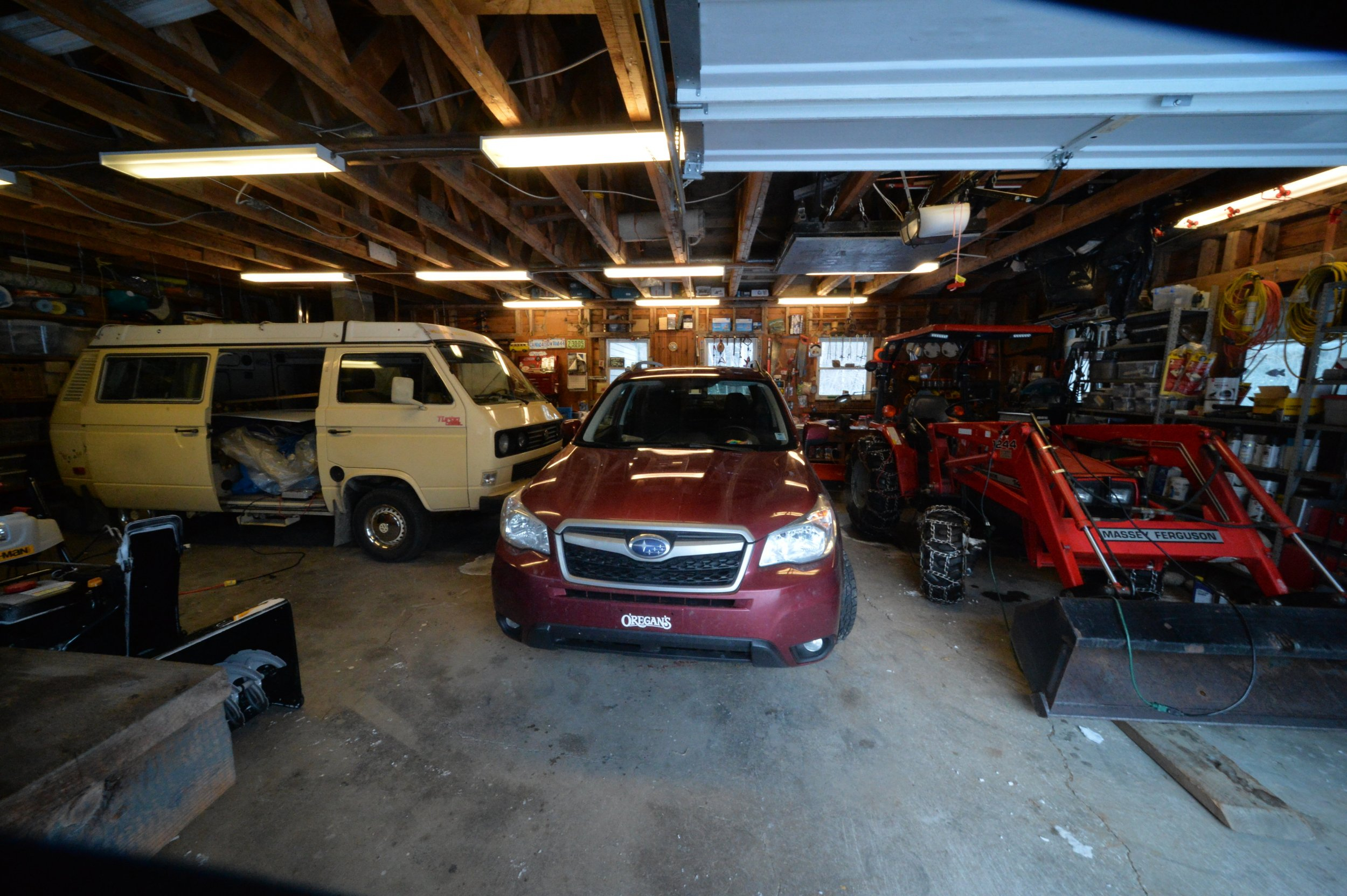

Just a word of caution here, unless the wx is really cold, leaving the coolant heater plugged in all the time can evaporate the coolant. Not sure how it happened, but I guess I had been leaving it plugged in all winter between plowing. I also use a magnetic oil pan heater and a battery tender. So I never had a problem starting my 1429V M/F. I discovered the low coolant when my water pump seized from no coolant. My Bad.. Here on the North East coast of Canada this past week-end was the worst storm in 4 years. For the last four years I didn't use my rear blower, so this year I left it packed away in the tractor shed, 100 feet away and impossible to reach with 3 - 4 feet of drifted packed snow.
