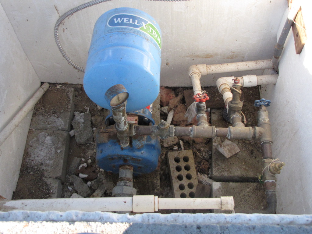

Thanks for all the advice. After I figured out what was what with the wiring, I primed the pump and applied juice. It started right up. I think I opened one of the valves too quick, so I primed it a second time and went slower. It held good the second time. When the pressure gauge would get to 50-55, the pump would turn off. I took the attached pic after seeing water coming from the spigot today.

If you need more flow, try opening the valve close to the pump. It is being used as a flow control. If the well can produce enough water, opening the valve will give you more flow. If the well is a slow producer, the valve is set like it is to keep from pumping the well down more than it can produce.
