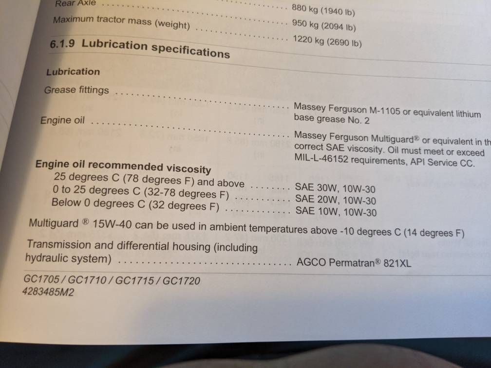

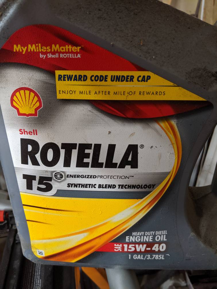

Block heaters are nice below 32° to keep your oil from getting too thick. That said you can run different oil grades in cold temperatures to mitigate too much thickening as well.
I live in the Northeast near buffalo NY. I run Rotella T5 15W-40 Diesel Motor oil year round. I simply vary my use of glow plugs depending on temperature. I store my machine in an unheated garage and have been fine all the way down to about 0° with heavy glow plug use. Even then it's rare for us to get that cold with any consistency. We usually hover in the low to mid 20's in the dead of winter. I also start my machine and let it warm while I dress to be outside in the winter for 10-15 minutes when it's real cold out. Hope this helps. IMG_20191012_085555.jpgIMG_20191012_090218.jpg
