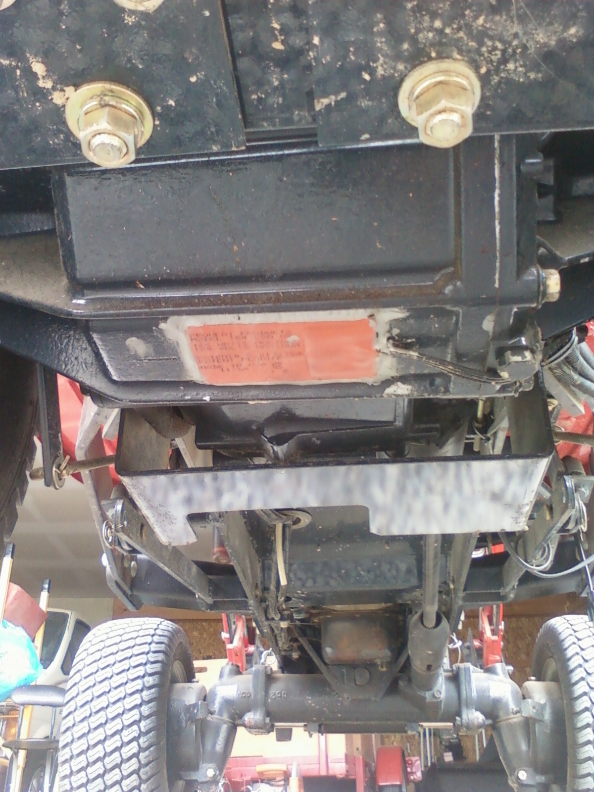

If you want to warm oil up, you can do it more effectively with a silicone pad heater permanently glued to the bottom of the oil pan. And, they are not expensive.
You do have to be careful not to use a heater that is big enough to cook the oil.
I use a 140w pad heater on my transmission to keep the oil from getting cold soaked.
