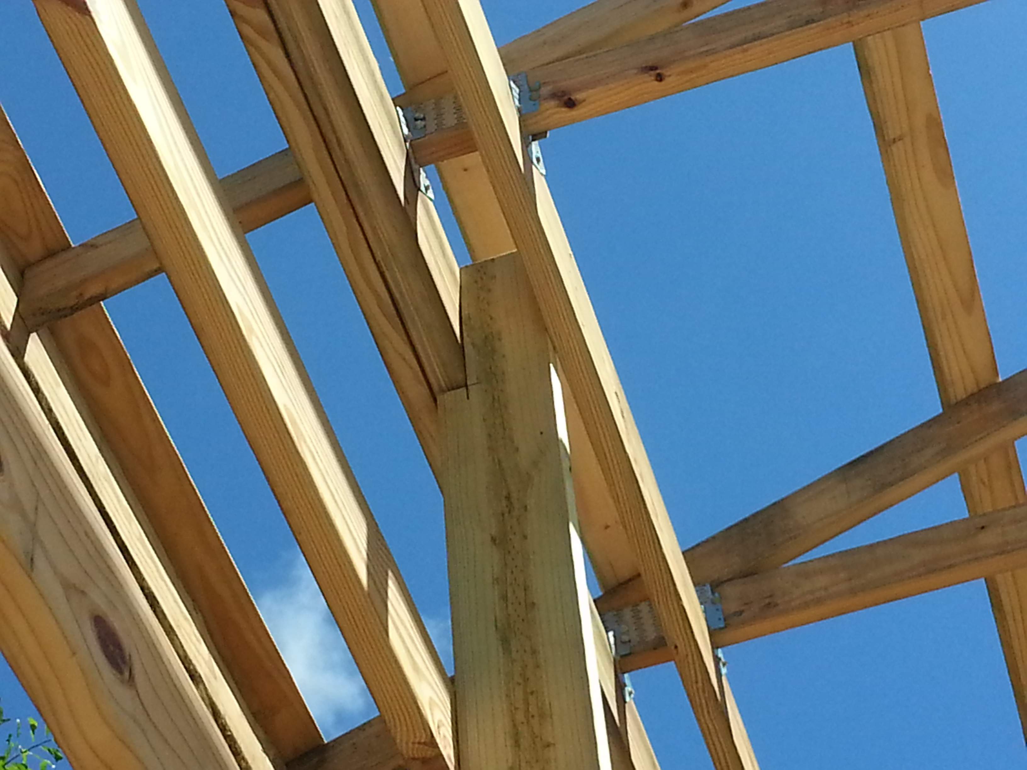

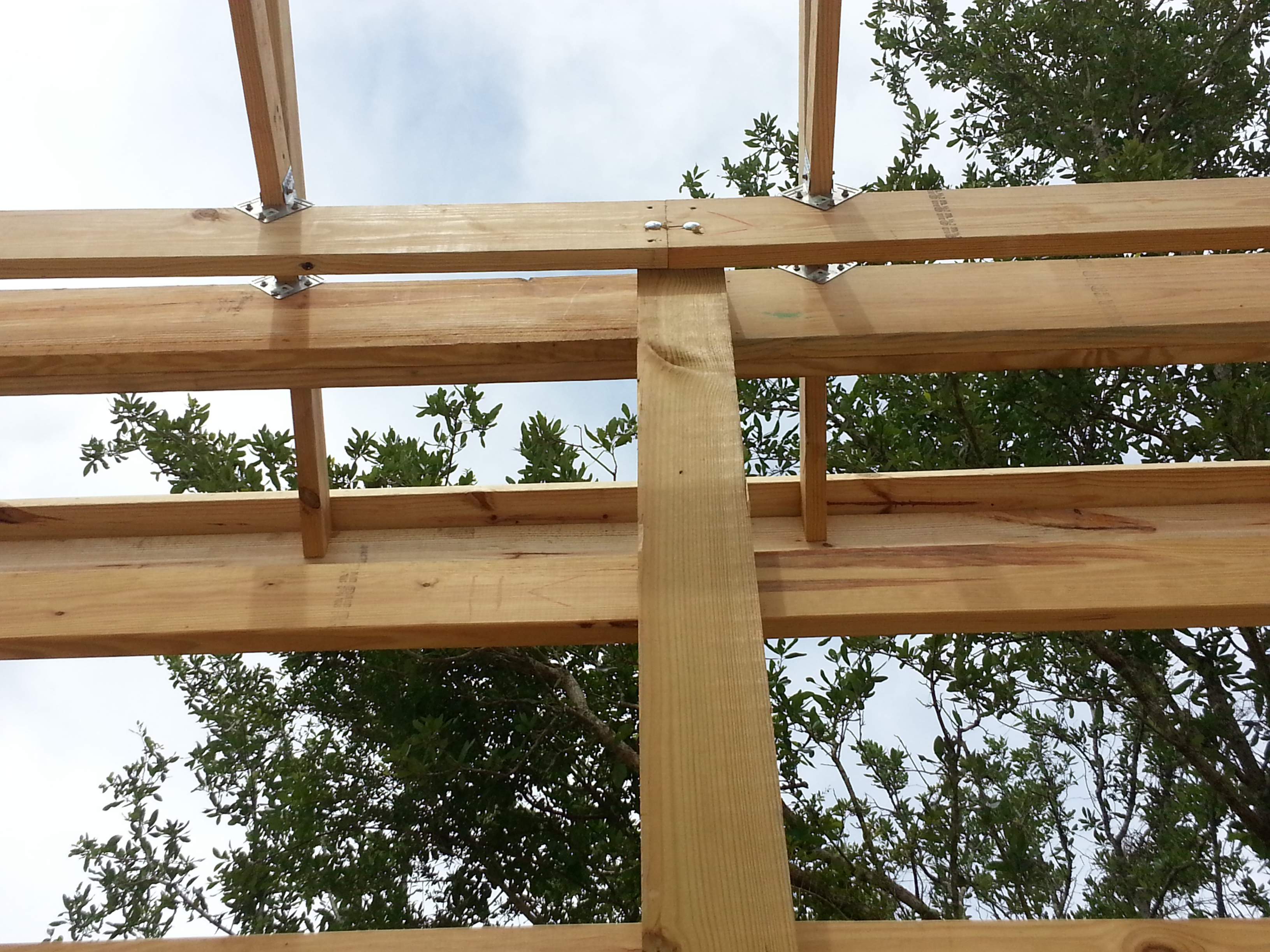

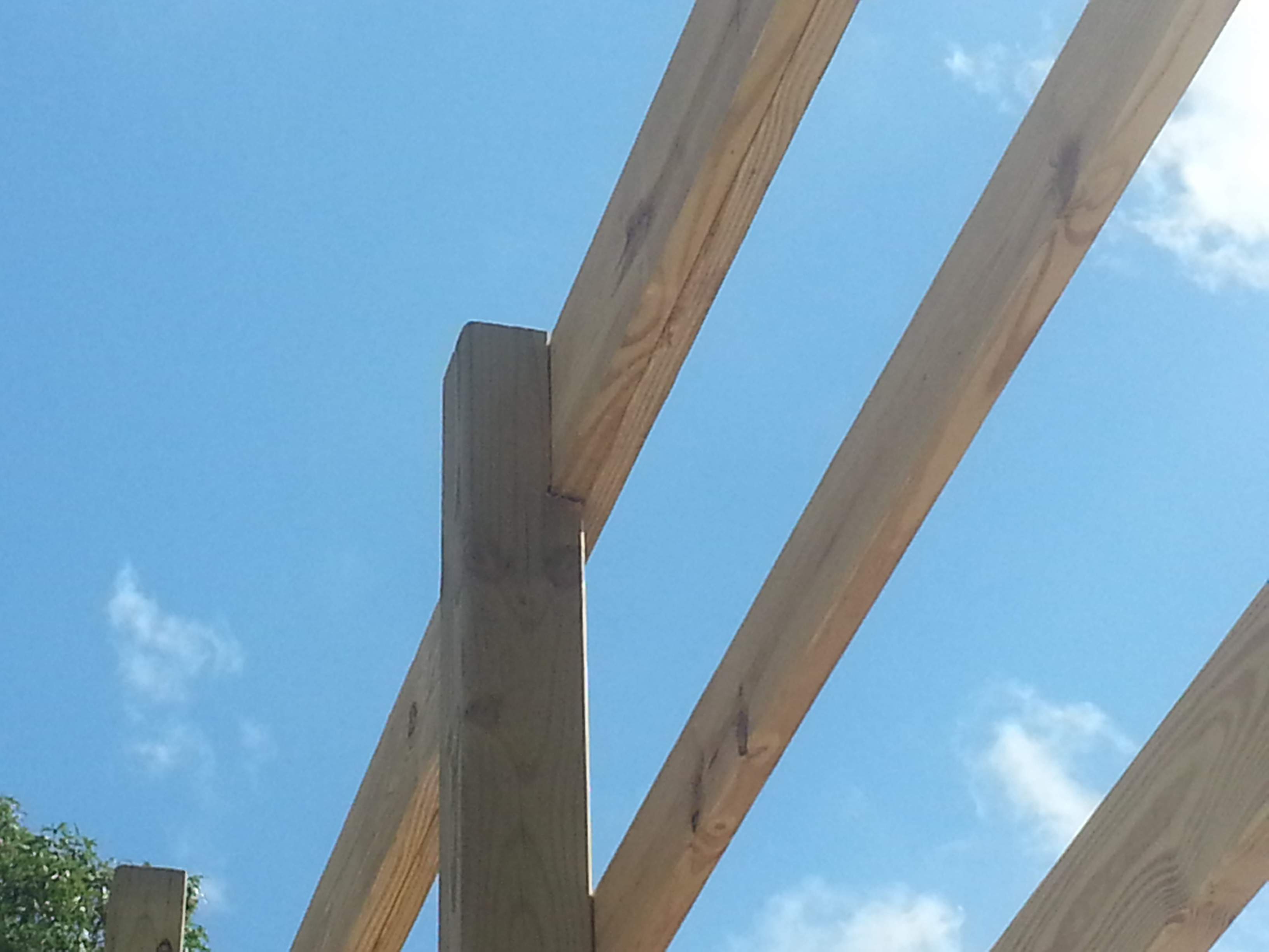

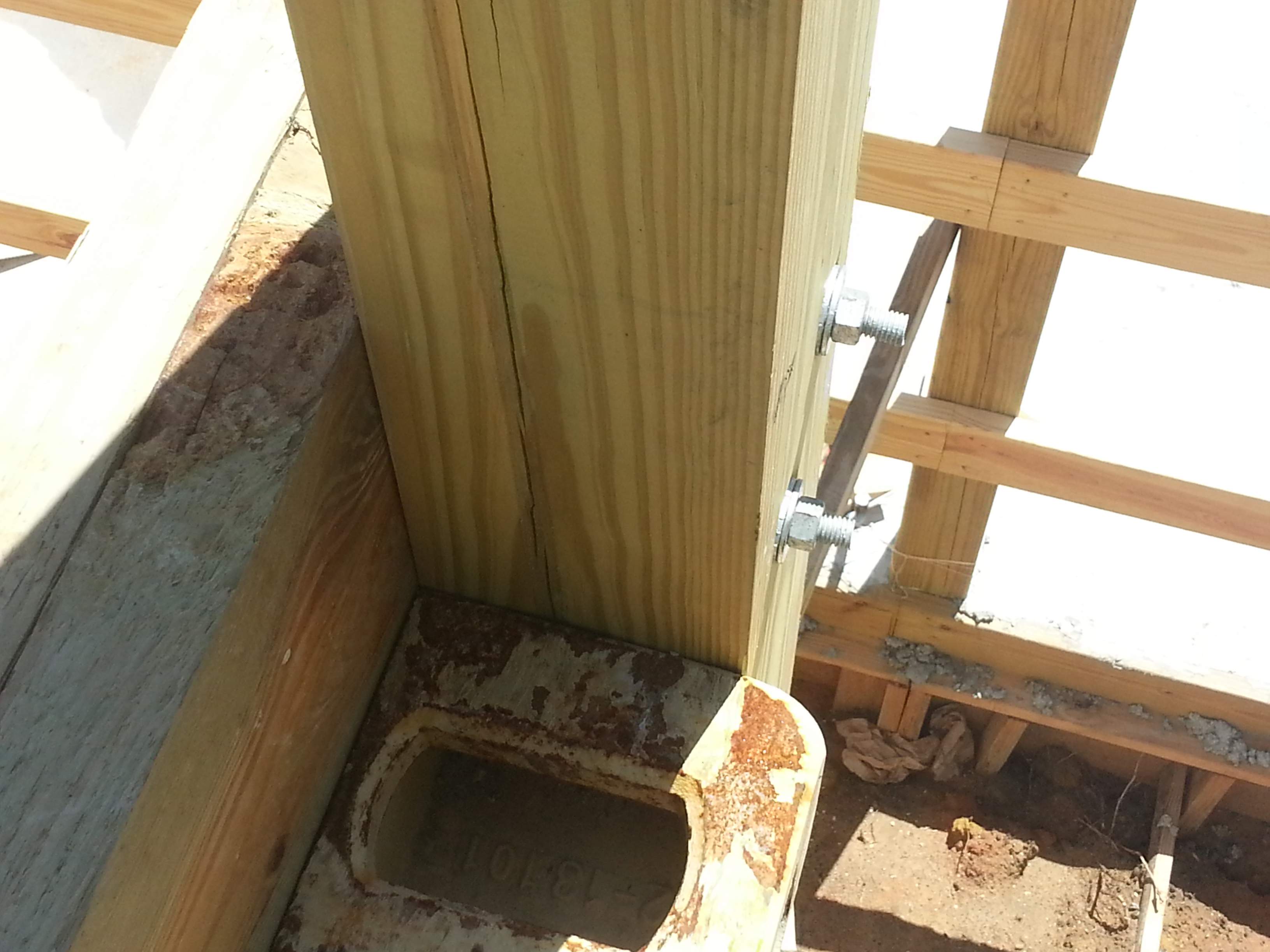

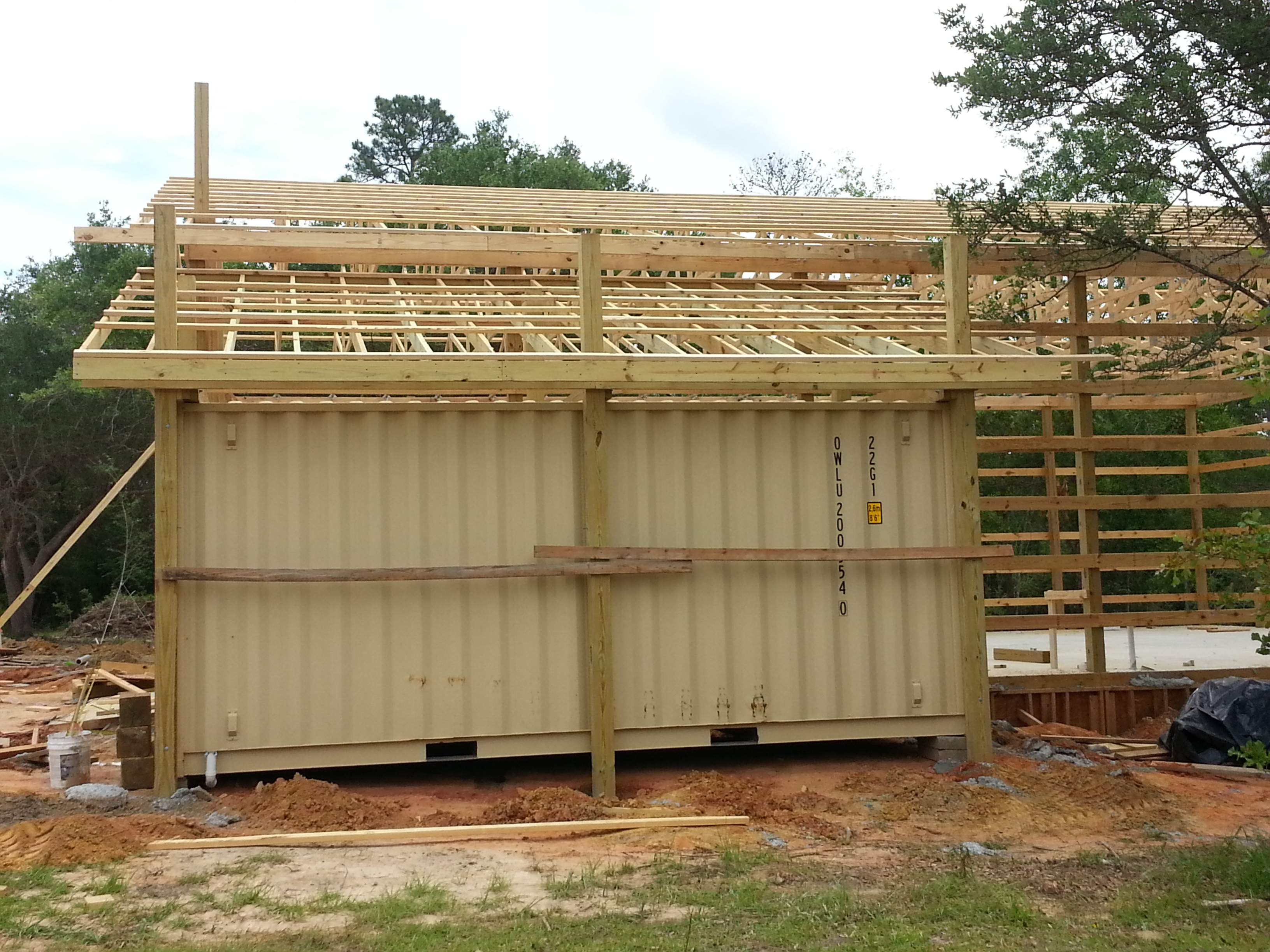

Top outside band is 2-2x10's with the inside 1 notched in post. Also a 2x8 added to the inside of the posts. All screwed and bolted to posts. Trusses sit on the 3 boards with 2 hurricane straps per side. 1 on 2x10 and 1 on 2x8.

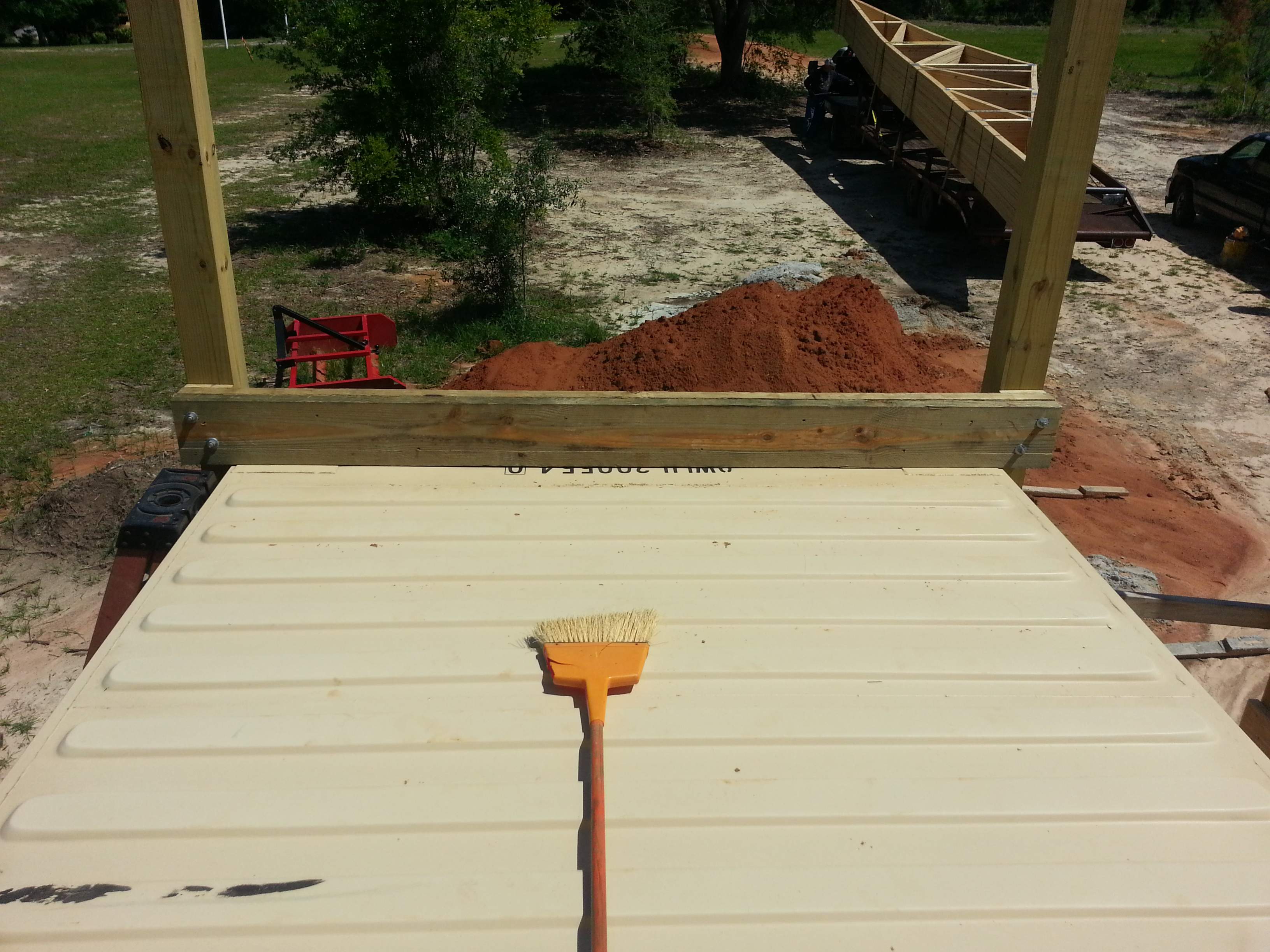

The shelter has 12-1/2" bolts drilled thru and bolted at corners to the 4 corner posts. The steel there is 1/2" thick rectangular tubing by the doors and 3/8" thick on other end. I added 2- rough cut 2x8's across the top on the ends. They sit inside the 4 corner pads that stick up higher than walls. I have 2 more 2x8" across the center for a total of 6 with 2-1/2" bolts per corner and rough cuts are screwed together with 4" deck screws.

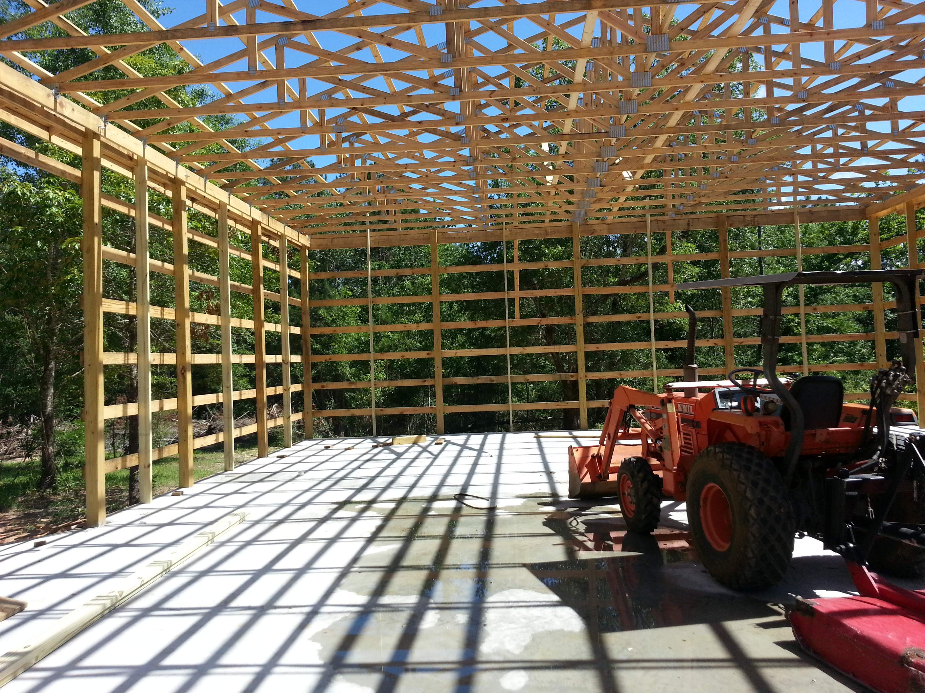

I decided to add treated 2x6x16' between all of the 6x6's to beef up the walls a little. I notched the tops to fit between the top bands and used galv. brackets screwed into the concrete at the bottom and screwed all the girts to it. Looks like tooth picks but really tightened and straightened things up. Waiting on rain to clear to start metal. Don't want the insulation wet.
