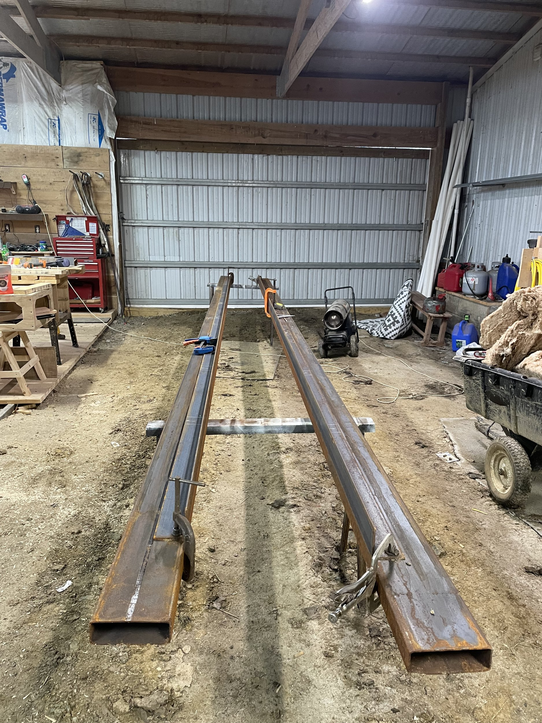

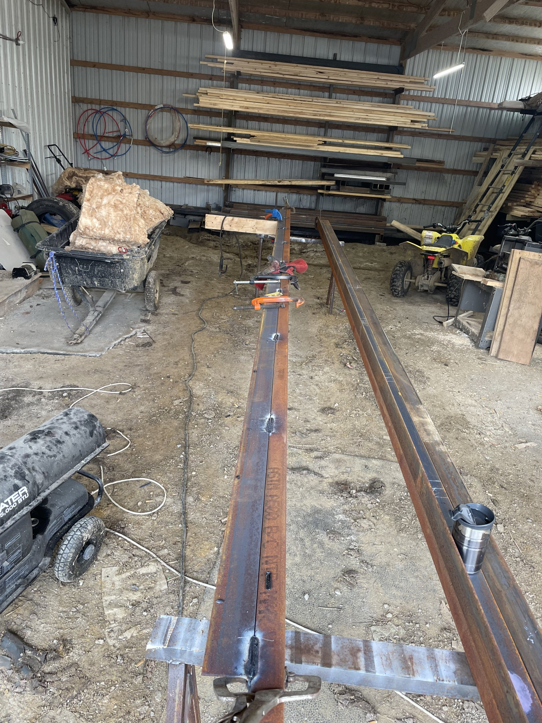

In my barn thread I mentioned a bridge build and people wanted me to post when I was building it.
Todays the day!!!
Approx 20’ span
Approx 7-8’ wide
2x6 tubes for the stringers
A center 2x6 tube under the stringers
3x3 tubes for cross members
6x6 treated timbers for the “foundations” on each end.
End goal is to drive a vehicle across!

/ Starting my bridge!! #3
Todays the day!!!
Approx 20’ span
Approx 7-8’ wide
View attachment 786740View attachment 786742View attachment 786743View attachment 786745

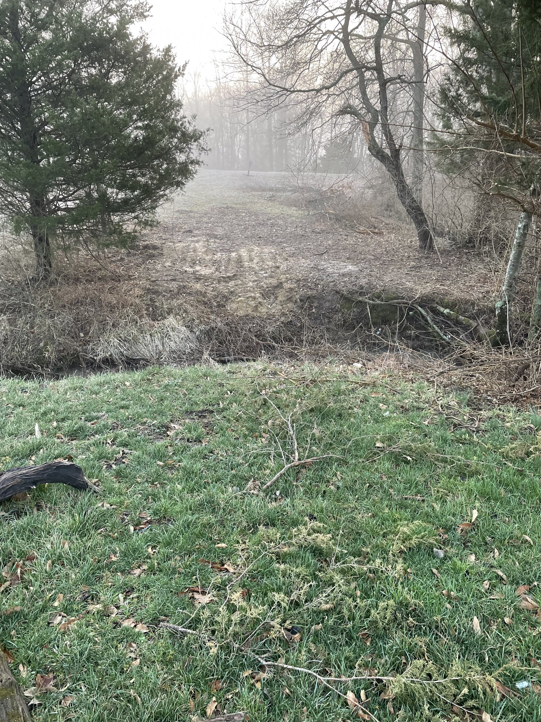

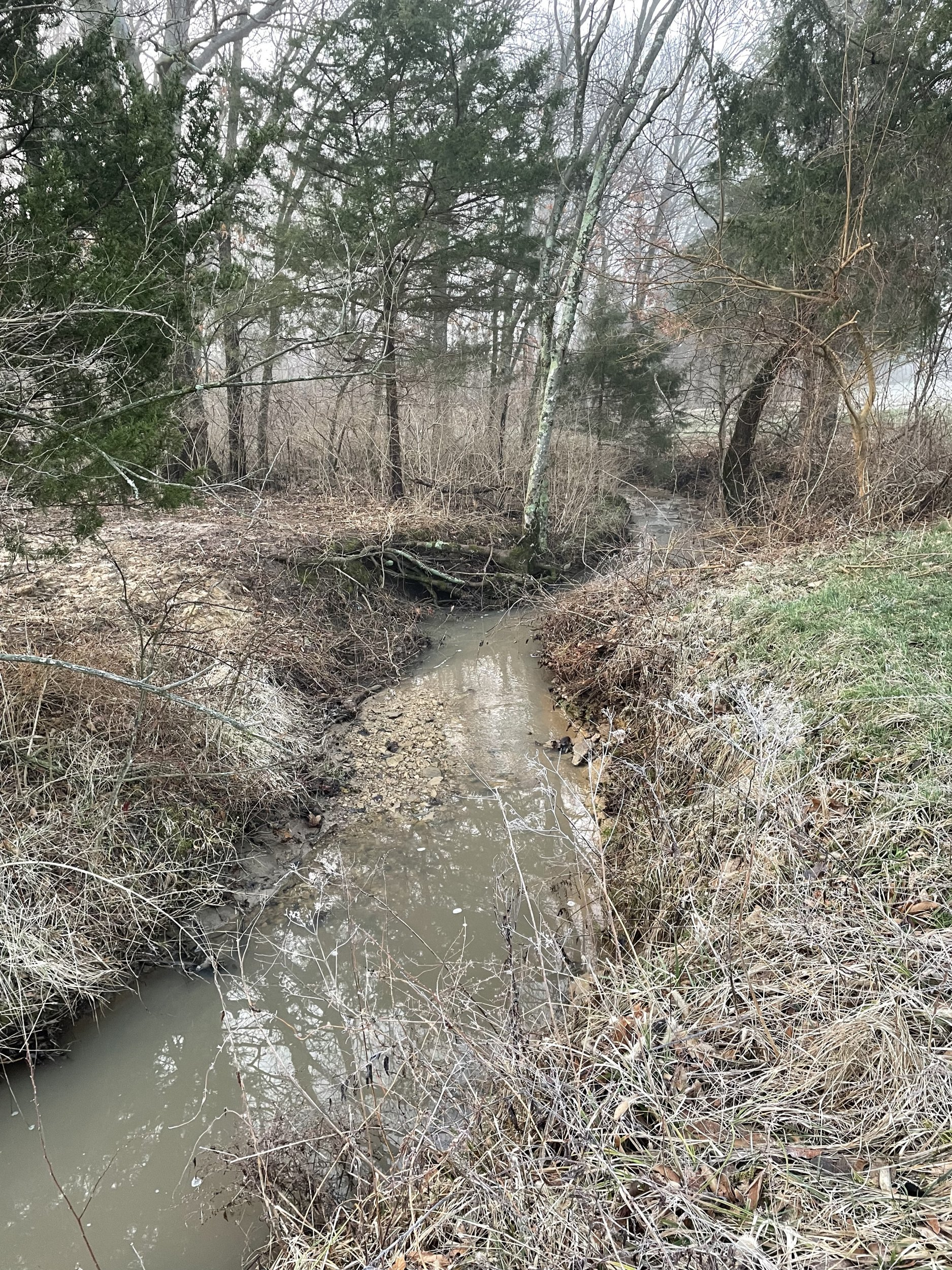

Is there a big flow fluctuation in this stream ? One thing to keep in mind is the vegetation always die under bridges, then the water erode the bank below the abutments since there is no vegetation to hold the soil together.
#9
subscribed as well looking forward to see the progress...
It gets going fairly well when it rains more than a couple inches.
It’s run off from a field next to me.
I’ve seen it completely dry before

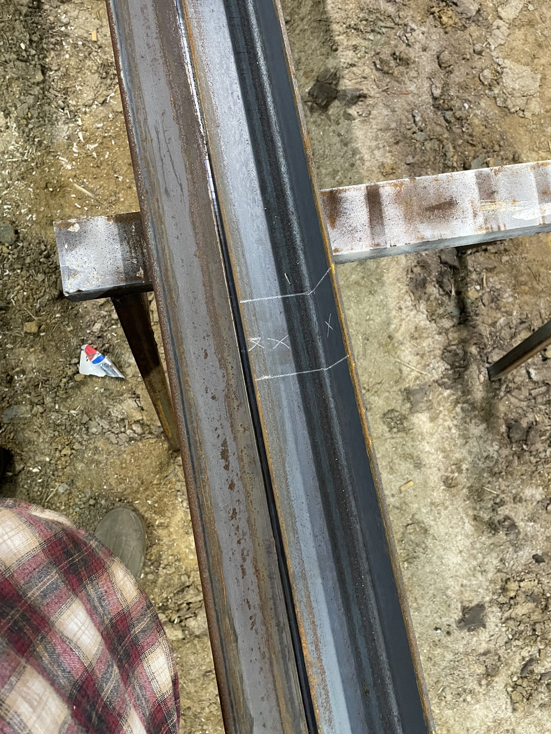

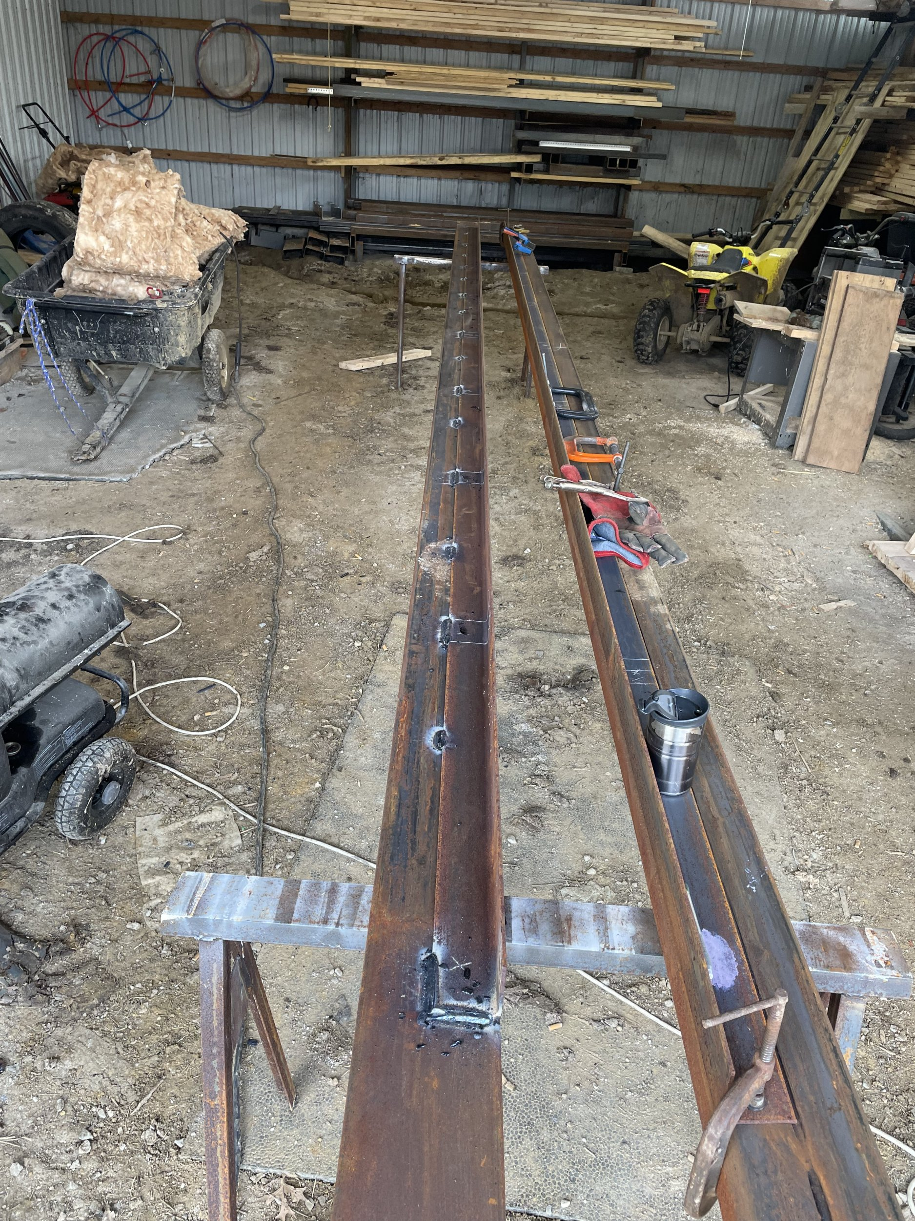

Progress so far.
Taking a break for some ice water and swapping of laundry.
This is the center stringer.
Gonna weld up the outside stringers after my break
Gonna be tricky getting the other 6x6 across the creek

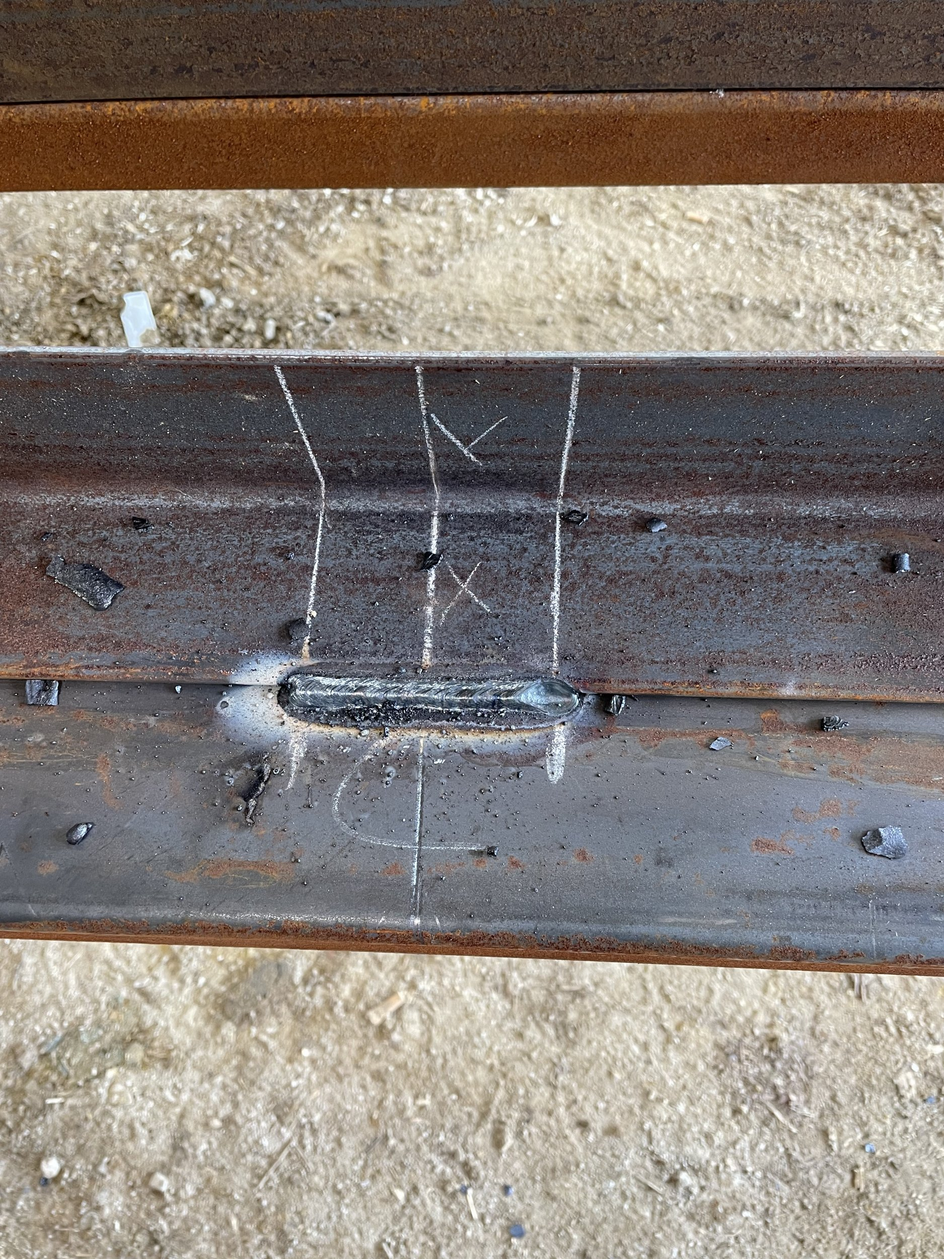

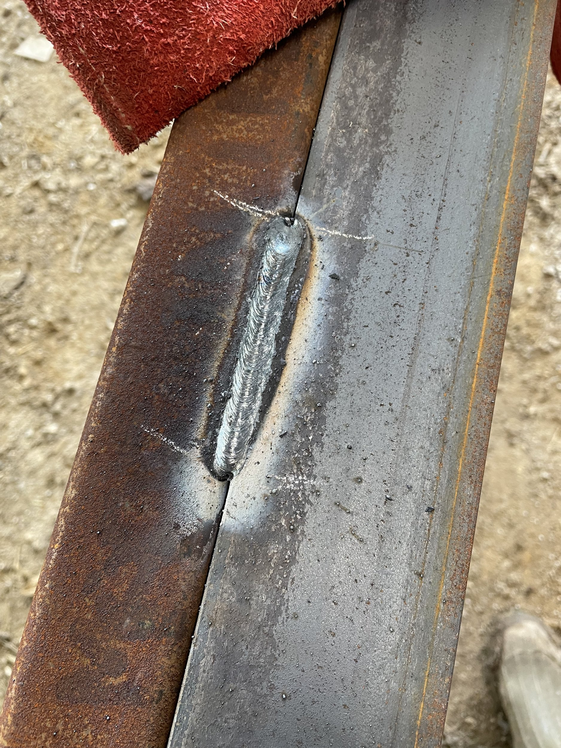

1 stringer welded!!
1/8 7014 rod-110amps
Miller Blue Star 185 welder

Good looking stick welds. I didn't use one enough to get good at stick welding. After I bought a good MIG, I never went back.
I’ve got a wire feed
For a project like this it’s really slow.
